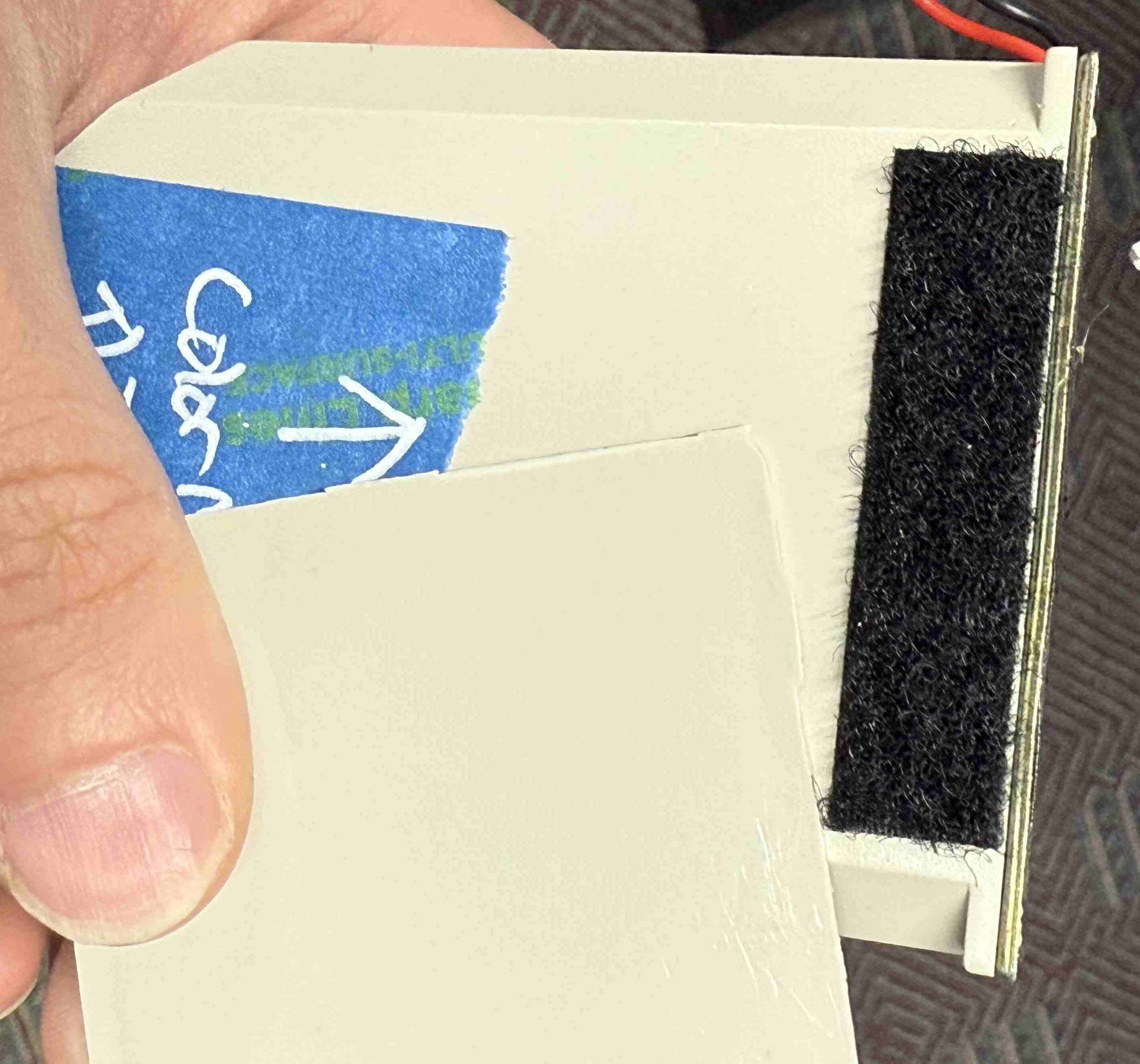

@jcm-1 Can you share what LaB, RAL or other color system value this PLA should match to?
A while back I measured platinum gray paint on a CD-ROM drive with a JZ-300 color meter.
It read:
L 76
A* 0
B* 3
I'm curious how close this PLA color would be to that.

The closest RAL standard color is RAL 7044. This has been established for a couple of years now (also by me). I matched it using a nix Mini 2 color sensor, getting an RGB value, then cross referencing that to the RAL color standard. We had been getting filament from ColorFabb in the Netherlands, but they cost something like $46/750g plus shipping and import duty - so not very cost effective.
This filament from Polar Filaments was matched physically. I sent them the speaker box from inside my Color Classic (i.e. has never seen light, so no yellowing), and they matched it to that doing whatever color matching magic they do. Attached is the color swatch match to the speaker box.
