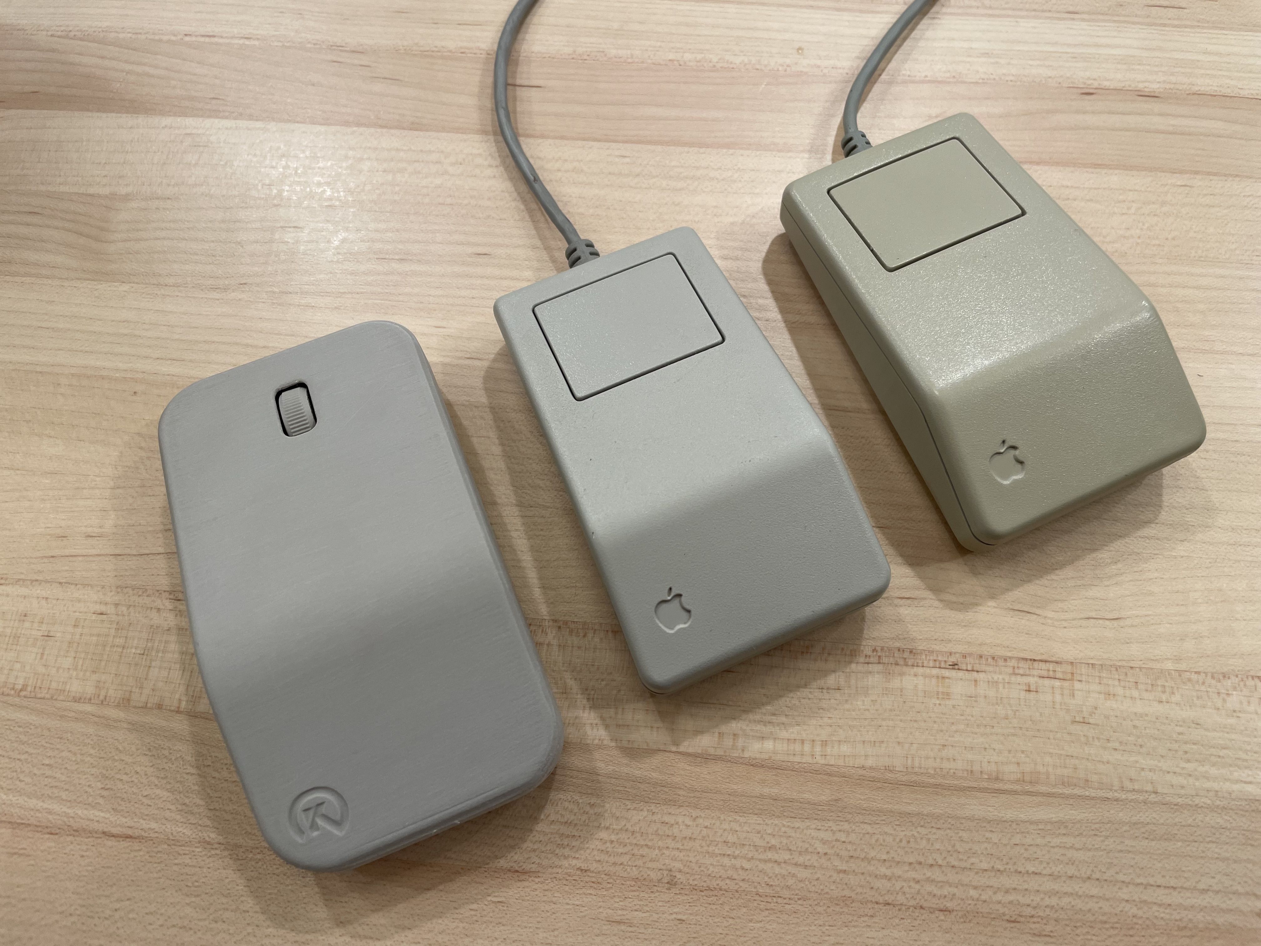

I've had no problem printing items with Polymaker Matte PLA Filament Matte Muted White on my Bambu Lab A1 mini, about 1/3 way through my spool now.
Polymaker PolyTerra™ PLA Muted White
https://www.amazon.com/dp/B09TR8N5T2 (unavailable now, bought mine Jan 2024)
Here's a retro inspired mouse I printed recently:
It looks like this is the replacement?:
Polymaker Panchroma™ Matte PLA Muted White
Are you guys saying you have problems printing with one or both of these? and/or the color on the new "muted white" is different, not as close to Apple Platinum? (it def was not an exact match for the older version, not bad either though) Anyone have a comparison picture?

The new version of it is a little warmer on the color. ColorFABB RAL 7044 is an almost exact match.
Problems with both. "Gooey" or "doughy" is how I would categorize the plastic. I've printed it on everything from a Creality Ender 3 Pro up to a Bambu Lab X1 Carbon.
Try using it with anything that takes stress: like non-brass screw bosses, or pressure clips, or any kind of small details.

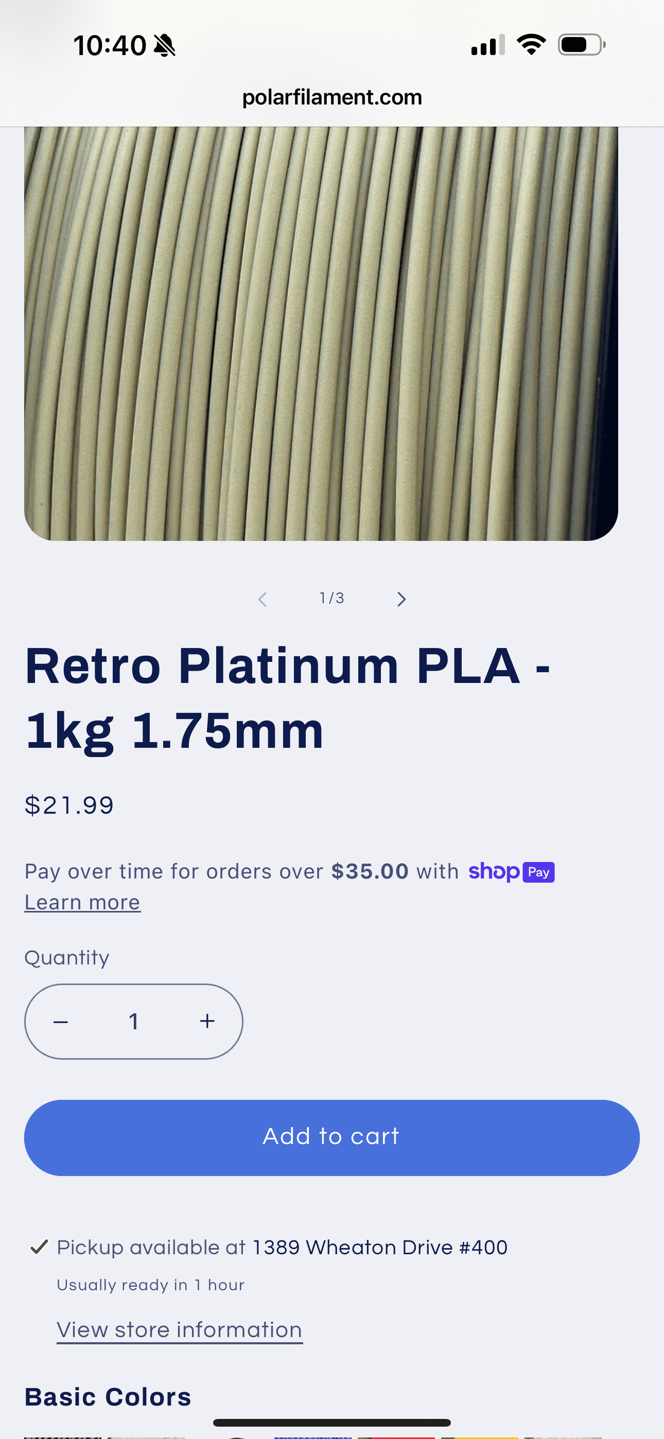

The update is:
Polar Filament has color matched Mac Platinum filament in stock now, for $21.99 per KG. That's it. That's the update!
I ran into Chris Auger at the SEMVCC meetup this year. He noticed the SE Mini case I had and asked about the color. I told him the story about ColorFABB. He said he had a place that was local to him that made color matched filament. WOO HOO.
I paid them a fee to color match the speaker box from inside my Mac Color Classic. Then, I paid them for 25KG of filament - all in about $900. In exchange, I asked them to release the color to the public so anyone can use it.
Go get a spool or three and let them know it's popular, so they keep making it!

Since you seem to be in contact to them, one feedback maybe you could pass along is that their site doesn’t make it clear on the order page that shipping is available. When I went to the page before, it looked like they only offered local pickup.
if they could add something like “shipping available” under the description or where it only says “pickup available”, it might get them more sales.
I did just order a spool. Thanks for doing this! I expect once word gets out of hey will do pretty good business selling these.
I'll let them know.
