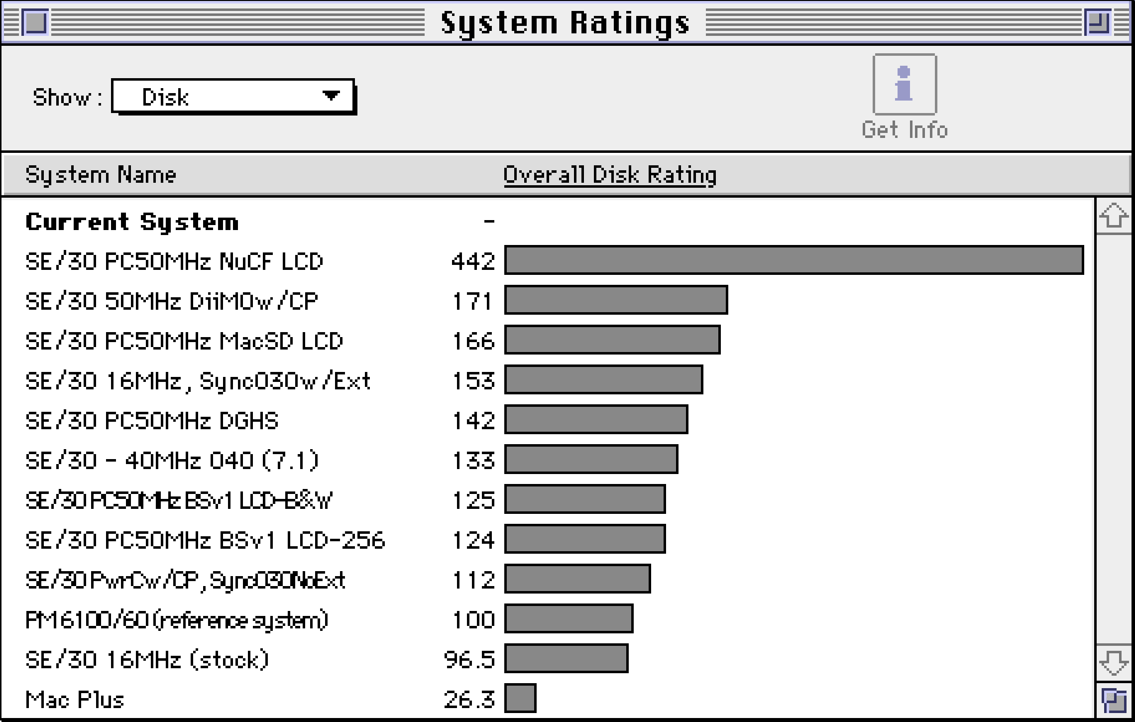

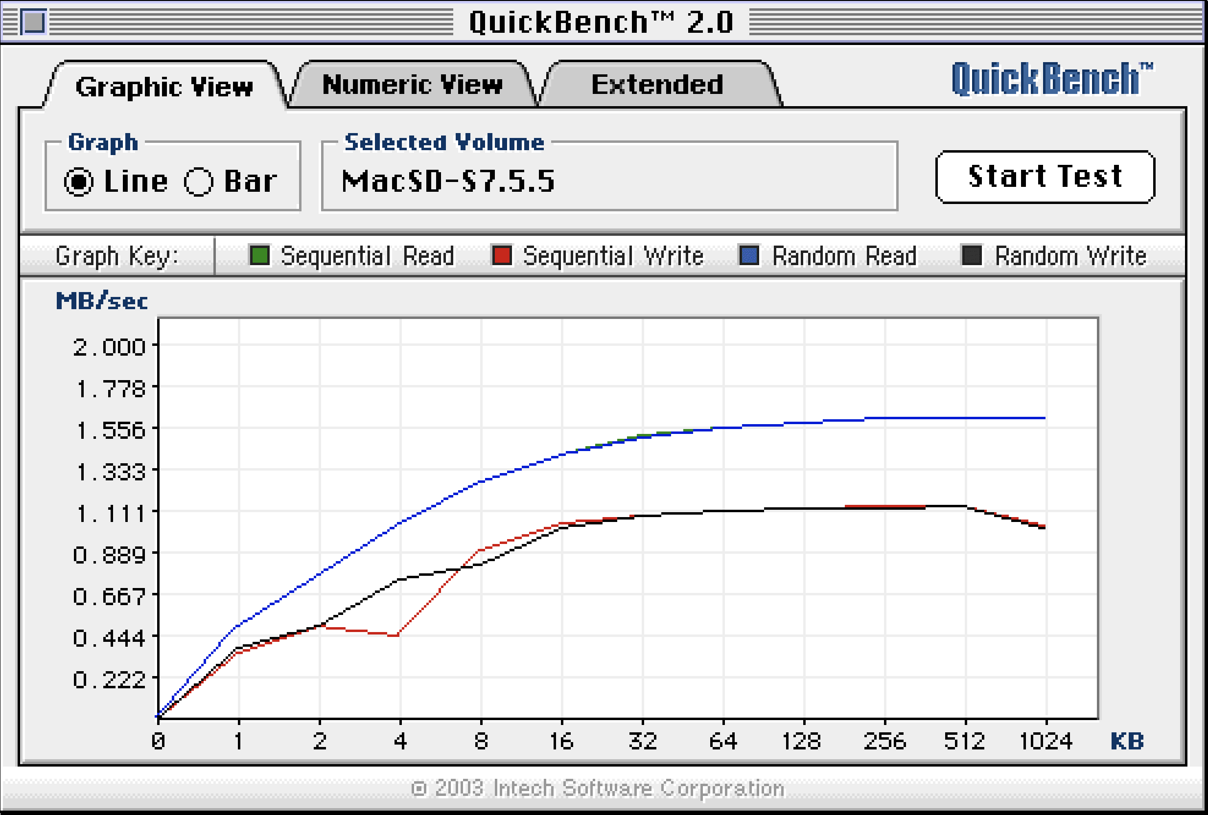

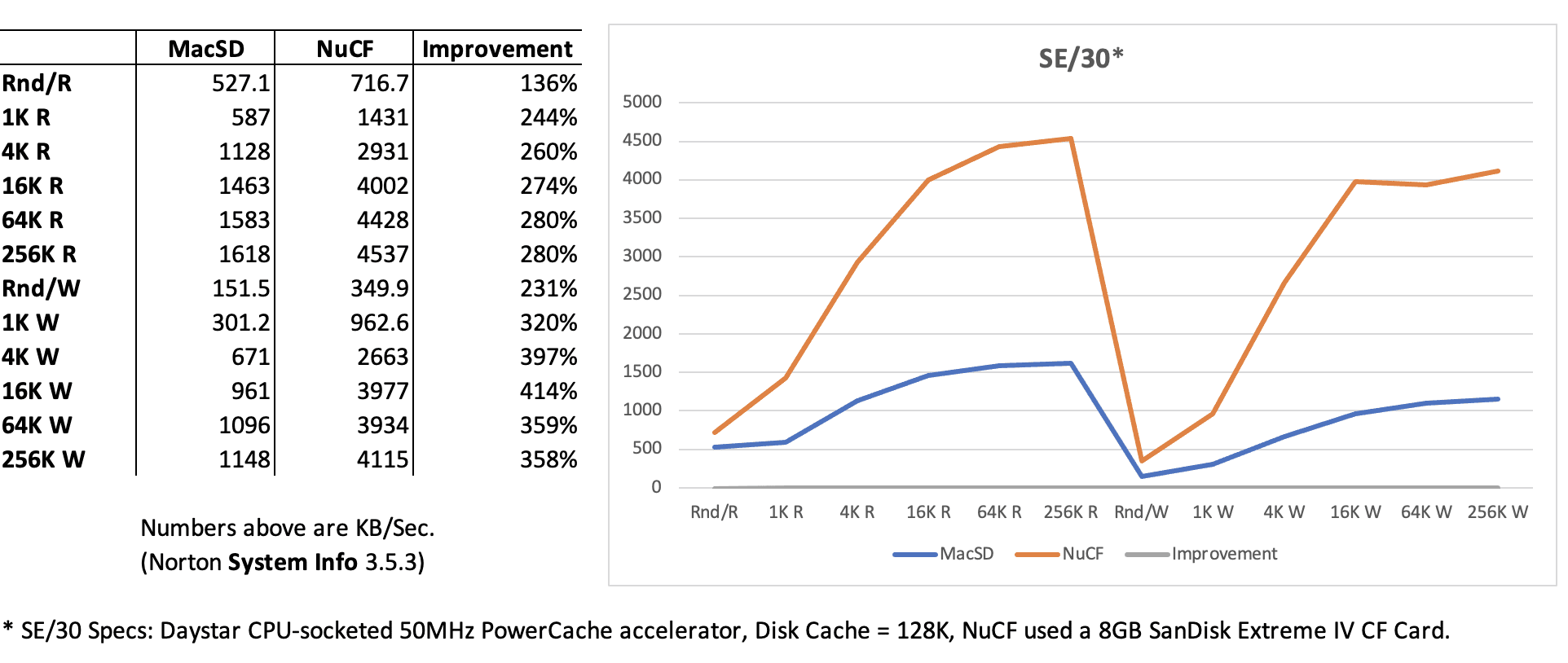

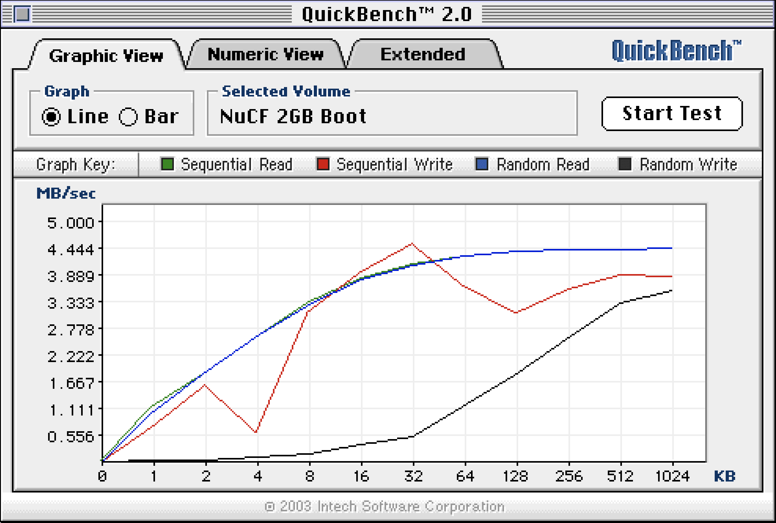

Below are my SE/30 benchmarks (with the IIfx at the end, created by ZZJ). Note that my SE/30 has a 50MHz CPU-socketed Daystar PowerCache installed (with PowerCentral loaded, caches enabled). Previously, I was getting the best scores overall with MacSD by @YMK. MacSD even beats BlueSCSIv2 (a great, fast product) in most of my benchmarking on SE/30 machines. But because NuCF bypasses SCSI altogether, it gives you some serious performance increases, as shown below. BTW, I still love MacSD. It's really fast and has great features, which makes the sheer speed improvement by NuCF all the more impressive.

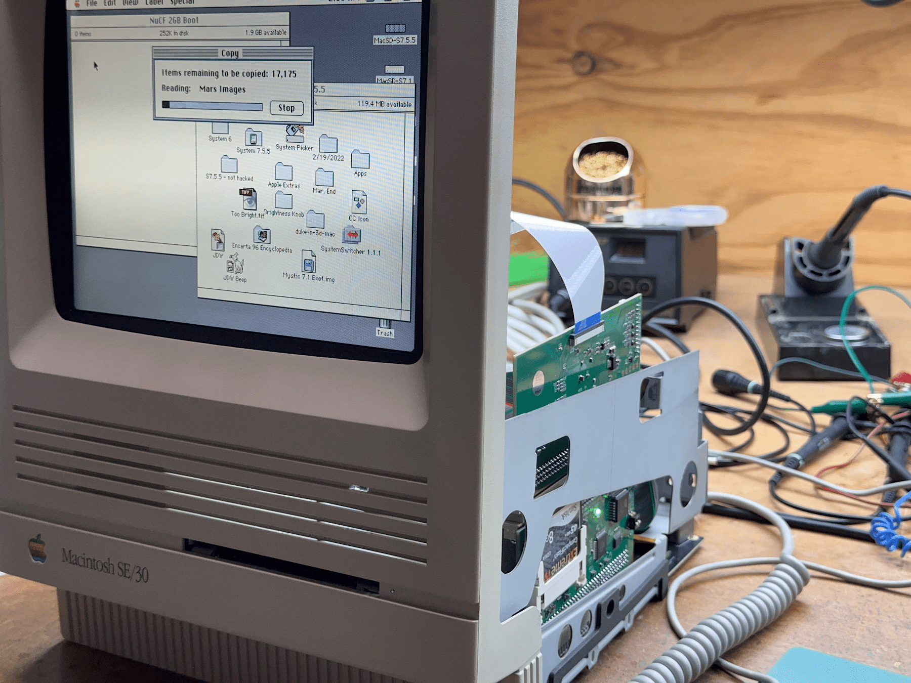

I ran those benchmarks with NuCF installed in my SE/30 which has ZZJ's LCD color kit.

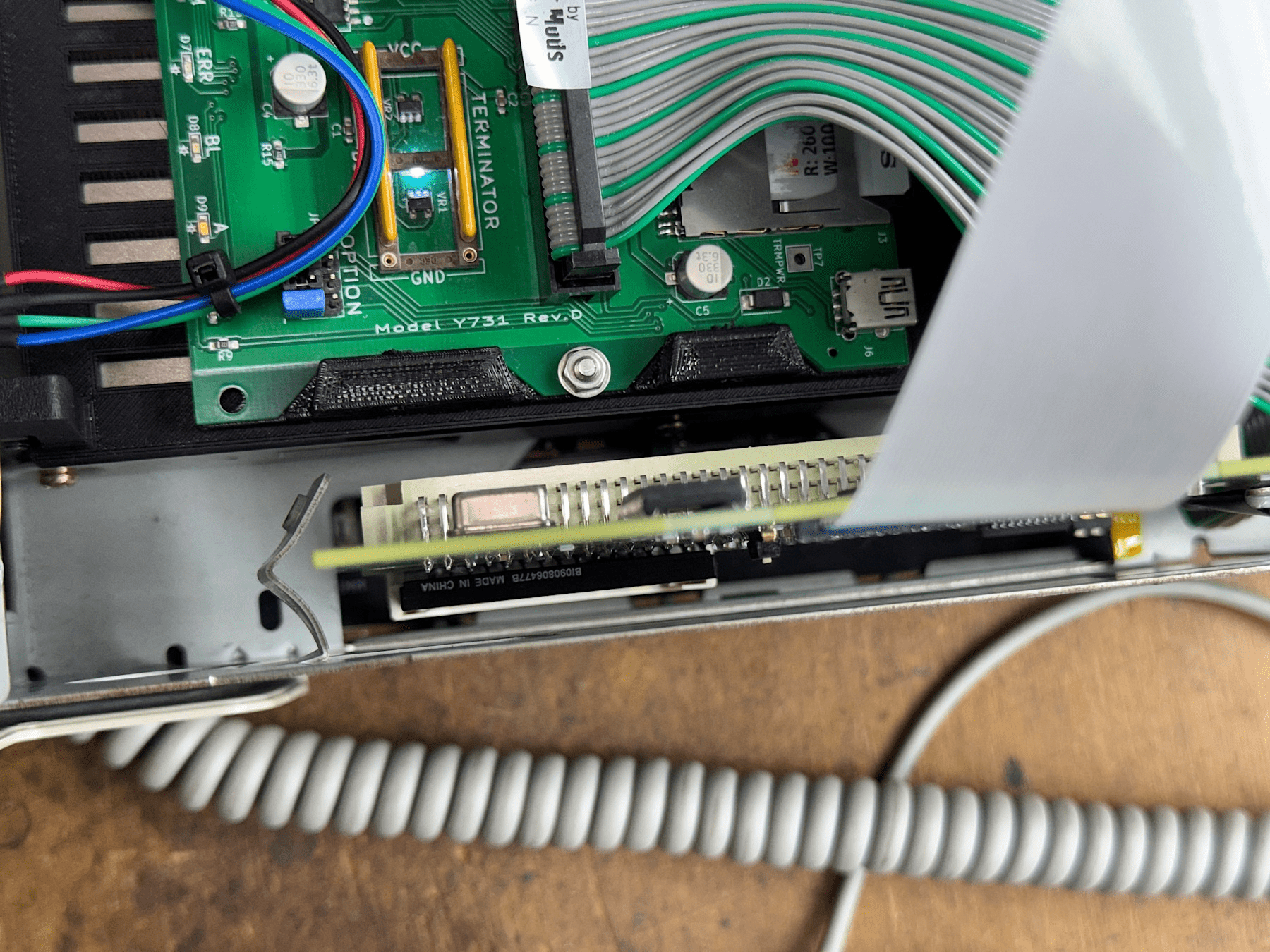

You can stack PDS cards, and the photo below shows the 30color video card sitting atop NuCF.

We need to get more NuCF users to chime in about how performance differs from card to card. So if you own a NuCF, please run System Info 3.5.3 (or 3.5.5) and post your own bar graph for Disk Ratings and create your own MS Excel graph too. I've attached the Excel file I created to make it super easy for all of you to rework it with your own benchmark results.

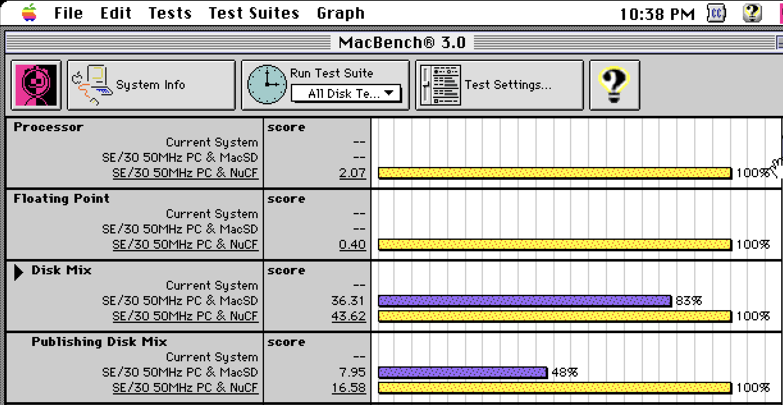

MacBench 3.0
Norton System Info 3.5.3: Disk Ratings
Norton System Info 3.5.3: Detailed Ratings, Absolute

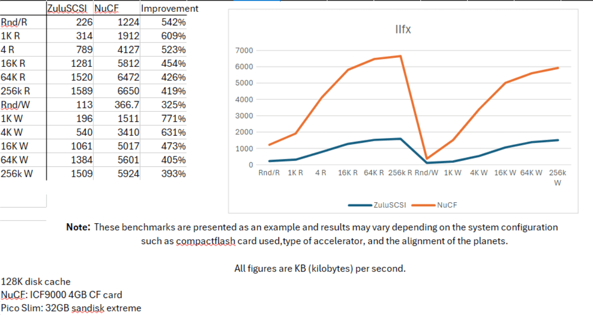

Norton System Info 3.5.?: Detailed Ratings, Absolute (for Mac IIfx, created by ZigZagJoe)
ZZJ's Comments on BenchMark Results
I was told that "sequential performance" is faster than a 68030 Mac really needs, but that the "random disk access" is the benchmark result where you'll see major improvement and which gives you the overall feeling of speed from NuCF. ZZJ went on to say that most SE/30 accelerators cause some loss of measured benchmark performance (especially sequential) when using NuCF. He cited an example of the Carrera accelerator as having a "bad bus translation implementation" (when benchmarked alongside NuCF). But he added that "random access" performance is not significantly impacted by accelerators, so it's of little consequence in use.Lastly, his sales page on the 68kMLA also says this:

Minor Installation Caveat
You will need to bend the left side metal tab on the SE/30 chassis to avoid shorting the card you have stacked atop NuCF, as shown below.Performance Tweaking
