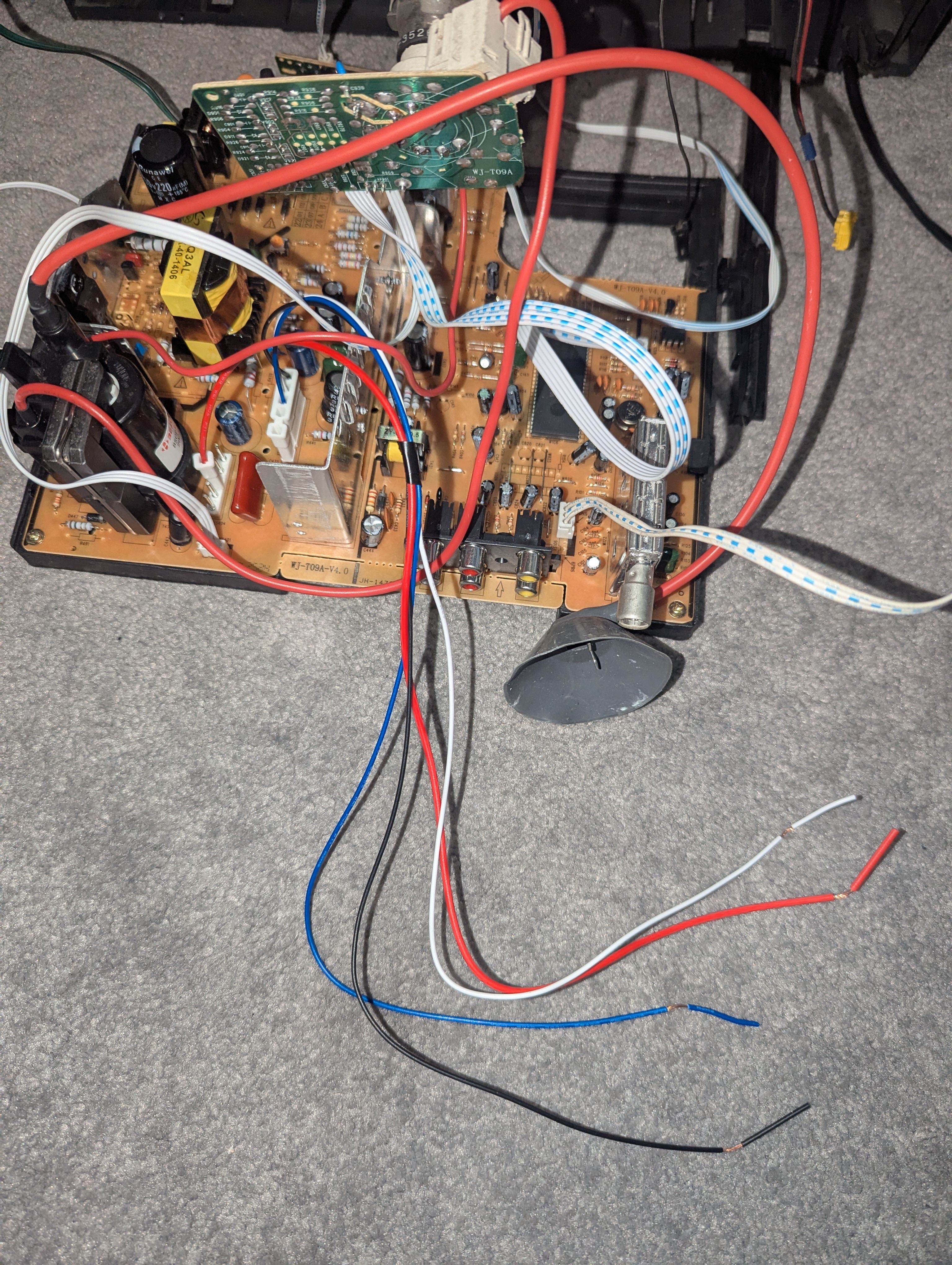

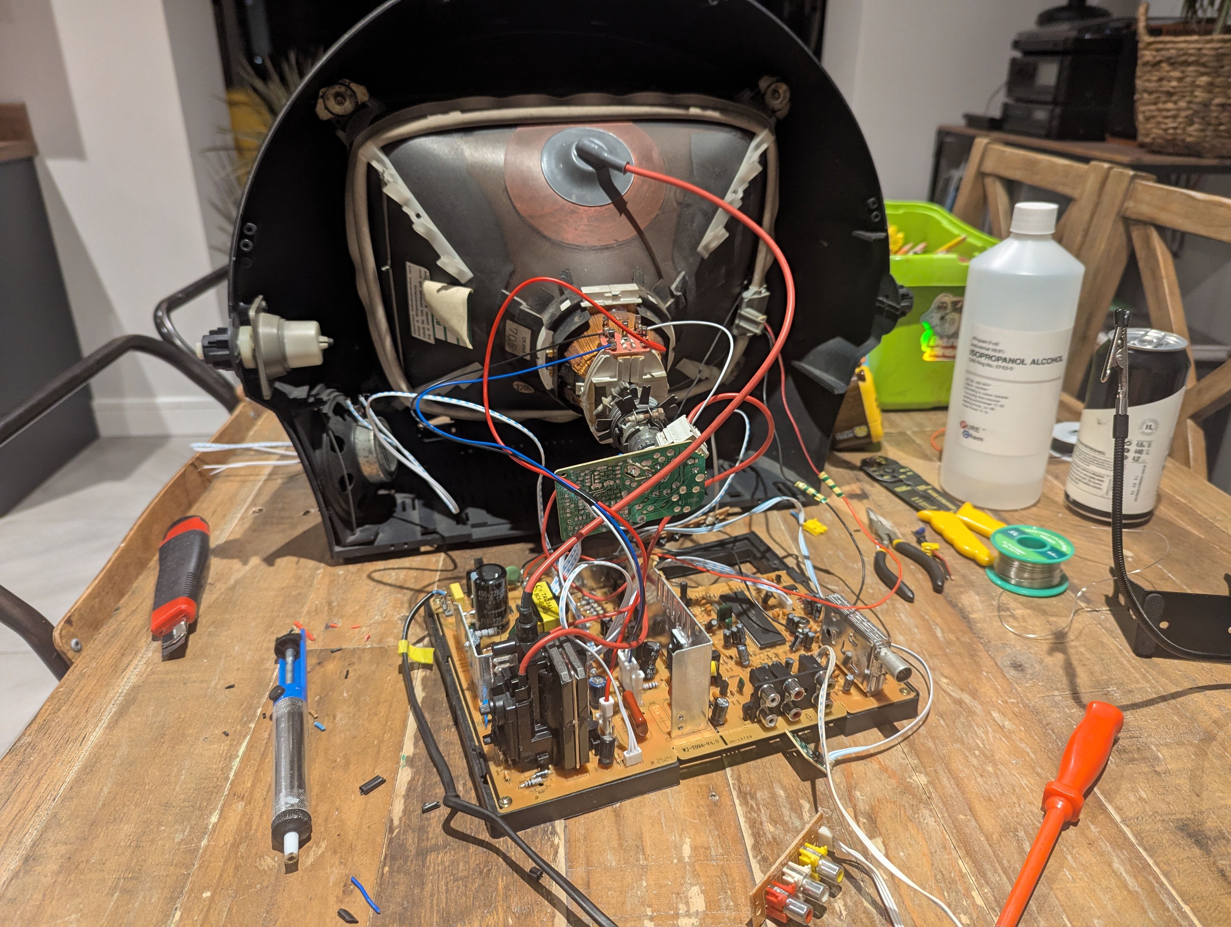

Aliexpress has various replacement analog boards for the 14-20+ size CRT set new, production dates in 2023. The components would suggest compatibility with Phillips sets so I was willing to gamble the $70 cad to bring my Discoverer back to life!

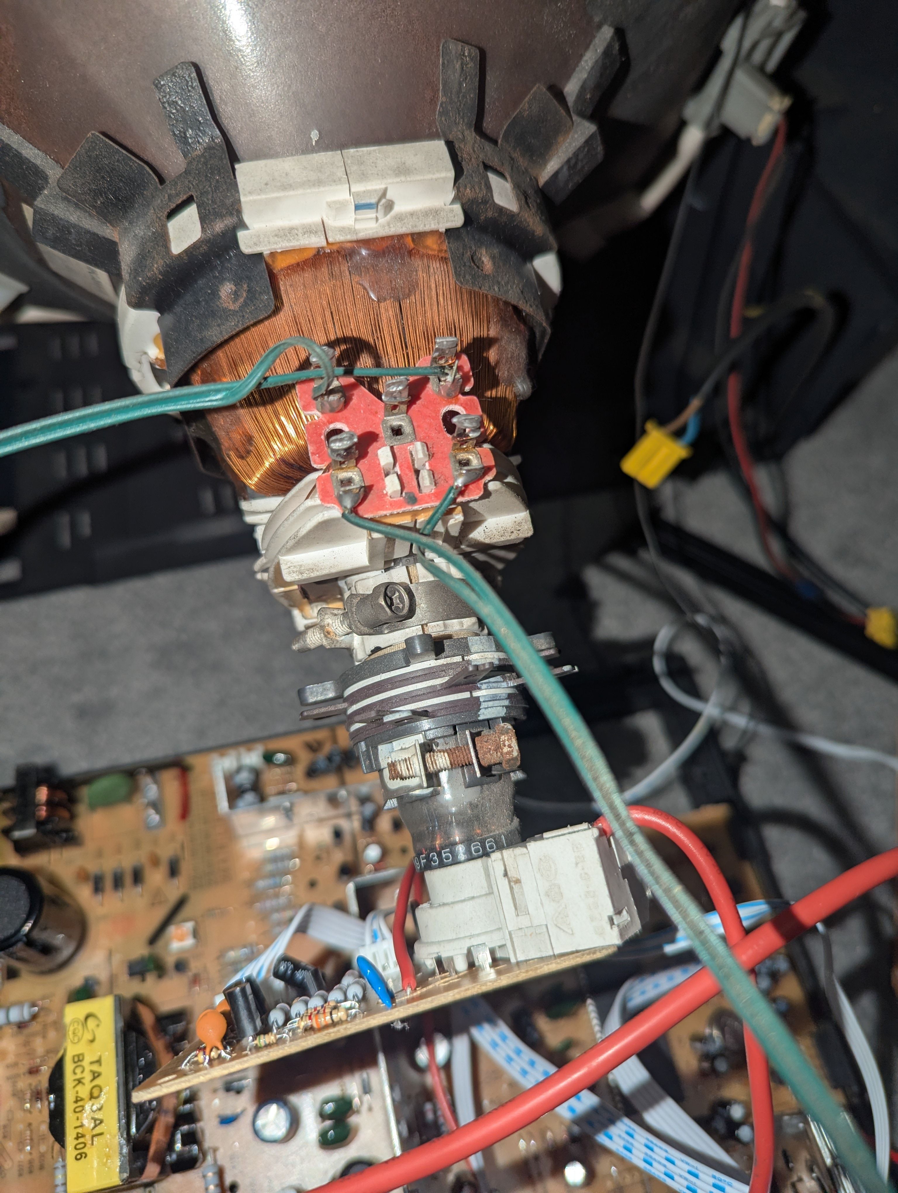

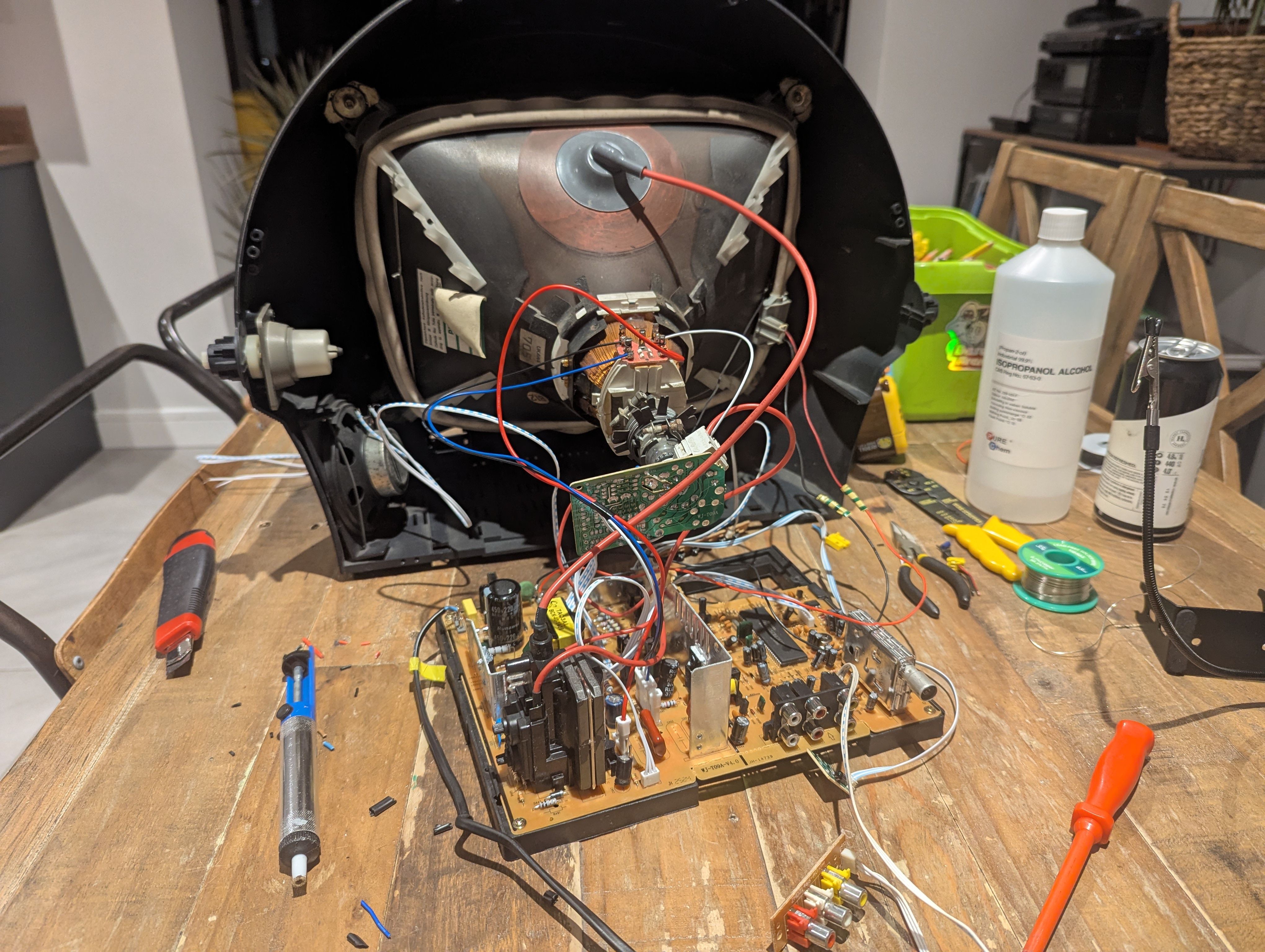

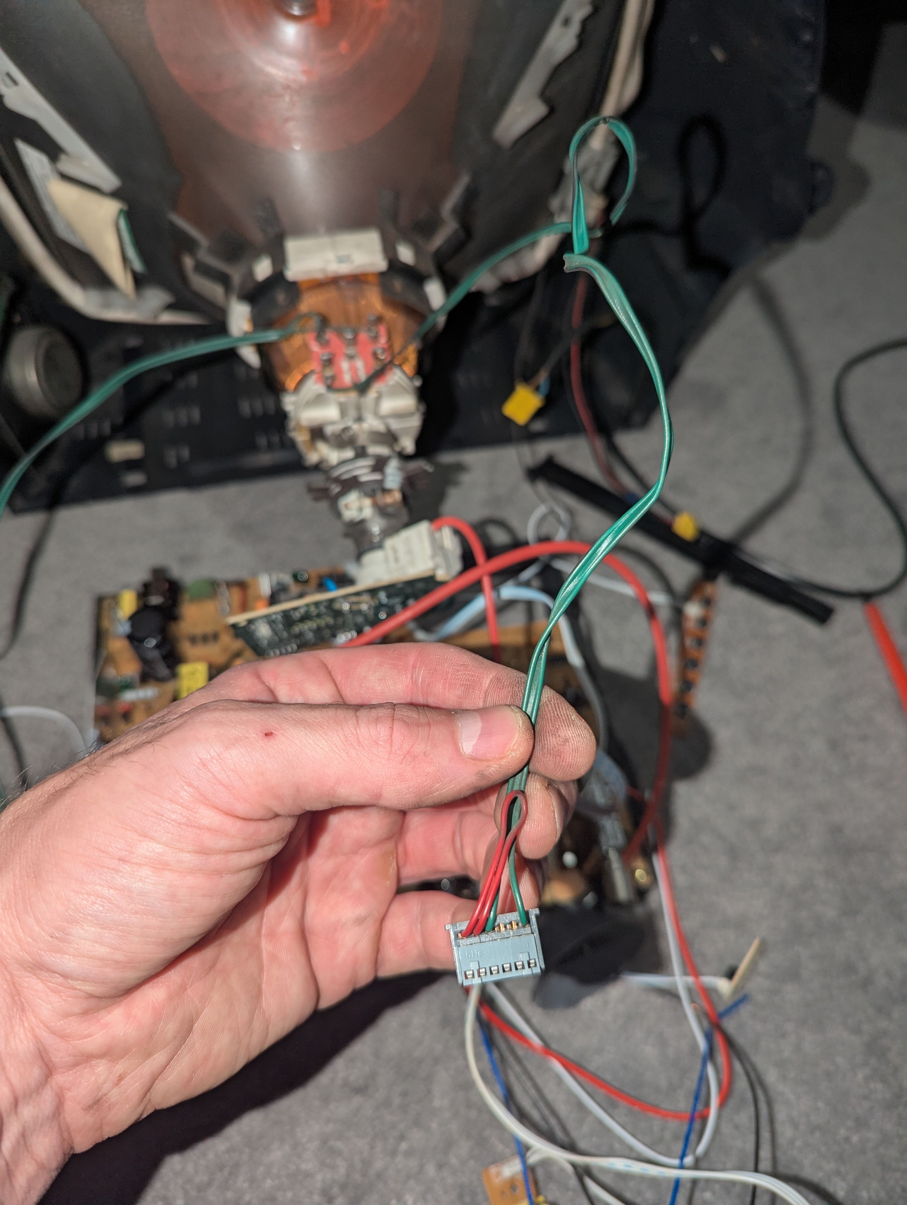

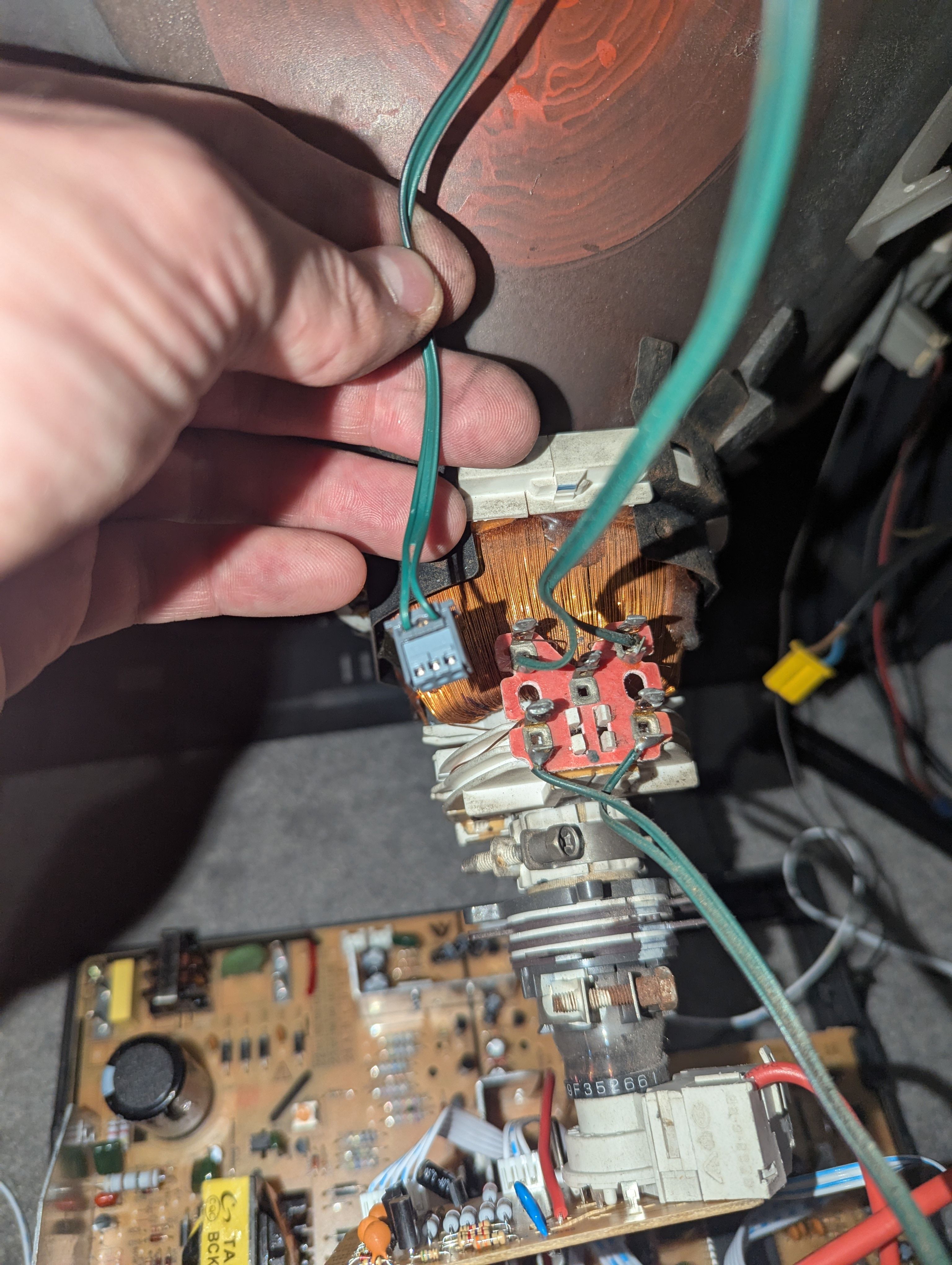

Installation was easy, even without having to reference the schematics it was straight forward to pair the horizontal and vertical deflection, degauss and speaker.

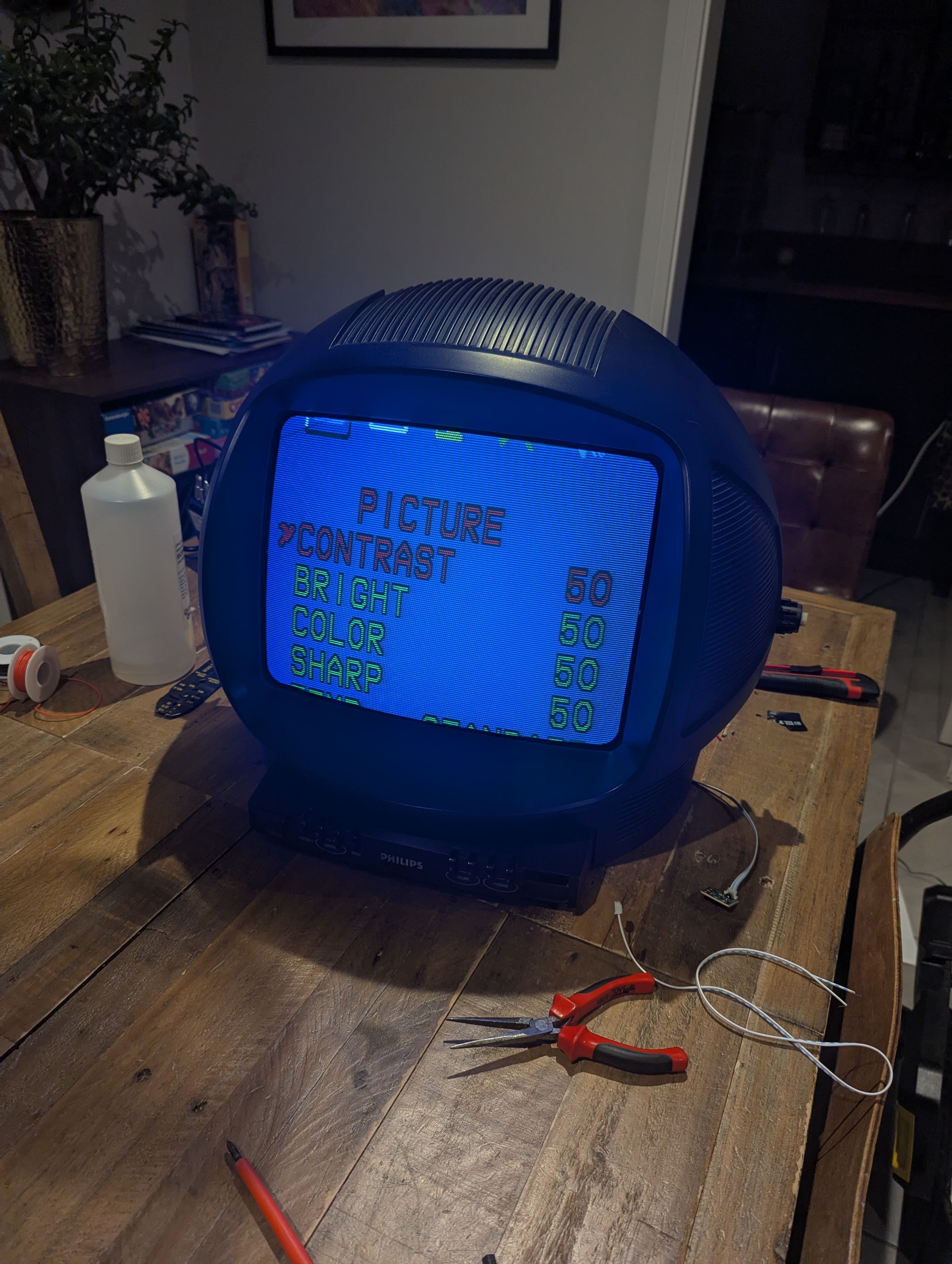

I was honestly amazed that right out of the box this worked and the new board provided an excellent result! I loaded 240p test suite over component input and got to work adjusting the geometry, colour and start considering how to install everything while keeping the set looking original.
To retain the original buttons at the front I took the advice from @techknight and relieved the original board of that section of PCB, I cut all the traces going to/from the buttons as not to increase resistances and confuse the onboard logic. The analog board kit provides an IR receiver and button board which I patched directly into the original.
After using a bit of epoxy to hold the button panel in place it was a pleasant DISCOVERER-Y that the included mounting bracket fit exactly into the sliding PCB channels. This was meant to be!
The only visible alteration to the set was the rear input panel, since this is a mono speaker set there was only two rca jacks, I had to cut this section to accommodate the third. I could have taken the time to 3d print another IO panel but I will never look back here too often (the white wire seen at the panel is about 1ft long and easily allows separating the two halves for service/cleaning without having to disconnect).

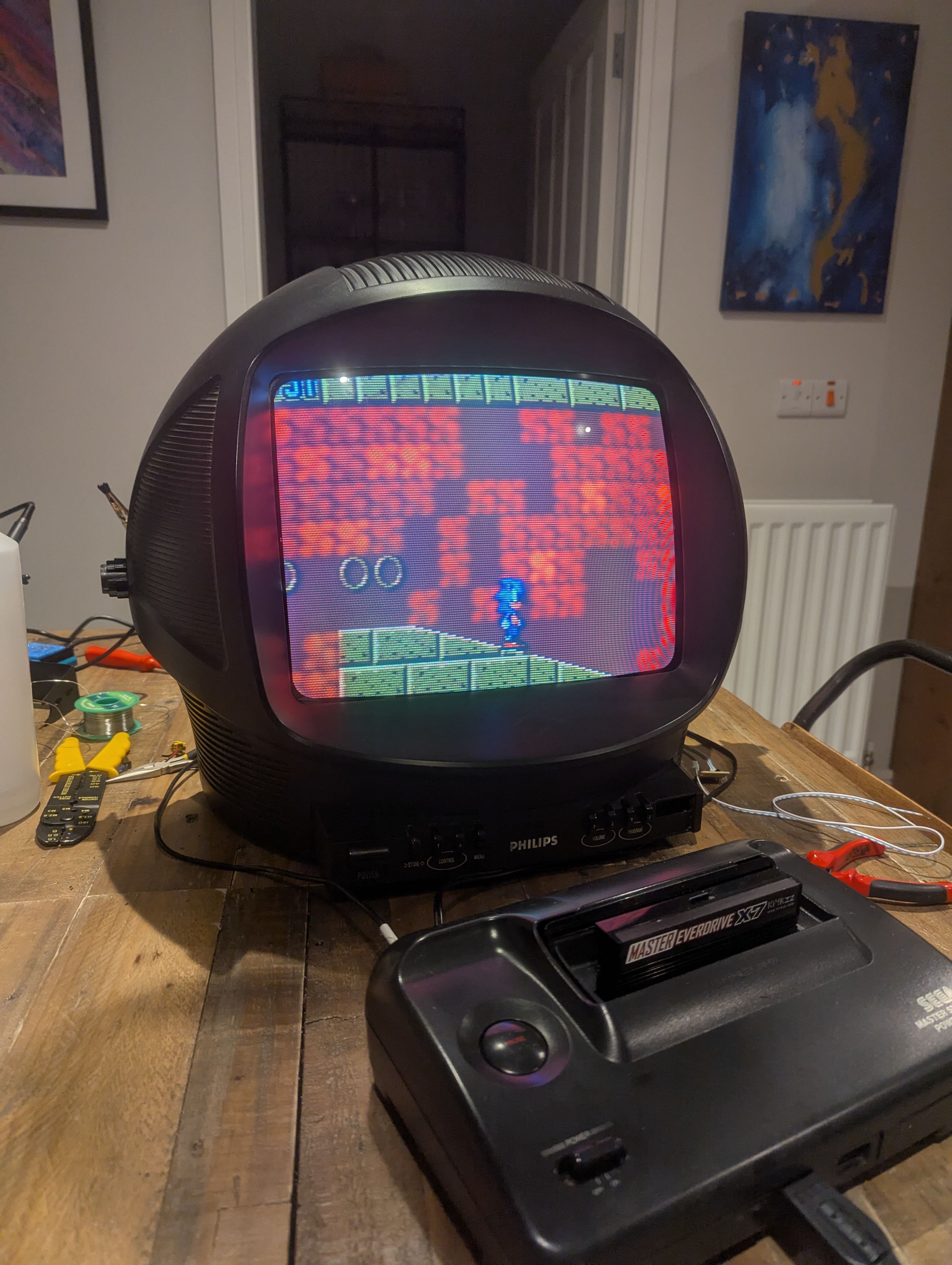

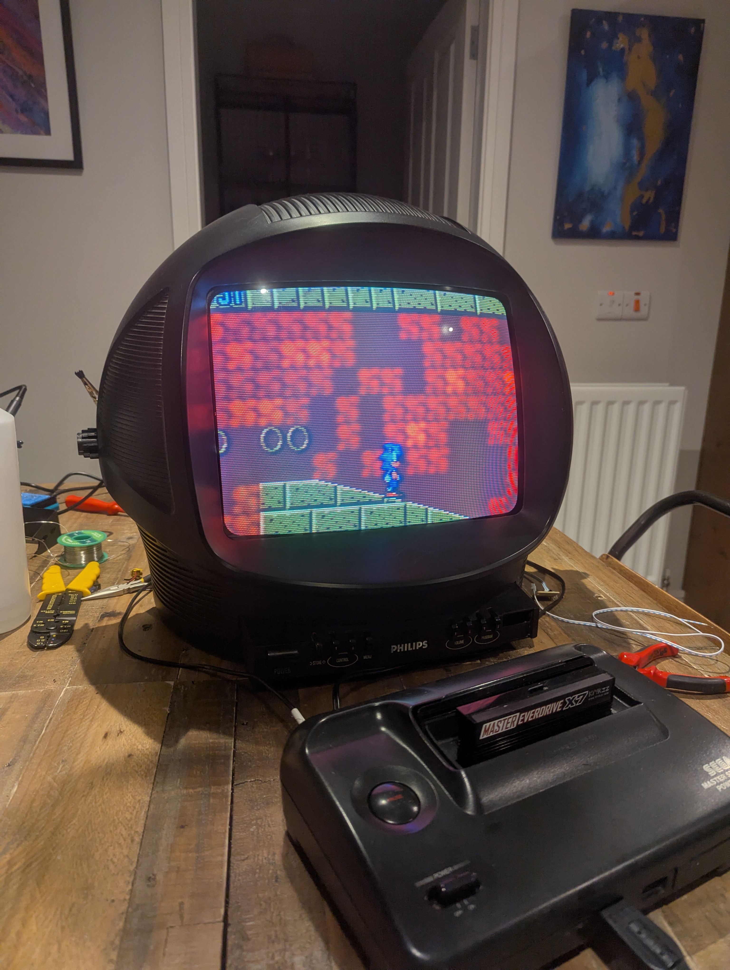

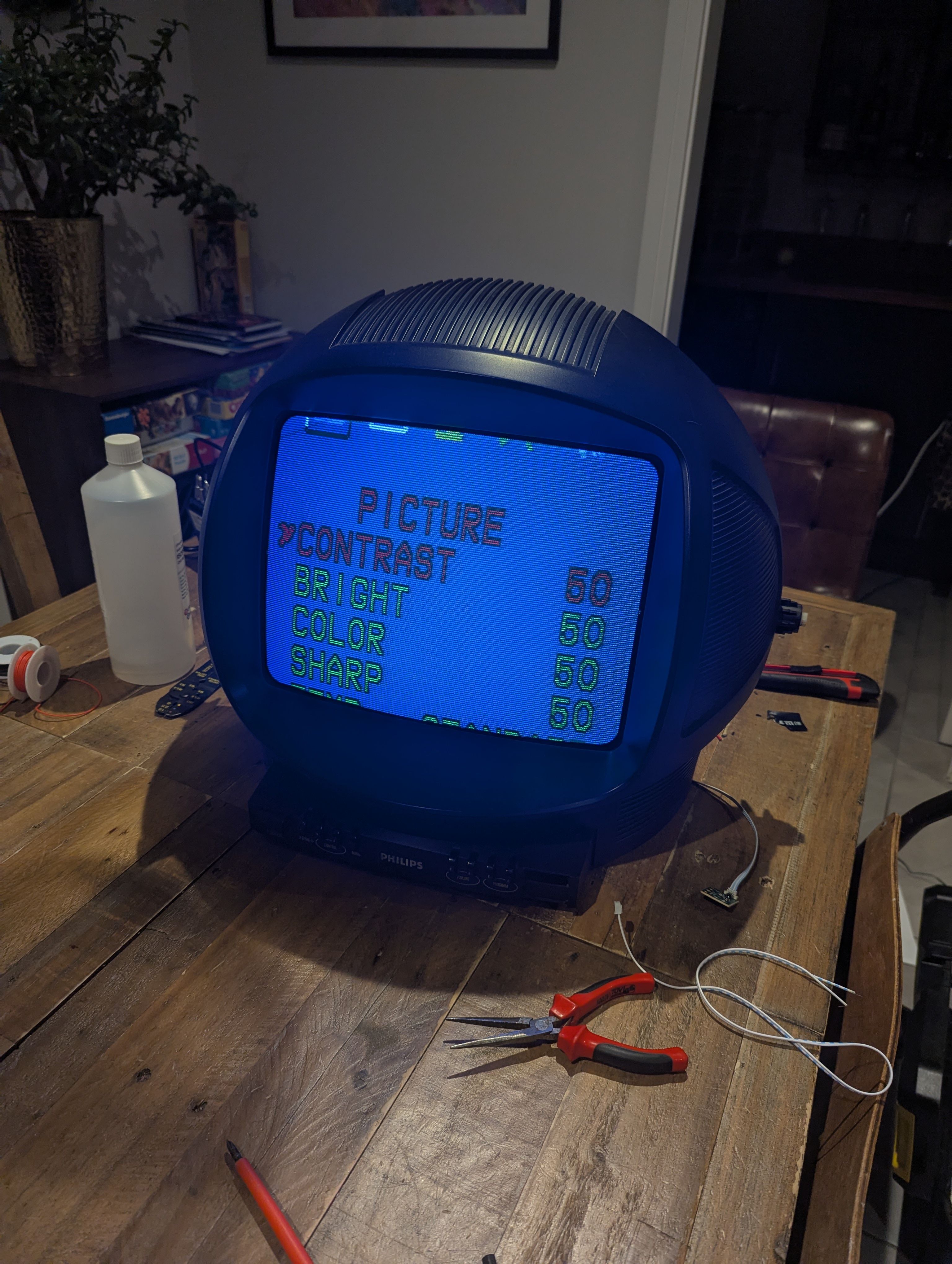

After a little extra detailing I fired up the Super Famicom for some Demons Crest, The picture quality is great and I couldn't be happier with the results.
I COULD NOT BE HAPPIER!
