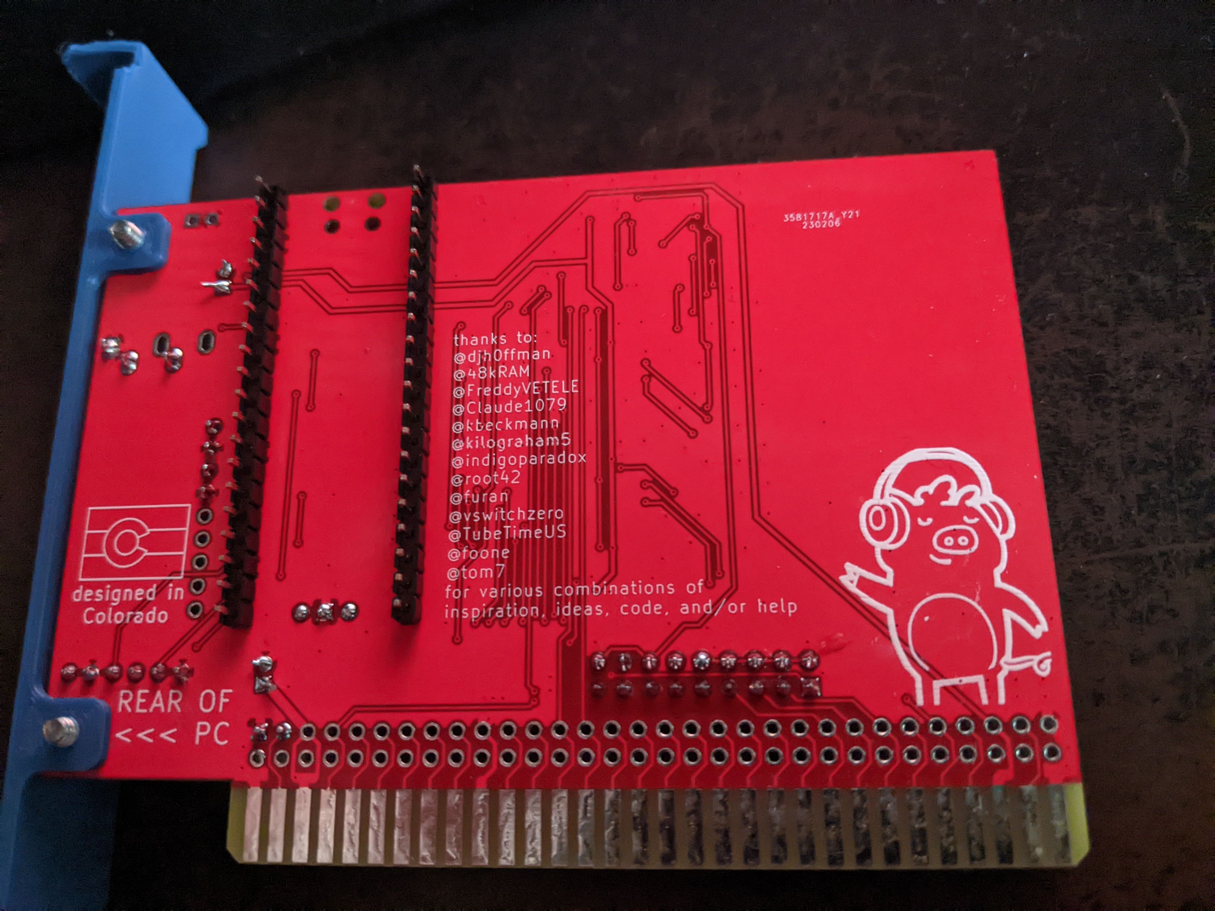

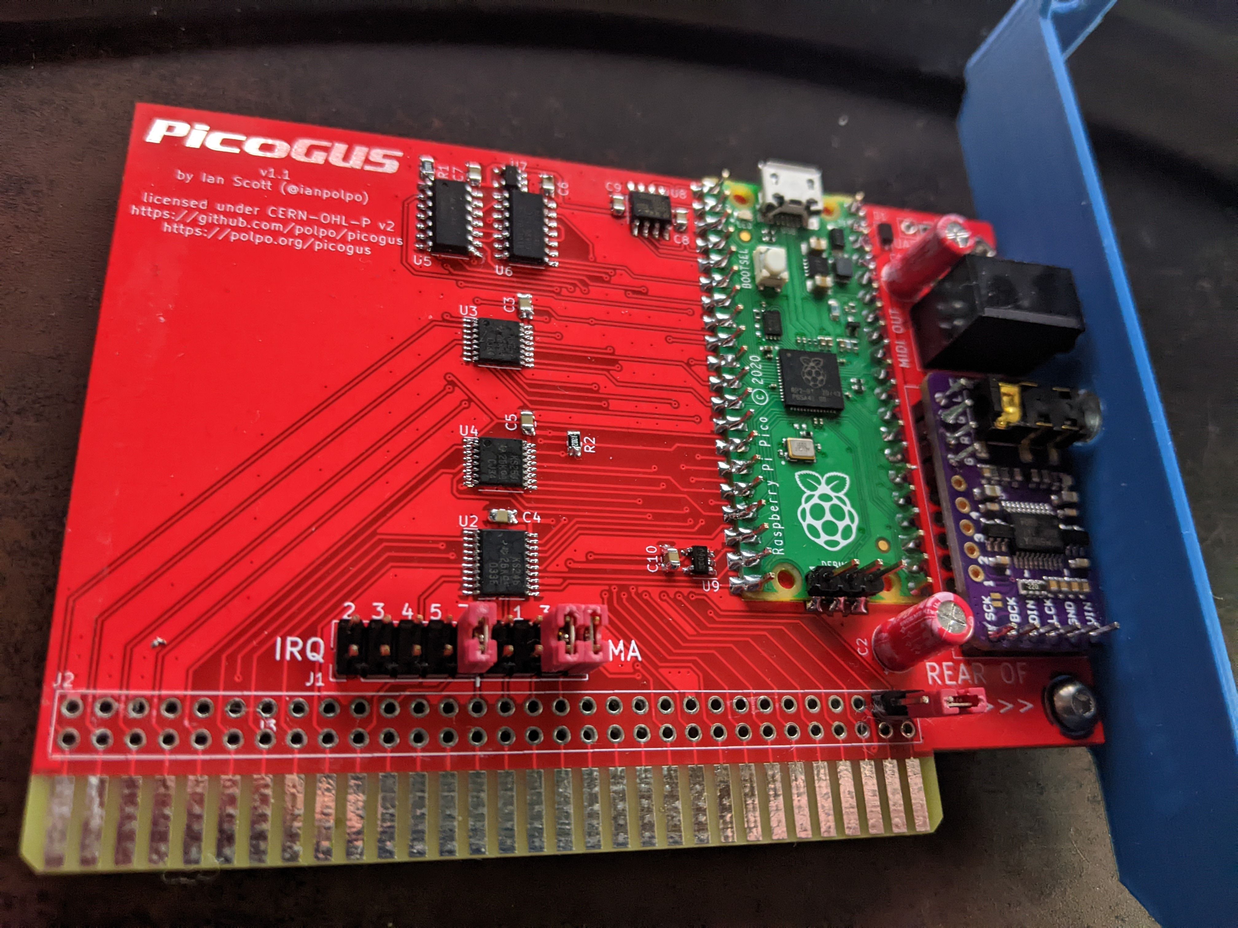

I had the PCB made by JLCPCB and ordered the mouser list found in the GitHub
Picos are NOT affected by the raspberry shortage but as I write this in March 2023, it's becoming possible to even buy the normal ones (through rpilocator, but I digress as this project is only compatible with the pico)
Here's the finished assembled product. I had the bracket be 3d printed by a friend. I had to sand down the pointy end a bit as it would not fit inside my PC case. The mouser kit does provide you with a metal case bracket, but you have to source your own M2.5 screws (iirc) and you'd have to drill down your own 2 holes for the audio port and the small midi port.

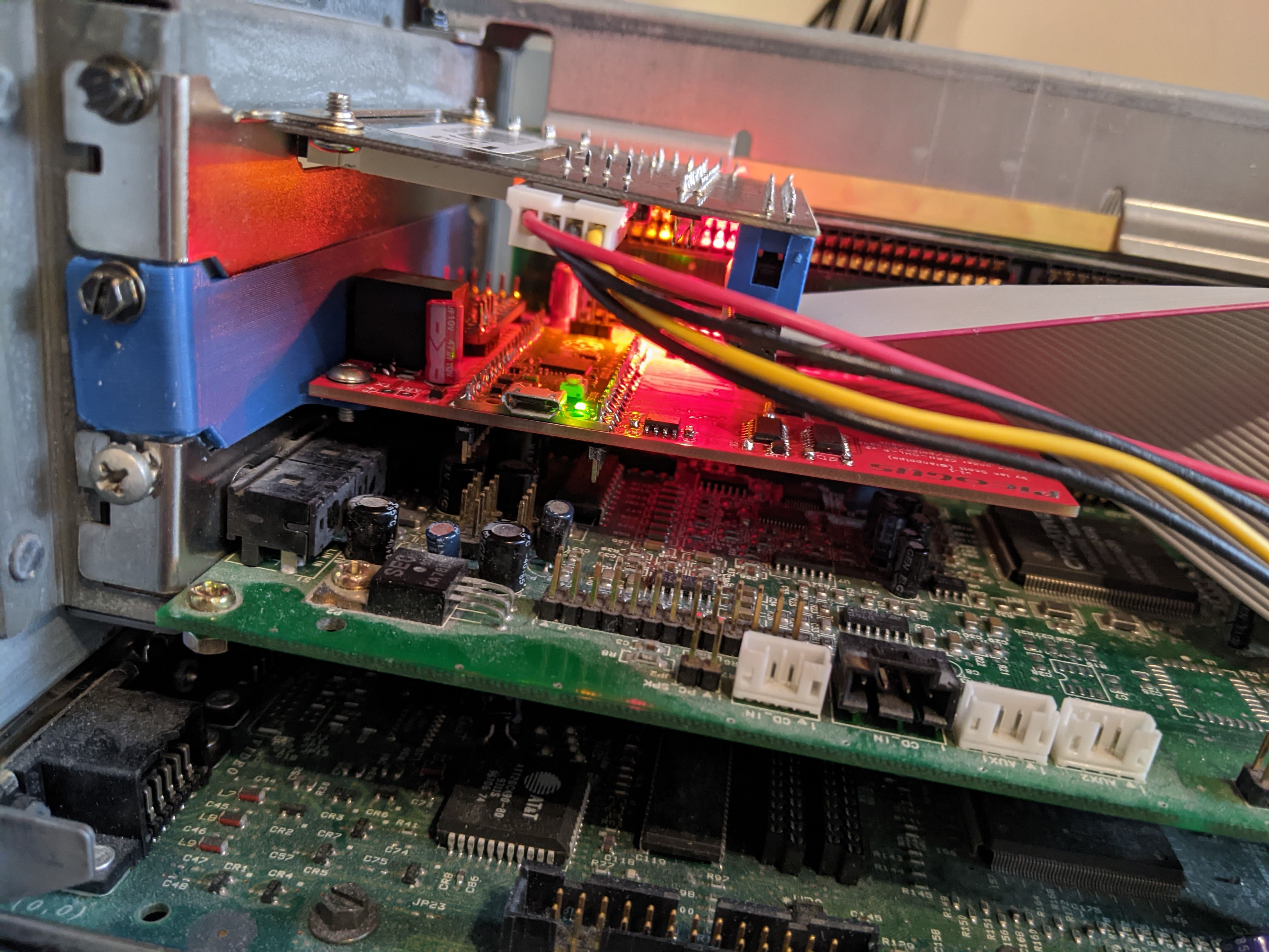

The only place I can use it in my retro gear is inside an upgraded IBM ValuePoint DX2/66 with 32 MB RAM that already had a SB16 vibra clone set at IRQ 5 DMA 1 Port 220.
Therefore, I set my jumpers on my PicoGUS to IRQ 7 DMA 3 and will set my autoexec.bat settings line with those and port 240.
The only non-intuitive step (for me) was getting the Gus firmware on the pico. I followed the steps: press the BOOTSEL button on the soldered on pico (requires a jumper that links the RESET pin to GND to force a programming mode, the guide tells you where), THEN plug it with a microUSB cable to a modern PC or other. The pico memory will show as a volume onto which you can basically only do 1 copy, after which it'll auto unmount and all is good.
I was expecting to copy several firmwares in advance (you can't) and have the files stay permanently visible when you connect it a 2nd time and on (they won't, they're consumed and then wiped).
I then proceeded to install it in my case, which is a pain to open and a heavy CRT has to be set aside...
Everything so far works!
