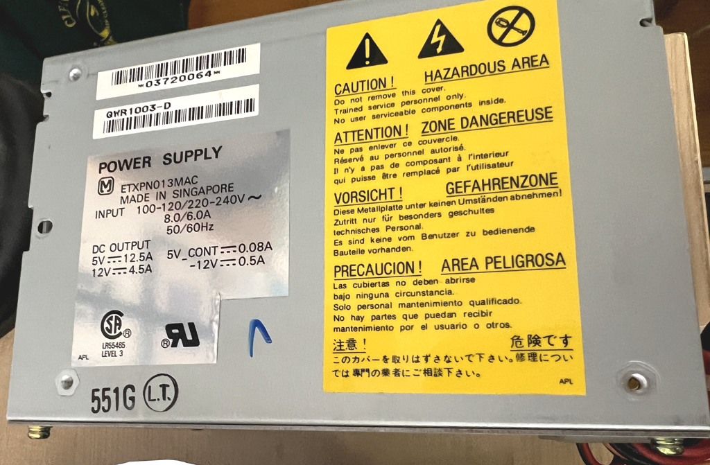

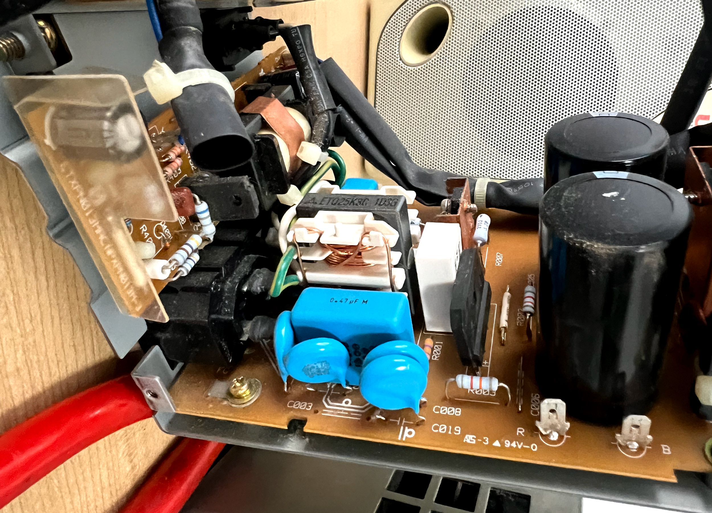

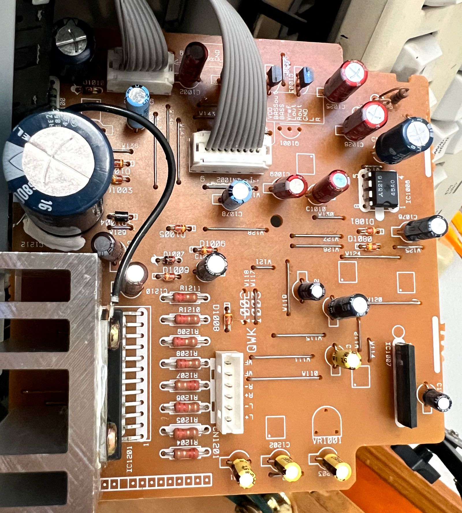

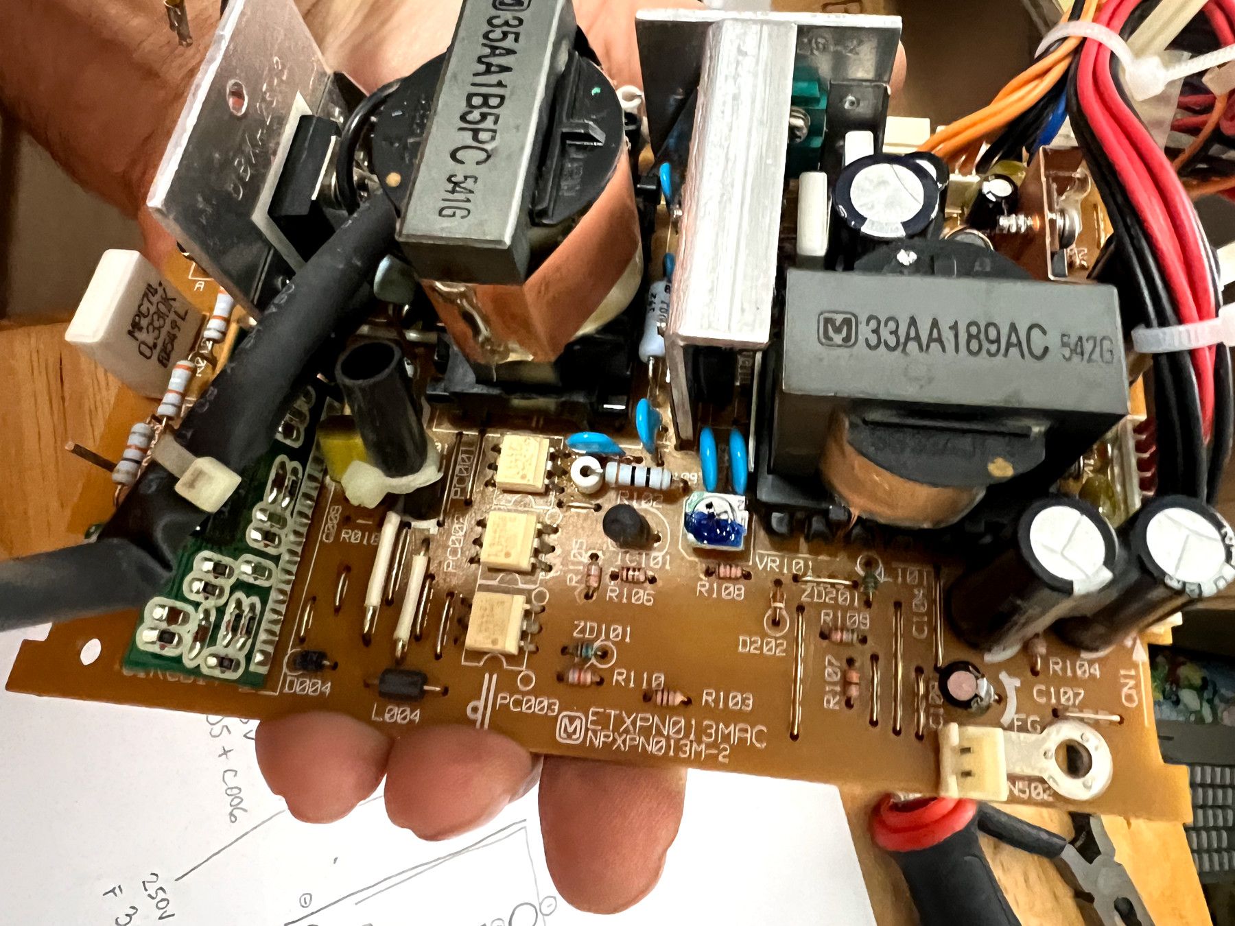

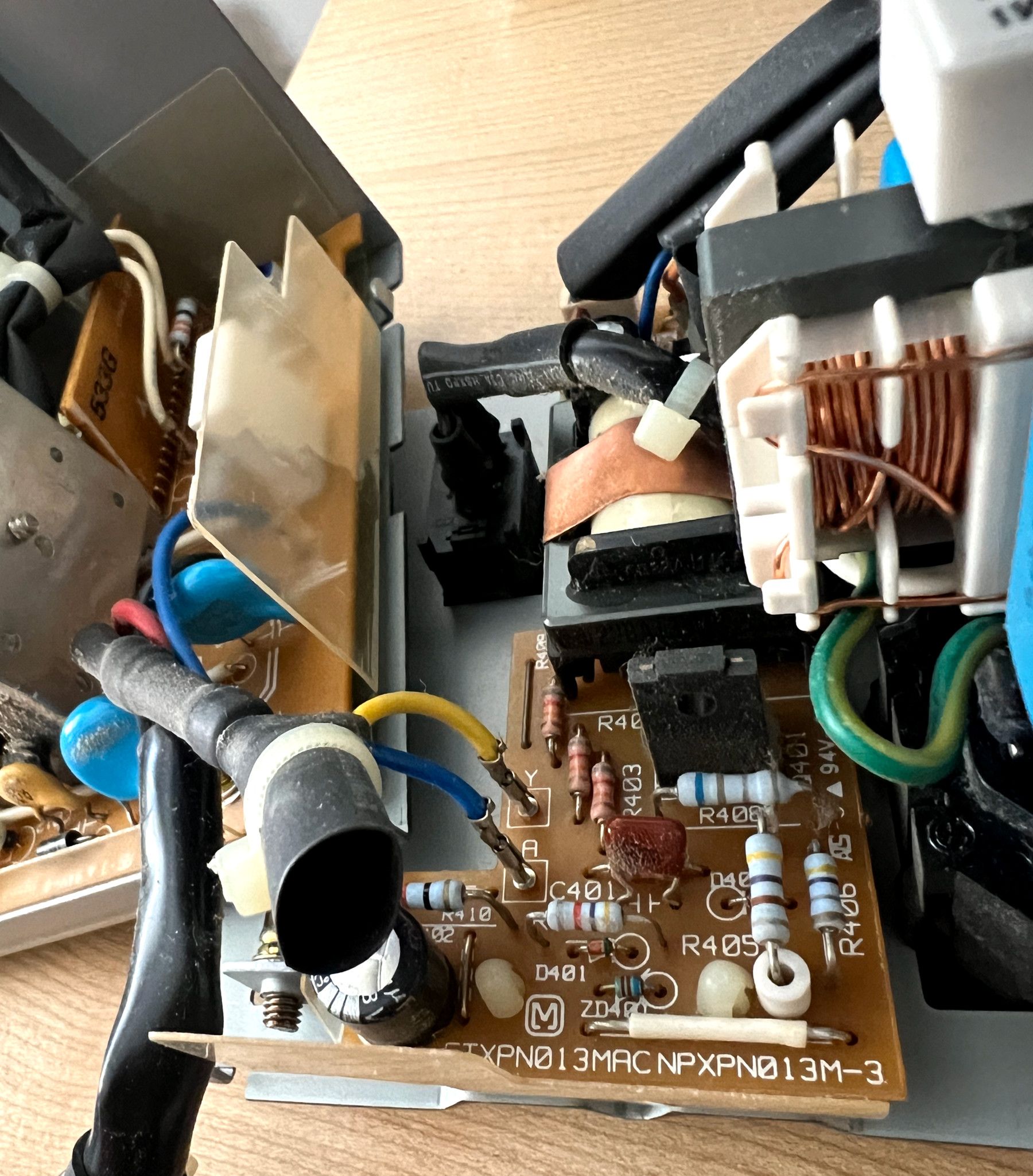

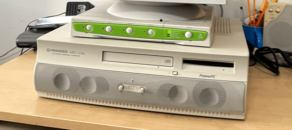

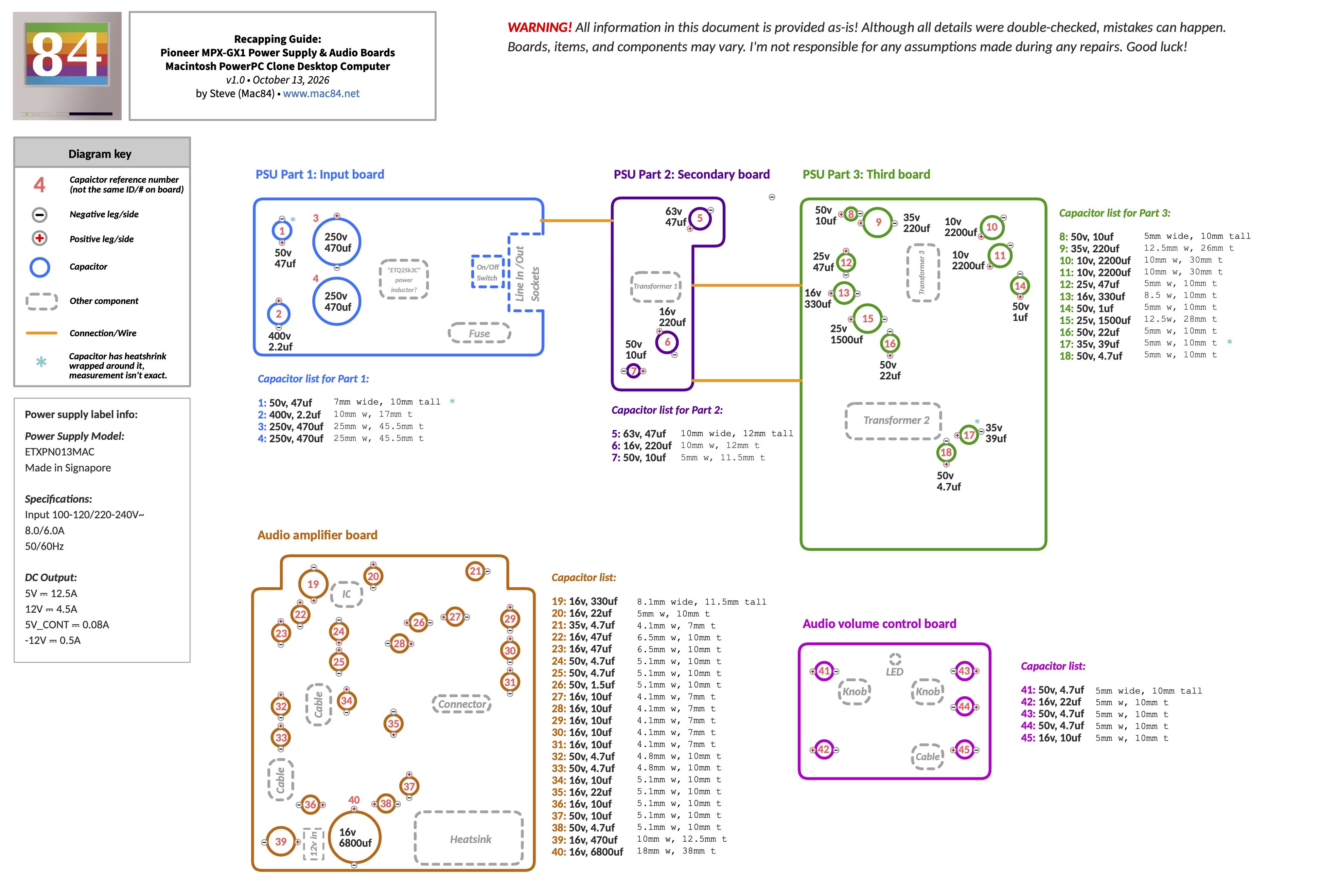

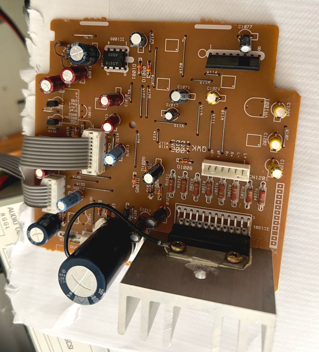

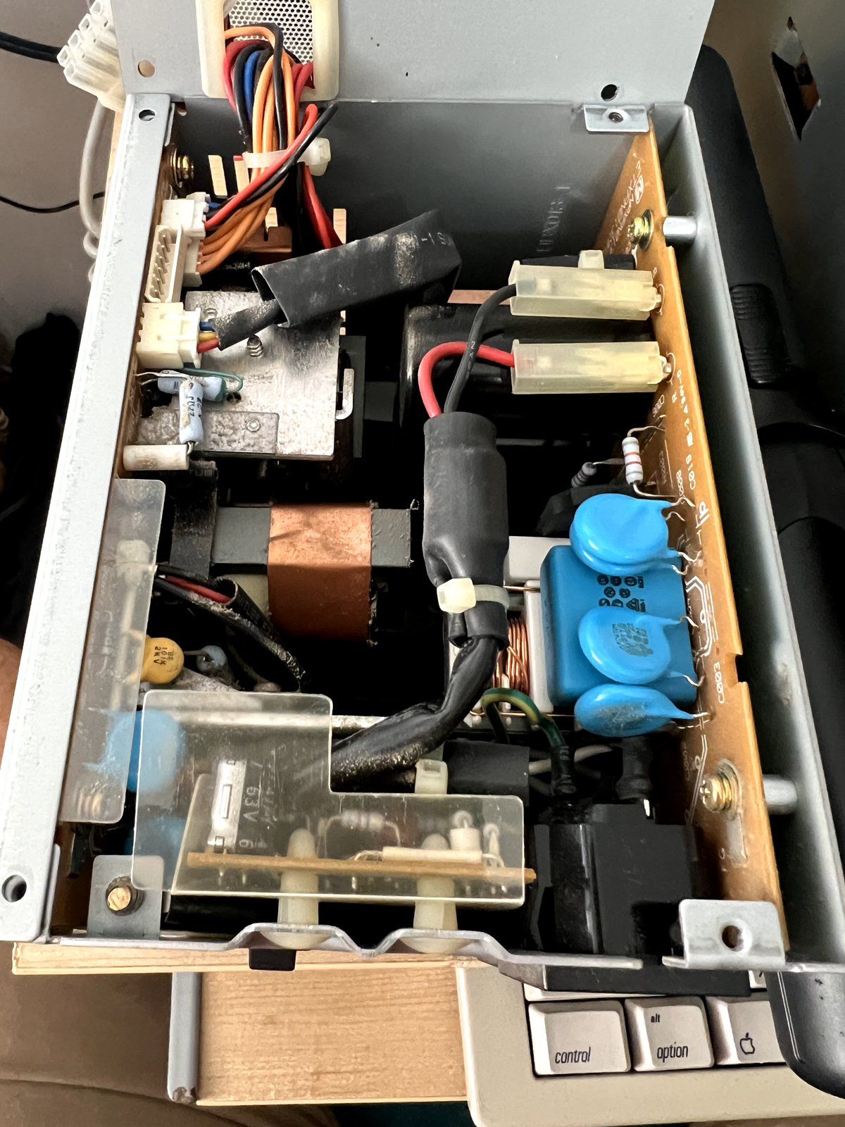

When I got my Pioneer MPC-GX1 (video here), I noticed the system needed to stay plugged in for a bit before powering on. Well, sadly today I went to plug mine in and it wasn't happy. So I ripped open the power supply and drew a quick map of the capacitors on the PSU and audio amplifier board. I also took some photos, hopefully this'll be helpful to anyone who has one of these clones!
Attached is a two-page PDF of this capacitor map and a bunch of photos of the PSU and audio amp. board.
