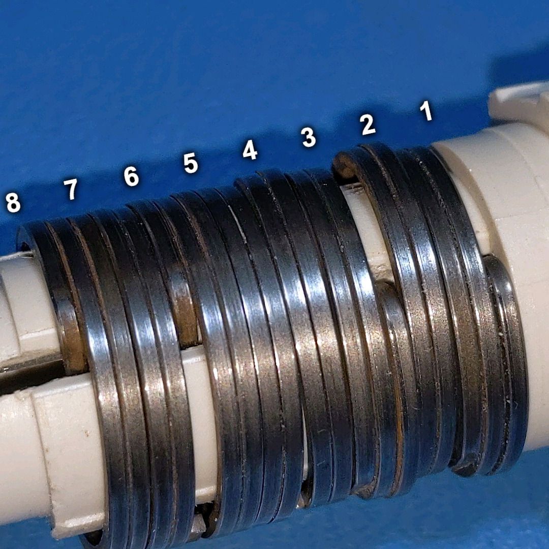

I recently restored a Mac Portable with a stuck clutch/hinge. Here's what I did to loosen it. Doing so wasn't easy or cheap but the story might be of interest to forum readers — especially a reader who owns a lathe. I don't, but I do have some Deoxit so that's what I tried first. Unfortunately, that didn't free up the stuck clutch. (It is compatible with polycarbonate plastic but do read the manufacturer's advice about this because there are some provisos.)
So I dissassembled the clutch completely then lubricated it with Super Lube. Disassembly and reassembly are very difficult and fresh lubricant didn't resolve the friction problem. So perhaps the real cause of the problem wasn't dry grease but abrasion of the plastic surfaces inside the clutch.
Unfortunately, the plastic cylinder that grips the clutch springs got gouged when I forced the springs back in. And that isn't the only hazard when attempting this — the springs can be deformed when they are dragged in or out of the housing.
So I can't recommend disassembling these clutches. At least, not without some means of compressing the springs for reinsertion. A special tool, maybe something like a small piston ring compressor, might work. Also, a puller might help with sliding the springs straight out of their housing.
In one of his videos, @techknight mentioned a possible solution for stuck clutches, which was to permanently remove a few of the springs from each clutch. So that's what I did. But this introduced a new problem. The missing springs leave a gap and the remaining springs now have room to expand by tilting over. The square corners of a tilted spring then bind with the bore of the plastic cylinder. So they got stuck again.

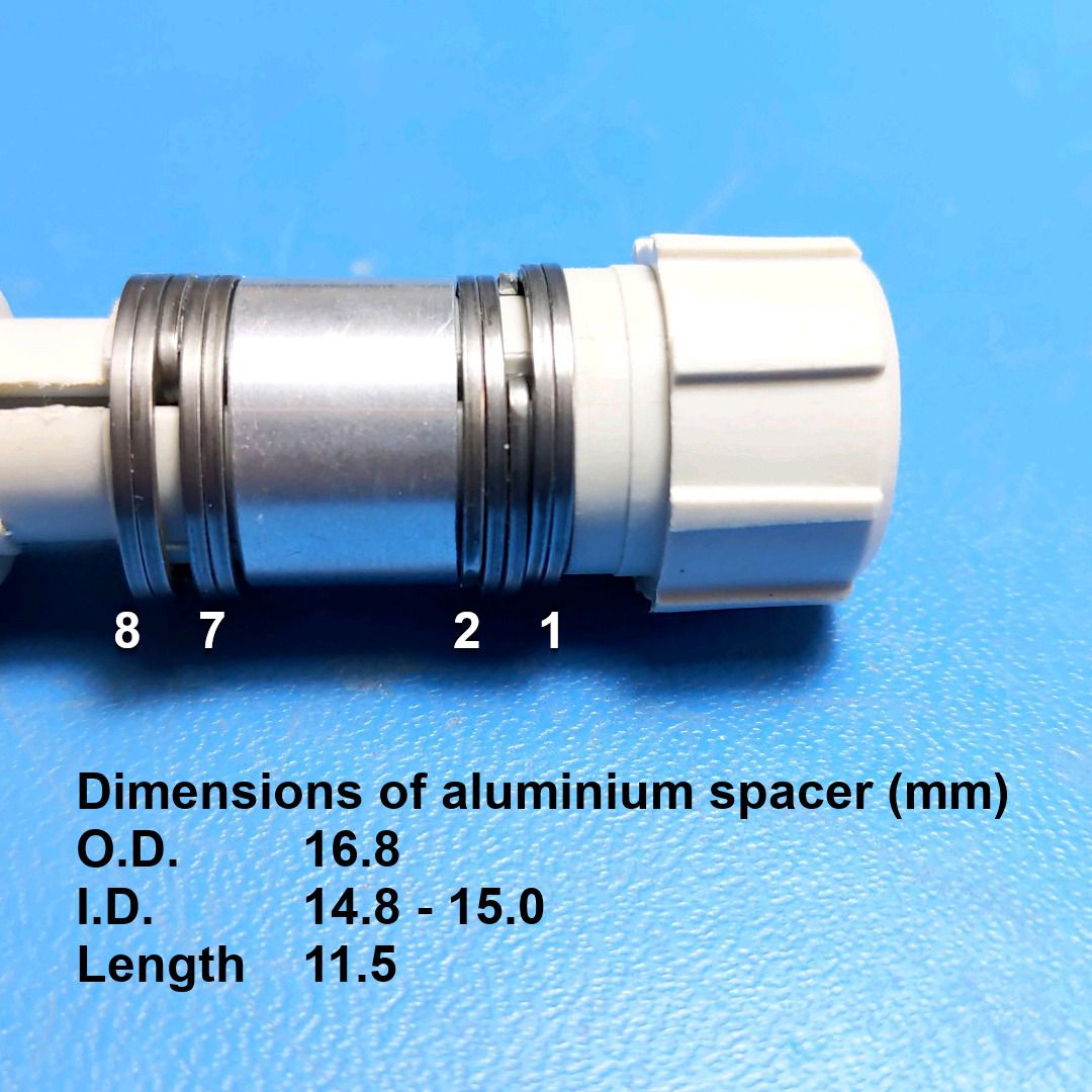

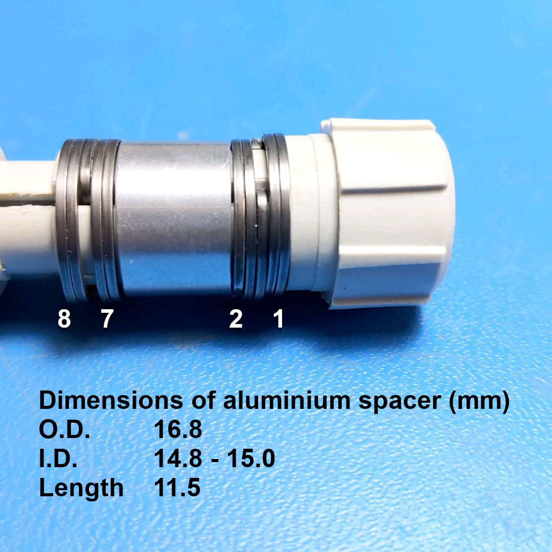

In the end, I paid a machinist to turn some spacers from aluminium to fill the gap. That did the trick. The resistance in the hinges is much lower now. There's still enough friction to hold the screen up.
In each hinge, four springs were removed from the middle of the shaft so that the arrangement remains symmetrical. The end springs do exactly the same work as the middle springs; two resist opening and two resist closing. In theory, friction is halved.

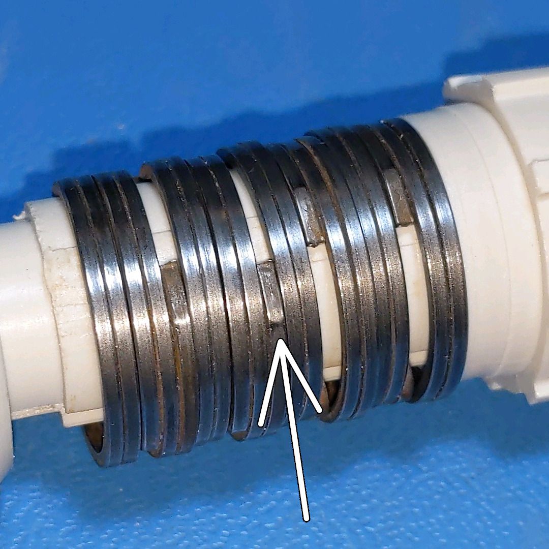

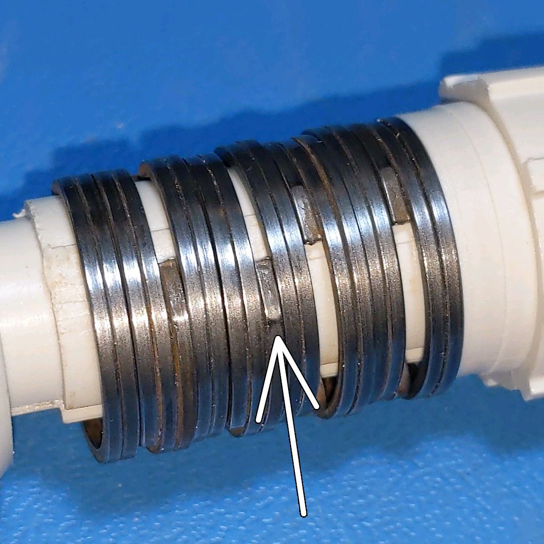

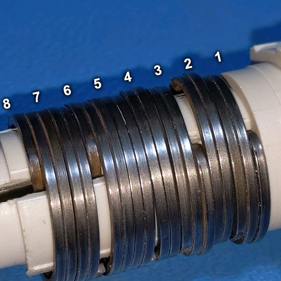

All springs are identical except that their free lengths vary significantly. Some are so short that the trailing end could catch on the ridge on the hinge shaft (indicated with an arrow in the photo). If it did so, this would add to the friction problem. So when I reassembled each hinge, I selected the four longest springs and left out the short ones.
Was it worth all the time, effort and expense? Probably not. From a cost stand-point I should have bought a replacement. But maybe this experiment is helpful to someone. Maybe there's an opportunity here for someone to manufacture new clutch housings from metal instead of plastic. Or re-bore the original plastic part and fit a metal liner. I don't have the tools for that, nor do I have the time, but perhaps others do.

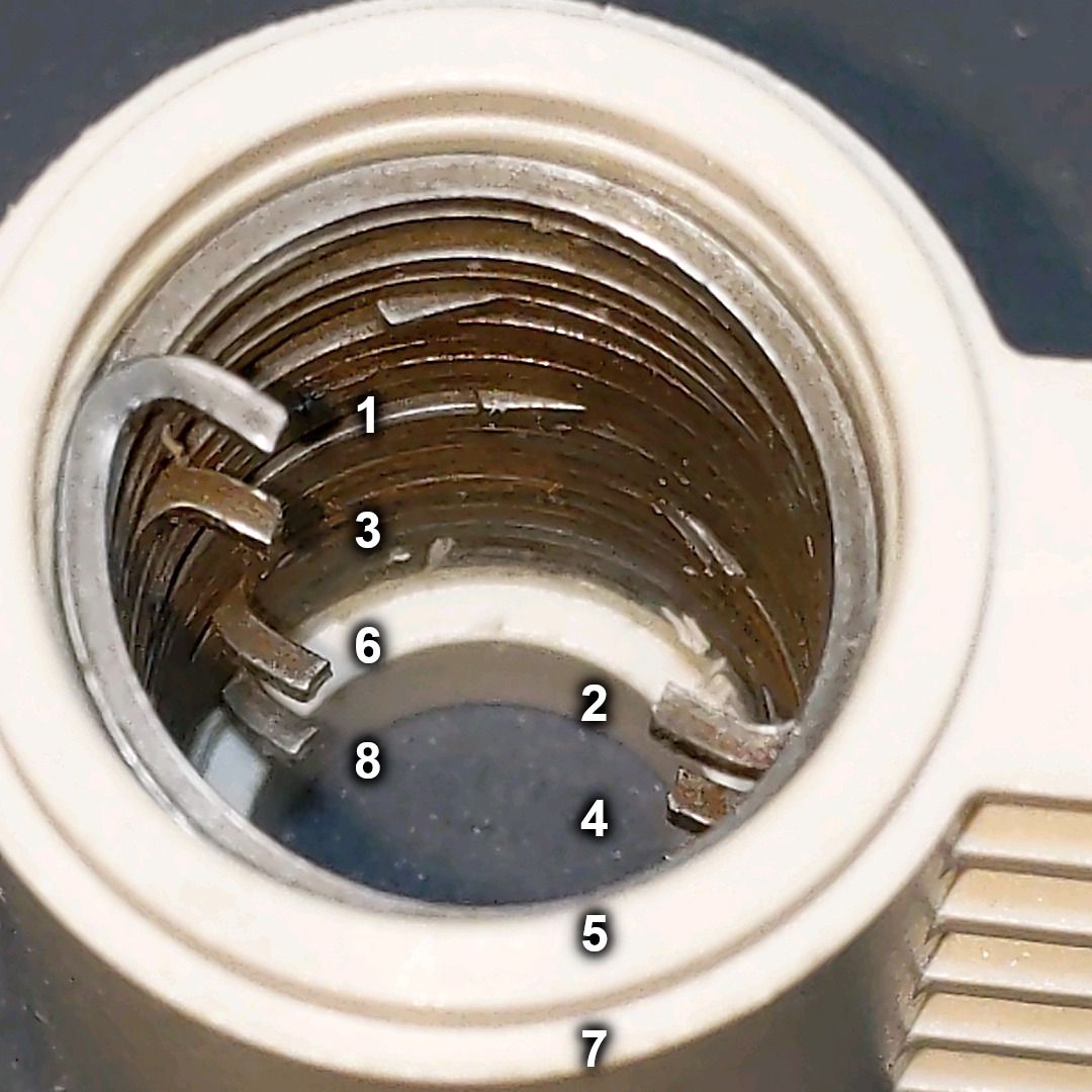

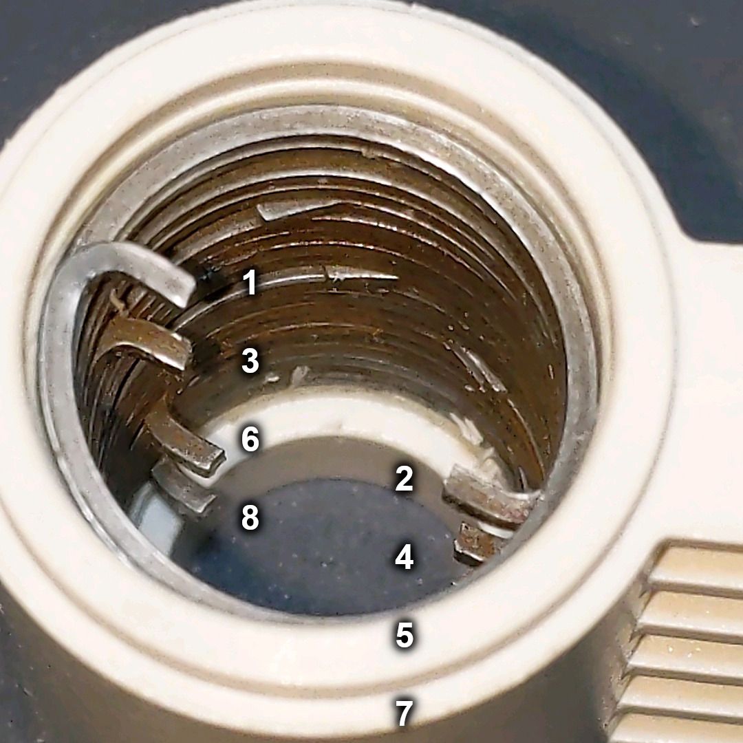

Anyway, if you look again at the photos you'll notice that the springs form a helix, a bit like a left-handed screw thread. Now, if you grasp spring 1 by the hooked end and twist in a clockwise direction it loosens and can be pulled out because the spring diameter reduces. But if you twist spring 8 in the same direction, it would just tighten against the housing because the diameter would enlarge. That's because the only way to grasp the silly thing is by its hooked end and some springs are up-side down. So you need to examine each spring to find out in which direction it wants to be pulled. (At least, they are up-side down in the photo, and I'm fairly confident that the photo reflects the factory cofiguration...)
My advice is, don't disassemble it if you can't see a way forward because if you succeed, you'll find that reassembly is even more difficult. And both stages involve some risk of damage.

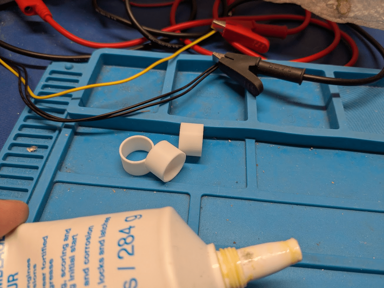

Is it possible this can be put into an STL for 3D printing? Perhaps that spacer could just simply be ran with PLA.
fthain
May 7, 2024
I think it's mostly a question of compatibility with the grease — if a plastic tube broke down or turned sticky that could be a problem.
I don't know much about 3D printing. Perhaps it could help with tool-making. A spring compressor made from thermoplastic would seem impractical as the compressed spring has to slide out without grabbing. But maybe a print can be made from inelastic material.

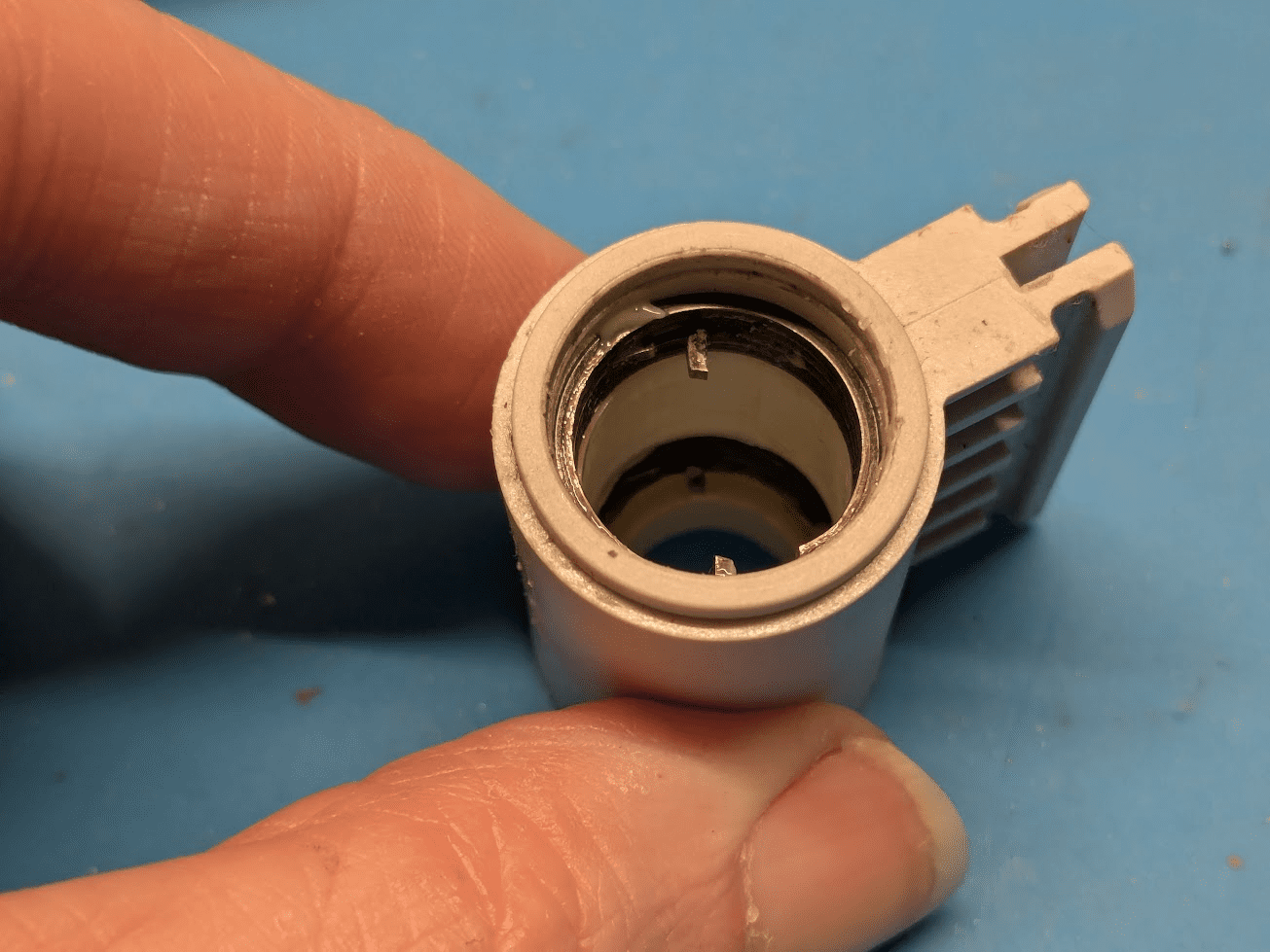

Fair point, ive always put the springs back in manually and then slid the clutch in. But, if you divide the springs the way you have, then yeah that sleeve has to pull out the other springs or it wont slide out.
The idea I had was bunch up the springs at one end and put the sleeve on the other end. Idk how that does mechanically yet though as I am NO mechanical engineer.
That's what I did too but I wasn't happy with the result. Small plastic shavings ended up inside the mechanism when I tried this. I think a tool like a spring compressor would avoid scraping bits of plastic from the rim of the cylinder when forcing the springs back in. Alternatively, maybe cutting a chamfer on the rim would be sufficient. That would require a lathe though.
