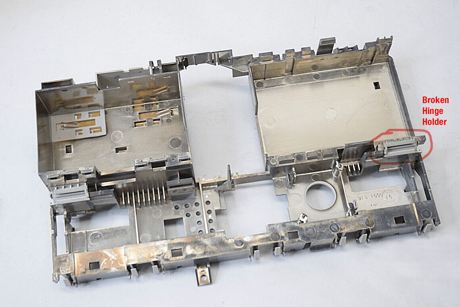

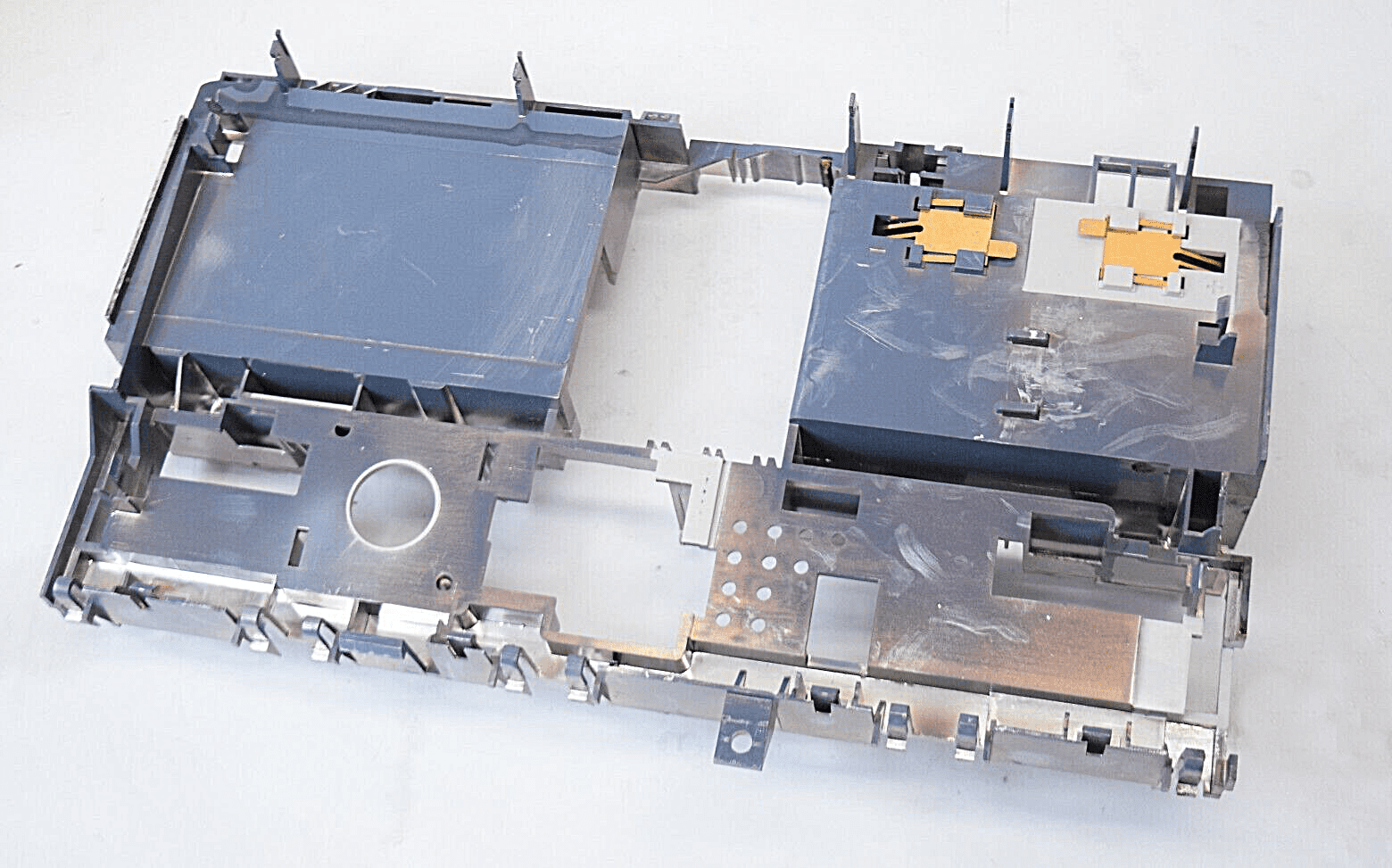

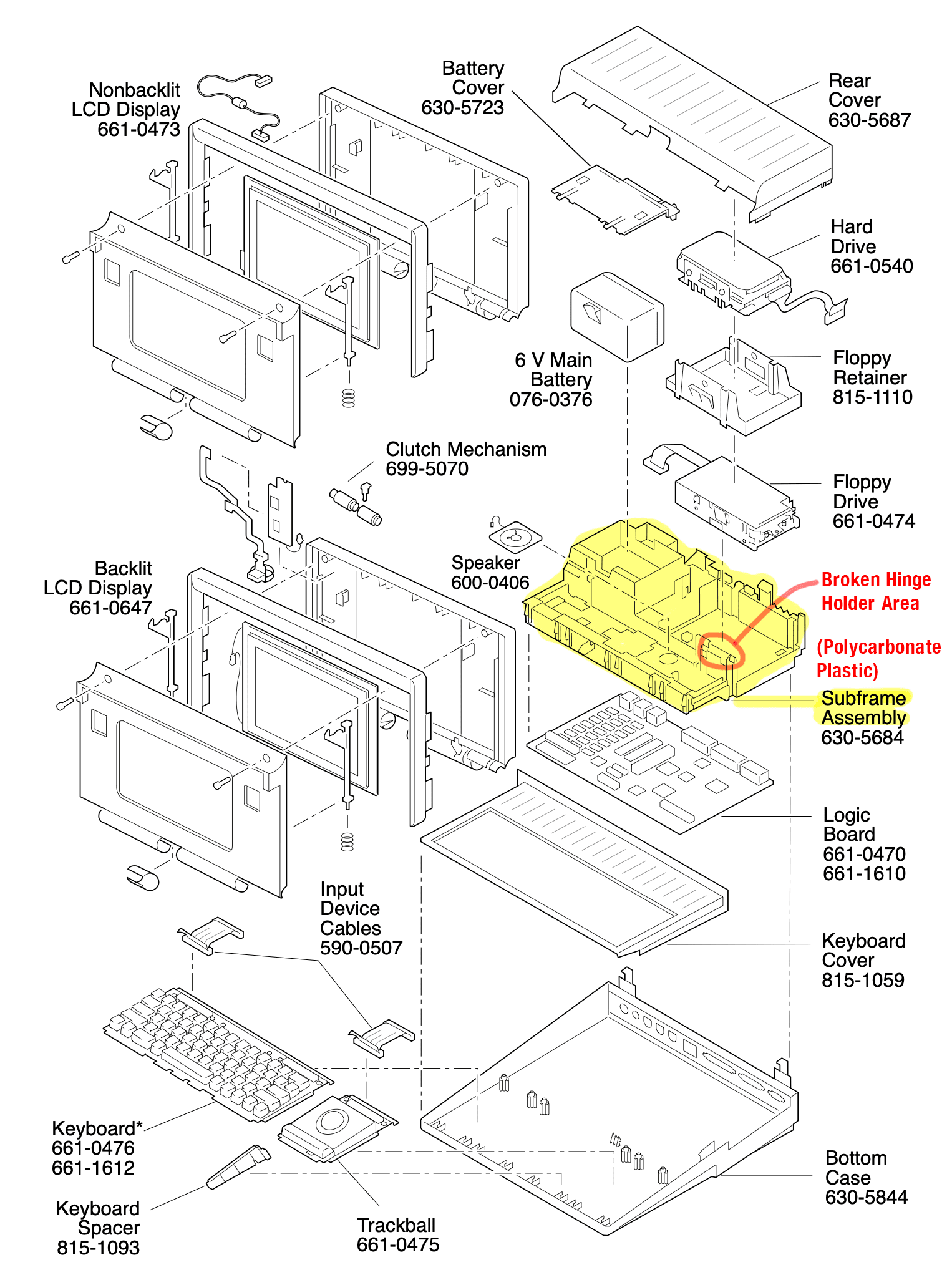

Is this portion of the chassis removable - a subframe?
Yes.
TOP
BOTTOM

is this a common problem? I’ve not heard of it before.
One other person in this thread has the same exact problem. And @techknight has a recent video (mentioned earlier in this thread) showing a Portable with the same cracked hinge holder too. That means there are likely others out there.
Sadly, many Portable owners seem to be hibernating, Stephen. For example, I have tried REALLY hard to get a peep out of the folks in the Mac Portable FaceBook group, but it's like pulling teeth.
Gone are the days of DanTheAppleMacMan on EBAY who often sold Portables. Those guys were really knowledgable and would provide quick answers and feedback, but I never owned a Portable back in those days.
Seems like most Portable Owners these days never use the machines and simply have them in a closet.
Well, I've been working on a video about my Mac Portable for more than a month now, and once that video goes out, I suspect there will be renewed interest. And when people see my crack (ha ha), some may chime in after checking out their own machines.

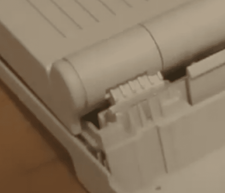

What I can tell you is that hinge takes a lot of pressure when you close the LCD. A lot! The crack closes when I fully open the LCD. But if I put my thumb and all my might on top of that cracked hinge, hoping to keep it pushed closed while I close the lid... well... that's utterly impossible. So yeah. The lid puts THAT much force on the hinge! It's pretty crazy Apple chose to make it out of something other than metal. Even Portables with that hinge holder intact are ticking time bombs, in my opinion.
Also, when I first got my portable, there were other tiny parts that had broken off that subframe. None were critical. They were just tiny tabs. I was able to get them back on with superglue and they continue to be attached today.
It's because there is so much stress on that HINGE HOLDER that I have taken huge pains and a lot of time trying to figure out how best to CHEMICALLY WELD it back together. But tiny air bubbles compromise the strength of the bond a bit. DCM is better than superglue, by far, but not as strong as the original unbroken part.

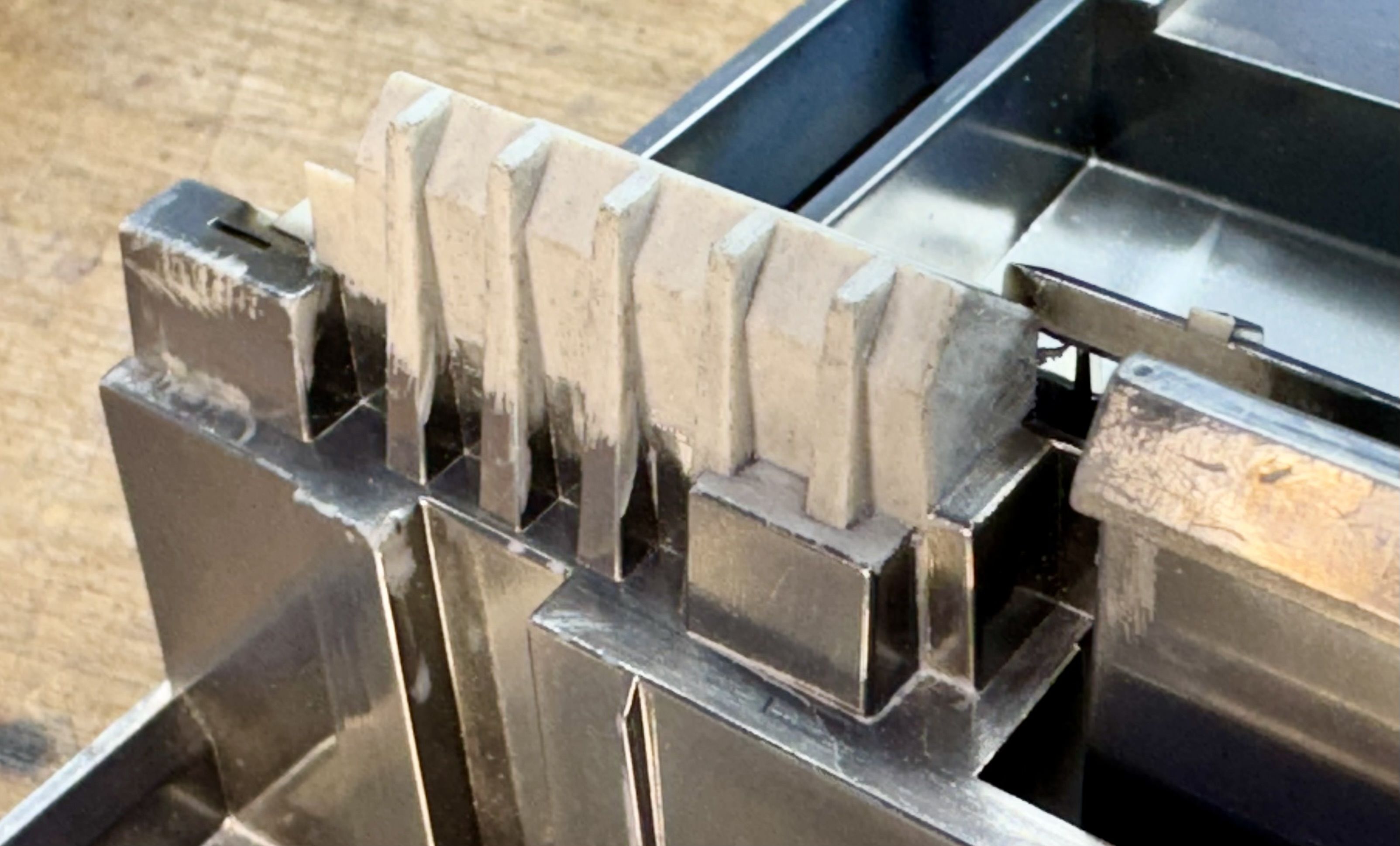

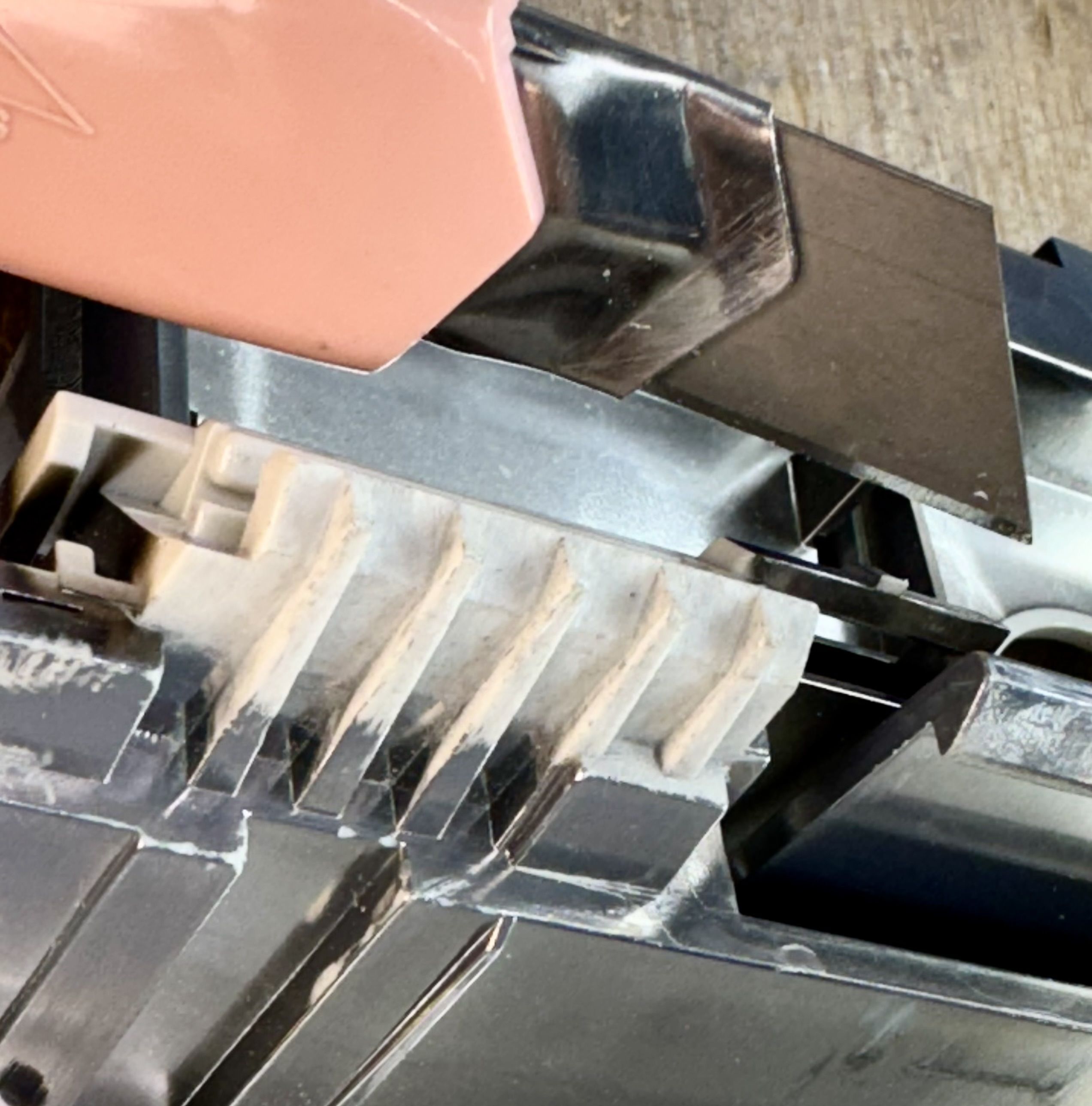

I finished stripping off the chrome paint by hand using mostly a box cutter. I did the sides of the ribs too.
My plan was to use DCM to solvent-weld the transparent polycarbonate piece to the back of the ribs and then after that stuff JB weld (original 24-hour cure) down in between the ribs. But I can’t fit a toothpick anymore than you see in the photo below, so I realistically wouldn’t be able to stuff JB weld deep down in there at all.
So I’m wondering if I should solvent-weld that transparent polycarbonate piece to the back of the 5 ribs and just put JB Weld at the top and sides, or forgo the solvent-weld and transparent piece altogether and just put JB weld all across the ribs.

Tape some paper to the side of the metal drive bracket, install the metal drive bracket, and stuff JB Weld between the fins and the metal drive bracket.
The paper should stop the JB Weld from sticking to the metal drive bracket?
Instead of paper, use a thin metal plate? Something less thick than the polycarbonate so more JB Weld can be stuffed in there.
This assumes that installing the floppy drive and the hard drive doesn't require the void between the fins and the metal drive bracket.
#46
Check the distance between the top of the fins and the rear cover when installed to see if there's room for some JB Weld above the fins.
Some playdough or similar material (putty) might be useful for testing clearances. If it's not too sticky, can be squeezed into shape and can maintain its shape after being squeezed.

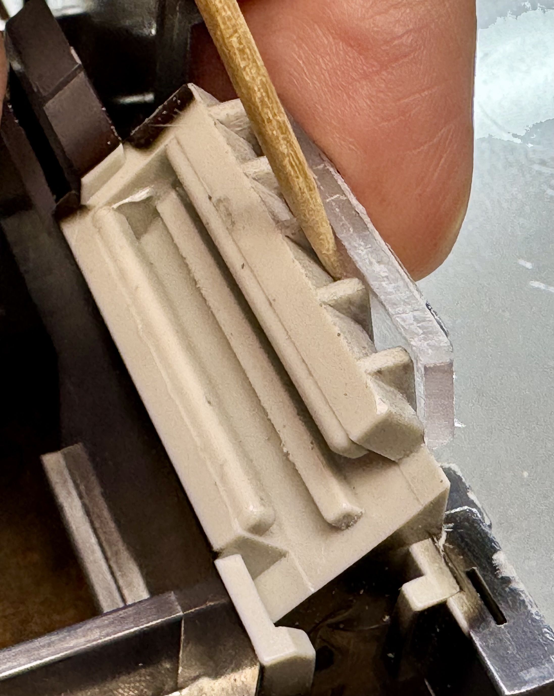

Well, I'm actually glad to hear you feel "it's a toss-up" because I already DCM solvent-welded the transparent piece to the back of the ribs today on my lunch break. :) I will shoot some photos for you this evening after work.
The only thing I've not yet decided is if I want to drill in order to add self-tapping screws BEFORE I apply any JB Weld. THAT is the question in my mind right now.
You would need to drill through the transparent piece and the plastic of the subframe?
The alternative to drilling or cutting is melting. Heat a metal pin (with soldering iron?) sufficiently that it can be inserted into the plastic. Is that possible? Will the hole that is created snuggly hold the pin or will the hole grow in size or deform the plastic? Beware of fire, toxic fumes, burning, and damage. Maybe the pin will be too thick to be inserted (i.e. too much plastic will need to be displaced)?
Maybe test in a safe area of the subframe the drilling or melting methods.
I've seen videos of 3D plastic prints where a metal standoff or nut is heated with a soldering iron and inserted into holes in the 3D print that are slightly smaller than the standoff or nut but what if there's no hole to begin with?

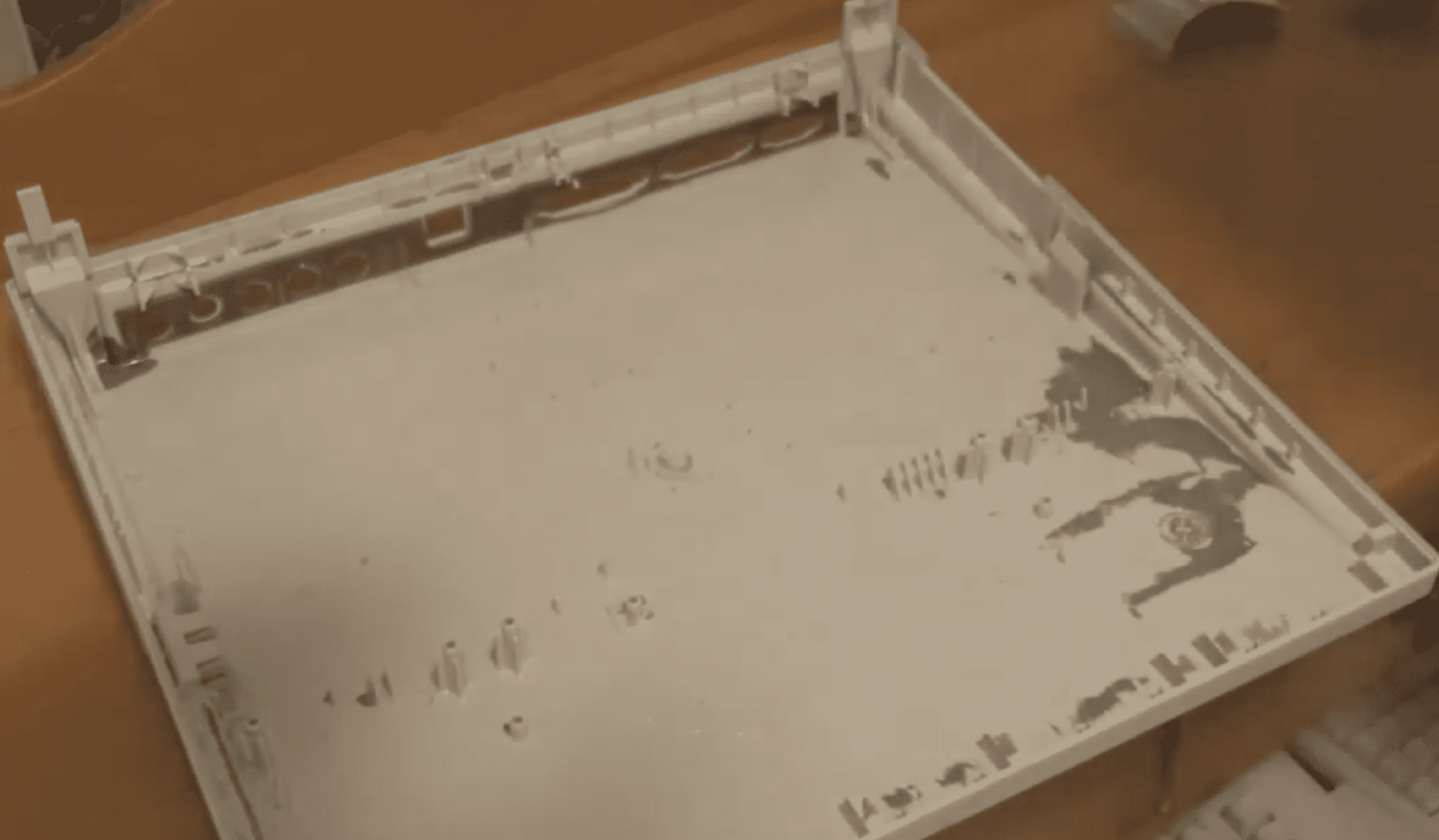

Holy cow, I just noticed that Jason has a cracked right hinge holder too! Have a close look at his ribs, which are mostly missing in the middle!
SOURCE VIDEO
What's even more fascinating is that his machine doesn't have any of that chrome paint at all! Wow.
Later in that same video, it seems clear the chrome paint was removed somehow, although not an entirely perfect removal job...
I noticed that Jason never removes the LCD from the subframe assembly, which implies he may have fixed his right-side hinge by PERMANENTLY epoxying the cylindrical hinge to the hinge holder, just as TechKnight did in his video.

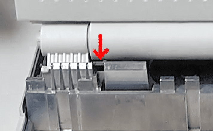

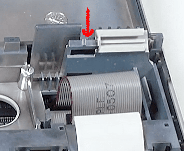

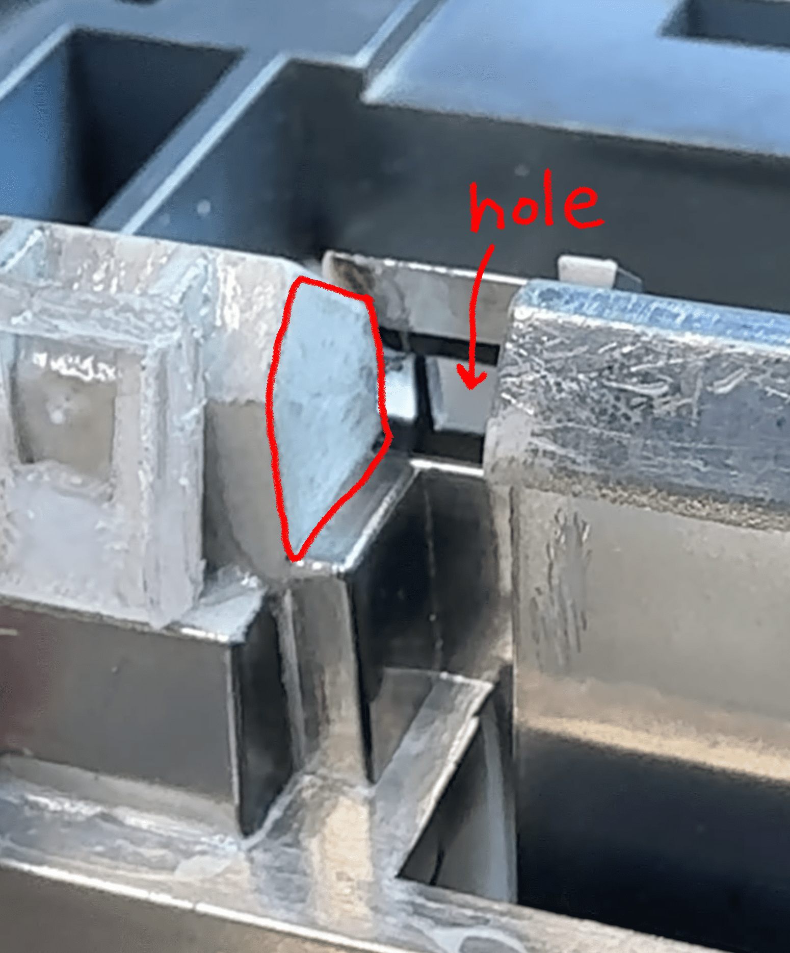

Anyway...
As I mentioned in the video I posted about a half hour ago, the little piece of plastic that looks like a latch of some sort actually serves no purpose at all that I can see...
Nothing seems to fit inside it.
What that means is I could put a clump of JB Weld on the left side of that rectangular hole without worry it will block the hole, since nothing apparently goes through that hole!
