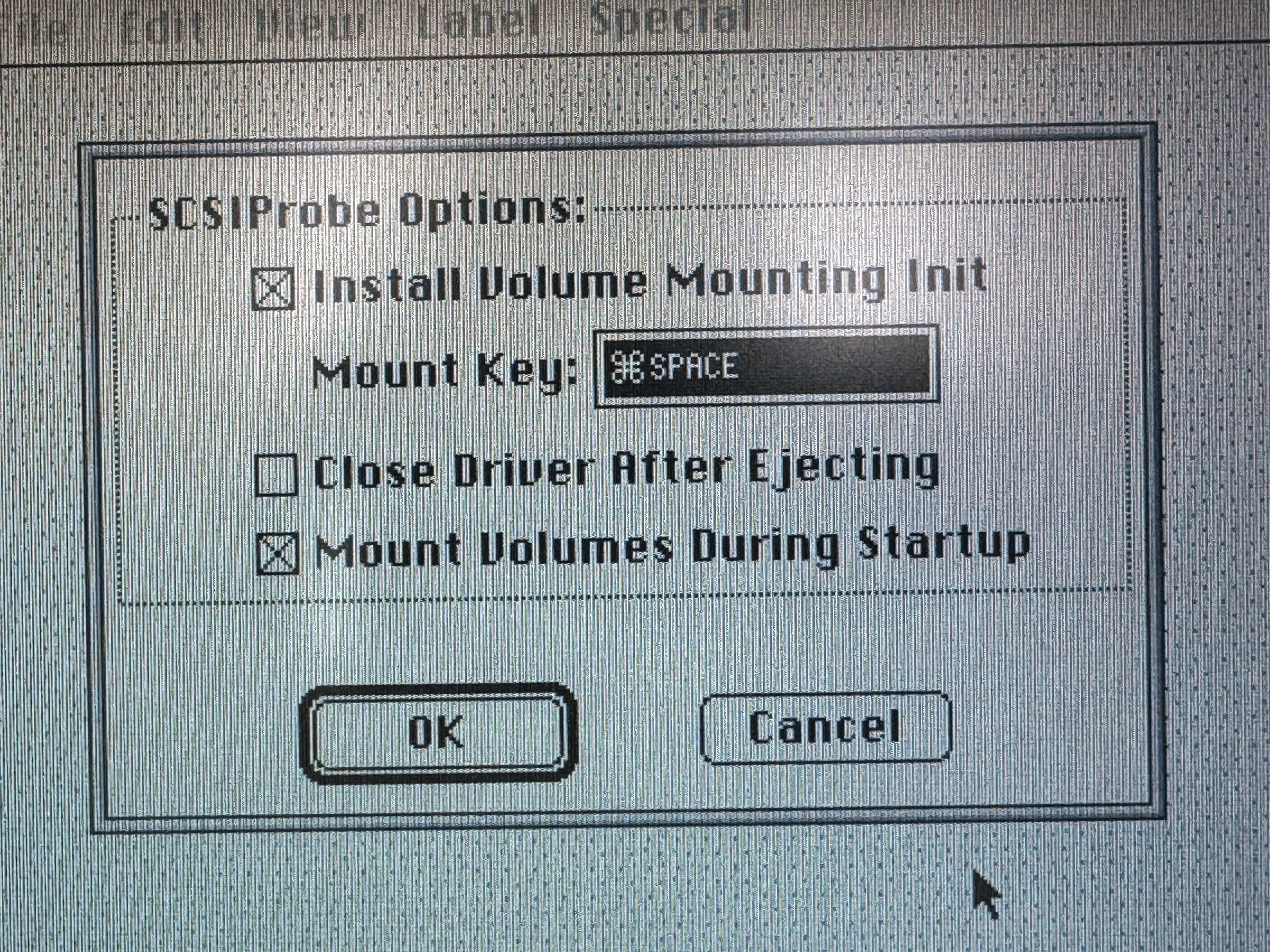

What I did instead was put SCSI Probe into the Control Panels folder, open it, click Options, then tick these two checkboxes:
Upon reboot, both drives mounted just fine. It seems to be a good solution to the problem. I only tested in S7.1, but I suspect it will work in 7.5.5 and 7.6.1 too, which are really the only other version of MacOS I can run on this machine.
