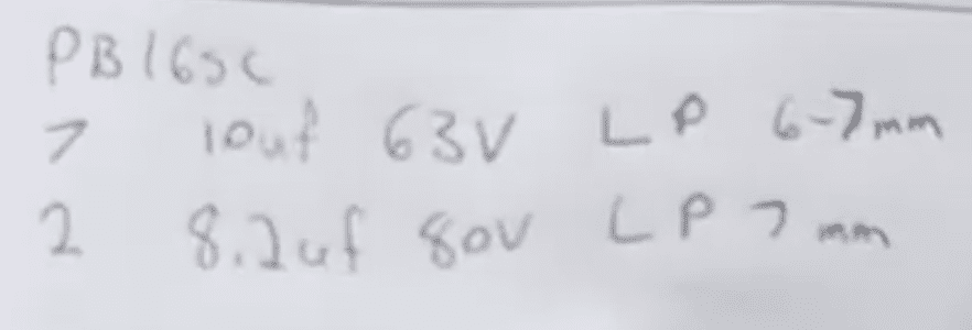

Hey, @techknight . Your video here shows a recapping list for the PB 165c at time stamp 14:39.
You bought YAGEO ESS106M063AE2EA from Mouser to replace the seven 10uF 63V "Low Profile" caps:
Height (Length): 7mm (which your video shows "just barely clears")
Diameter: 6.3mm
Lead Spacing: 2.5mm
Hour Rating: 1000
ESR: 10Ω?
But if ultra low ESR is acceptable, Mouser has the following POLYMER replacement candidate that will never leak and is 2mm shorter too:
KYOCERA AVX RPF0605100M063K
Height (Length): 5mm (same height as stock caps)
Diameter: 6.3mm
Lead Spacing: 2.5mm
Hour Rating: 5000
ESR: 66mΩ
Thoughts?
