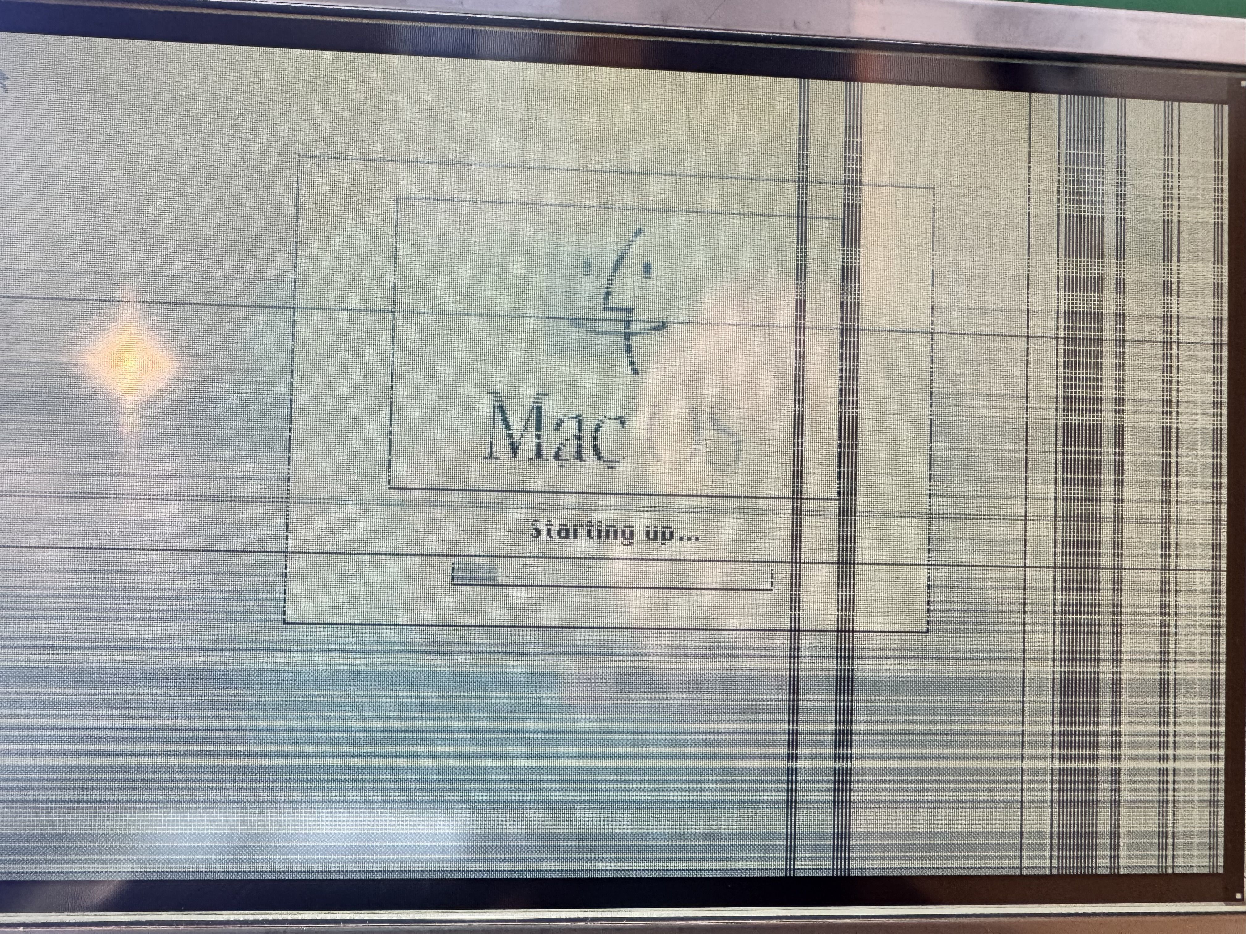

oh my God, aligning the screen after baking is the true crux of this fix! It’s very difficult to look at the crosshairs and knowing that you are right above it. This is the third time I’m bending the tabs to try to align it and I am worried the the tabs might break from twisting them over and over again. Does anyone have a good tip as how to look down the window to see if the crosses align? I’ve made sure that the traces on the pcb and the foamy stuff on the screen are clean. On first try there were only some horizontal lines on the right hand side, but now I’ve got zebra bonanza!
Here’s a picture of my last attempt(80% worse than the initial first try )

I guess you did not get the memo lol. It’s better to bake the display complete with PCB. Remove backlight tube, diffuser and desolder flex connector.
haha, I found that post AFTER I had removed the display! 😭
I guess I'll have to keep trying to get the alignment correct. One question though: Do I have to twist all the metal tabs between every attempt, or can I leave some open?
I think I left some open while I was testing on my initial bake.
Oh my! I finally did it! What a pain. But on one try I got rid of all the horizontal stripes, and then I realigned the vertical ones. Turns out that if you don’t clamp down well all the tabs you don’t get enough contact between the PCB and the foam on the screen. So I wonder if I got it pretty decent the first try but did not make good enough contact between the pcb and the screen.

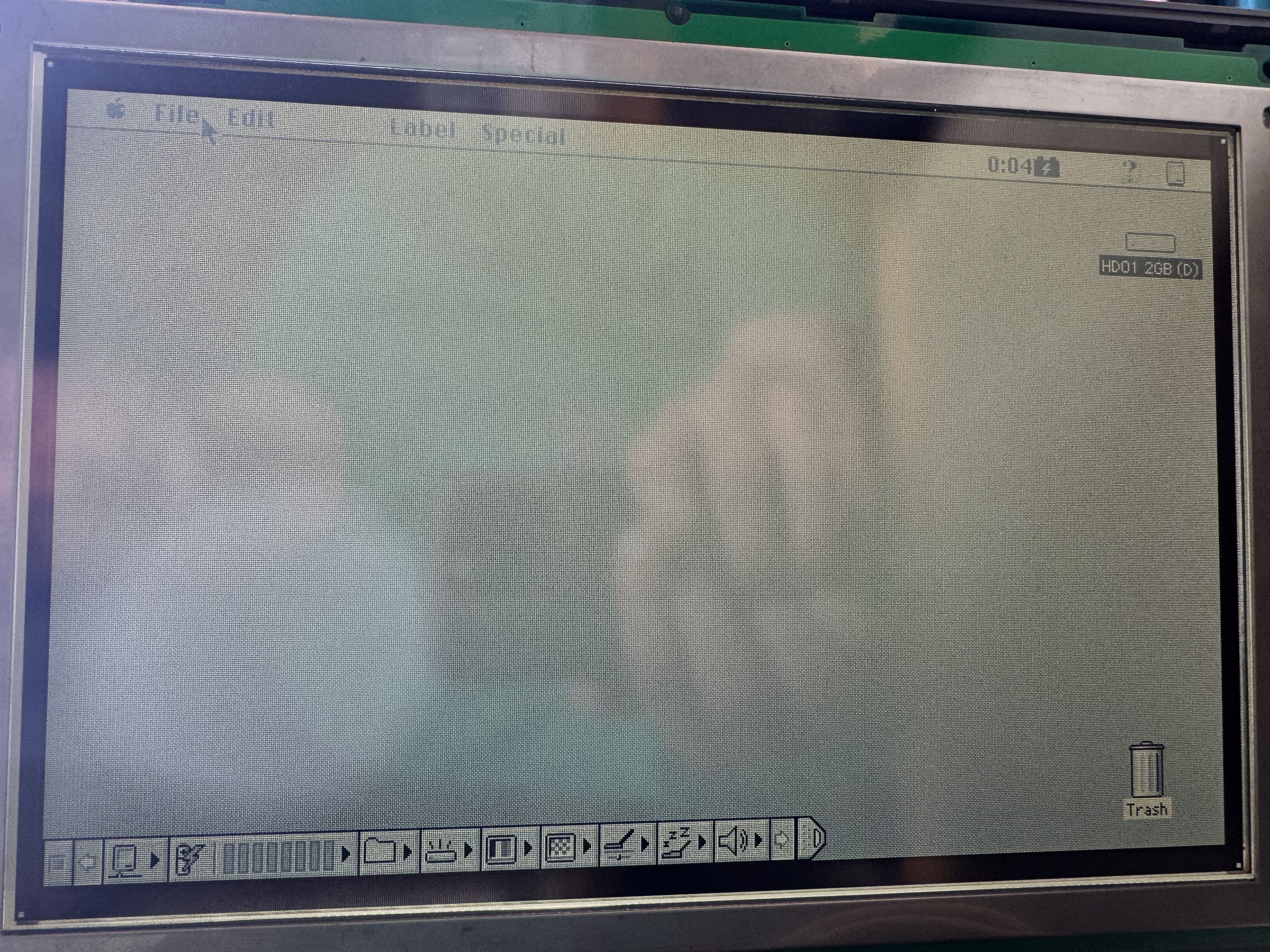

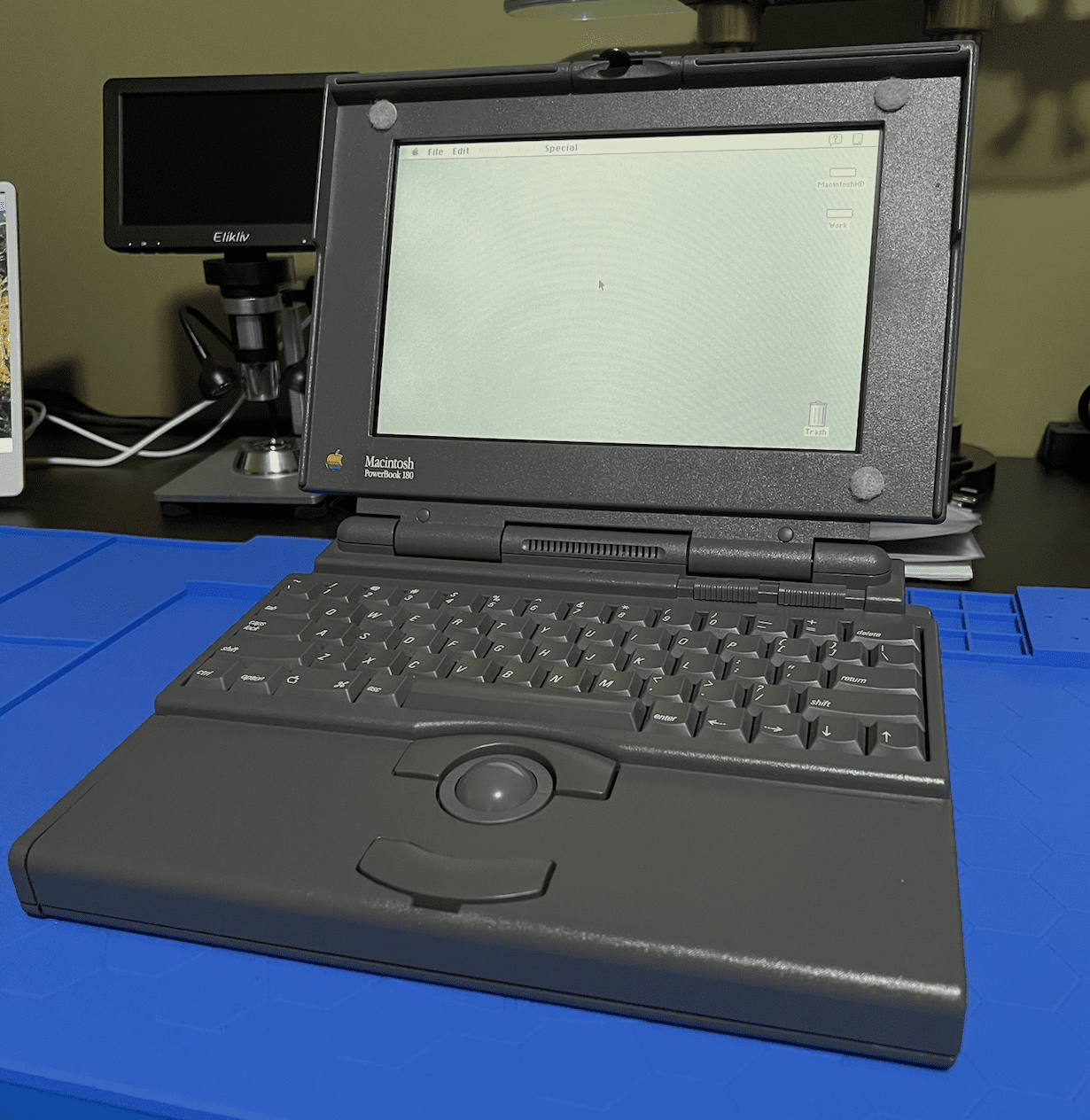

This is a little late, but here is the one year update on the 180 lcd that I baked. It is still working well, and I've had no issues with the lcd since the baking so far. During this time, the hard drive has failed (replaced with a BlueSCSI using a SD card extension to empty battery bay), and the trackball stopped working (replaced with donor trackball from parts laptop), but the lcd has been fine so far.
When I did the baking a year ago, I didn't really do anything with regards alignment. For this laptop's lcd, there really wasn't any ability to adjust the positioning. Half of the tabs bent clockwise and the other half bent counter-clockwise, and, given the slots, it would only go together one way. I never saw any lines on the display image other than when I was doing some testing prior to the baking. The lcd seems really finicky about the tabs all being pressed down firmly. If even one tab wasn't pressed down firmly then the lcd would go haywire. Not sure if it is a grounding thing or if the pressure is required to make sure all of the wires make good contact. Then again, I could have just gotten lucky with this laptop.
