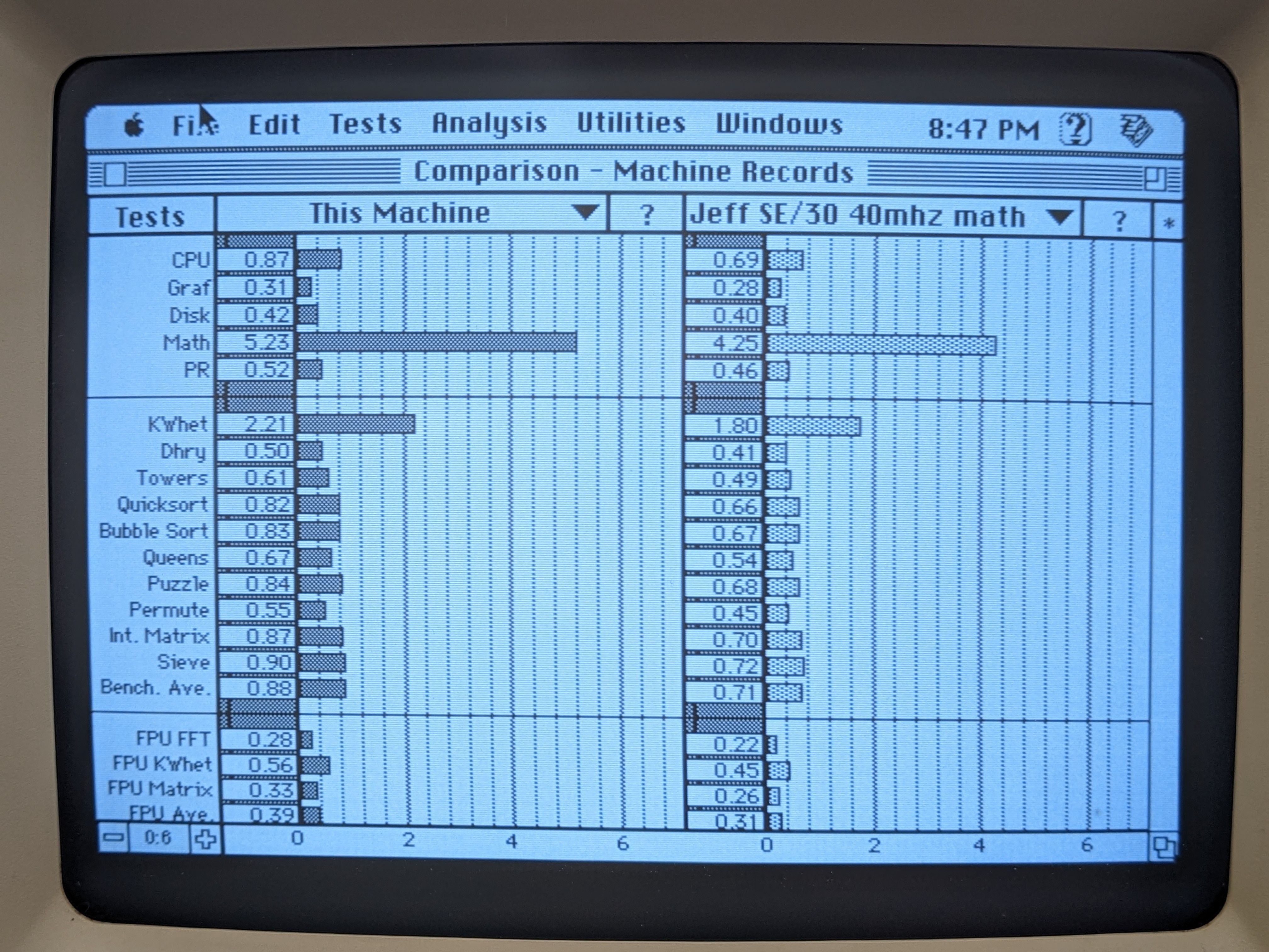

Colin, I am sorry I do not have a IIci to test, but perhaps this feedback will be semi-helpful...
My SE/30 benchmark results in Speedometer 4.01 using the 50MHz socketed Daystar PowerCache (with Power Central v2.2 loaded at startup) tests similarly to what @JeffC reported...
I generated those results with the stock SE/30 ROM, 128MB RAM, booted into System 7.1.
OS version is very important when benchmarking. I almost always get slower results when booted into S7.5.5 versus S7.1, for example. System 6.0.8 is also great for testing, but you can't run the newest versions of many benchmarking apps under System 6.
When benchmarking with Speedometer, it's important to always report the version number because benchmark results were adjusted across versions. Version 4 will report different numbers than version 3.x.
