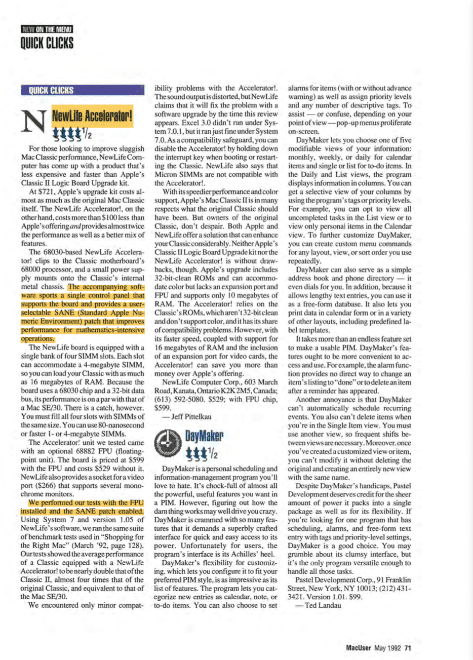

So, I looked through the magazines back in the day. In the May 1992 issue of MacUser, I found a review of the NewLife accelerator for the Mac Classic on page 71. NewLife provided a CDEV with user selectable SANE. Hmmm. Now I am hunting for more information. :sneaky:
Unfortunately, their test seems to have consisted of only the card & SANE CP installed, without testing to see how math performance would differ with only the accelerator and NOT the CP installed.
But perhaps the most interesting part of that article is this...
Distorted sound plagues the Levco SuperMac SpeedCard I have (until I disable it via the Programmer's Switch trick I showed in my video). But bad sound also plagues the Sonnet Allegro 33MHz accelerator that recently was shown on Bruce's recent video, as per an old post by Byrd here. And Byrd's pics are here. I also know from @Kay K.M.Mods that the Carrera040 too has distorted sound, at least on the SE/30 (he seems to not have issues on the IIci for some reason). And yet, my 50MHz 68030 DiiMO PDS accelerator for SE/30 has no sound issues, neither does my Daystar PowerCache socketed 50MHz '030 with FPU, and neither does my 40MHz Daystar Turbo040 PDS accelerator (all for SE/30). And that is why I am hoping @Zane Kaminski can avoid the same bad sound fate with his amazing new accelerator. Most people play games on vintage Macs, and you can't play most games with bad sound. It's just a fact. Also...
Bad sound = Bad design
(in my humble opinion)

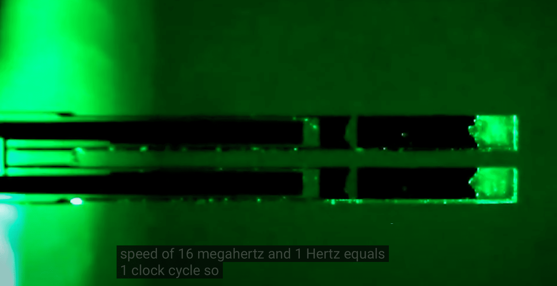

And the crystals inside the oscillators give off vibrations as it hits a specific frequency. Below is from a 16 MHz oscillator. So, that distorts sound at the software level without considering the change in processing frequency. Interesting.

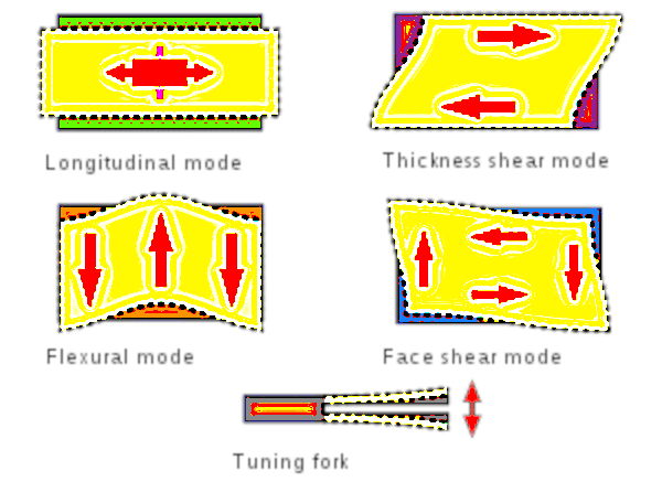

The second illustration shows the various ways to produce vibrations of the crystals at specific frequencies depending on the design.
In early, June I posted 2 audio files here were you can hear sound with and without the distortion caused by the Levco SuperMac SpeedCard.
And here is the audio Spectrogram comparison.
