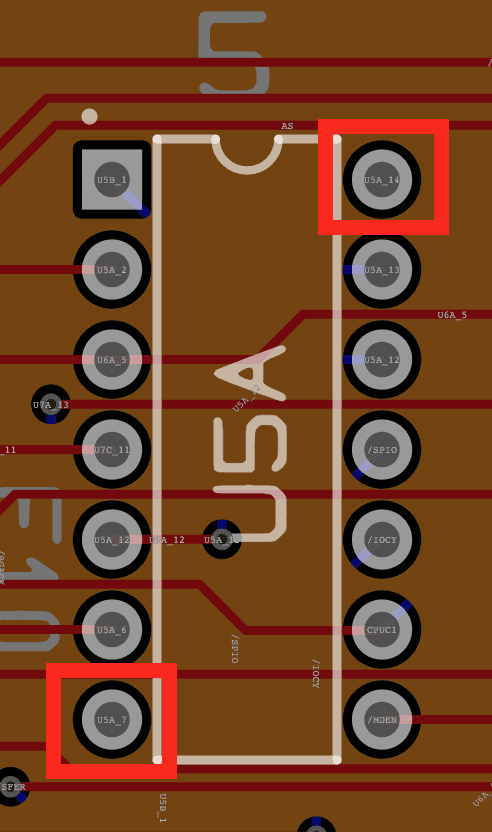

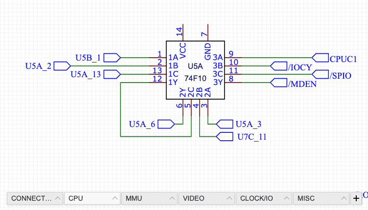

You know what's generally a prudent and conscientious methodology for producing a fairly complicated four layer PCB the size of a dinner plate?
MAKING SURE YOUR DAMNED ICs ARE POWERED.

That... is an expensive mistake, lol. And possibly the reason why the PCB has been running into issues.
Oh god! Easy mistake to make I guess? Also relatively easy to repair hopefully 😬😬

Did you ever get the chance to patch and retest your CPU card?
Yep - Alex has my card at the moment and got a chance to bodge power and ground to U5A this weekend. It now boots into LOS successfully! LisaTest does report an issue with the error logic, apparently, but it's not enough to interfere with the system actually operating. Now that we've stomped that bug, all focus is on figuring out the error logic issue and then it's done!
