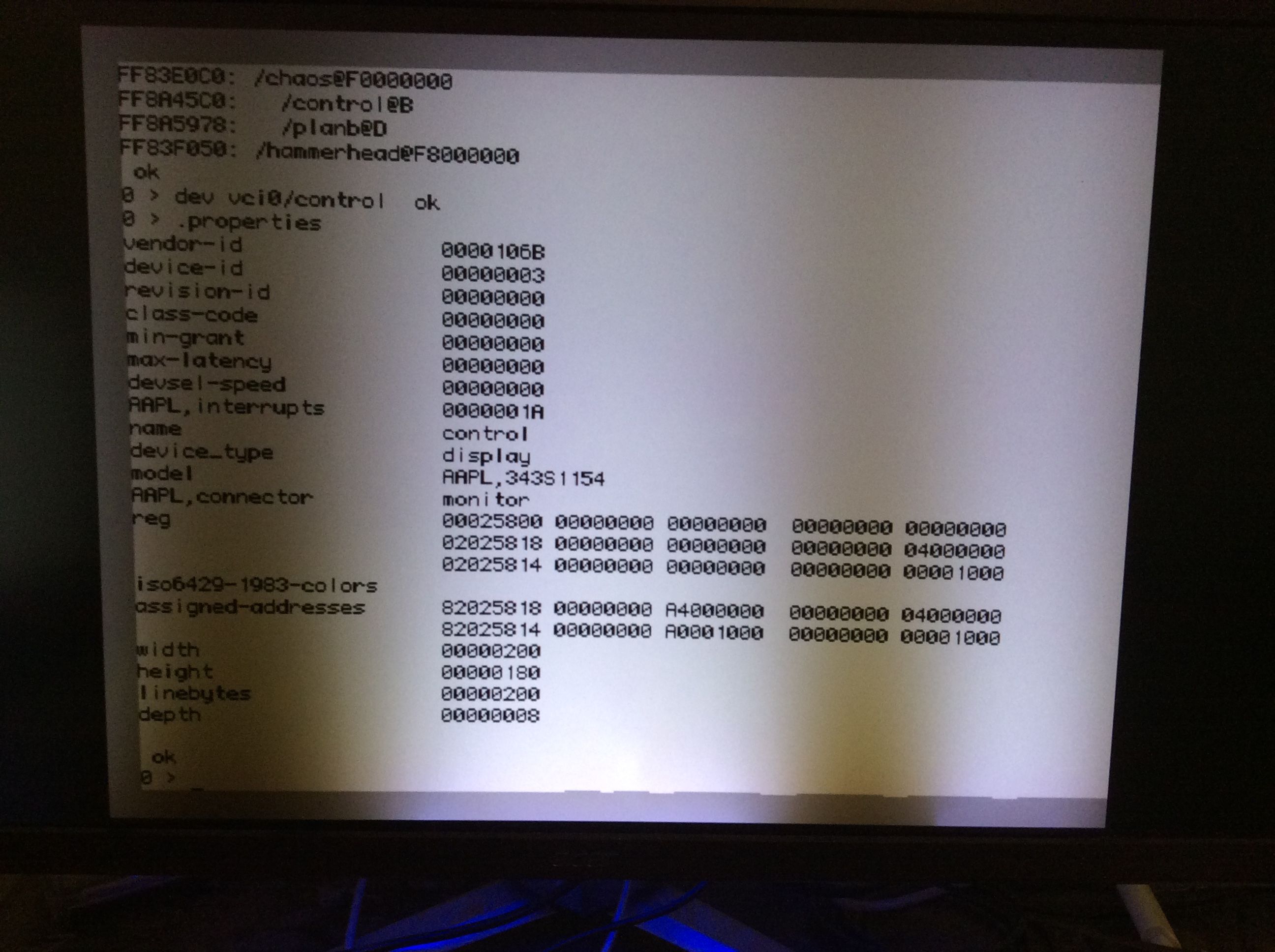

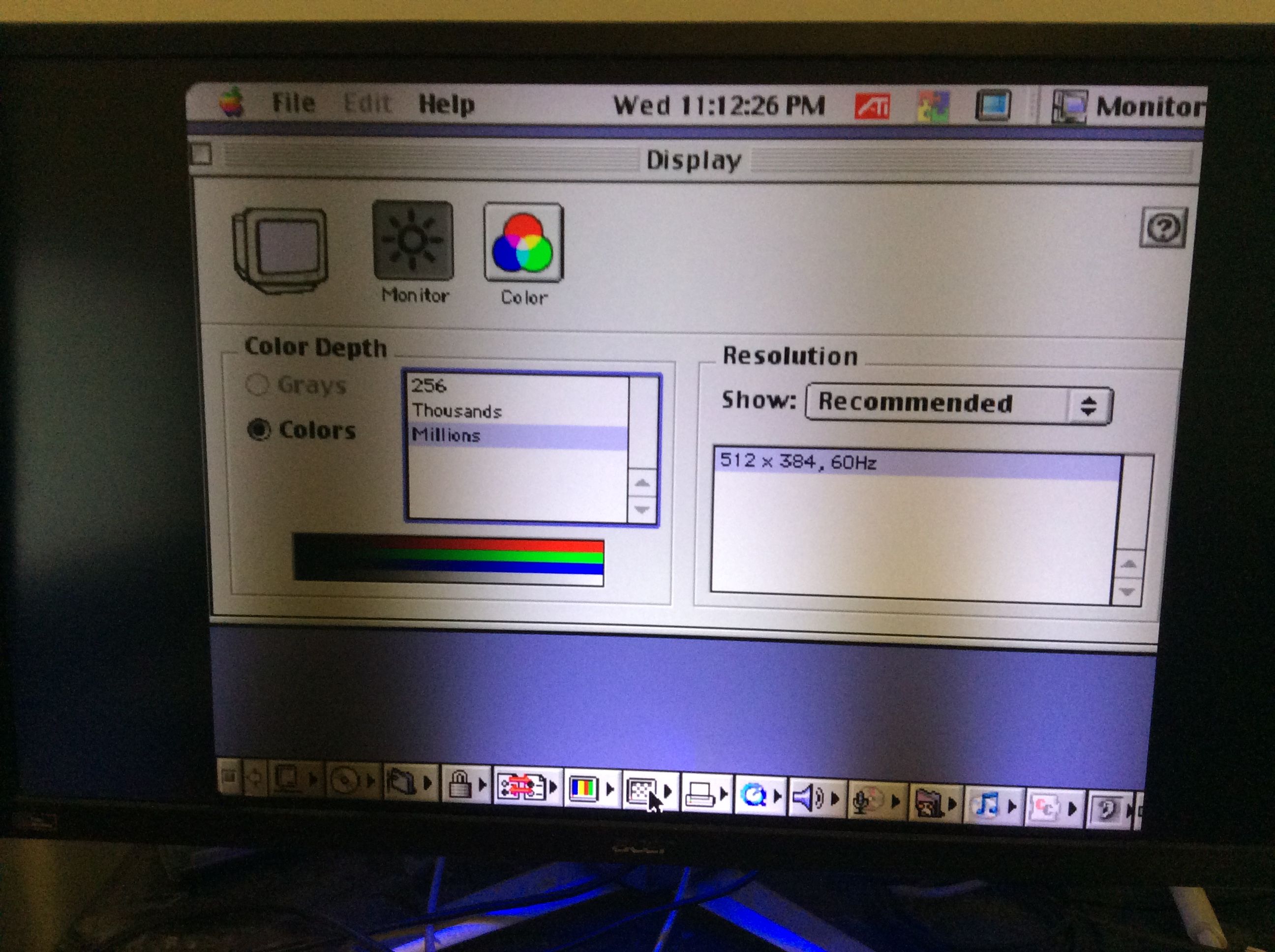

I tested built in video output of my Power Mac 8600 (vci0/control in Open Firmware).
In Open Firmware, I had to load the Control3.of version of the control driver because the ROM version only supports 640x480@67 and 640x480@60VGA.
I used dipswitches 13467 of the Apple to VGA adapter (same adapter discussed at #3 above and in the thread at #42 ). Connected to that is a cheap USB powered VGA to HDMI adapter. My LCD display recognizes the mode as 640x398 25 KHz 60 Hz. The VGA to HDMI adapter must be doing some scaling. It's not good scaling - you can see some vertical and horizontal lines are doubled in thickness.
https://www.amazon.com/dp/B09XH2L8BM
https://www.amazon.com/dp/B07MQBDY91?th=1
Power Mac 8600 built-in video 512x384 Open Firmware Control3_joevt.jpgPower Mac 8600 built-in video 512x384 Mac OS 9.2.2.jpg
  • control Open Firmware.zip

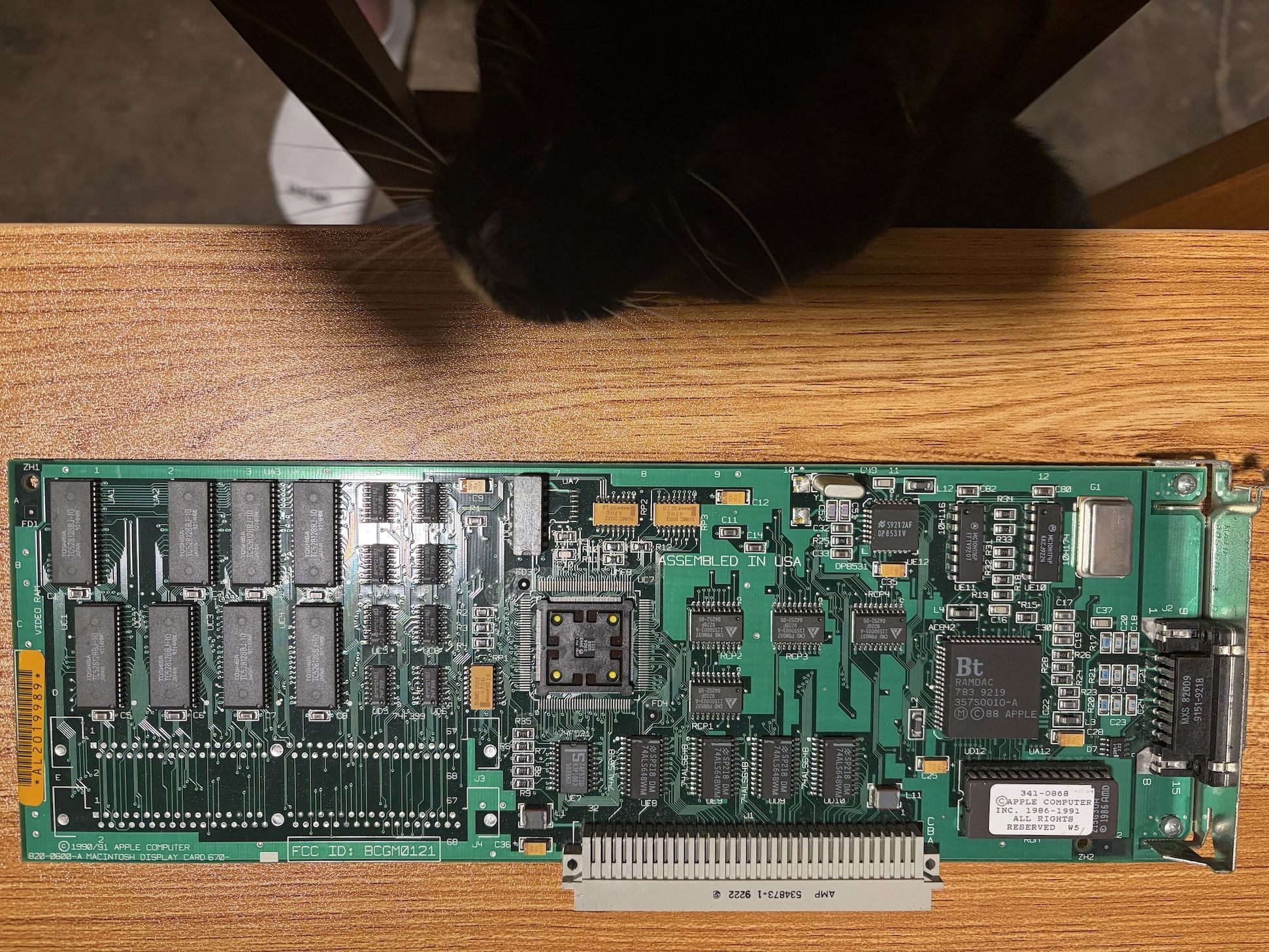

I do have an extra Macintosh Display Card 8•24 if you're interested.
Ron's Computer Videos
Oct 15, 2021
234
317
Thanks, I get what you're doing now. I did wonder though if you were trying to see if 512x384 would work on the Sony CPD-200sf in an unsupported manner, although your test with the LC seems to imply it won't.
That is seemingly the card I need for this project. As long as it's not the "GC" (670-0310) model, I'm interested.

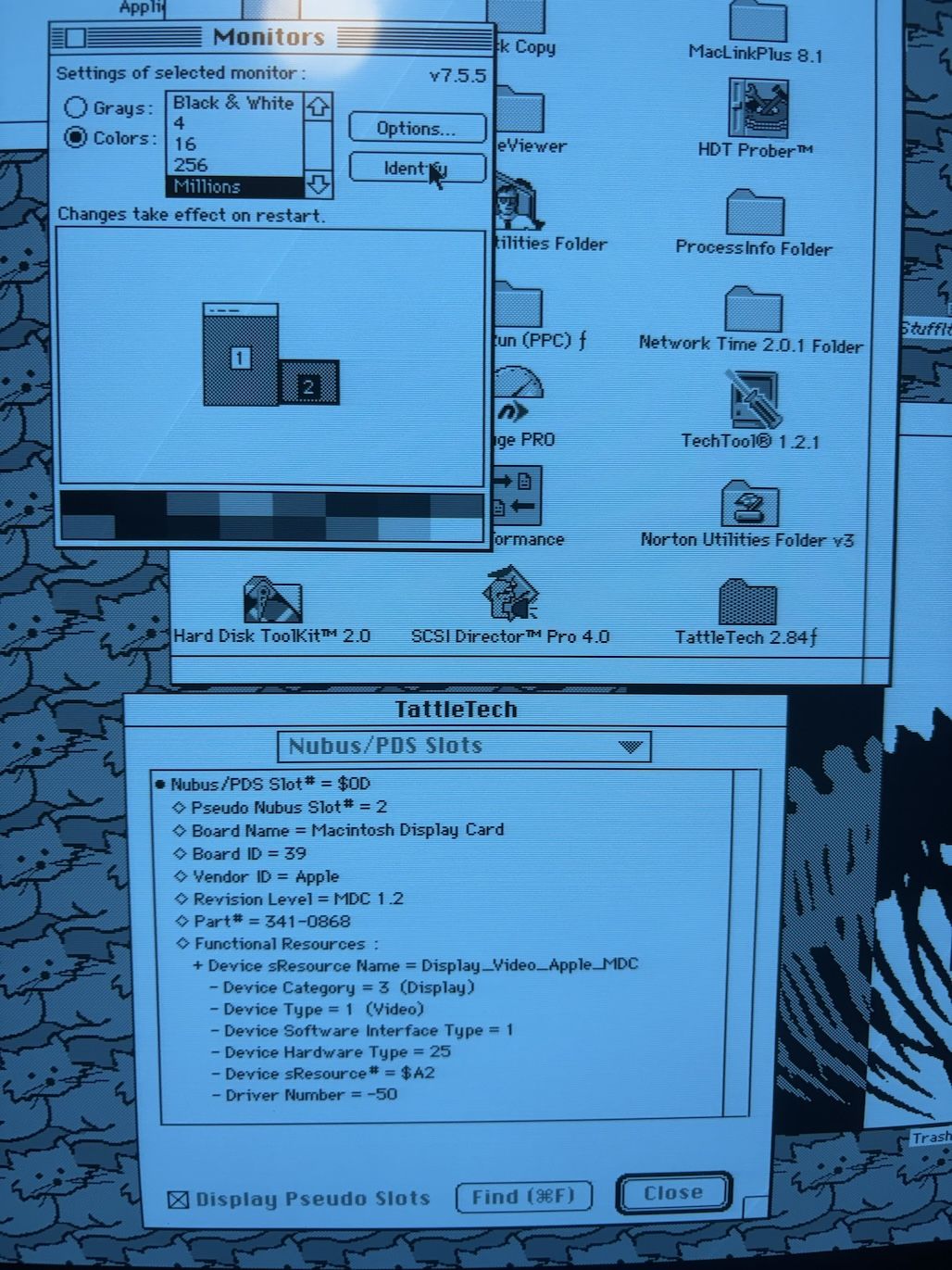

I think TattleTech has a utility to view NuBus slot info?

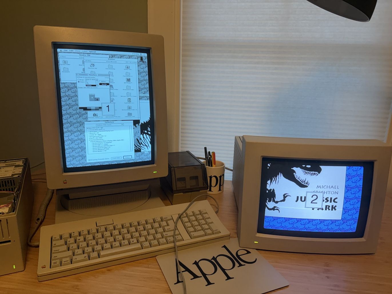

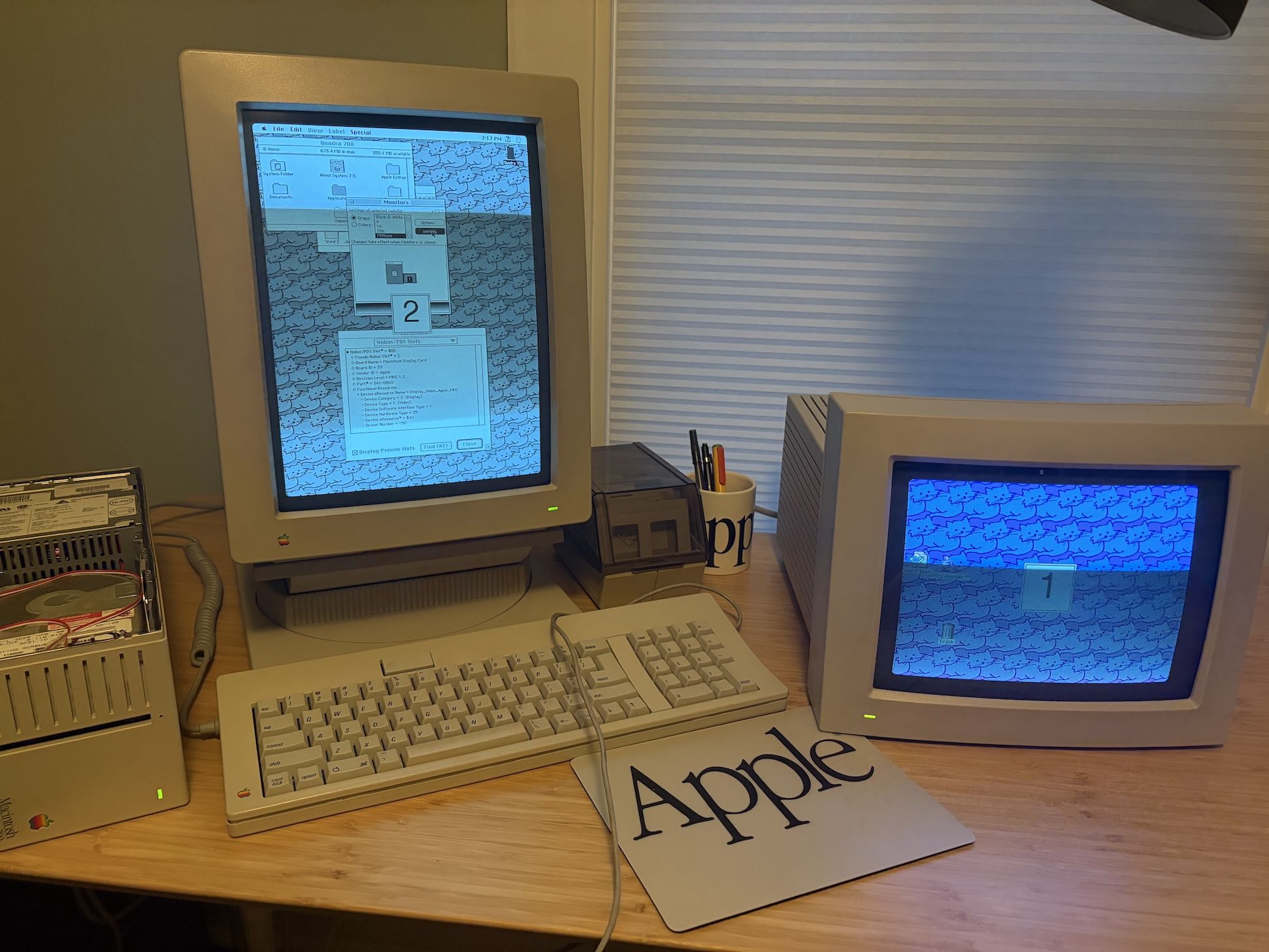

It's the regular, non GC, "Macintosh Display Card 8•24" card. Just tested working in my Quadra 700 with a Macintosh 12-inch RGB Display (512x384). I was curious and also tried swapping monitors/video cards. Didn't realize it but the built-in Quadra 700 video can also drive the Macintosh 12-inch RGB Display. ...which seems like it would have been a very odd combination back in the day!
