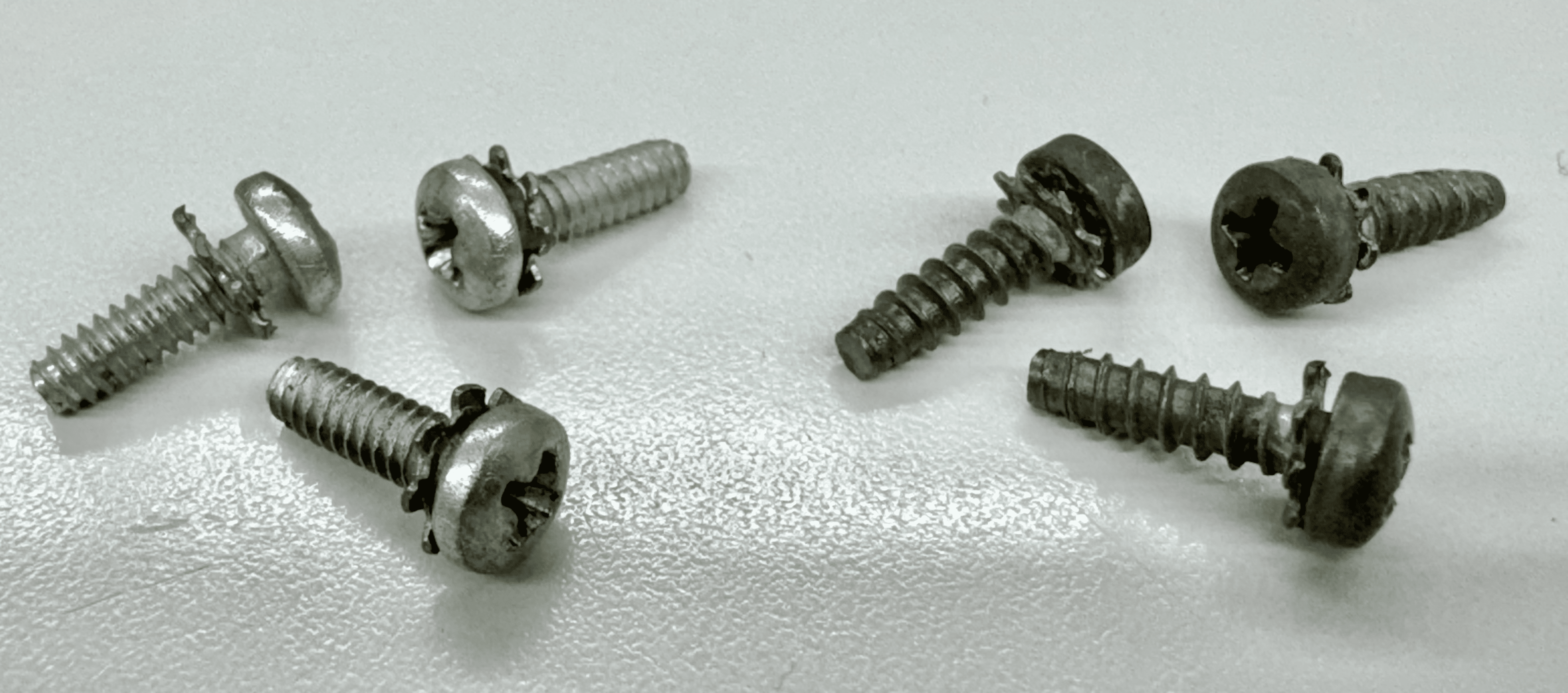

Yesterday, a viewer of my Macintosh SE & SE/30 Analog Board Recapping Walkthrough video asked me about SCREWS which affix the SE or SE/30 Analog Board to the metal chassis. It was a good question because I too have some missing.
Here is a photo of the TWO TYPES which I have seen over the years...
The silver colored trio at left look almost like MACHINE SCREWS to me, in terms of the threads. The 3 at right I see more often, and despite the lack of a pointy tip, the threads look like a SELF-TAPPING THREAD-FORMING screw to me.
MEASUREMENTS:
Shaft Length: 9.8mm
Shaft Width: 2.8mm
Head Width: 5.4mm (Phillips)
MACHINE SCREWS
Shaft Length: 9.7mm
Shaft Width: 2.7mm
As shown above, both types have a locking "tooth" washer near the head.
QUESTION: Those of you who have purchased replacements for these in the past, did you choose M3 machine screws, M3 self-tapping thread-forming screws, or something else? The shaft length is pretty close to 1cm, so I would assume that length would be preferred.

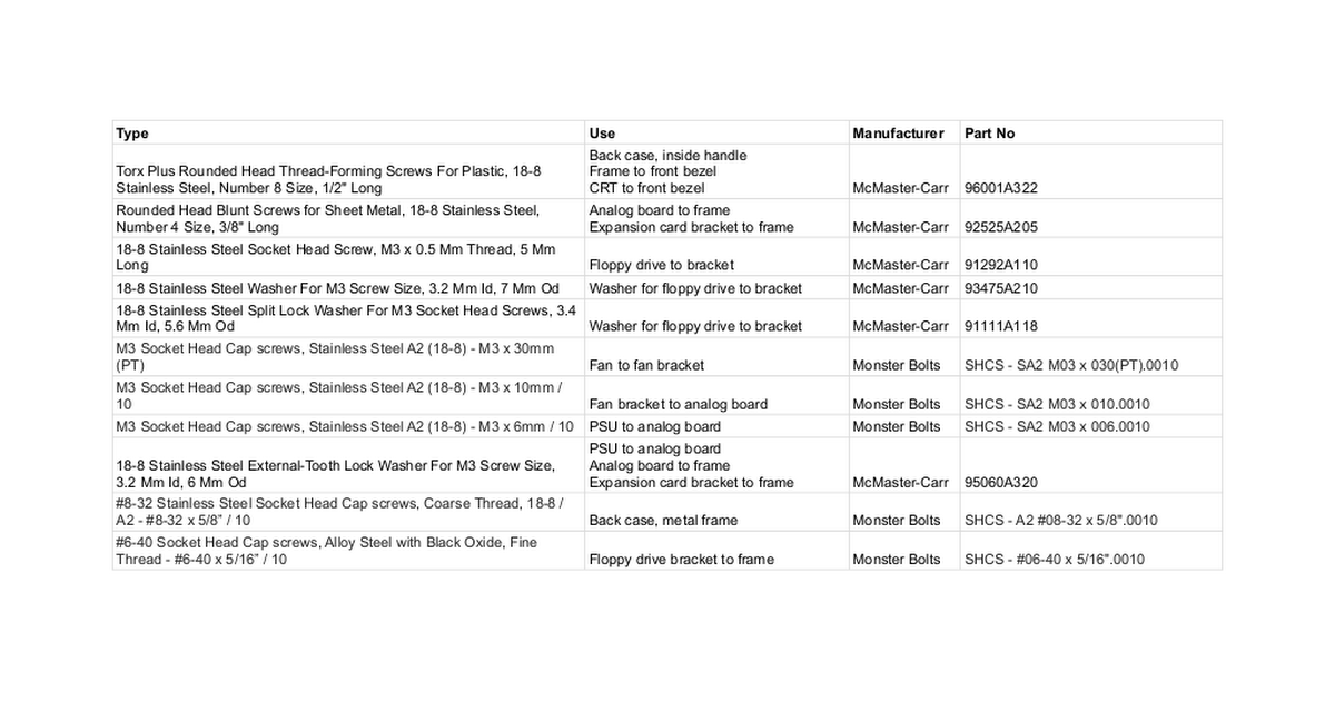

Wow! Your compiled info is what everyone needs to know! Thank you!
More specifically, you name the Analog Board to Chassis screws as being MCMASTER 92525A205, which I Googled here:
Pricing of more than $200 for 5,000 is impossibly expensive but the screw specifications shown there pretty much match the caliper measurements I presented in my opening post. Meaning, they are #4 screws that have fraction-of-an-inch measurements, rather than being metric “M3” screws.

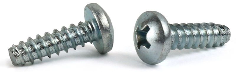

Visual inspection of the photo on that site matches my opening post photo of what I called self-tapping based on the look of the threads:
I then Googled up the McMaster 95060A320 washer, which is sanely priced at $1.64 for 100pcs:
McMaster-Carr is both the manufacturer and retailer. Search for that part number on this page: https://www.mcmaster.com/catalog/131/3424/92525A205
Pricing is $5.30 for qty 100. If you don't care about them being stainless, mild steel screws would be much cheaper.
Note that there's a difference between "self-tapping" and "thread-forming" screws; these are the latter. (The case screws are thread-forming as well.)

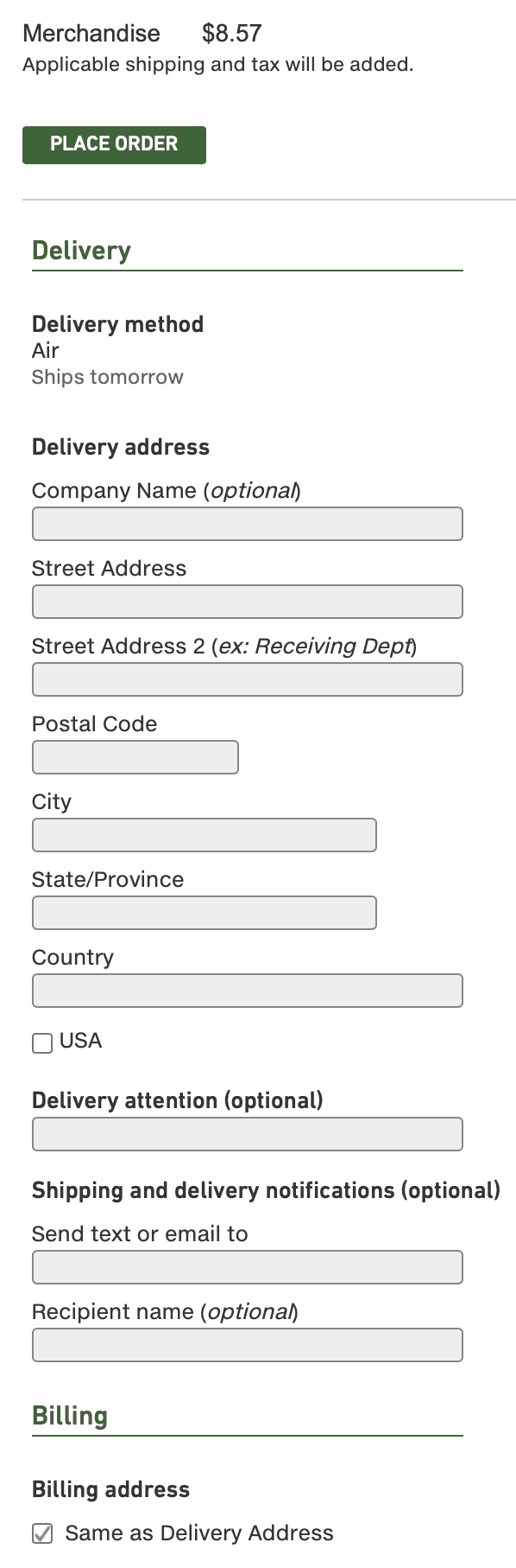

You then must fill out address and payment info and click the yellow SAVE button at bottom. The top part of the form looks like this...

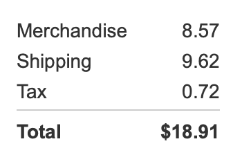

However, where I put in a sample address in California, it gave me these shipping prices:
GROUND SHIPPING:
AIR SHIPPING:

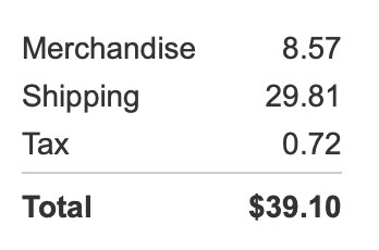

But of course, I don't live in CA. That was just a test. I then entered my address in Japan, and the shipping price vanished. They seem to allow shipping outside the USA, but I suspect their price would be at least $30, which is too high for screws and washers, especially when you need far less than 100pcs.
