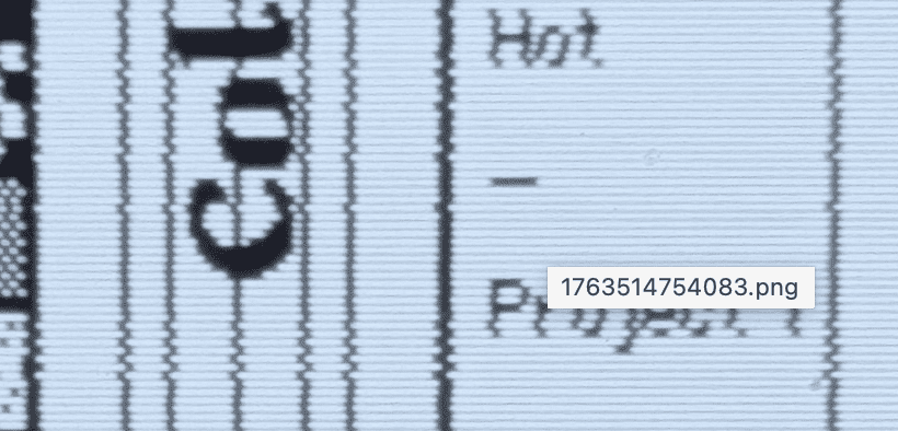

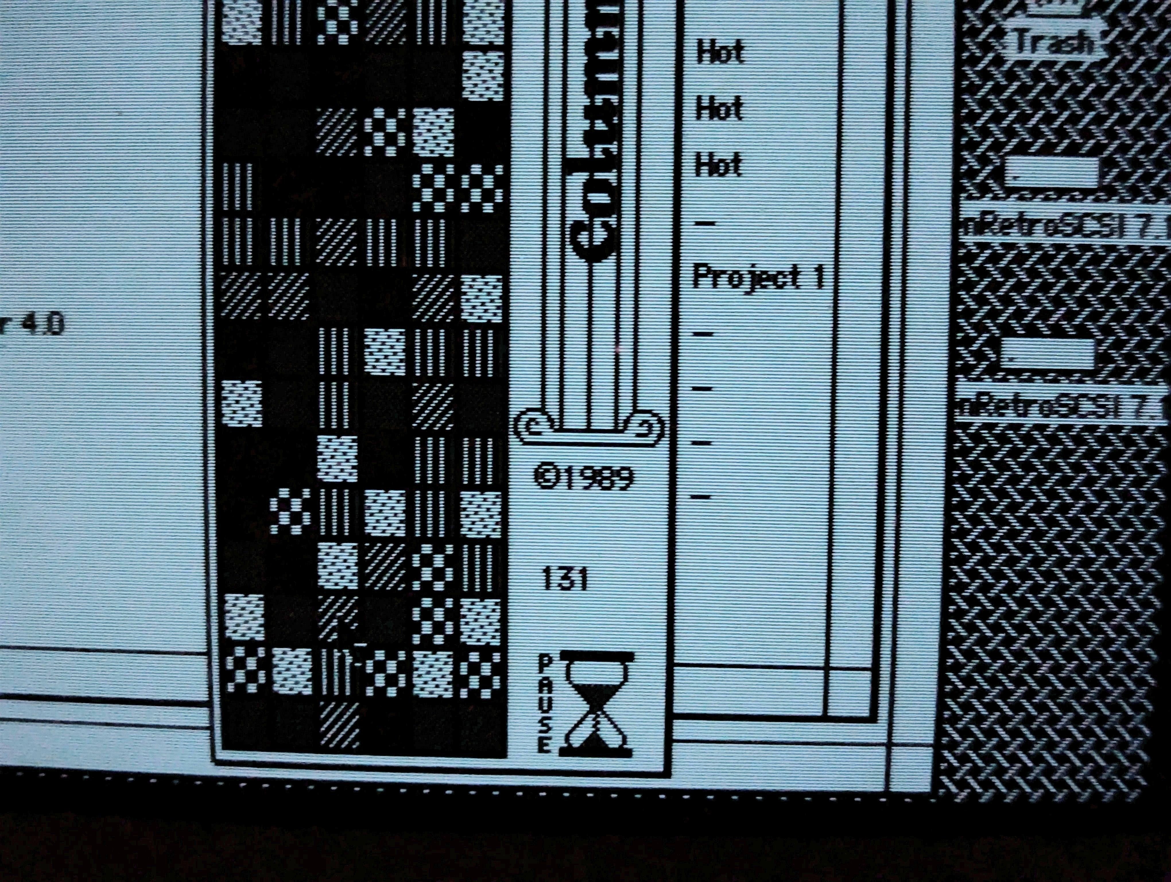

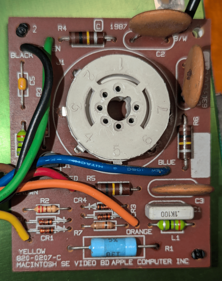

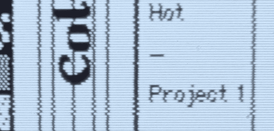

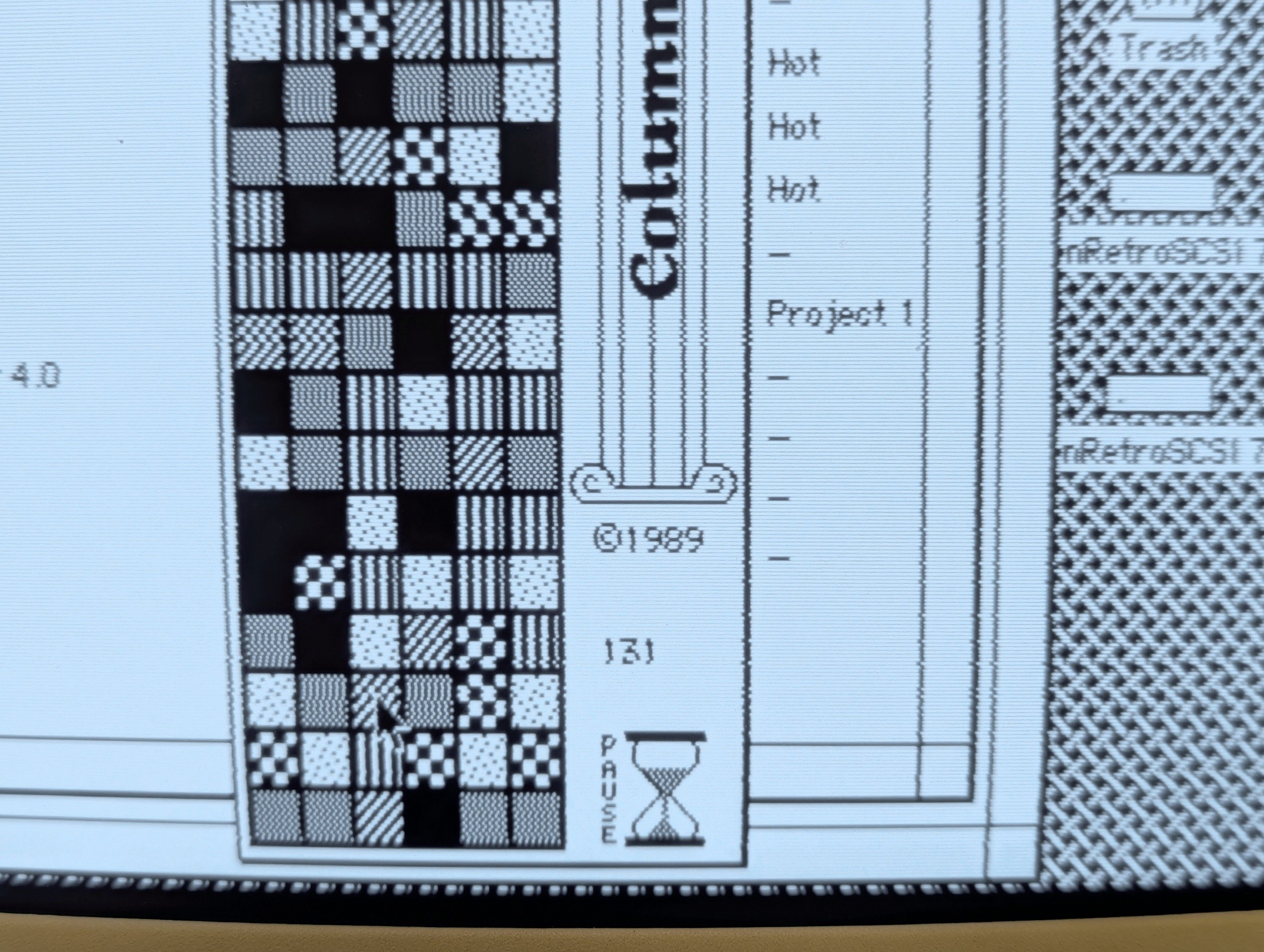

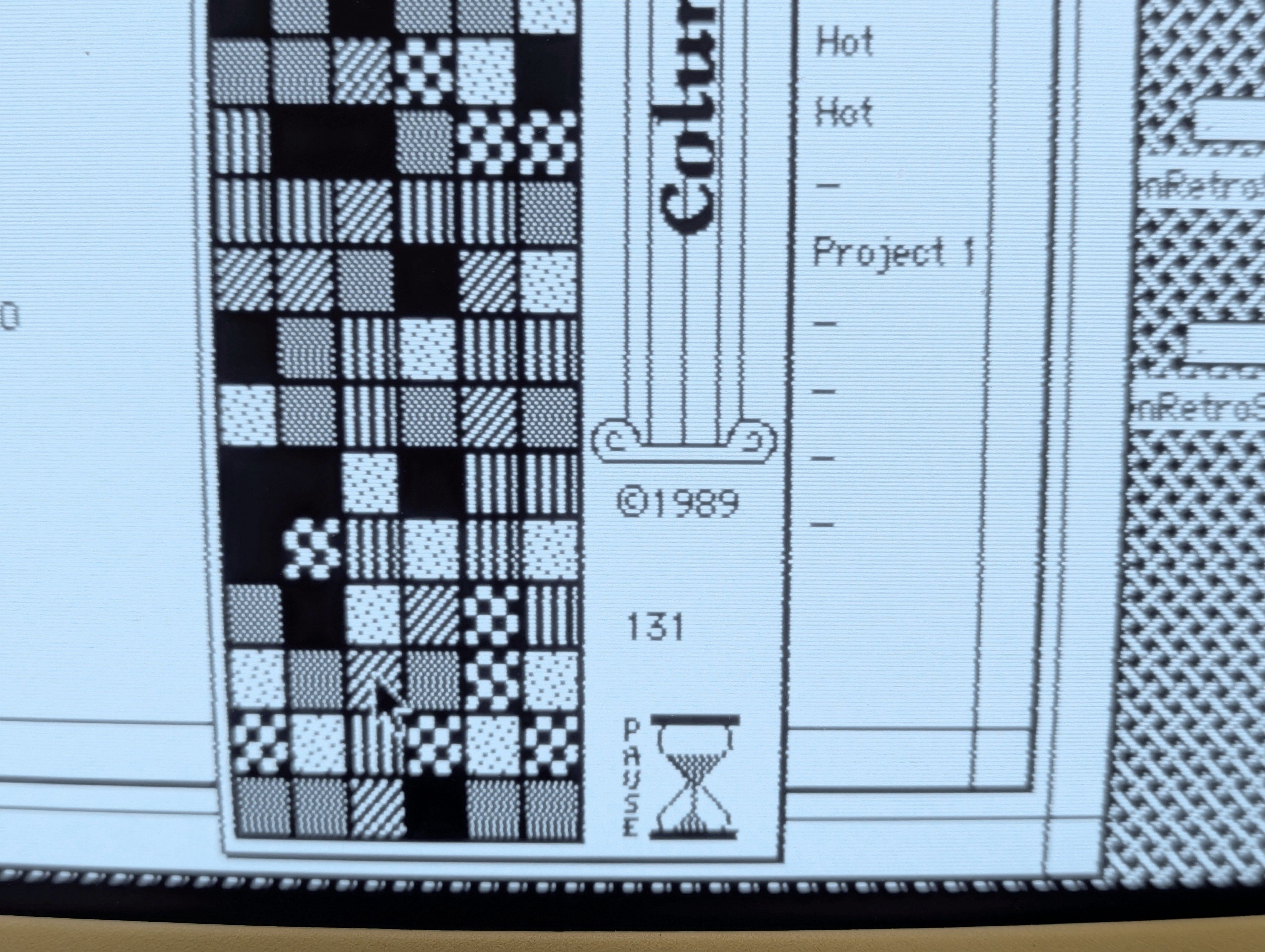

Except there's noise in the video that gets stronger as it warms up - after about ten minutes, it reaches a peak and stays there. I saw it surge with HDD activity while I was working on recovering the files that came with it, but that part isn't in the machine. I've tried replacing the HOT and reflowed the analog and CRT boards, but am unsure where to look next. The caps on the mainboard leaked at least a little, at least judging by how they looked when I removed the old ones, but I don't see much of anything that looks like corrosion beyond all the solder on the board being dull and slightly soft (fuzzy?) looking - no green crud. All of the pads came clean easily and everything looked good to my eyes otherwise. I swapped the CRT board with the one from the SE, and the noise changed a bit but didn't go away. The only consistent thing I can to to reduce the noise is to turn down the brightness - the brighter it is, the stronger the noise is. The pictures attached show this at normal brightness (the noise moves randomly like static) and one turned almost to nothing, edited to be more visible. I also haven't seen any rogue solder or bridged connections, though it's always possible that I missed one.
Would the CRT board be the next thing to investigate, or should I still be looking at the motherboard or somewhere else? I've always been good to hang parts, and now I feel more confident I can solder them, but circuit-level diagnosis is still kinda new to me.

Apologies for not responding, but troubleshooting has been on hold while the computer gets a little real-world exposure between major holidays (it and some friends are hanging out in an elementary school gifted classroom, as part of a rotating display of vintage tech for kids to try out and ask questions about). As the problem seems to stabilize at a certain point, it has an external monitor they'll want to look at anyway, and they're not going to run the computer for hours at a time, it should either be fine for the time being or finally fail to a point that gives us a useful hint.
I can't say for certain if I noticed the issue before the recap work, as I was mostly trying to get the external video card working reliably. I recall a noisy display at one point, but that was with the original analog board shortly before the flyback audibly crapped out and I switched to the one that's in it now (also the one that was cleaned and recapped).
And yes, I recognize that this situation is novel - that's why I created an account to ask questions here, hoping someone had a lead I could follow because the Googles, they had nothing. I wish I had more to tell you - I know it's isolated to the horizontal plane, it starts out very weak when cold and increases as it reaches full temperature, it's not affected by replacing the CRT or the CRT board, and that a questionably functional HDD connected to the device can make the same kind of noise appear when there's disk activity.
