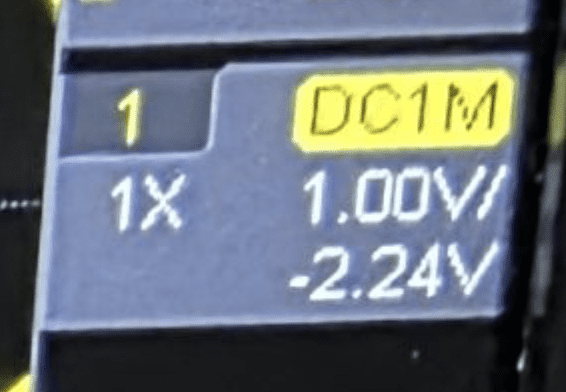

Also, I cannot see a clear photo of your scope probe to see what your attenuation slide-switch setting is. But if the on-screen message below means your Probe is set to 1x, that needs to be changed to 10x for correct HF measurements. The 1X setting can be used for very LF measurements, but it's best to only use 1X for very small amplitude signals that are hard to measure with the 10X probe setting.

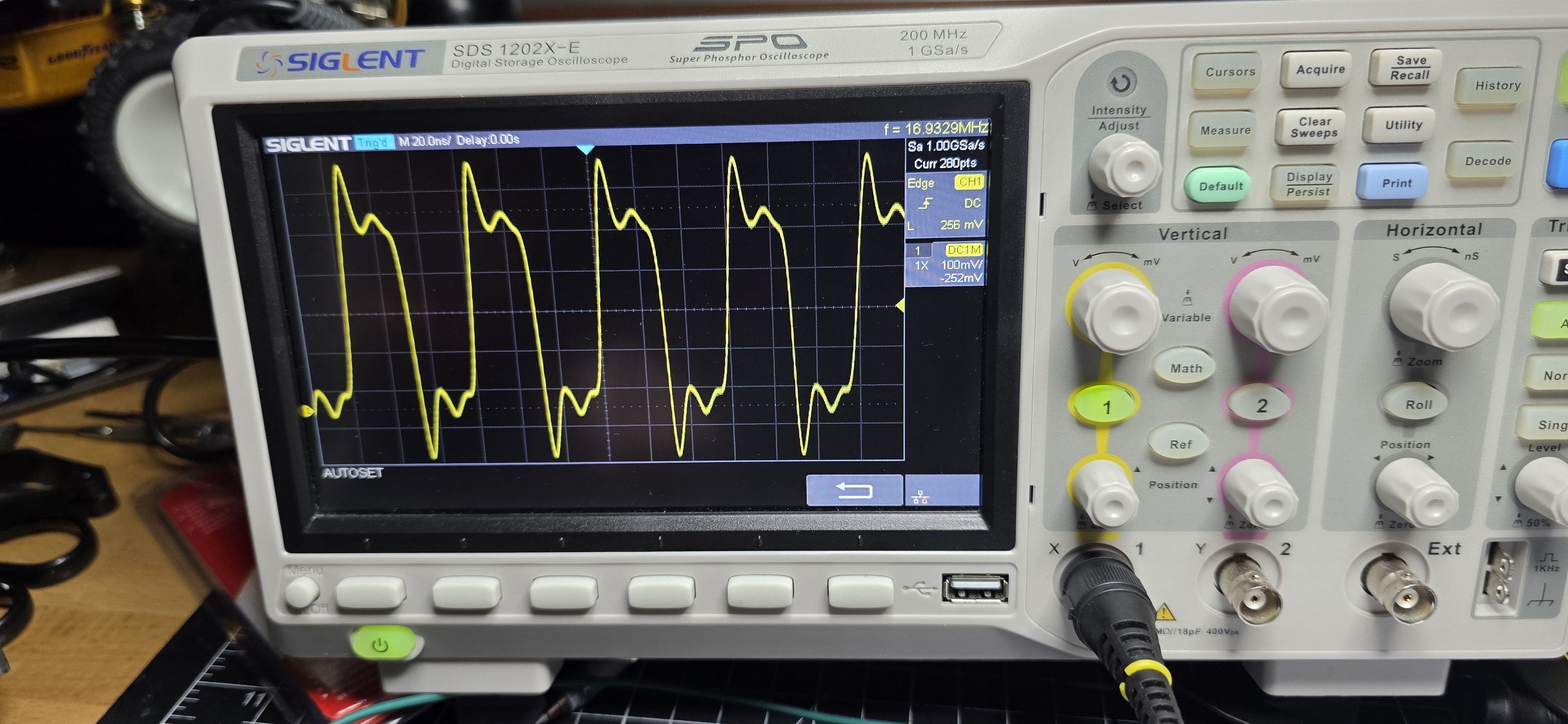

Setting the probe to 10X made the leg farthest from UE10 - which corresponds to Pin 25 of UE10 - produce a good wave form again, even with the extended green ground lead:
10X probe setting on the probe itself, and connected to UE10 Pin 25:

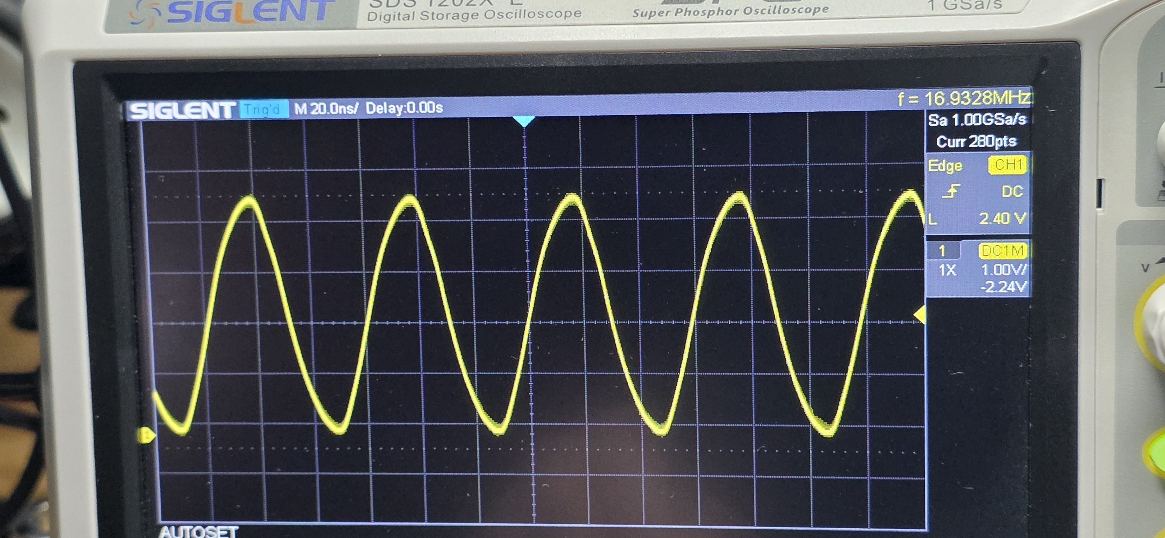

But 10x probe setting on Pin 24 produces the odd wave form again:

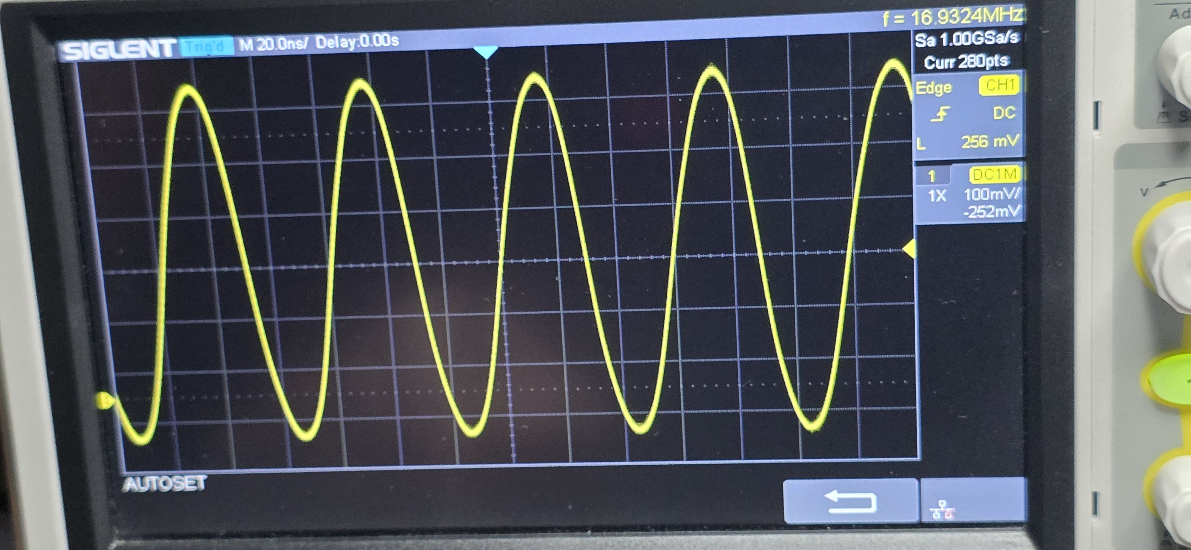

If I switch the probe to 1x, I get a good wave form on Pin 24:

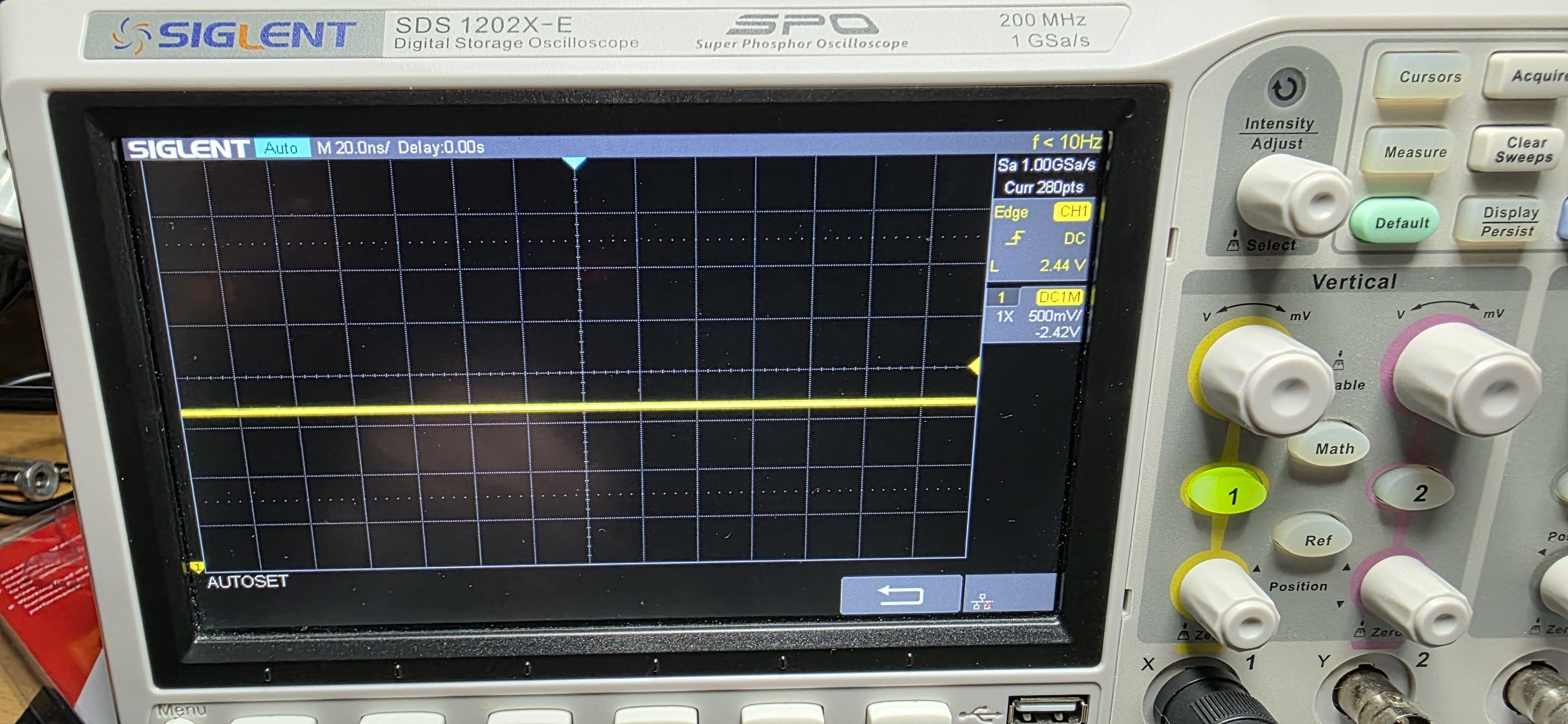

1x probe setting on UE10 Pin 25 produces a flat line:
I see that the screen shows 1X no matter which selection is on the physical probe itself, I'll see if I can get that to change.
