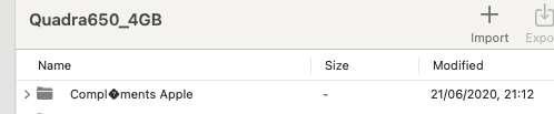

After a quick test, I can report that it doesn't like file names with accented characters:
The missing letter is an e with acute accent (é)
Trying to open a folder with such name will make Sector unresponsive (endless beachball pointer).

Thank you. That's a big bug. Thanks for reporting it. Is it possible for you to provide me the exact disk image so I can recreate it?

Thank you for this new and very useful app.
I have the same kind of error. Probably bad Mac OS Roman <-> utf8 mapping?

Yes, it was bad MacRoman -> UTF8 mapping! There is now a 1.0.1 update in the Mac App Store that should fix this issue and a few other bugs. Let me know if you come across any other issues. Thanks!
