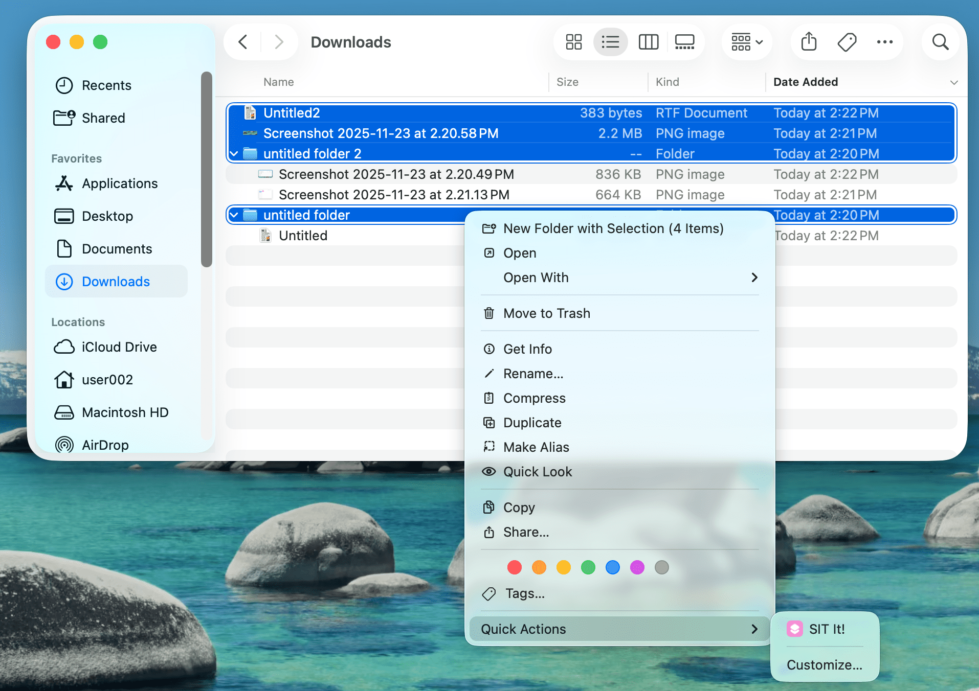

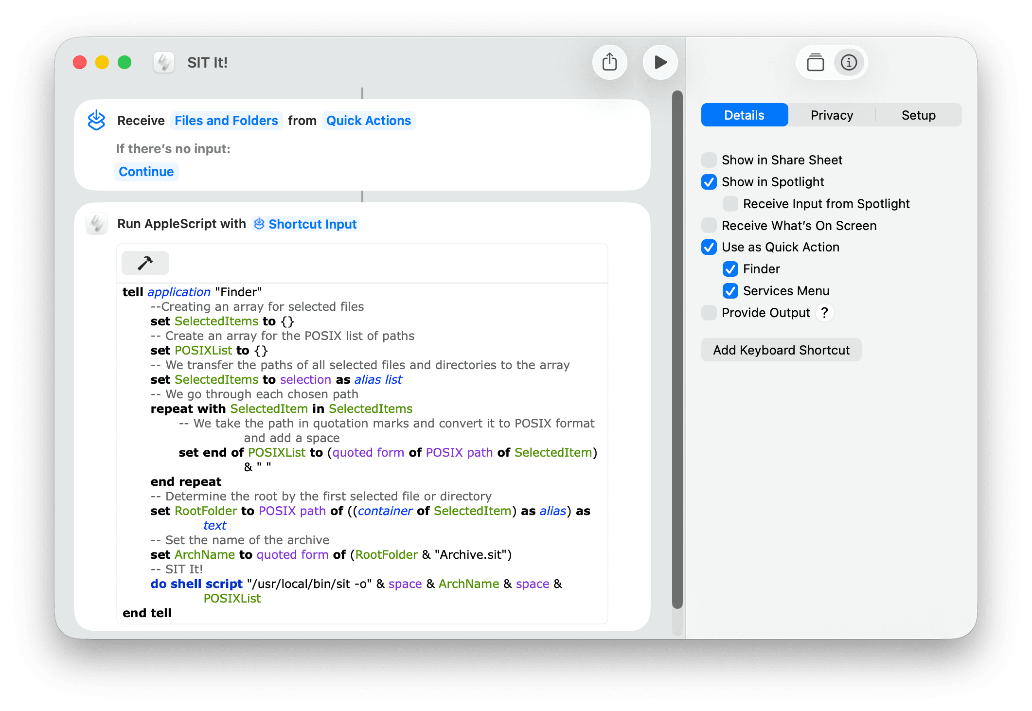

@thecloud I have some similar solutions for shortcuts on AppleScript, so I adapted them quickly enough.
AppleScript:
tell application "Finder"
    --Creating an array for selected files
    set SelectedItems to {}
    -- Create an array for the POSIX list of paths
    set POSIXList to {}
    -- We transfer the paths of all selected files and directories to the array
    set SelectedItems to selection as alias list
    -- We go through each chosen path
    repeat with SelectedItem in SelectedItems
        -- We take the path in quotation marks and convert it to POSIX format and add a space
        set end of POSIXList to (quoted form of POSIX path of SelectedItem) & " "
    end repeat
    -- Determine the root by the first selected file or directory
    set RootFolder to POSIX path of ((container of SelectedItem) as alias) as text
    -- Set the name of the archive
    set ArchName to quoted form of (RootFolder & "Archive.sit")
    -- SIT It!
    do shell script "/usr/local/bin/sit -o" & space & ArchName & space & POSIXList
end tell
Reactions: thecloud
