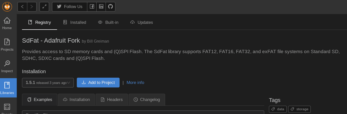

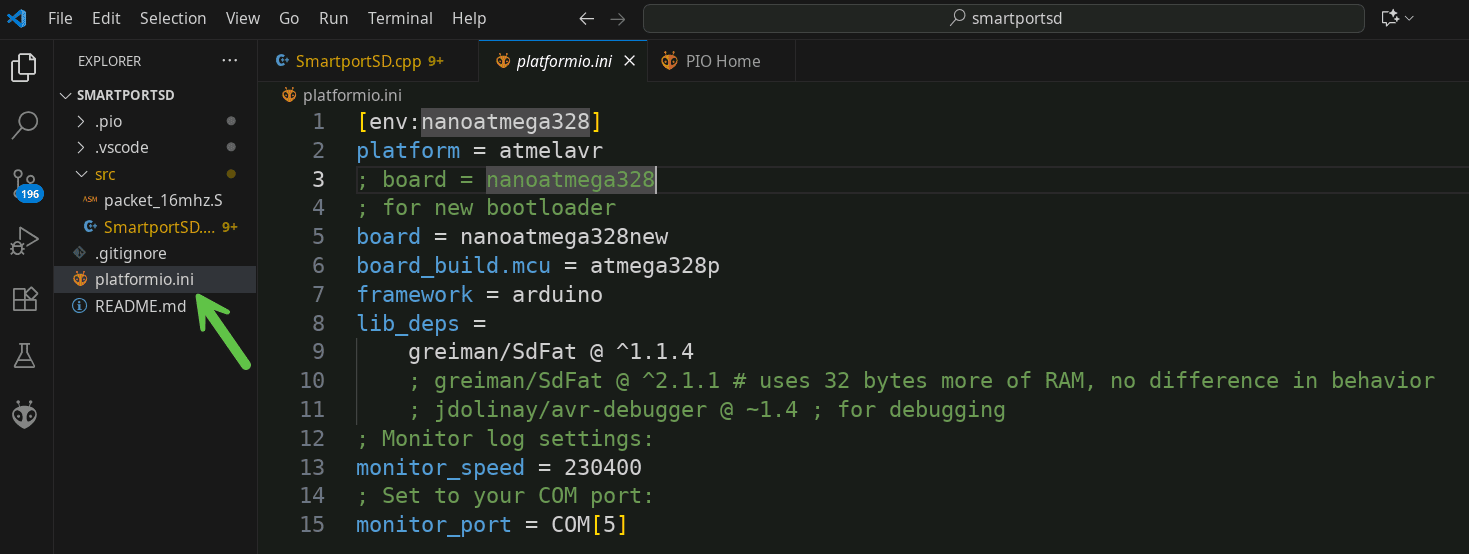

FYI: I added some comments to Chris' SmartportSD inside someone else's issue: https://github.com/djtersteegc/smartportsd/issues/4
We have a few of us that have built these locally and are using the 9-pin connector, and can't get our Apple IIC/IIGS to recognize and boot from the unit.
I can see the initial debug messages from the initial code, and also can turn debug on with @eric's code on my PC, but when hooked to the IIGS, the unit simply isn't recognized as a bootable device, even though the PC debug initially states with both codebases that it sees the valid bootable Total Replay Part1.PO on the FAT32 formatted microSD.
I also see that others are having a SDFat issue with 1.x versions needing to be used, otherwise latest 2.x versions cause errors in compilation.
Hopefully this helps anyone else building or trying to use these to know what other people are going through right now. I plan on keeping my post here updated and/or the issue updated on Git (or opening a new one if Chris wants me to) so that others can utilize it if needed for reference. This post and Chris' repo seem to come up first when a search is done in Google.

You're using too new a library and Arduino IDE. The original code was written for Arduino 1.8.X and the FAT32 library from 2021. Newer IDEs and libraries depreciated many of the functions in the code, hence the "Compilation error: use of deleted function" error you're getting.
Eric's more updated code was ported to PortIO to make it more current. Use his code from his Github repository here: https://github.com/erichelgeson/smartportsd

Thanks @Stinkerton18 for your help.
I have now installed both vscode and platformio, along with library adafruit/sdfat. I did also with Greimans original(?) library, but that produced even more errors.
Now when building the project I get

It looks like you have the newest SDFat library version. How I know is this line from your logs:
|-- SdFat - Adafruit Fork @ 2.3.54
EDIT:
The oldest available now is 1.5.1 though from the looks of things, which is much newer than what Eric was using originally:
I'll try back leveling to this release and see if the code compiles.

Alright, test done, compiled without incident and PlatformIO/VSCode downloaded the appropriate version of the greiman (not AdaFruit) SdFat library.
I did the following:
  1. Installed VS Code from this link: https://code.visualstudio.com/
  2. Installed Platform IO per their instructions here: https://platformio.org/install/ide?install=vscode
  3. Waited for Platform IO to finish its install, though I had to manually install python3-venv myself.
  4. Cloned Eric's github repo to a folder on my computer (you need the entire repo)
  5. Opened the smartportsd folder in VS Code (File -> Open Folder)
  6. In the "Explorer" window in VS Code, clicked on the platformio.ini file to open it and have VS Code/PlatformIO start the download and setup of the necessary files:
It was, surprisingly simple in my case, especially since this was on a Mint Linux machine. The only manual step I had to take was installing python3-venv.
Did you clone the entire repo from Eric or are you still trying to use the older/original repo?
