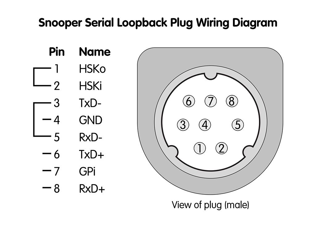

Hi all,
The Snooper software (originally made by Maxa, then later by Central Point Software) used to include a NuBus diagnostic card as well as a small, black, serial loopback plug for testing the serial ports.
I'm not too fussed about the card, but does anyone have one of these loopback plugs, or even a diagram of the plug's wiring? I'd like to replicate it.
I assume it's just connecting the RxD to TxD, but I'd like to be sure.
Thanks,
Bruce

I have one the Maxa Snooper NuBus cards (1.0) … but it didn’t come with the loopback plug. I wasn’t even aware that such a thing existed until now. I guess I need to read the user manual a bit closer.
I don't suppose you could post some nice, clear hi res pics of both sides of the NuBus card please? I'd love to reverse engineer it.

I've figured it out (and made a pretty diagram). I've tested this in Snooper and it passes the handshake and data tests successfully.
I hope it's of help to others.
Hi Bruce, thanks for figuring out the loopback connections. Just wondering if this same pinout also works for your printer port? When I do this on my printer port it is happy with the handshake lines but fails on the data lines. On the modem port it work perfectly.
Thanks.
Thanks.
Hi Craig, yes it's the same for both ports. I've only tested it on a couple of computers, but it worked for both ports on both computers.
