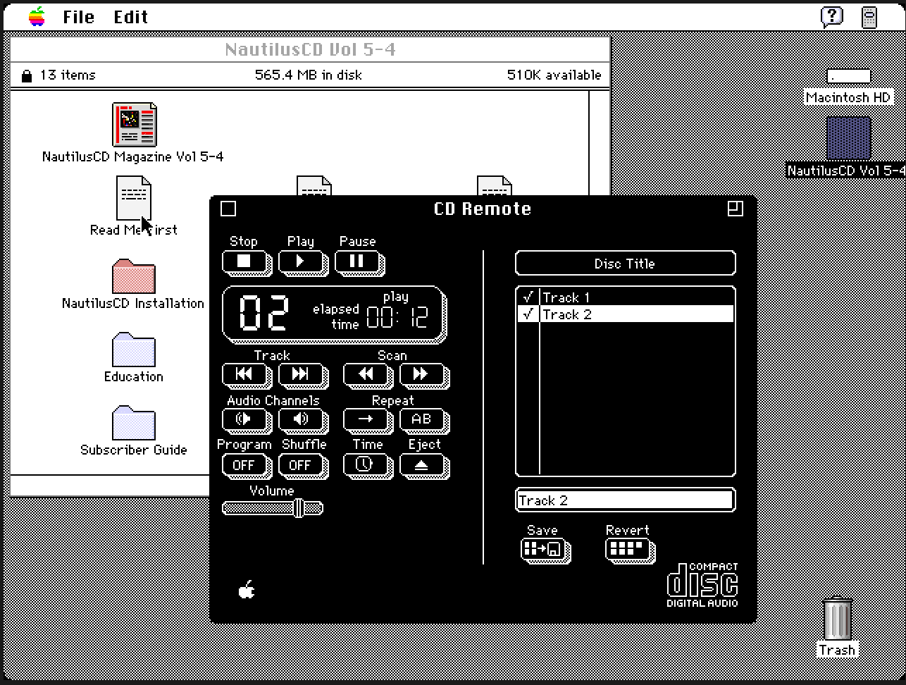

Fantastic -- checked out from your PR and:
Thanks for both the fix and explaining how you researched it. I'd never played around with the Peripherals or Breakpoints windows before; I'm guessing you knew enough about SCSI to know what to monitor?
