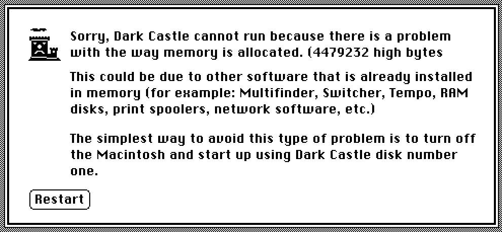

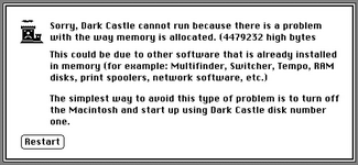

So far, I've not been successful in running Dark Castle or Beyond Dark Castle on my M5126 Backlit Macintosh Portable. I've tried disk images on my FloppyEMU to no avail. I've tried (and failed)running it from my internal BlueSCSI, even versions of Dark Castle that otherwise work under System 7.5.5 in Basilisk II.
The problem that happens is that I either get memory error dialogs when launching, or it will launch but with the screen garbled. I've tried System 6.0.8 (both with and without MultiFinder loaded), and System 7.1.

  • I built a custom Mini vMac "variation" app using the Mac SE as a base, 1MB RAM, and 640x400 resolution. I get the standard memory error when trying to boot from the Dark Castle *.dsk image using that app.
    Same memory error occurs if I boot from a S6.0.8 *.dsk or MacPaint 1.5 floppy with even older OS. (Meaning, I later mount the Dark C. floppy on the Desktop and double-click the game, then get the memory error.)
  • Booting from a System 3.2 disk or a System 2.0 disk, then mounting Dark Castle separately at the Desktop, results in the same memory error.
  • I created a Mac Plus 1MB variant of Mini vMac with 640x400 resolution, but I get the same Memory related error.

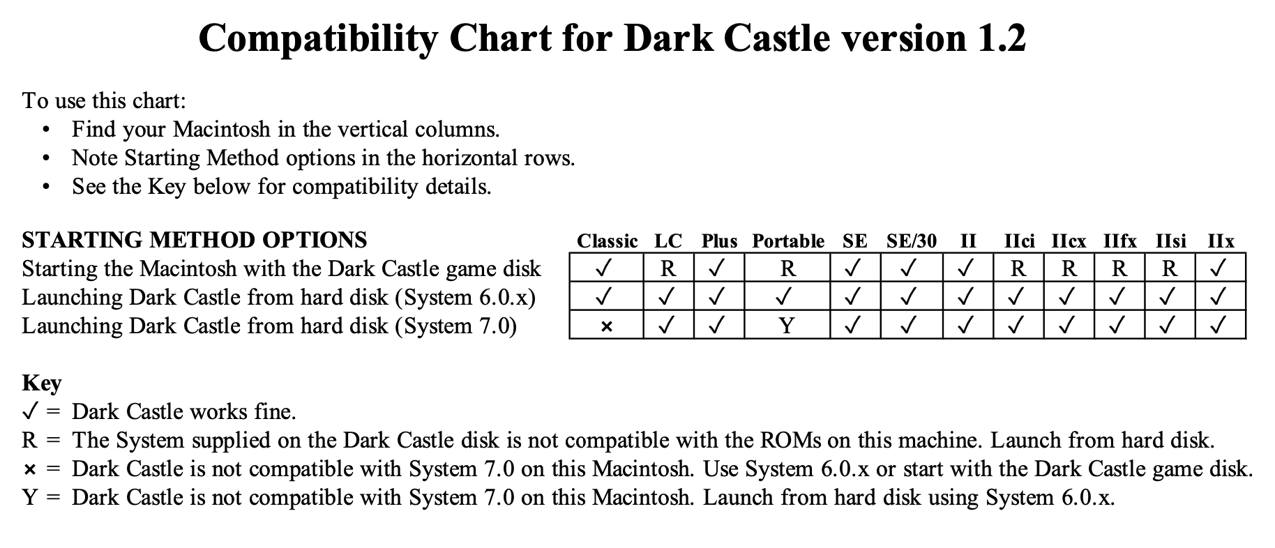

The amusing thing is, v1.2 from Macintosh Garden includes this compatibility chart which mentions the Portable...
But I confirmed in System 6.0.8 that chart is wrong (at least for the M5126 Portable) because I get a garbled screen when Launching Dark Castle v1.2 without the hack. With Ryan Schmidt's excellent hack, it works fine.
