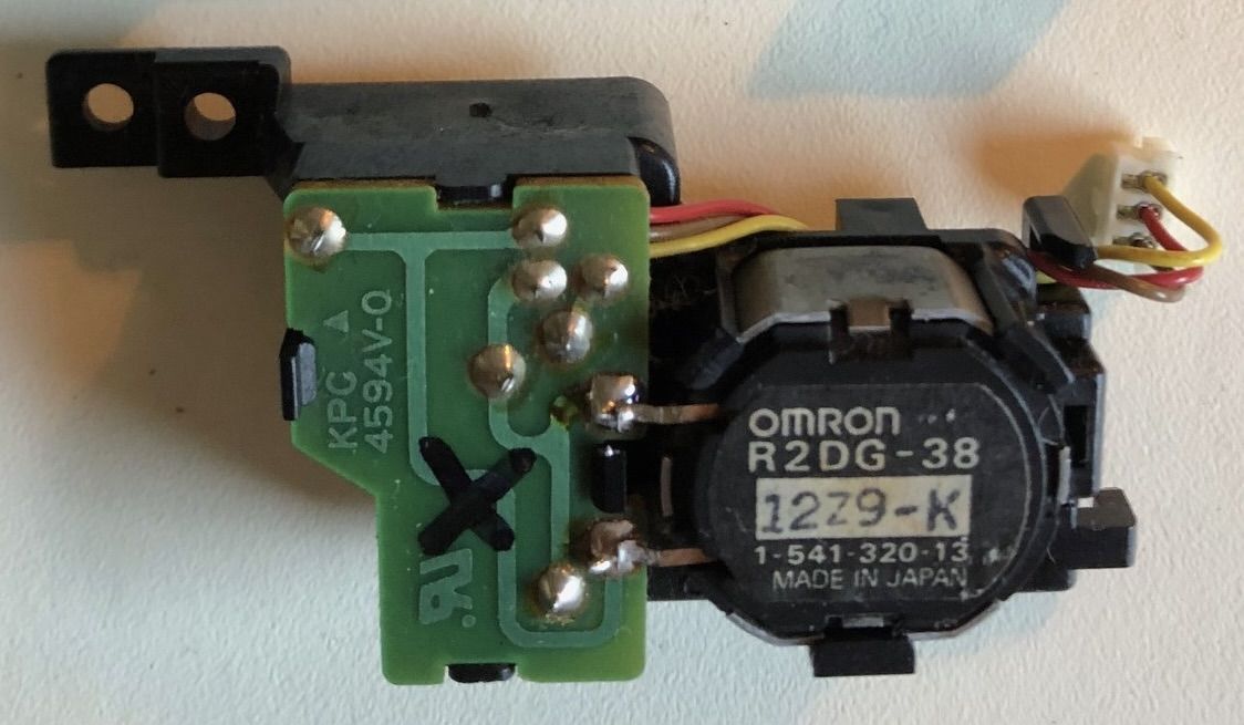

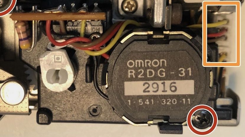

On this problem drive, one difference is it has the OMROM eject that does NOT have the lobed cam + switch. It's all internal. The drive that works has the little egg shaped cam and switch.
Working drive has:
Problem drive has:
Working drive has:
Problem drive has:
