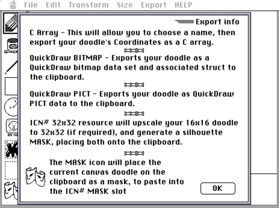

Dedicated EXPORT menu
- C Array
- QuickDraw bitmap
- QuickDraw PICT
- ICN# 32x32 resource

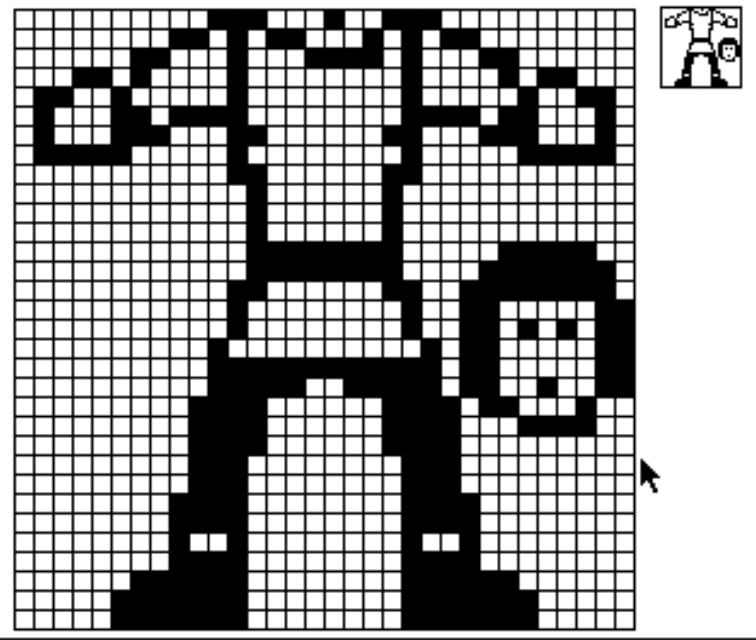

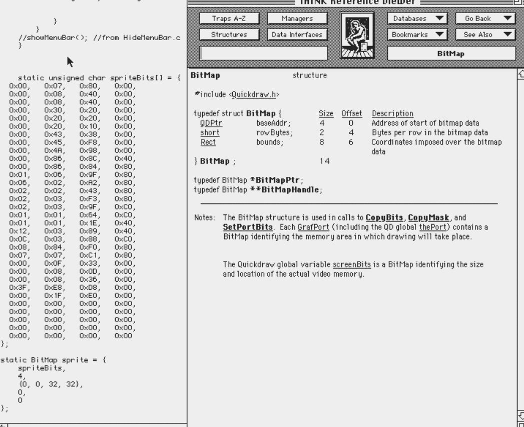

@DW1992 I'm checking out your tool - nicely done! This is a good basis for graphics.
I'm wondering about the export to a bitmap structure. I'm guessing BitMap have more elements than in THINK C/Symantec C++, would you agree?
The last 2 elements aren't present in what I have over here.
Suggestions:
-I don't expect the rich selection rectangle + lasso functionality of Macpaint, but at least a simple displacement of the canvas in all 4 directions would go a long way
-custom sizes, but where a multiple of 32 (for width) is suggested
-sprite sheets
-animation tests with play forward once, loop, bounce
-automated mask graphic generation (I have source code on that if you want) that will detect the edges of your sprite and draw something 1 pixel larger in all directions

great work.... what mu0n said... just 1 pixel to the right, just 1
- transparency when copying to clipboard so folder icons aren't square
- copy/paste/cut

Wow! I never expected so many people to fool around with SquirrelEDIT! 🥳
Awesome doodles!
Mu0n, I'm flattered you draw a portrait of me... 😜
Nilobject... I think I need to make the canvas height 12 pixels taller... poor guy! 🙈 Not a good time to loose your head... guess he'll never be the head of a major corporation... 😂
Mu0n, You're right! I didn't even notice the trailing 0,0 elements! No, they aren't suppose to be part of the structure!
Thanks for catching that type-o! I can't believe I missed it! Staring at the screen far too long. lol
C:
    sprintf(p,
            "static BitMap %s = {\r"
            "    %s,\r"
            "    %d,\r"
            "    {0, 0, %d, %d},\r"
            "    0,\r"
            "    0\r"
            "};\r",
            cName,
            bitsName,
            gSize / 8,
            gSize,
            gSize);
Should have been...
C:
sprintf(p,
        "    %s,\r"
        "    %d,\r"
        "    {0, 0, %d, %d}\r"
        "};\r",
        cName,
        bitsName,
        gSize / 8,
        gSize,
        gSize);
All fixed. :giggle:

static BitMap MoonMesprite = {
    MoonMespriteBits,
    4,
    {0, 0, 32, 32}

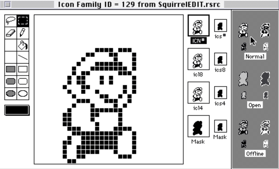

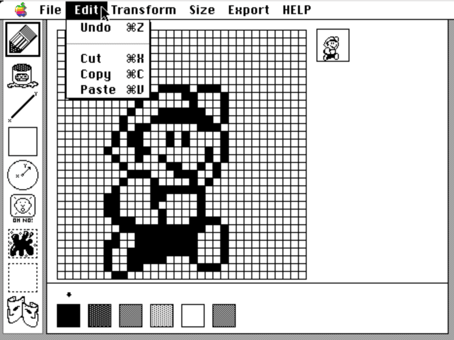

Mu0n, thank you so much for your mask code example, it was invaluable!
I'm still picking through it, but have the basic function working.
Still a (big) work in progress, but making ground! :)
SquirrelEDIT can now generate a mask from your doodle on either the 16x16 or 32x32 canvas.
If you generate from the 16x16 canvas, it will scale x2 so it fits the 32x32 mask ICN# ResEdit slot.
You can click the theatre mask icon 🎭 in the tool palette (yes, proud of that doodle) 😜 🎨
Which will generate JUST the 32x32 mask of whatever is on the canvas...
OR
If you choose ICN# export from the EXPORT menu:
Bytes 0-127 = 32x32 icon bitmap
Bytes 128-255 = 32x32 icon mask
You'll get both in one PASTE operation. 🥳
Right now, it generates a silhouette of your doodle for the mask and won't take into consideration 'holes' within the interior of your drawing.
Stay tuned.. working on it.. need more free time. 😂
Cut / Copy / Paste is also being worked on.
Cut and paste kinda work, but not really well yet... nowhere near something I'd want to release.. or even consider usable. 💥
Copy does nothing, haven't even played with function that yet.
Again... coming soon (I hope...)! Same SQUIRREL time... same SQUIRREL channel! 🦇
Preview screen shots.
My 32x32 Mario doodle in SquirrelEDIT exported using EXPORT: ICN# Export, and the resulting paste into the ICN# resource in ResEdit, with automatically generated silhouette mask bits.
Screenshot 2026-09-22 at 6.18.11 PM.pngScreenshot 2026-09-22 at 6.18.48 PM.png

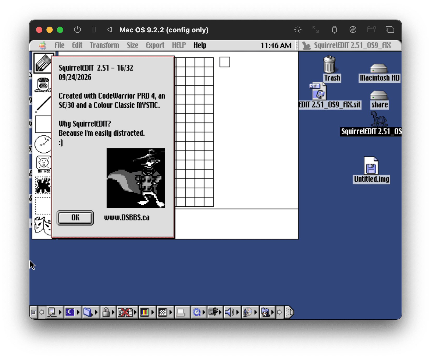

Hi Everyone,
OK, I think 🤔 I have SquirrelEDIT to a point where I'm comfortable releasing it with the new features.
It's still very much a Work In Progress, so lots of changes still to come (and even more bug fixes!) 🐛
I'm releasing a PRE-RELEASE version of 2.51 here.
I'm not posting it to the Garden or Repository yet.
Please feel free to play with this version and let me know what you like, don't like, could be different, etc..

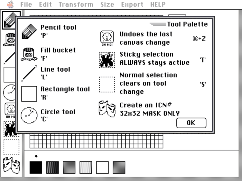

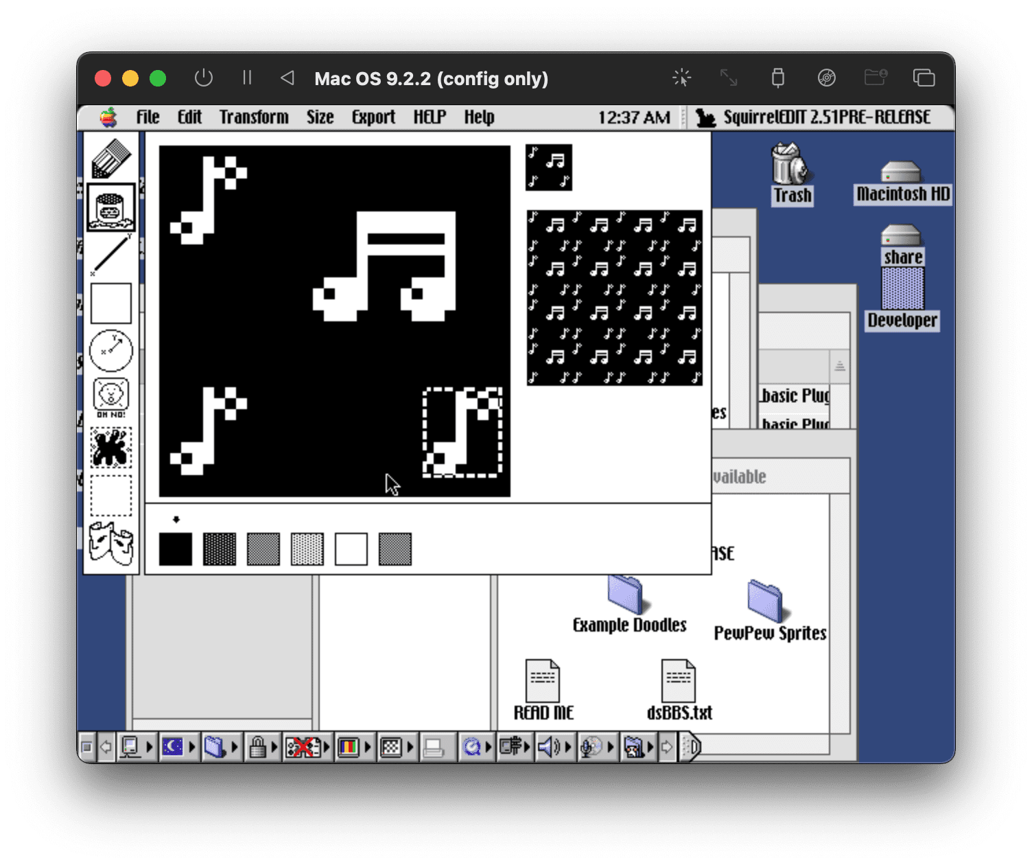

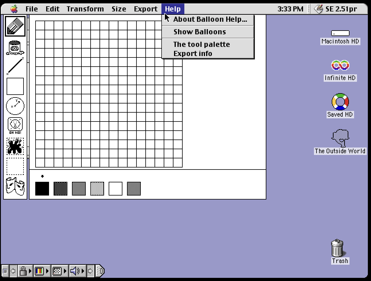

CUT / COPY / PASTE
Yay! 🥳 A working (mostly) cut / copy / paste system!
I tried to make to function similarly to the system in ResEdit's pixel editor.
You can select a portion of pixels, click inside and drag it to a new location, as well as traditional copy / cut.
Selection Marquee (NORMAL)
The NORMAL selection marquee is just what you think.
Use it to select pixels on your canvas by dragging a box around them, then copy, cut, etc...
If you have pixels selected and click on another tool, etc.. the selection will vanish.
Selection Marquee (STICKY)
The STICKY selection marquee is... well... sticky... 😜
The difference between STICKY and NORMAL being, if you have pixels selected and click on another tool, etc.. the selection will NOT vanish.
You can continue to rotate, invert, draw, etc.. inside the sticky section marquee and then copy / cut.
MASK (the theatre guys icon)
In the tool palette, at the bottom, there are two theatre masks 🎭 (clever...) 🤪
Clicking the mask icon will upscale a 16x16 doodle to 32x32 and then generate a silhouette mask of the doodle, placing it onto the clipboard.
It does NOT alter your doodle, and it does NOT include the doodle itself.
Just the MASK silhouette that you can then independently paste into your ICN# MASK channel in ResEdit.
EXPORT MENU -> ICN# 32x32 Resource
ICN# 32x32 resource will now upscale your 16x16 doodle to 32x32 (if required), and generate a silhouette MASK of your doodle, placing both your doodle AND the generated MASK onto the clipboard.
You can then paste your fancy artwork and the included mask as an ICN# resource.
HELP menu
The HELP menu will give you helpful info... 🤪
I hope that helps. 😜

Also, thanks for finding the bug in the top Apple Menu Bar with the double 'Help / HELP' drop downs.
So... after a lot, and I mean a LOT of searching (and I'll admit it, a conversation with Gemini which I try to avoid. lol) I "think" I know what the issue is and how to fix it.
I test up to Systems 7.5.5 on real hardware (and in Basilisk II).
Apparently, starting with Mac OS 8.5, the Help Manager doesn't identify an app's Help menu by its ResEdit name, instead it looks for a `MENU` / `hmnu` resource with the menu ID `-16490` already present in the menu bar.
If it finds one with that exact ID, it just adds "Show Balloons" into the existing menu. But if it doesn't find a menu with ID `-16490`, it assumes you don't have one and creates its own brand-new "Help" menu with that ID and inserts it. Oh so helpful...:rolleyes:
I don't have anything running OS 8 or greater, the newest I have is System 7.5.5
I've tried a little trick to convince OS8.5+ that the generated 'Help' menu isn't needed and already exists, at the same time. System 7.5.5 and down will ignore the ID flag since there is no real menu there and just use m existing 'HELP' drop down...
IF you don't mind, can you test this new build on your OS9 machine?
It should only have 1 'HELP' drop down menu now. 🤞

I'm guessing my clever ResEdit ID trick wasn't so clever if the double 'Help / HELP' menus is still generating... 😢
I'll get OS9 emulated and test out a few ideas on how to eradicate this nuisance Help menu,.

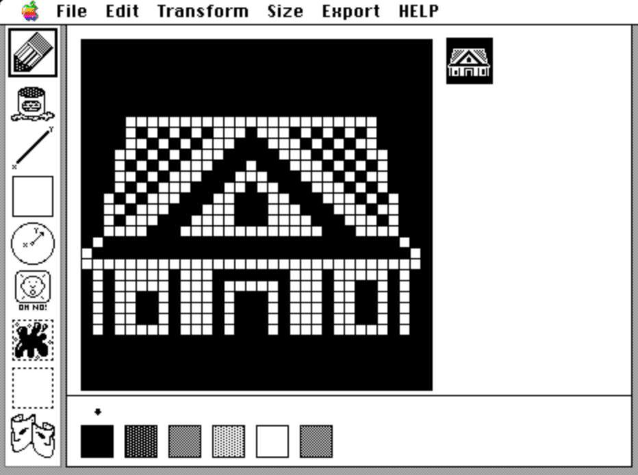

Ok, little update on the HELP menu issue between System 7.x and OS8.5+...
I got it working.
In System 7.x the two 'Help' menu items will appear under the Balloon Help drop down.
In OS8.5 and up, a 'Help' drop down menu is automatically generated containing the two menu items (and the balloon zainyness) 🤪
It's not ideal. I will still look more into your code Nilobject, as I'd like to have the actual 'Help' drop down appear as it's own menu, and not under the lame Balloon Help 🎈silliness, but at least it's working. 🥳
System 7.5.5
OS9
Grab the new version's .SIT in the attachments below.
  • SE 2.51pr.sit
Reactions: nilobject

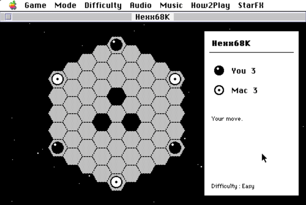

A little sneak peek of the game I'm making.
A homage to an old 1993 DOS game I LOVED as a kid... anyone recognize it? 🤔The parallax star field may give it away... :)
Game logic isn't in place yet, but the board rendering and piece movement / animations are working. 🥳
Horizontal parallax star field, music and SFX are also done, but to be honest, I just recycled their code from my other older projects.. mostly Operation: PewPew. :sneaky:
Planning for player vs computer and 2 player game modes.
1bit graphics, sized for 9" screens and runs on my SE/30 🥳
Probably won't get any further for a bit, heading out camping in about an hour, just wanted to give a little unofficial sneak peek... 🤪
