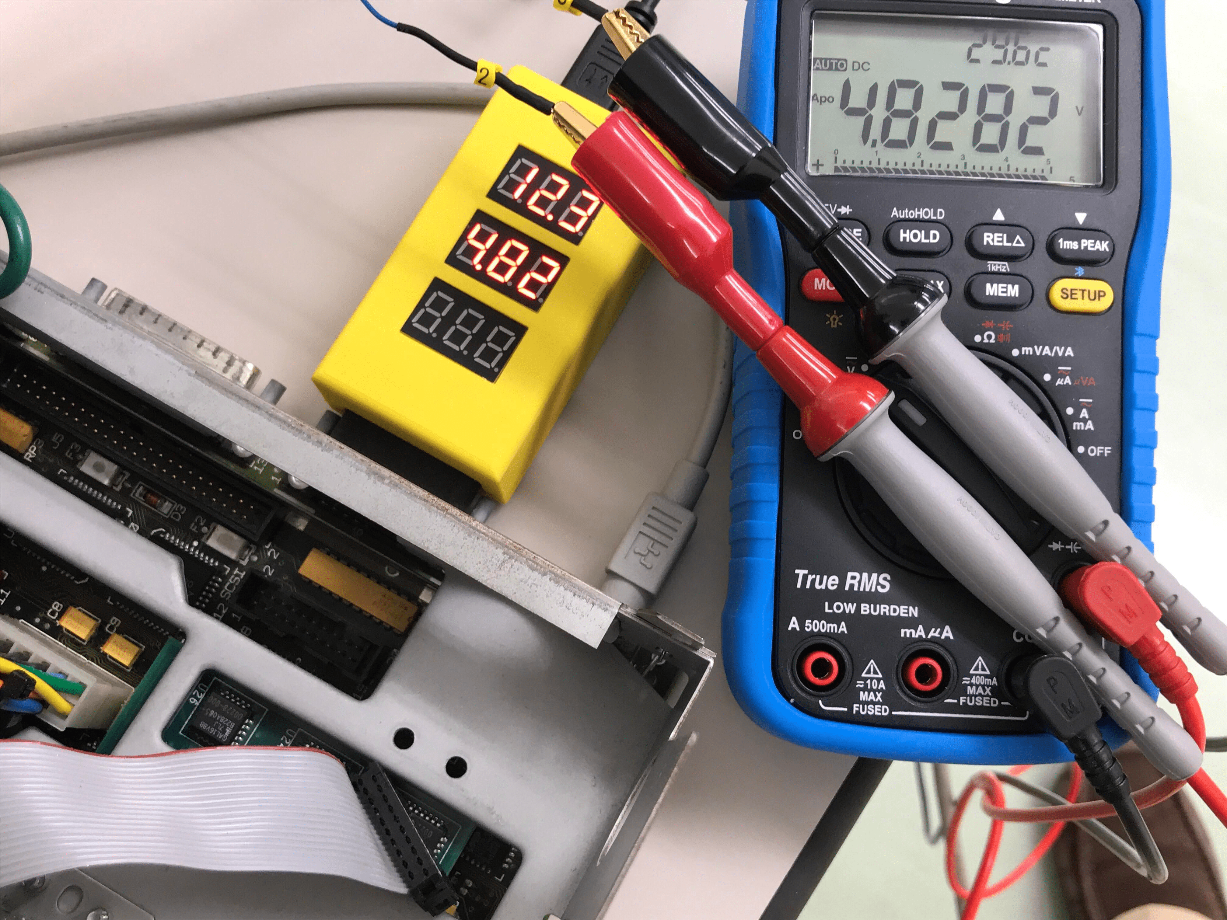

By the way, I also have one of his Vintage Mac Voltmeters, which conveniently measures 3 voltages at the same time from the external floppy disk connector. (On the SE/30, no negative voltage is available.) I am prepping to do a video about that soon. That nifty device is a creation of Will, along with Joakim Larsson (based in Sweden) and 68kMLA member Jake / Jajan547 (based in the USA). I must say it is quite accurate. It was spot on with my EEVBlog 121GW meter. It has a Mini DIN connector that allows a cable to be attached, and it was to that I connected by 121GW in the photo below. Pretty neat little device.

@JDW thank you so much for the positive posts. Yes, the CayMac team is very proud of the meter and see it as a great tool to help. I found it very hard to measure voltages from the floppy port and having to do other work. We have updated the case and the extension adapter to have a better case. The new version will not come with a cable as you can use your own ADB keyboard cable as the adapter has a miniDIN plug on it. I am sure many of us using the meter have a few of these around the place. Lol.
The tash20, I was using the 1825 chip as I could not get the 1704 at that time. I have ordered in total 50 of the 1704 and will start using them instead of the 1825. Note that Joakim had developed his own board based on the fabulous TashTari board to use a different sd card reader and smd items to lower the cost. Our intension is to provide these for others at the lowest price we can while still having quality. We use our own 3d resign printed db19 connector. I will have these back on the site in a week or 2. We will not include a case but you can get the stl and print your own. This again, is to lower the price.
attached are pics of the new meter case and adapter and the tash20 that we call Tash20 Budget.
I again like to thank @JDW and @Tashtari i looking forward to working with you both on any creative tasks ahead.
