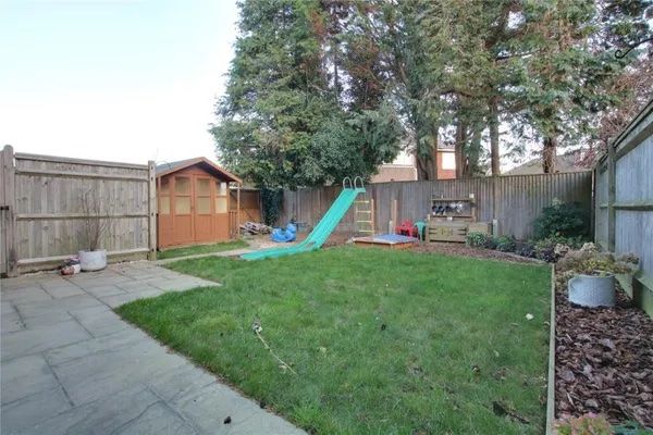

Thankfully there's a photo of the garden as it looked in 2019, that i found here (also handy if you want to ogle the property as it was in 2019, too!):
That's easily an 8x10 shed on the same pad. The water is available from an external hose reel mounted on the exterior wall, so i could plumb in a T piece and have it fed to the shed via flexible garden hose.
