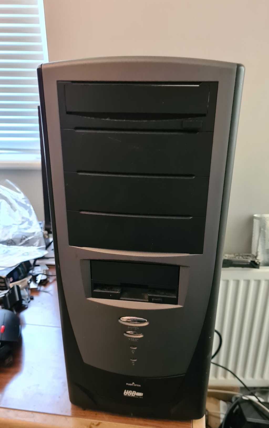

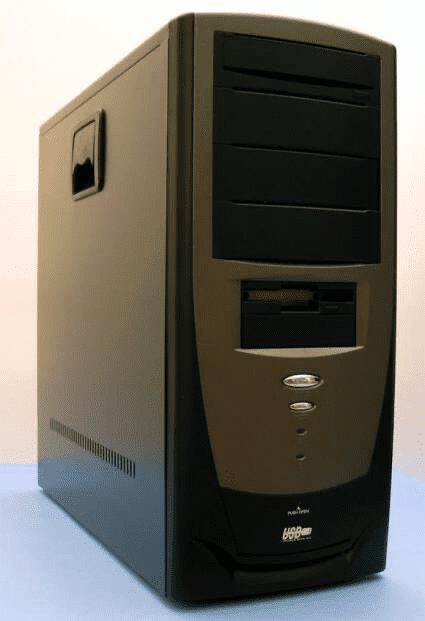

Sold a lot of pcs with this case back in the day, I knew I had at least 1 hanging around , I think I have the bones of a second.
Yours for postage if you want. It would go though normal post as none of the couriers I use will send to uk.
These pictures were taken today.
Oh, wow! Yes! Dm me and let's get this thing built!!
