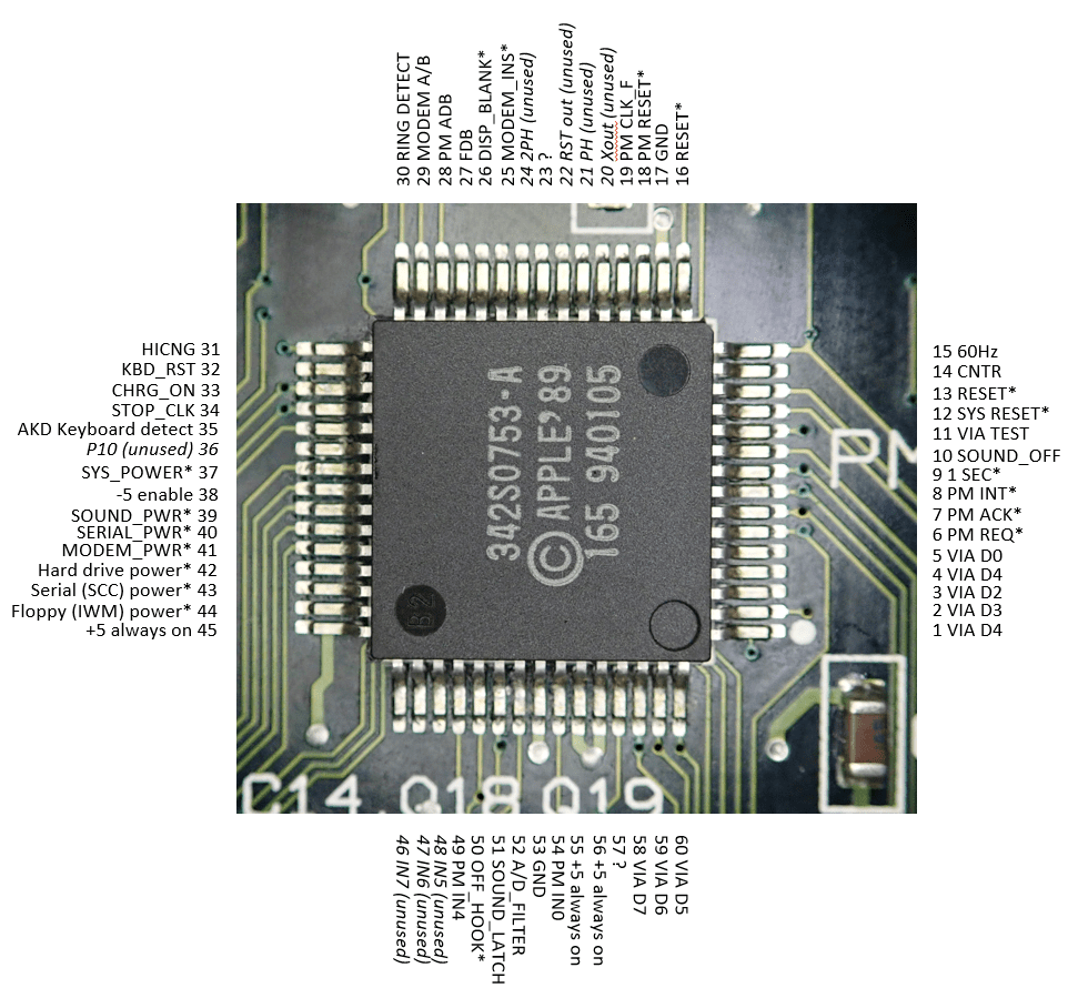

Recap: After correcting the J15 power tap wiring, the Portable stopped booting. SYS_RST*/PMGR_RESET* stuck at 0V, F1 good, PMGR clock running.
Traced PMGR_RESET* (J21 pin 46) to U15H pin 18 — the PMGR's hardware RESET input — confirmed via two independent schematic sources. The physical RESET button doesn't feed this pin directly; it goes to a firmware-read GPIO instead.
Pin 18 is not stuck low — reads 5.1V, matching a direct chip measurement. But even released, no chime, no boot, and SYS_RST* still reads 0V.
A/D battery-sense line (pin 52) reads 2.7V, matching the hybrid's output — no active overvoltage right now.

Chip pin 12 = SYS RESET (confirmed), held cleanly low — not floating, consistent with the PMGR actively running firmware and choosing not to release the system, not a dead chip??
Logic analyzer testing (Rigol DS1104Z Plus + RPL1116), watching pins 12/18/16 plus the GLU source (61/62) simultaneously during AKD triggers: AKD fires correctly (clean pulse confirmed at C116), but nothing downstream reacts — rules out contact resistance in S1 (suggested earlier — appreciated @daanvdl , but the GLU never even attempts a pulse).

Okay here is a new problem. No 12 Volt line.....
Current measurements with bench supply at 6.5V:
  • ALWAYS ON +5V (hybrid pins 11/18): 5.2V ✓
  • Main (5/0) rail (J11 VCC): 5.2V ✓
  • +12V rail (J15 pin 9): ~0V ✗
  • Q14 gate (IRF9230, P-channel): 6.5V = Vgs 0V = OFF
  • Q14 source: 6.5V
  • VR1 LT1070 pin 5 (VIN): ~0V
The hybrid is regulating ALWAYS ON and enabling the main rail correctly. But Q14 gate is sitting at supply voltage (not being pulled low by the hybrid), so Q14 is off, VR1 has no input power, and the boost converter never runs.
