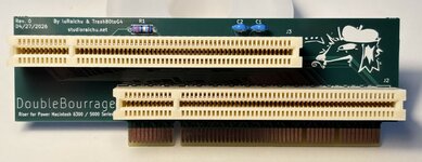

@luRaichu jumped into the project with both feet. He did the board layout, ordered the PCBs, the components, assembled the first one and it's in my grubby little paws for testing! All goes well so far outside of playing whack-a-mole with the gremlins actively undermining my attempts to get a stable testbed up and running.
TwinSlot moniker taken by IIsi card so we're calling this one DoubleBourrage, Double-Stuffer en Francais.
Craziness aside, got the first full test together and it passed with flying colors. Random USB card shows up in TattleTech's PCI Cards report, that's about all I was shooting for at the time. Nice big 1920x1200 main screen. I'd love to see that on a primary workstation with the secondary panel of the TAM active on a KVM setup. But alas, no TAM and no access to its PCI Riser for measurement and adaptation of the board design. Little help there? :unsure:
Need to get OS9.2 set up on another Compact Flash Card before I try to get much further along. Once the Crescendo/L2 is up and running I have all manner of I/O cards destined for the top, set back Slot_B.
Worse case scenario will be one of my trio of Sonnet TEMPOtrio cards, each with two channels of ATA-133, USB and Firewire. They're about the largest cards I can imagine fitting in the top slot. Tested for fit as it's been the aim all along to use one. It PASSED!. Supposedly works in Alchemy architecture, but they dropped support for Gazelle. But PCI Bridge hacks over at the MLA may prove differently?
It fits! But of course I dropped the friggin' CD and killed it. Need to find another one for the OS9 Lives installer.
The trio is a full on seven inch PCI Card and I snaked it in there sweet as can be. If there are any problems with the MedusaMess and SCSI Optical I can just run an ATAPI Optical off the trio with a DOM on the other ATA133 Channel.
Set up my series of cardboard prototypes to just barely squeeze the trio in far enough for short, RA USB & FW extension cables to be snaked out the vestigial PDS Slot opening.
I set Slot_B back another tenth inch to make just a tad more room for the RA cable breakout and it still fits under the CD mess! I have quite a few other I/O cards to test. So it's gonna be a slog before official rollout. It's been a very long time coming, but product release is nigh! :D

Thanks, very cool info about available slots, especially Slot_F1 for ATI in Gazelle. I was under the impression that archicture wouldn't support the Mythical Slot C so it's good to see it does! Next it's on to spelunking for Slot_F1 it seems. Not really expecting to find it supported in the connections on the Riser Slot, but if you can identify the Address line for resistive connection we'd be halfway there.
I'm not expecting any problems at all as it's an exact reproduction of the 6x00 riser. It's scrunched way down to fit in the PCI Drawer Macs with Slot_B1 set back for jumper cable extension to the outside world.
Hoping to create a QuadSlot Riser for the Testbed MiniTower some day. As tested, Slot_E1 connections are jumpered from a dummy CSII card to make room for a Gigabit NIC. ;)

Dunno, all you do is well above my pay grade. I just reverse engineered the 6x00 riser and applied what I'd learned to set up the "Mythical Slot_C" @trag had as the third PCI Slot on one of his clone risers along with a CSII Slot that was taped over.
Apple tied all four interrupts together and came up with their own way of doing PCI, using pins unassigned in the spec . . . Apple! :rolleyes:
Everything is in this AI8 doodle, save for the two capacitor connections we discovered when I took a hacksaw to the connector on a 6x00 riser. Intended to buzz it out . . . but Neolithic Hacker Mode kicked in . . .

I need to get on with seriously testing DoubleBourrage. Yesterday was my first day back to work after a six month hiatus on workman's comp. Hated forced "retirement" especially the first three months of recovery. But I'm back to limited playtime again. Double edged sword that.
Tangent _______________________________________________________________
If there are three unassigned pins remaining on the "Riser Connector. It's "nominally" Slot_A1++ so there's a chance that Slot_F1 can be activated on the riser. If not, you may be able to find the necessary signals/pin legs in the schematic? In that case, three bodge wires to the board components should do.
Four Slots using the jumpered CSII signals for Gigabit NIC will be very cool. Hrmmm, I wonder if those three lines missing signals are implemented on CSII?

YAY! You got me thinking outside where I'd boxed myself into only using Slot B_1 for USB/FW! :D
I can just as well throw a second VidCard in there for a three screen Alchemy/Gazelle machine as my test case for TwinSlot!
