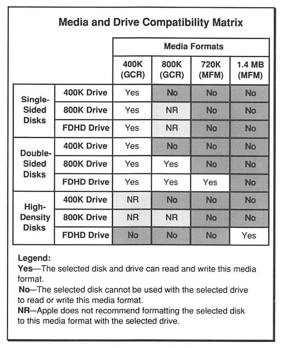

Thank you for this, this matrix is quite useful. But I am a little bit confused still about whether or not I can use 800K diskettes in a 1.44MB super drive in a powerbook 170. Sorry for asking this again, I am very new to all this, and I am trying to get a simple and straight forward answer to this question.
I would be most greatful for a yes or no type of answer, but if there is more complications than that, can you at least start off by saying yes but or no but?
I just found the answer in one of my other posts.
The answer is yes, the powerbook 170 floppy disk drive is 100% compatible with both 1.44MB diskettes, and 800K diskettes.
1,547
Which means it is compatible with 400K disks too, but whether or not it requires an HFS formatted disk is something I do not know. The oldest 400K disks were MFS (Macintosh File System). Keep in mind it is possible to format 800K disks as MFS too. So if your drive cannot read any MFS disks, then some 800K disks might be included in that.
