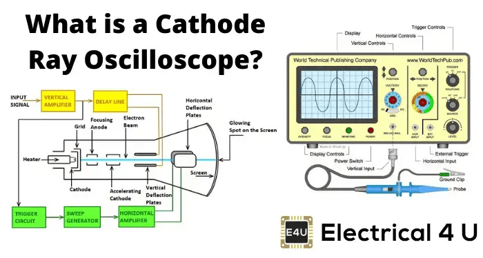

A Cathode Ray Oscilloscope (CRO) is a fast X-Y plotter that can display an input signal versus time or another signal with luminous spots produced by striking the beam of electrons, and this luminous spot moves in response to variation in the input quantity.
Source: Cathode Ray Oscilloscope by Electrical4U
I didn't make the distinction because I take the point of view of a physicist and all I need to lump them together is to see a step where electrons are made available with heat, then they're accelerated in vacuum inside a tube and their path is tweaked with electric and magnetic fields (fields are either generated with regulating circuits or with signal circuits) until they hit a phosphor target, bump up atomic electrons, and when replacements/cool down occur come back, that transition emits light.
I don't expect someone to be able to plug RCA composite inputs to an oscilloscope and watch tv or play a NES, aka I don't take the point of view of a marketplace TV consumer at large.
