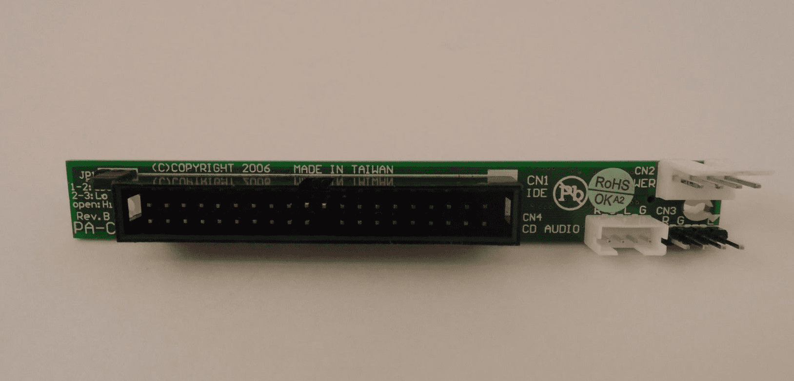

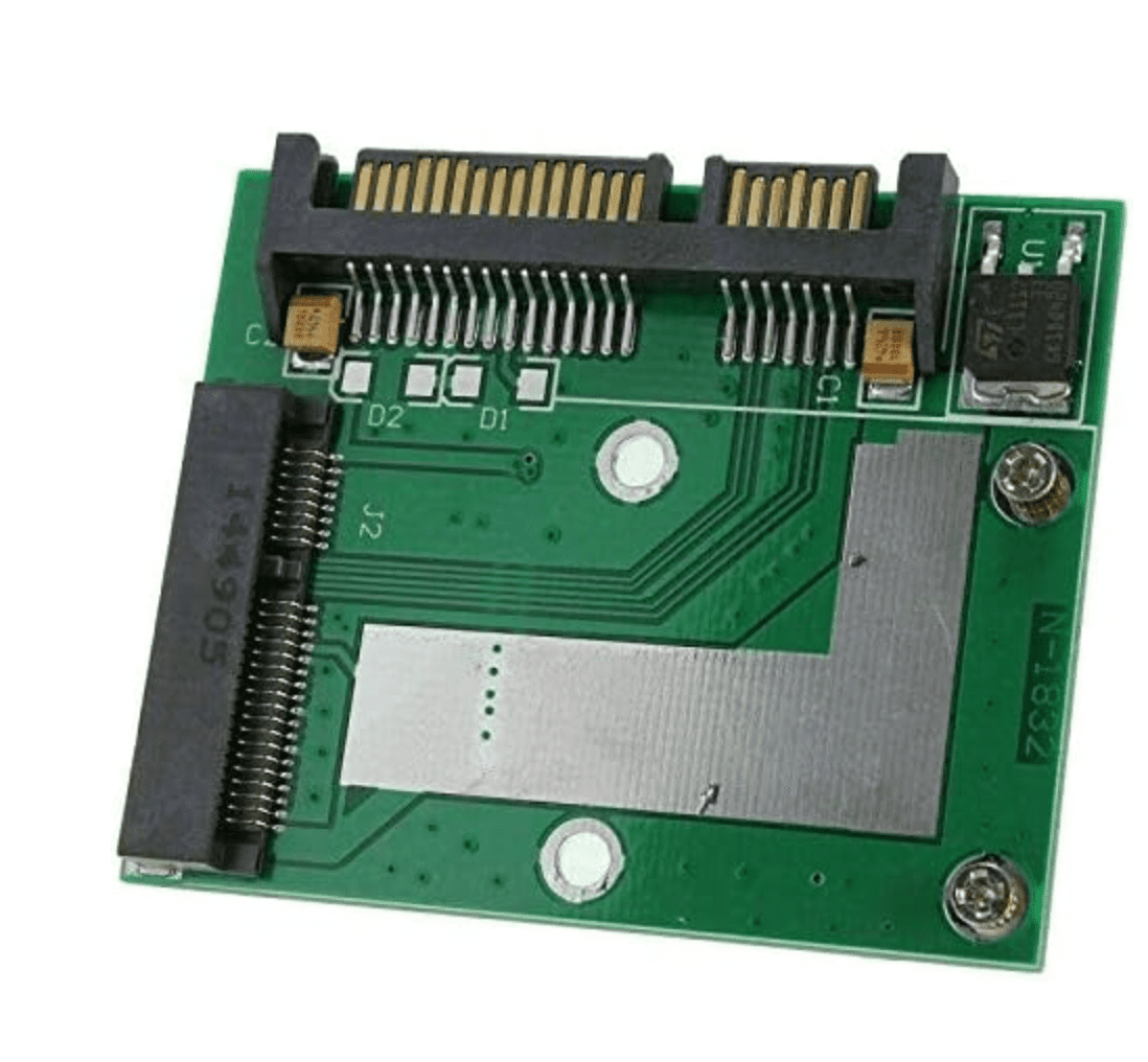

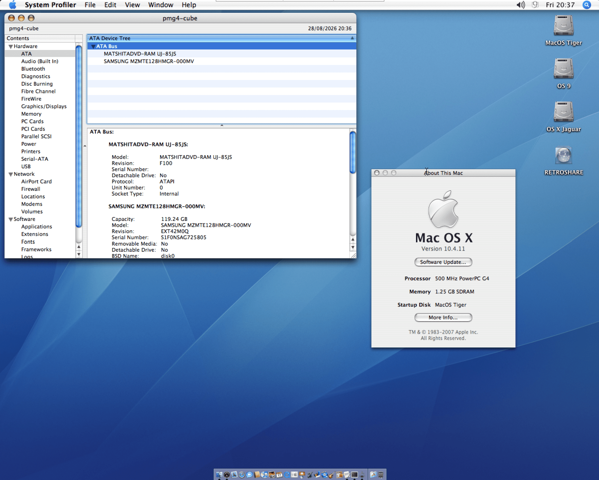

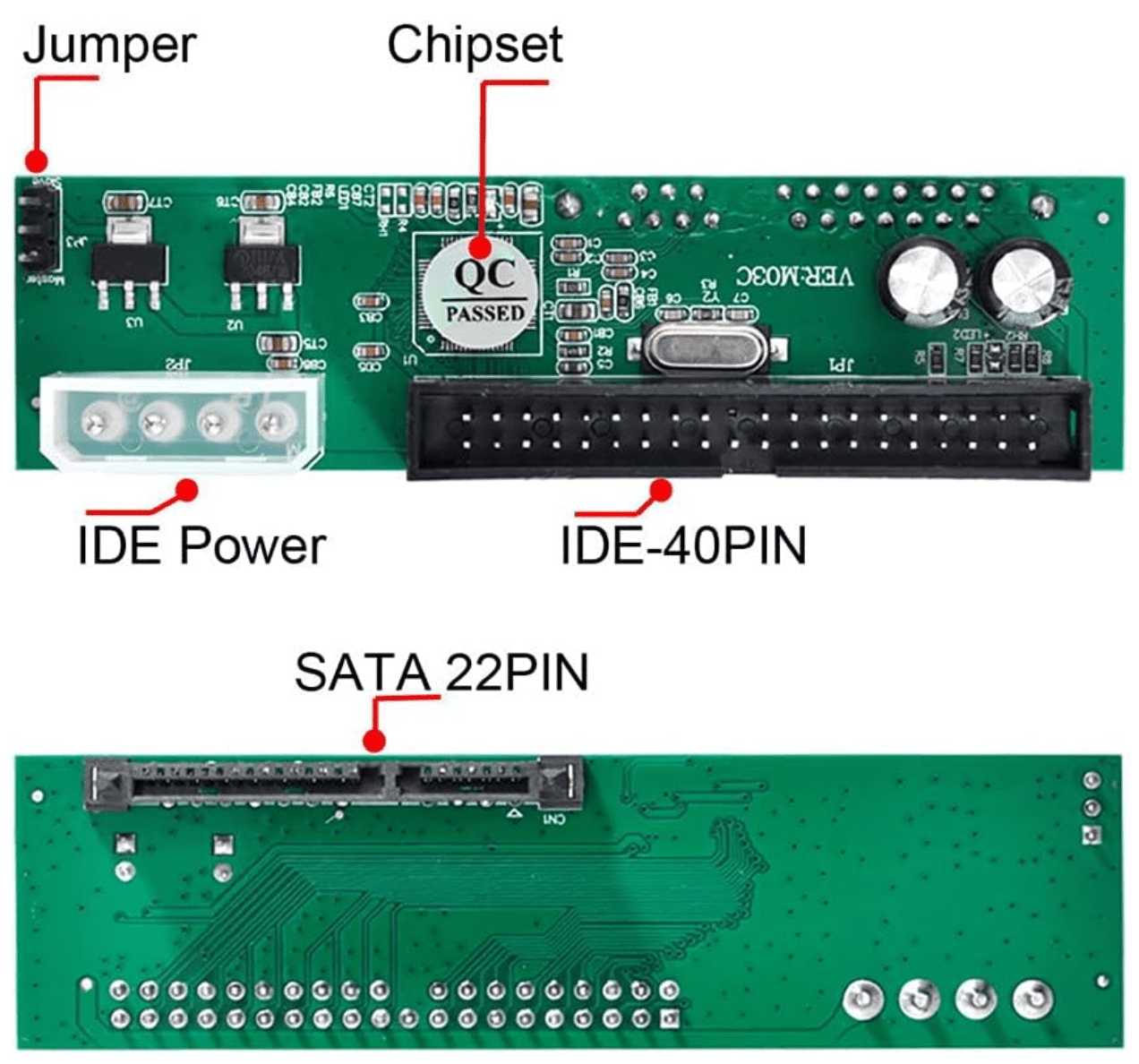

Hi, not to hijack a thread, I thought I would add my experience in case it helps anyone else - I had a load of bother retrofitting a particular drive and making it work with my SSD.
I started with a pre-existing setup of a dodgy SuperDrive and a Samsung MSATA 128GB SSD, plugged into a Startech IDE2SAT2. As soon as I introduced a Matshita UJ-85JS (seems like it came from an Acer) on a Supermicro SCD812, problems galore. I couldn't find my boot drives, no matter how much I fiddled with jumper settings. I even tried desoldering the cable select pin from the SCD812 and had no joy.
To skip to the combo that works for me, an Ablytech ATAPI-to-IDE adapter in Master, with this generic IDE-to-SATA adapter off Amazon in Slave. Works perfectly every time, survives sleep in OS9 and Tiger, and I now have a working DVD drive again.
Pics of the adapters attached (not mine - fair use applied) so folks have a visual reference of what I used...
As a point that may help some folks with thermal throttling, I added some thermal pads to the back side of the SSD to transfer heat to the mSATA-to-SSD adapter. Works well and worked fine (no throttling) when restoring a disk image (128gb) to the SSD.
