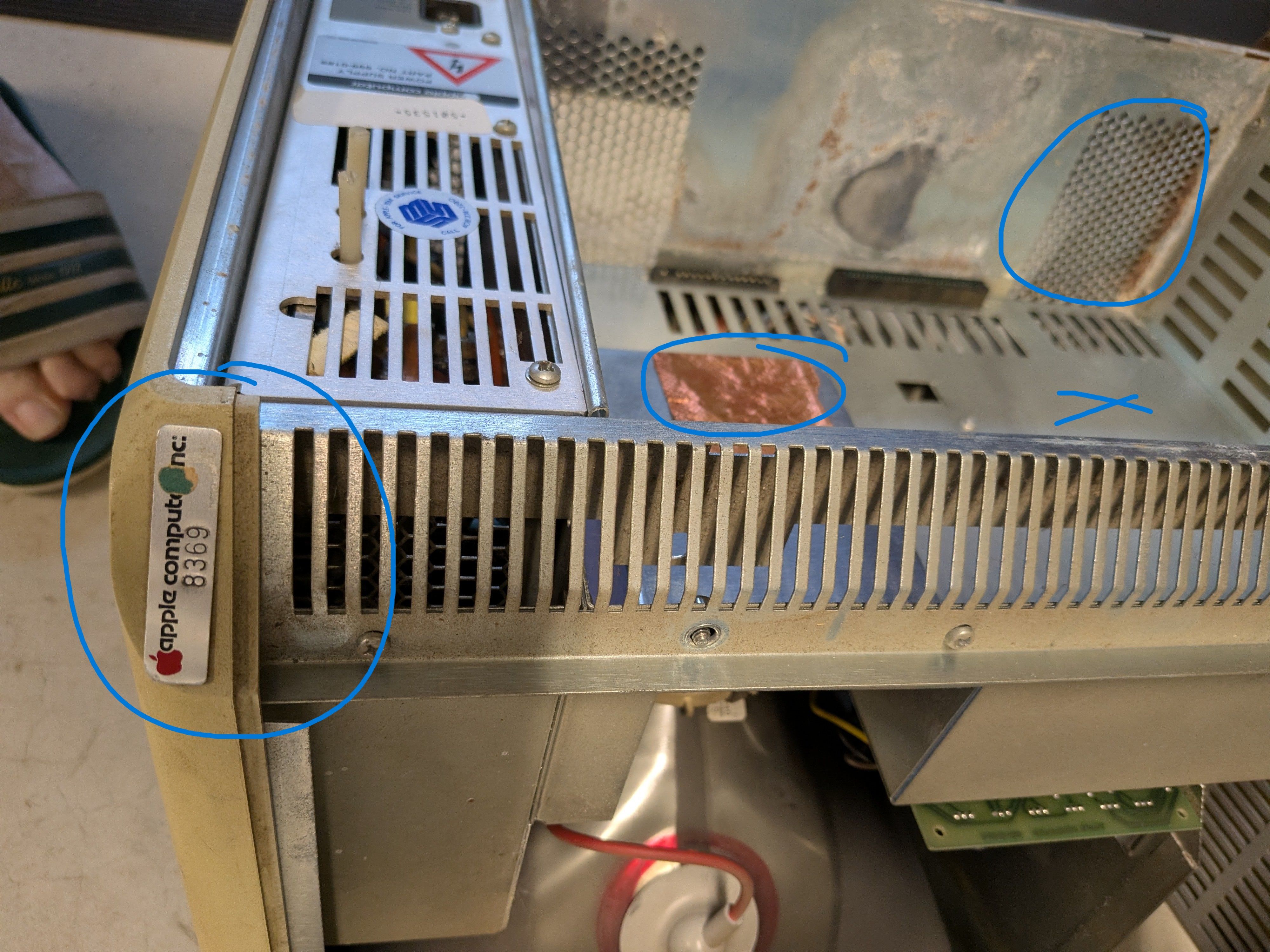

First, an Apple inventory tag:

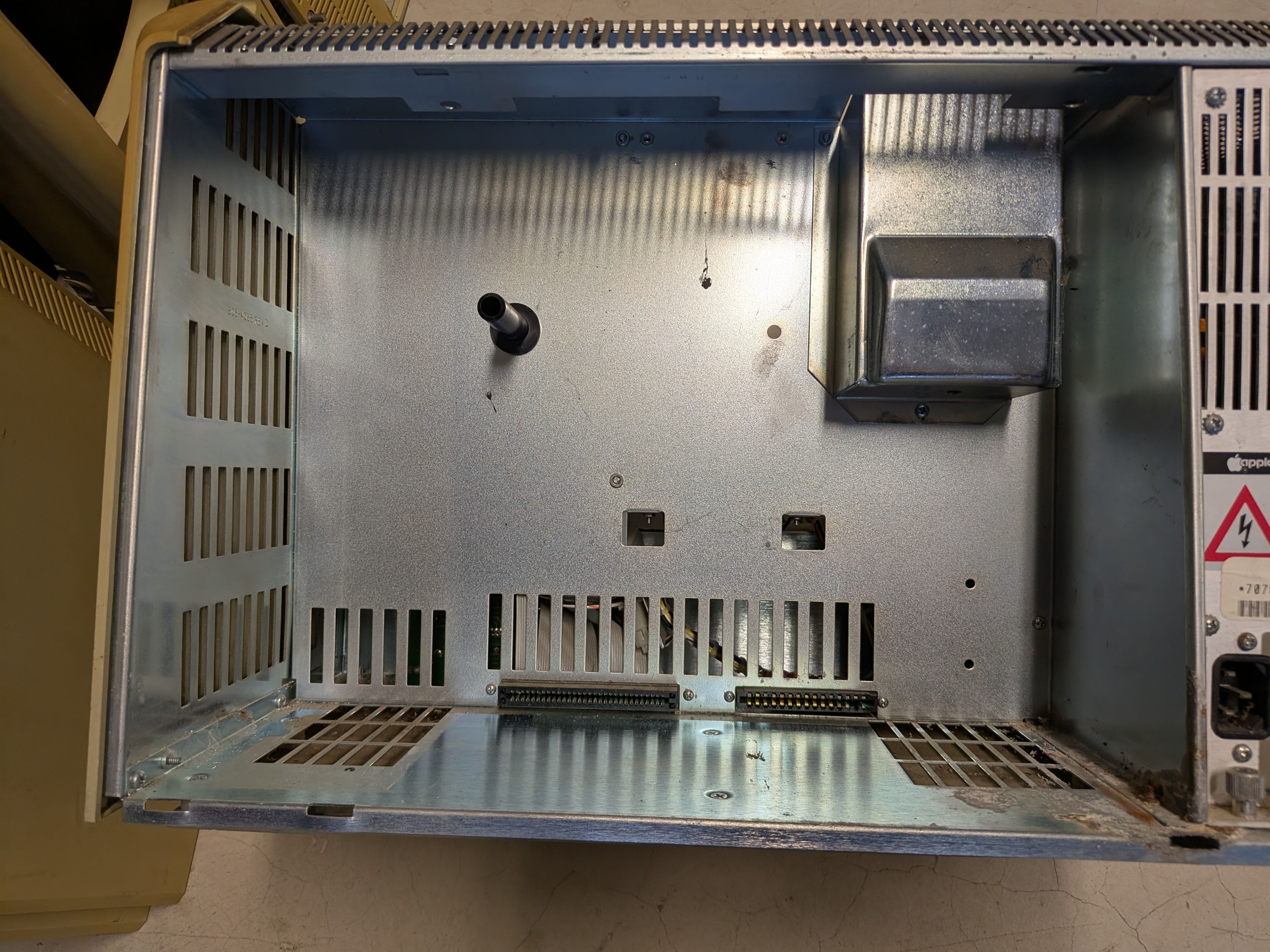

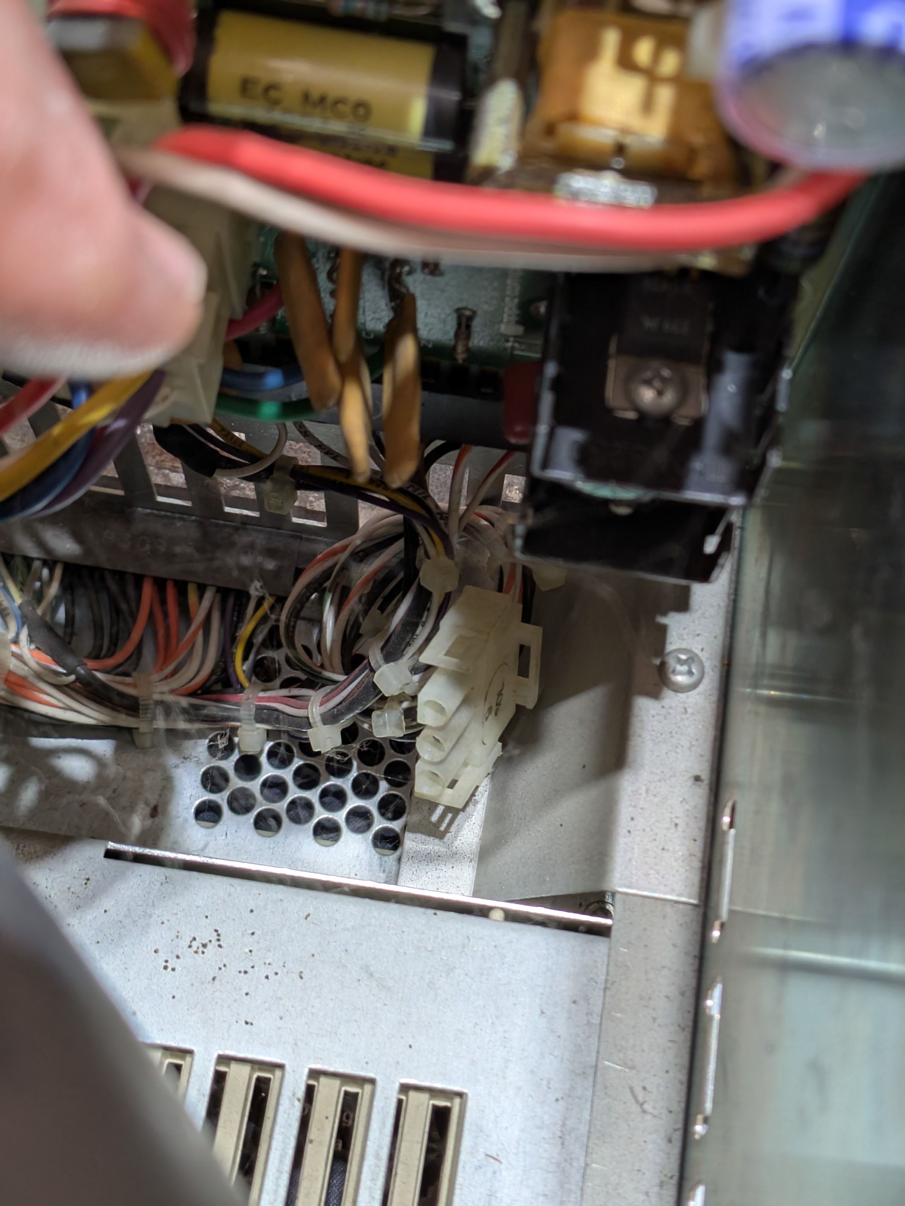

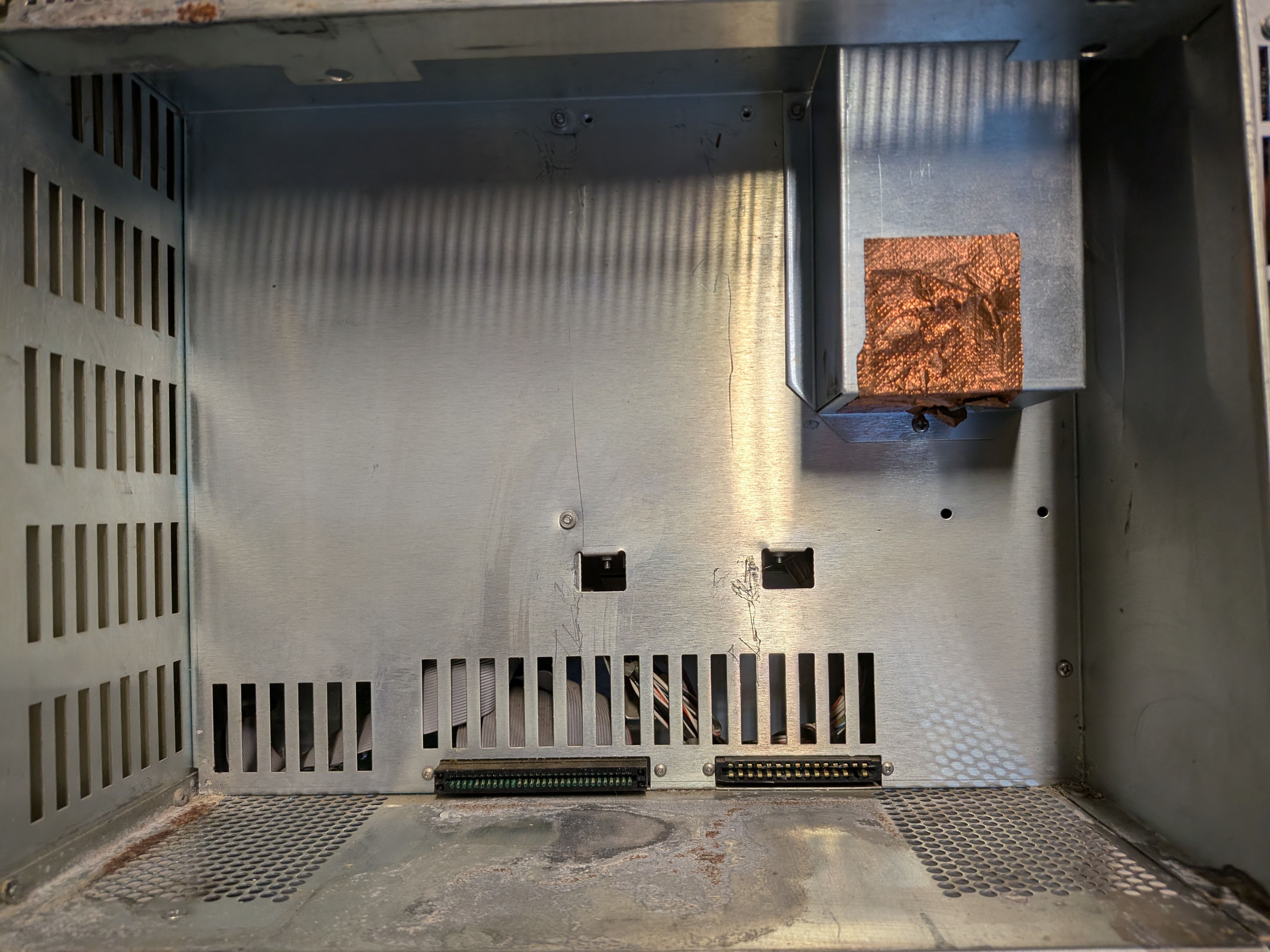

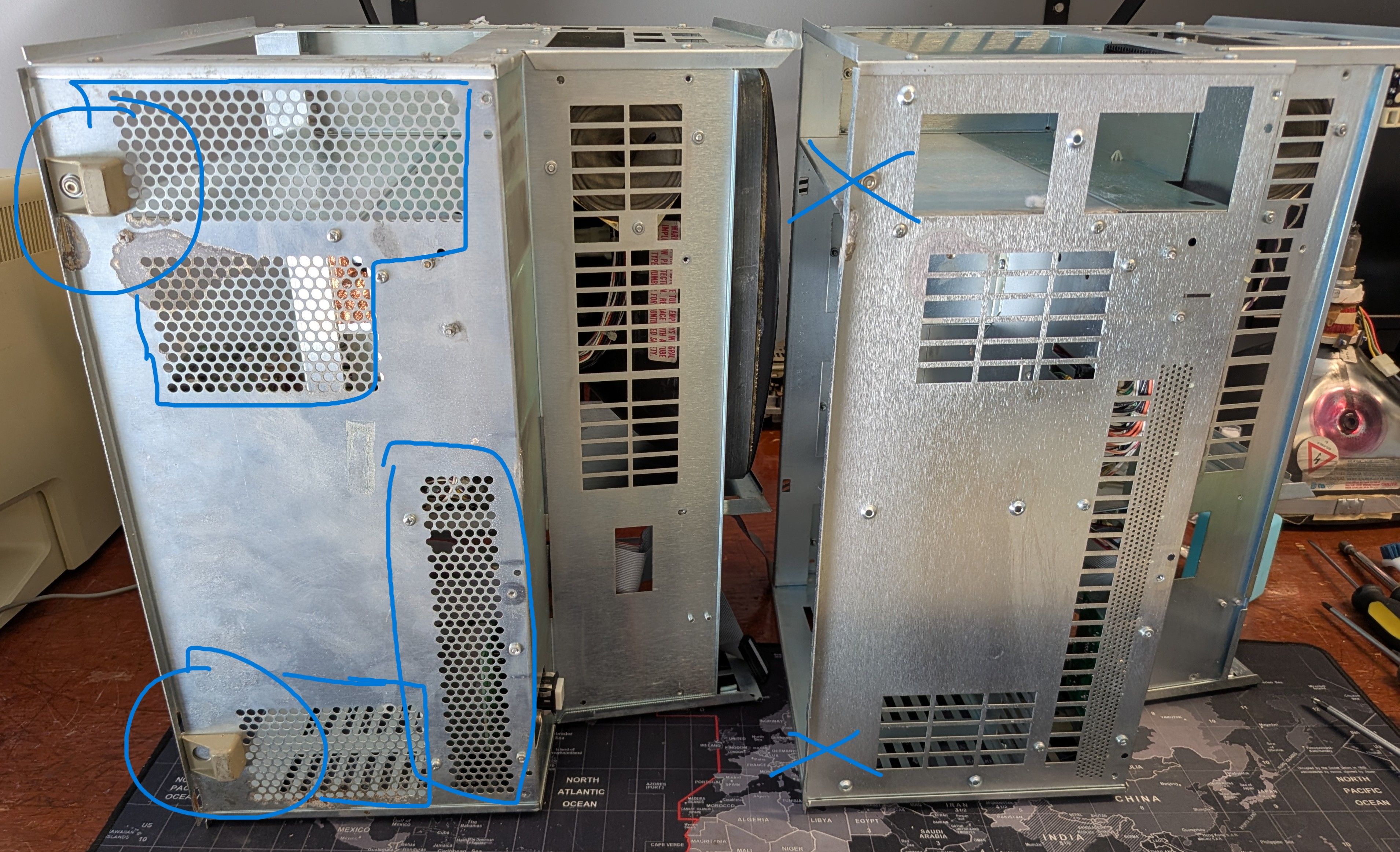

Second, some oddities in the back bay, including a CRT neck opening without the usual cover (it looks like one was not present) that is now covered with what appears to copper tape, NO black plastic tube, and a different set of vents cut into the sheet metal (round vent holes instead of square vents on the base), there are also two round holes beneath the CRT extension that are horizontal and high as opposed to vertical and low.
The machine in question left and 'normal' right.

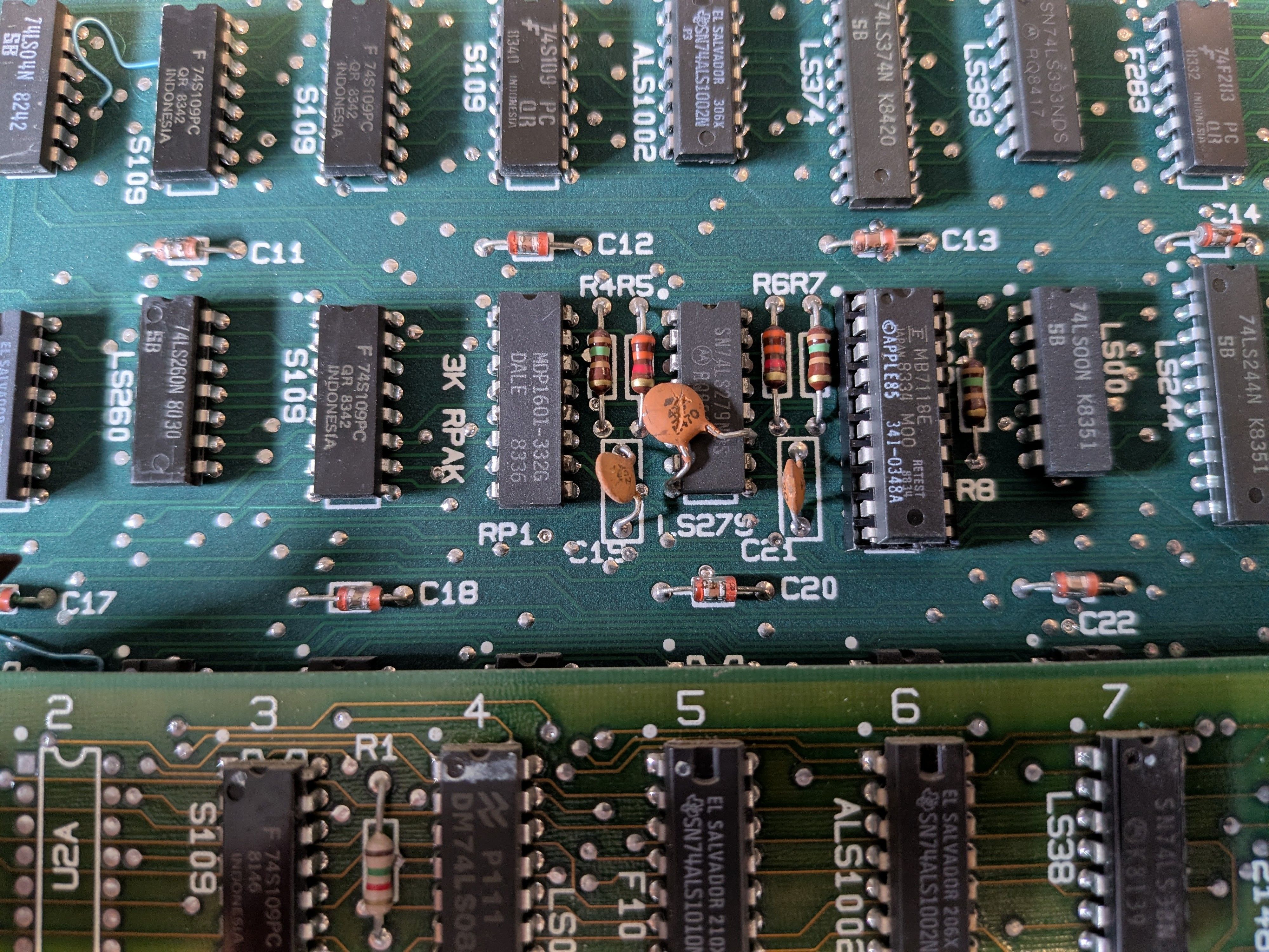

And, finally (at least so far) and bit of weirdness on the CPU board at S279:
