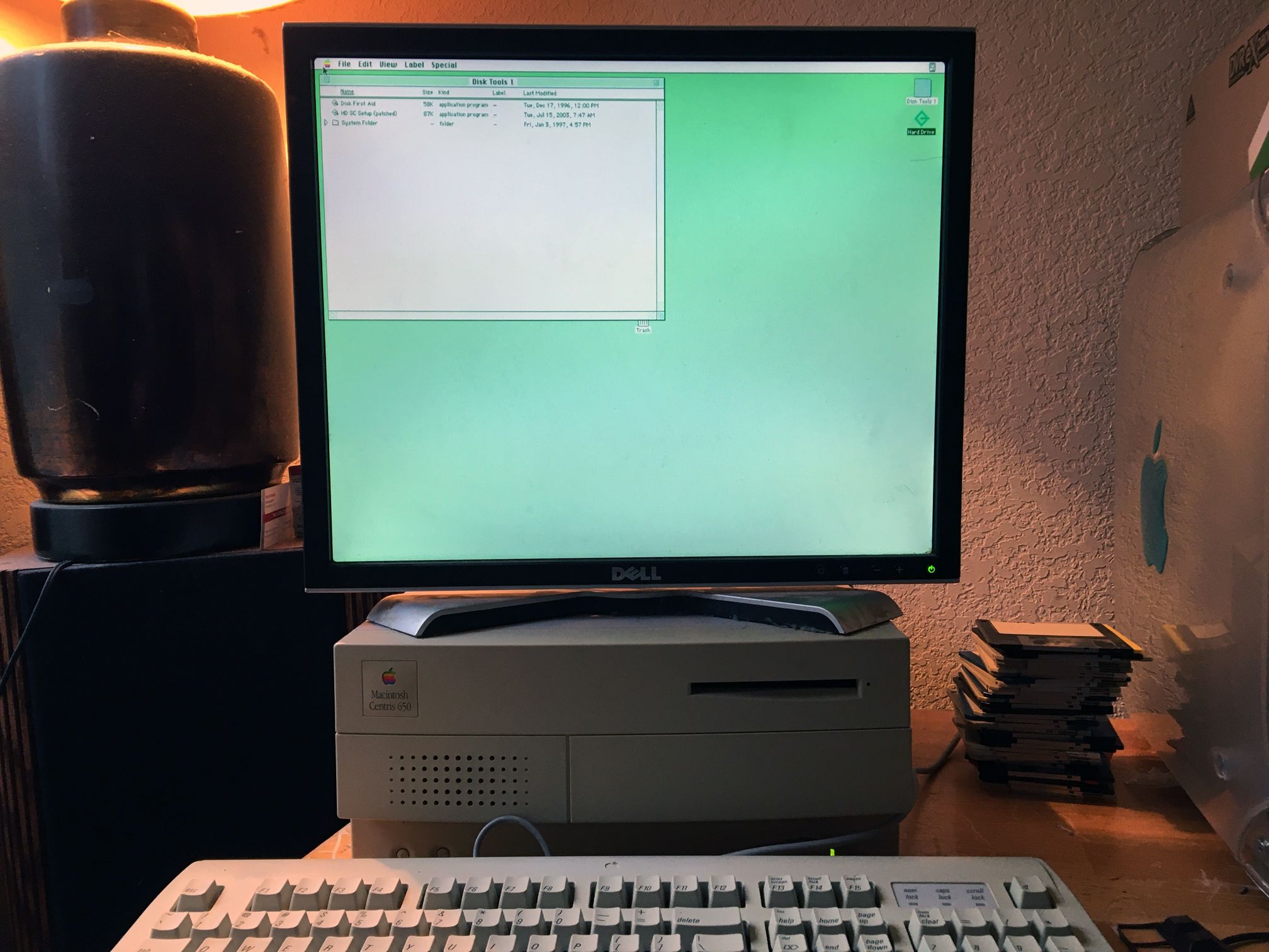

Turns out I have several and didn’t realize it because I thought they were too new. I had grabbed some Dell LCD monitors they were scraping at work and their data sheets say they do sync on green. If my IIci power supply wasn’t currently disassembled for re-capping, I would put it to the test.
