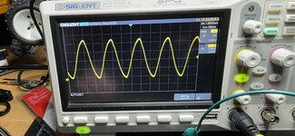

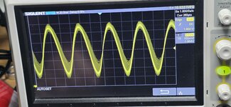

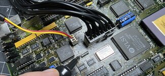

SE/30 Y3 Crystal Replacement Recommendation?

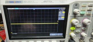

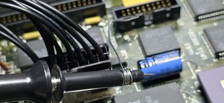

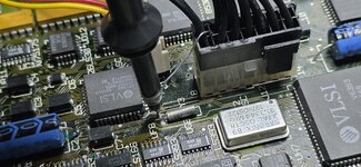

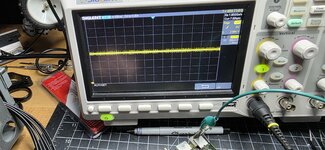

I made the shortest ground I could. Stuck it in the main power connector ground: Wave form is about the same as the long green...

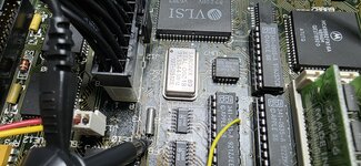

When you watch that video I linked for you, ignore his use of a buffer and hex invertor. That isn't relevant. I merely linked it for...

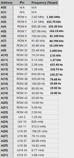

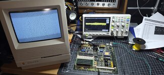

Put in some time today going through the CPU walking the bus tests. I'm now getting all of the square waves that should be found between...

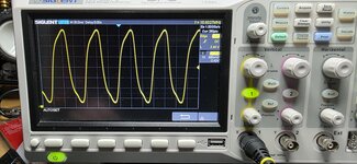

GreenBar0n

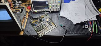

I have been working with the Simasima Repair Guide for about three days now, I'll post some things I found, approaching it from a new...

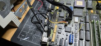

Adding a long green extension lead like that for Ground is a huge no-no when making HF measurements, but I must go further to say that...

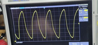

I shortened my probe ground lead, or got rid of the extension I was using - this green one: And used only the ground lead the probe...
