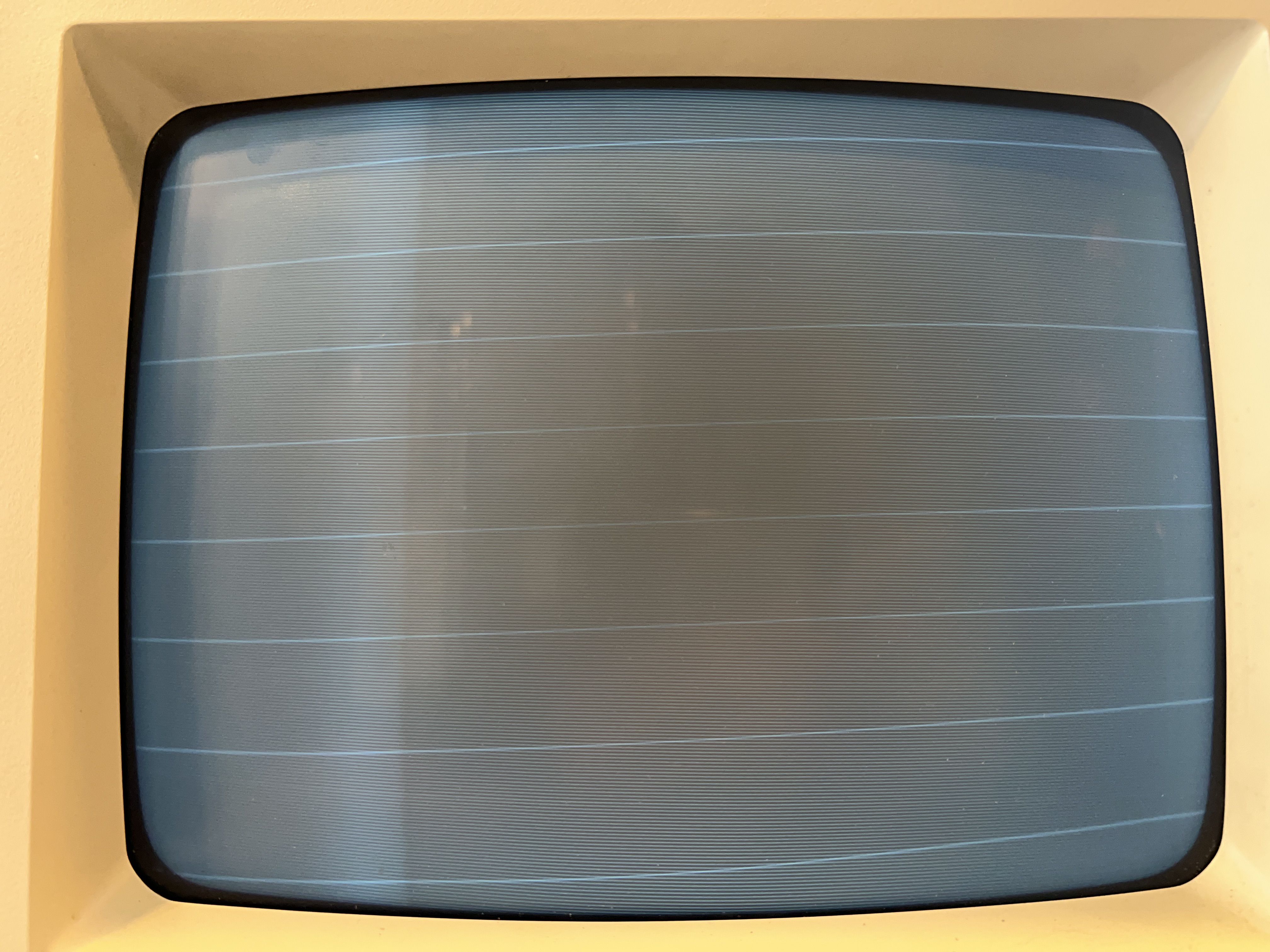

I discharged a 128K Mac without a bleeder resistor and manage to damage it. At first I got a chime but no raster at all. Per Macintosh Repair & Upgrade Secrets, I replaced the LAG chip on the logic board and got raster lines but a dark screen. I then replaced U2 on the analog board, but the issue persisted. I had previously reflowed all of the solder joints and swap tested with another J4/J7 cable assembly. Nothing on the analog board is visibly burnt.
Any tips on what to check next?
Here's the part of the book I referenced. I think he's got the symptoms backwards though. The logic board works fine and even if I install another known good logic board, I get a bong and screen with raster, but no floppy icon. So the issue is with the analog board, but not U2 since it was just replaced with a new part.

Update: +12V, -12V and +5V are all testing okay at the floppy port. Next I'm going to try to check components downstream rom U2 on the analog board.

Nearby resistors all tested okay. There is a 2N5485 (Q5) off of U2 pin 3 that shows resistance between source and gate in both directions. I'm not sure if this is because my meter isn't suited for it or if the transistor failed, but I've ordered some replacements to try.

Update: Replacing Q7 changed the symptom to a vertical line (collapsed horizontal deflection). Q6 tested okay. Will test Q3 next.
