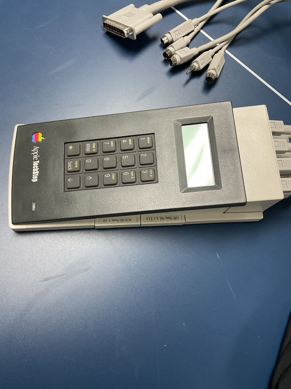

This mode will attempt to set up communication with the SCC (serial port controller) and Apple’s TechStep hardware
diagnostic tool. Note, this can be simulated with a serial connection.

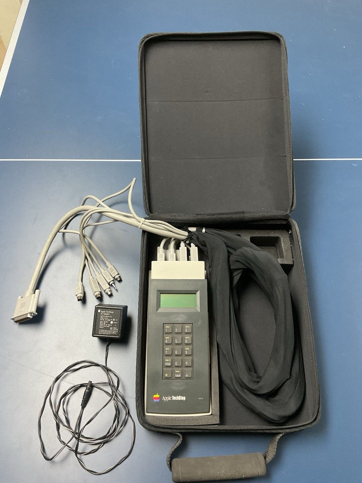

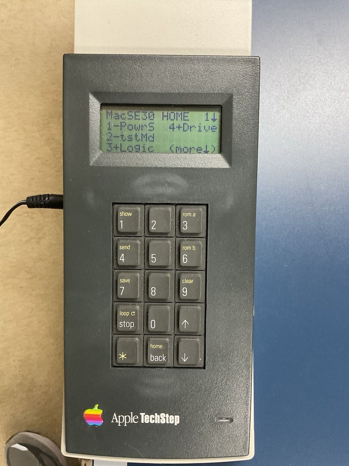

I've noticed if at least (4) good RAM SIMM's are not installed, simasimac occurs, but a bad Address line in the RAM banks still seems to allow Apple Test Mode to operate and produce a Sad Mac. If you can move the (4) good RAM modules to either Bank 0, or 1, which may not contain the bad Address line, you can still get to a Sad Mac and then be able to connect to the logic board with a serial cable, or TechStep and locate the bad Address line.
A broken Data line seems more likely to prevent the Apple Test Mode from starting at all - and without Test Mode operating it's much harder to diagnose.

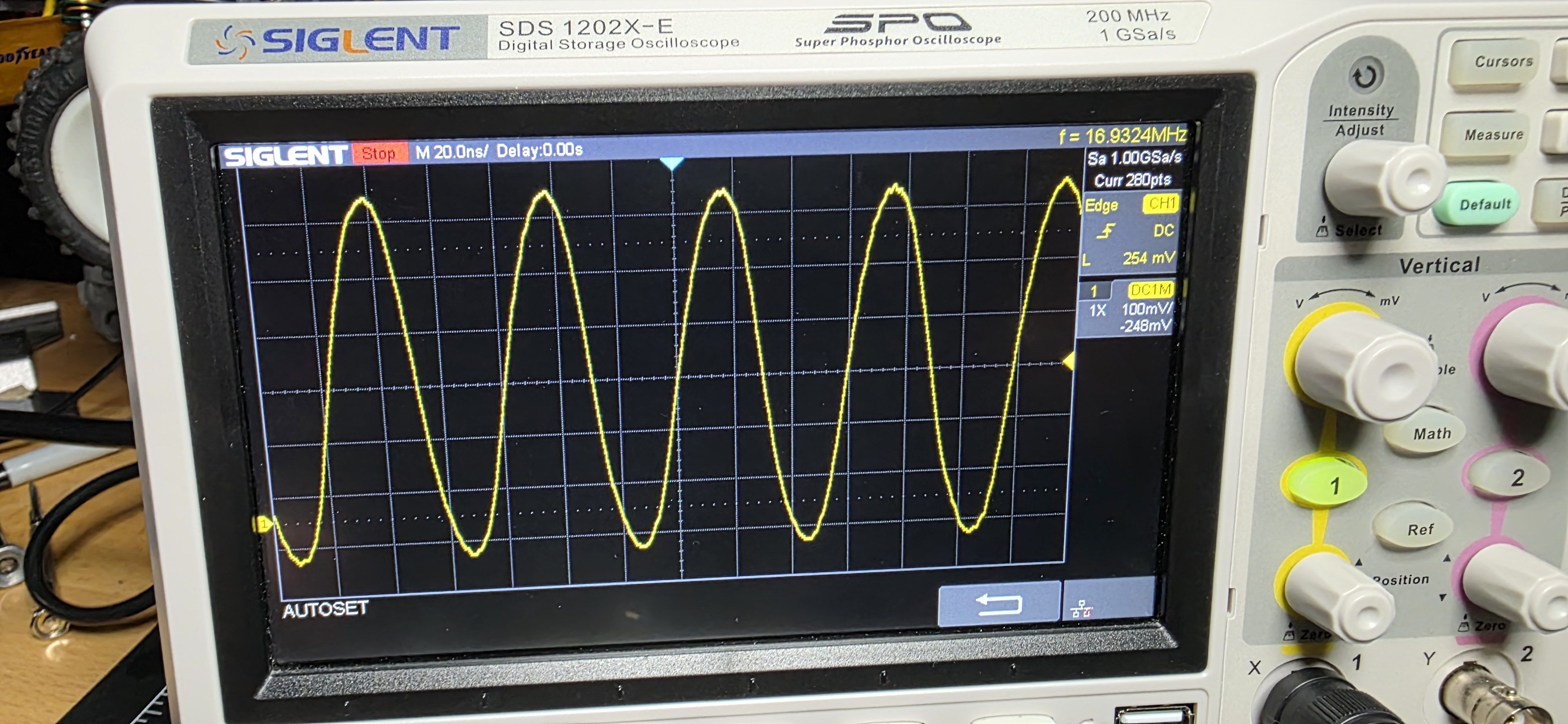

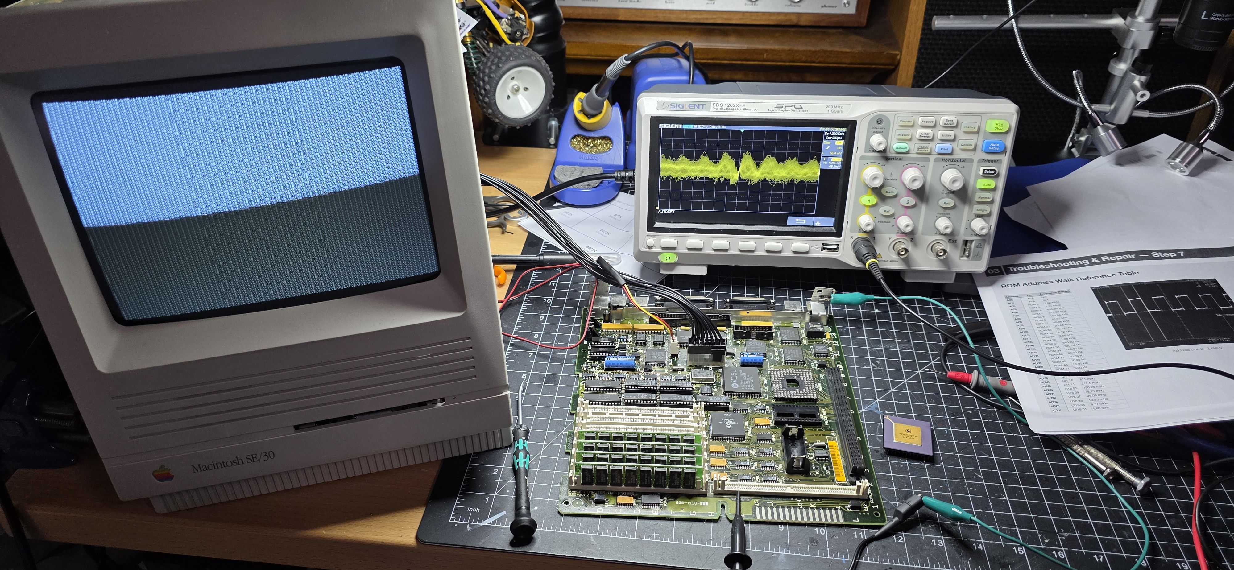

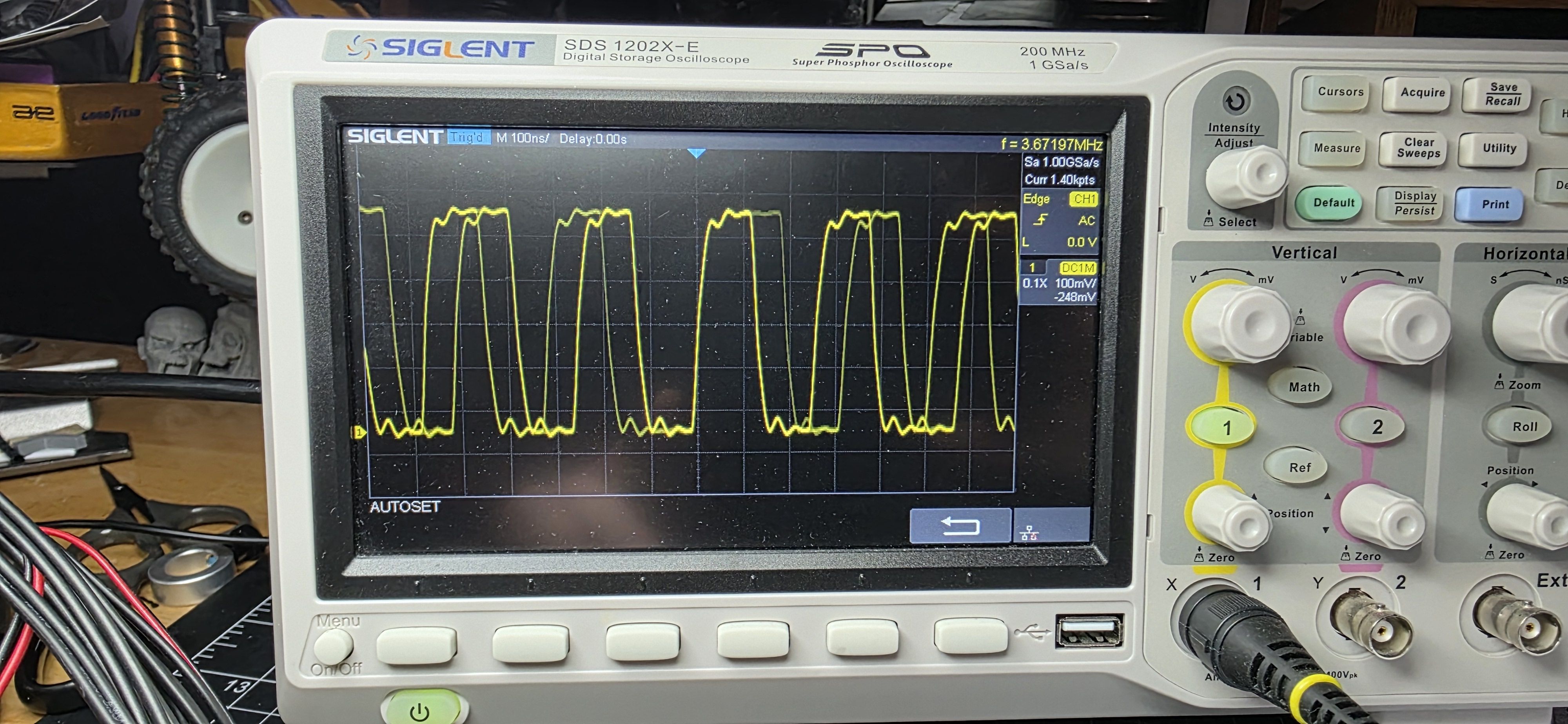

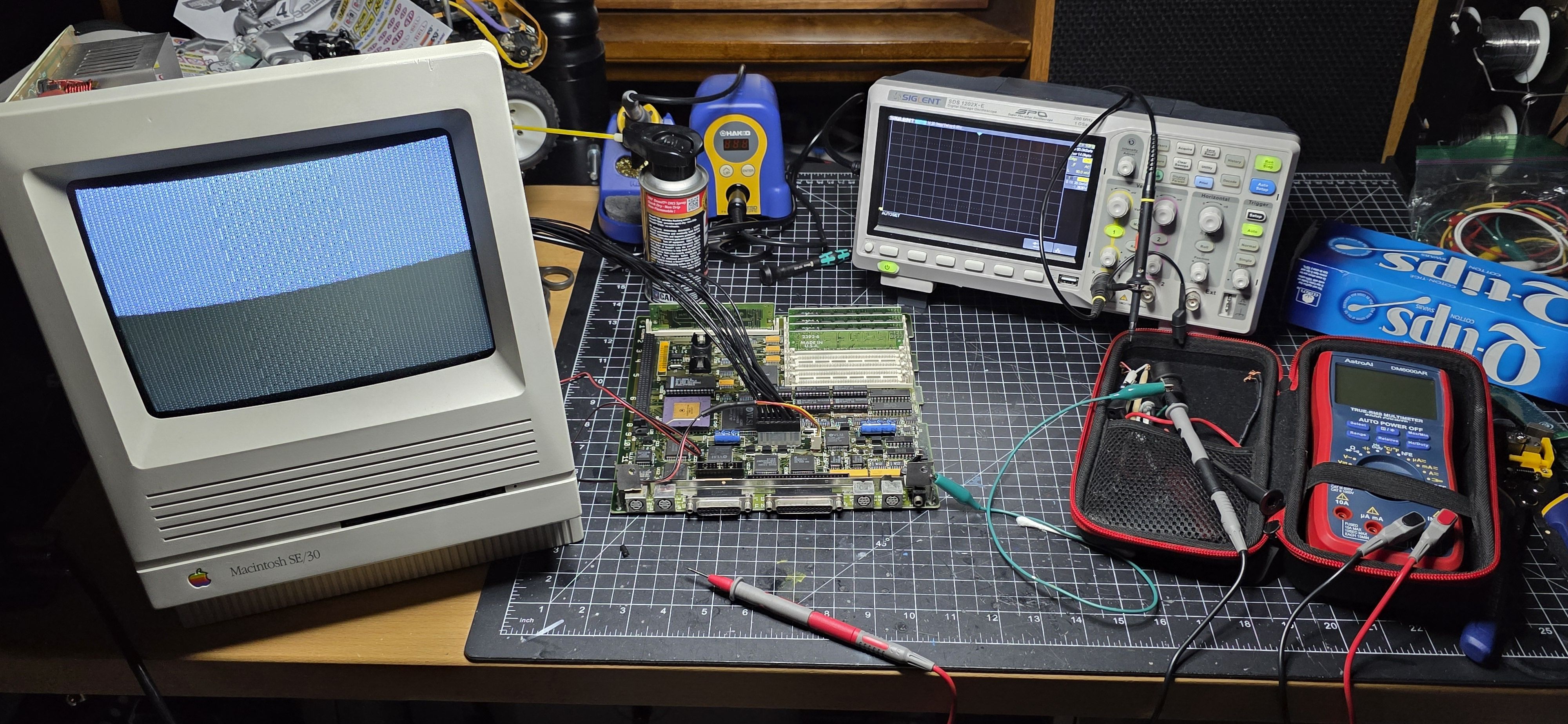

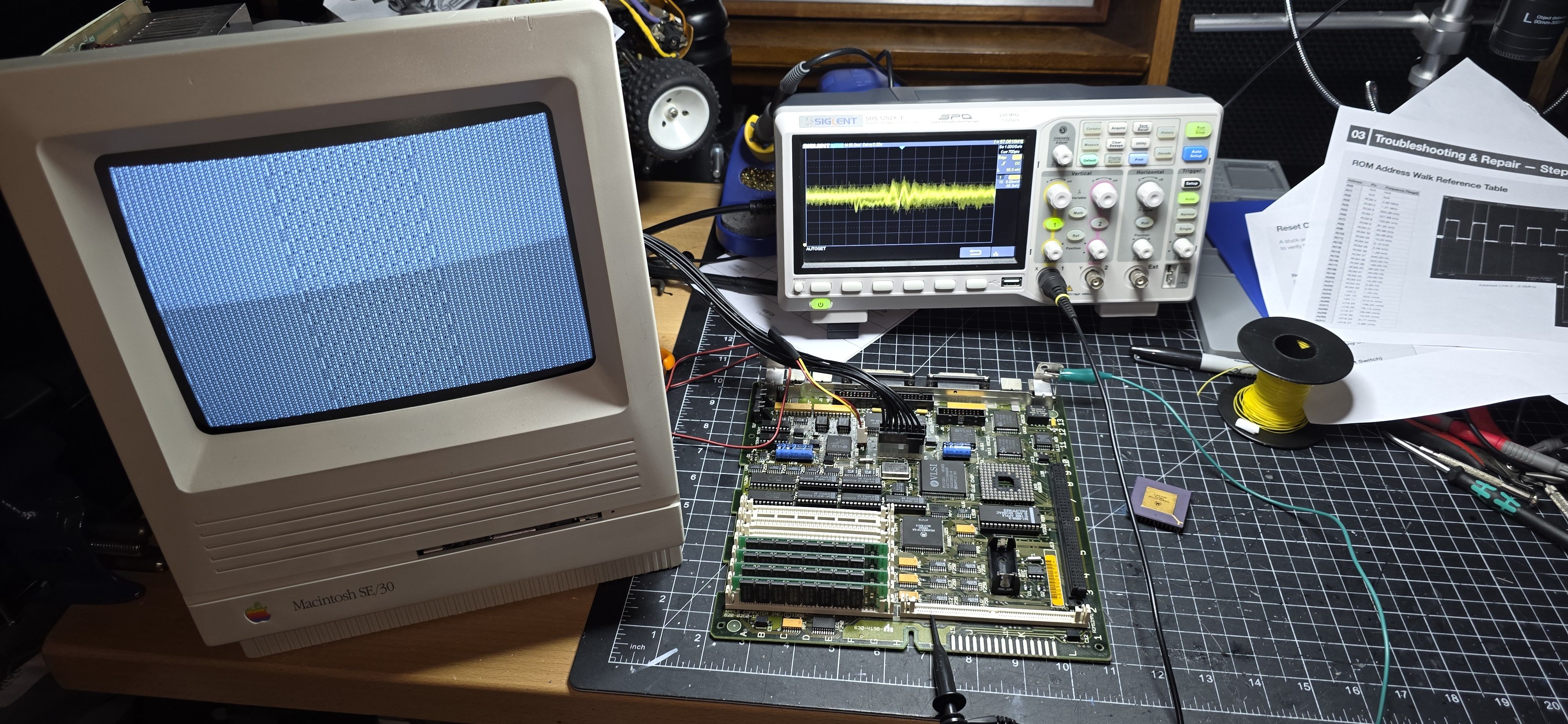

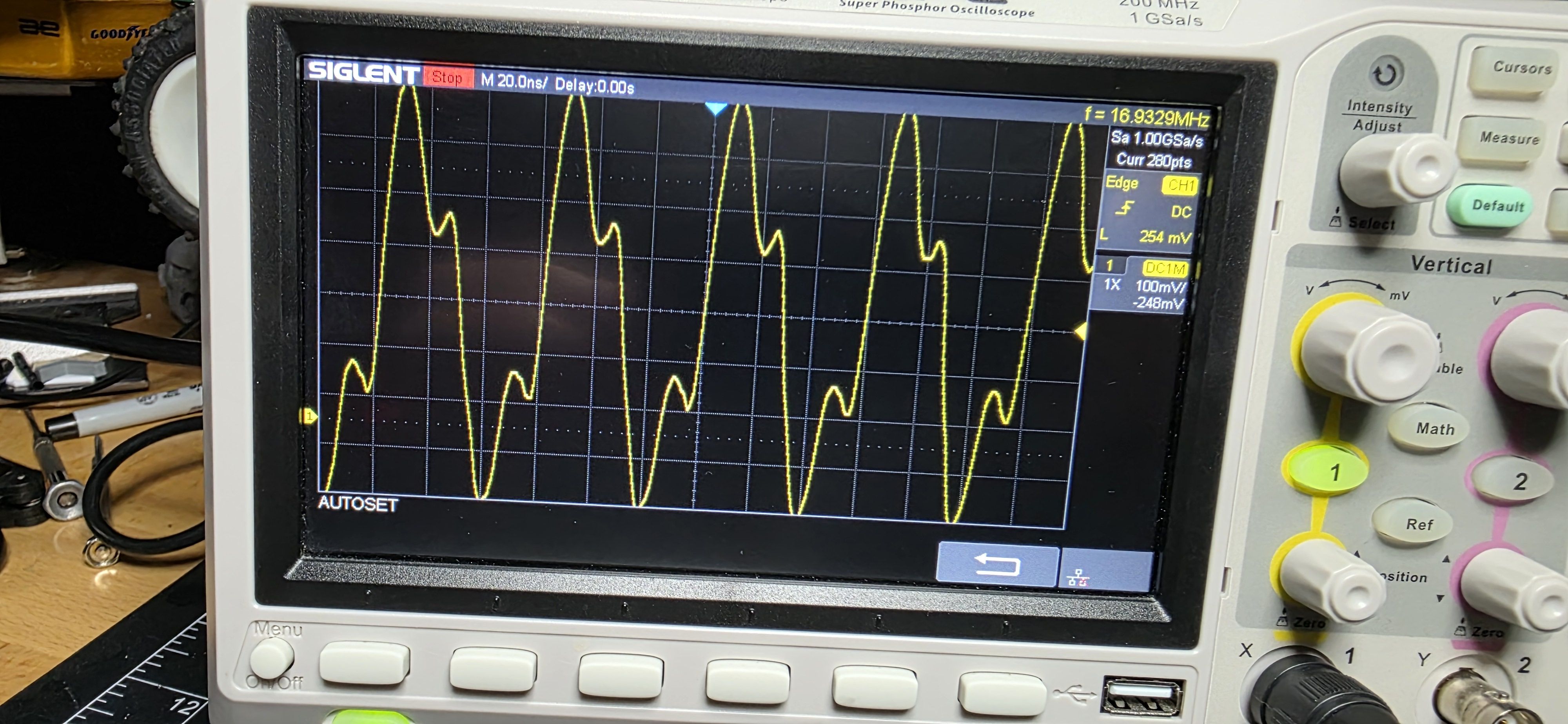

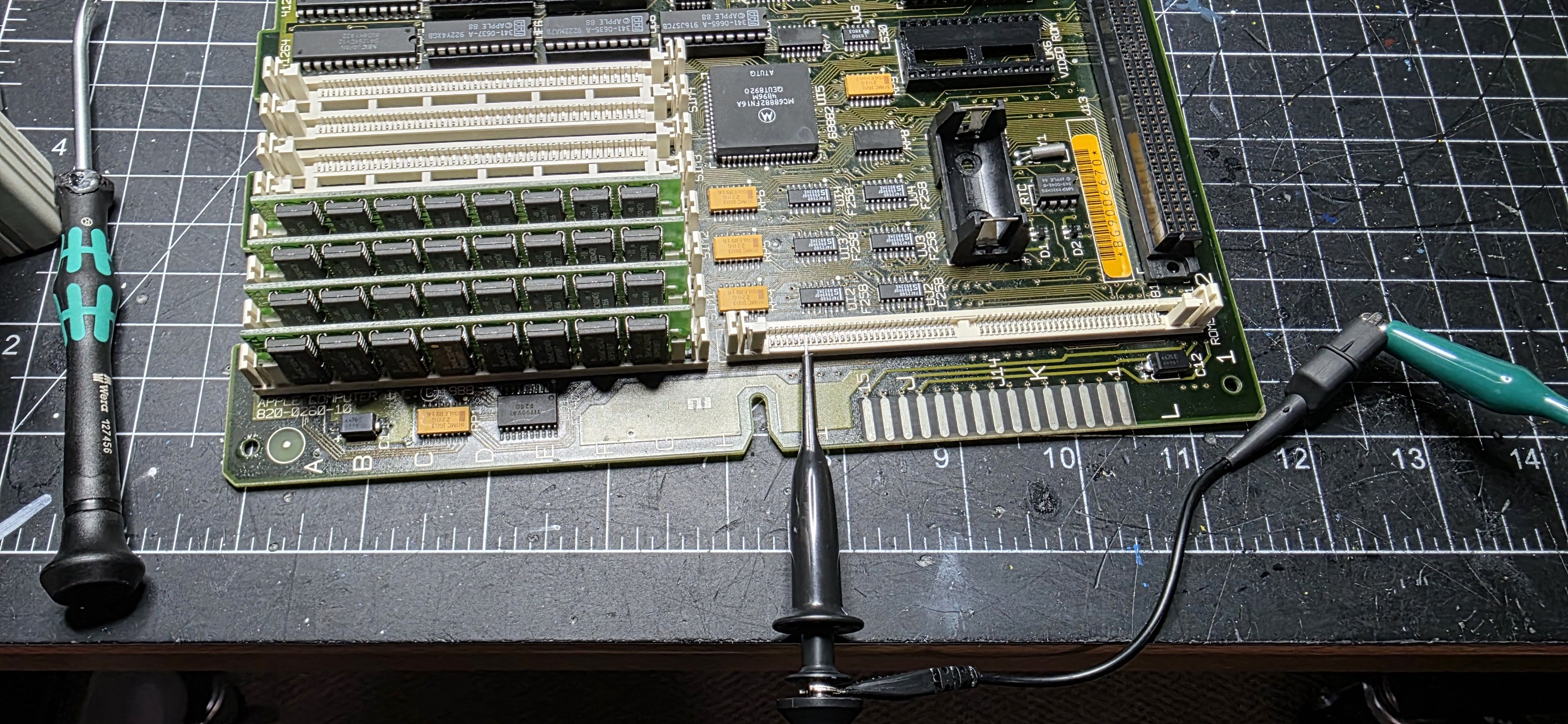

I opened my se30 again tonight as I noticed some of the smd 74hc logic ic legs are still a bit tarnished and reflowed all of them. While I'm at it I did more tests and found some interesting results.
If I remove ROM stick and let it boot to horizontal bars, all frequencies on address lines are halved, exactly the same as your measurements. I can only get ~2.6Mhz on A2 when ROM is installed:
Maybe our boards are different from the reference one used in the guide? My board's behavior is exactly like your first one.
Also I tried to block several address/data lines on the ROM stick by covering them up with kapton tape. Tried several different ones and they all result in horizontal bar. Well that's somewhat expected once I think about it since cpu can't read and execute the ROM, it can't initialize the vram and it will get stuck at horizontal bar.
However, how the system will behave if address/data lines from the cpu to the rest of the chips are severed is still unknown. Probably unstable system or non-working peripherals.
Anyway, what we do know for now is that some boards have different address line frequencies when ROM stick is removed, maybe we can suggest an edit to the repair guide. Also, never skip checking continuity from PDS slot to cpu lol.

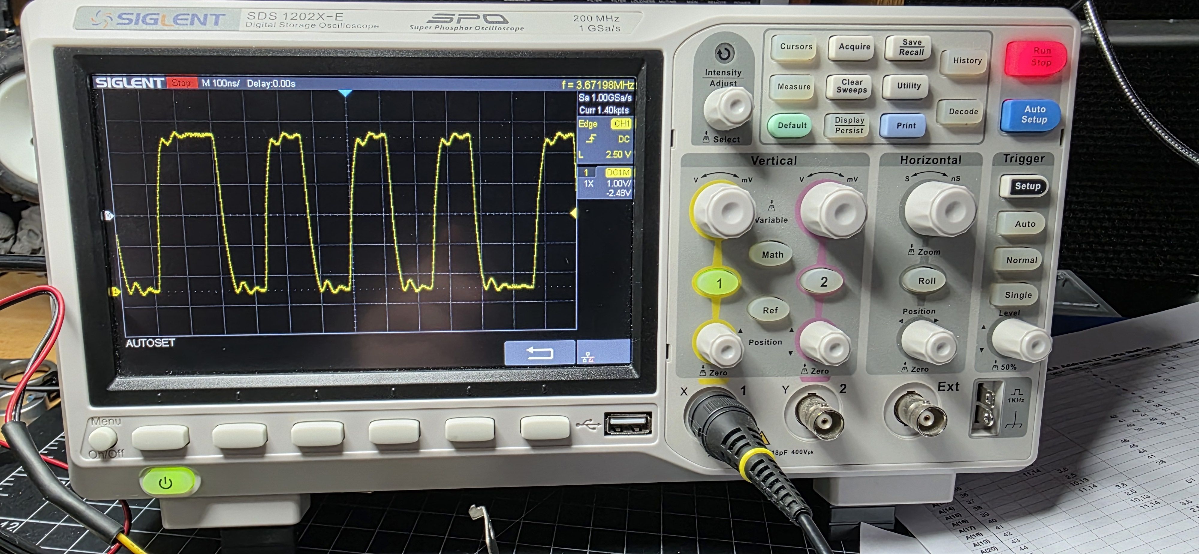

Regarding only getting 1.305MHz at A(2) Pin 4 - when the ROM is removed: I think the Simasima Repair Guide was stating what the Frequency Target should be for each Address line with the ROM inserted, or as as a perfectly functioning Logic Board; yet when running the CPU/Walk the Bus Test, they say to remove the ROM, and I think they just forgot to mention what the Frequency Target should be without the ROM.
I have (2) SE/30 boards that behave that same way, and I asked ZigZagJoe on 68KMLA and he confirmed that without the ROM there is no 2.62MHz at A(2). That would make (4) SE/30 Logic Boards that have confirmed without the ROM inserted, 1.305MHz is what you get for A(2). It was very confusing to me being a new user of the Guide, I thought I had an issue with my clocks as a result of that mismatch.

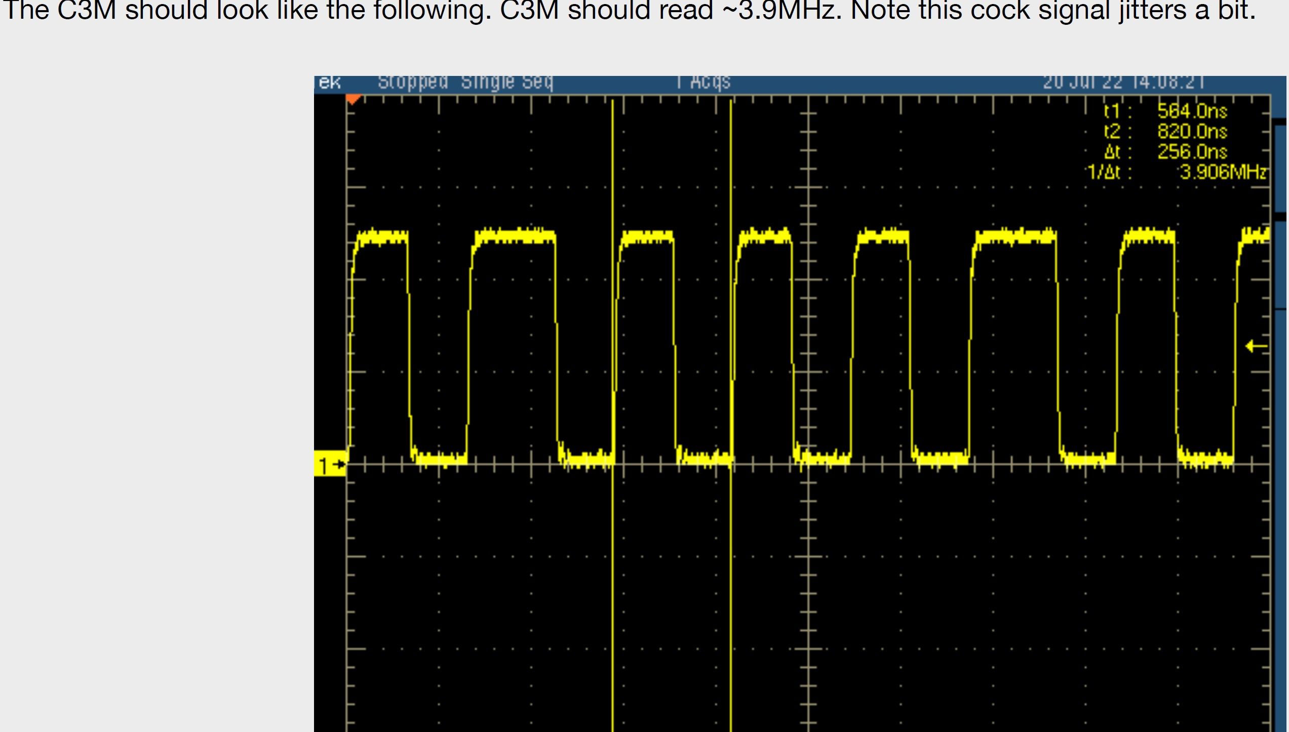

I took another look at the repair guide:
With the ROM removed, the CPU will walk the bus from A(2)
through A(31). On a working board, A(2) at ROM pin 4 will display
a ~2.6 MHz square wave. Each address following should be half
the frequency of the bit that precedes it. A(3) is ~1.3 MHz, A(4) is
~655 kHz and so on.
And on page 46 the scope shows square wave with 50% duty cycle, and its measurement is indeed 2.6MHz (pg 46):
If ROM is installed, A2 will not show a perfect 50% duty cycle square wave, instead some irregular waveform as data is flowing on the bus (pg 88):
Frequency of the square wave is 1/(2.5*400ns)=1MHz. This waveform matches perfectly with my measurement, which frequency is 1/(5*200ns)=1MHz.
So I think the guide isn't necessarily wrong, there might be a different motherboard revision that gives different frequencies. My friend also has an SE30 in perfect condition (no battery leakage or capacitor leakage damage) which I recapped last year. iirc it's an early revision with socketed 68030, I will borrow it from him and run some more tests.

Grabbed my friend's se30 and removed rom, here's the result:
Early revision with socketed cpu and pals. A2 is also 1.3mhz.
And I think I know what's wring with the guide. Take a closer look at oscilloscope screenshot on pg 46, the frequency is calculated by 1/(t2-t1), but t2 is placed at falling edge of the square wave, so essentially the calculated frequency is doubled. If t2 is placed at rising edge of the next cycle, it will give 1.3mhz.
Reactions: GreenBar0n

Using a cheap DMM with the Frequency Counter function, where there is no adjustable settings like an O-scope, you'll still get 1.305MHz at A(2). The Guide never mentions how to setup the scope. Either way it's confusing to a new user that has no idea what a working SE/30 board is supposed to look like in the first place.
I really appreciate the hard work and knowledge contained in the Guide, just wish they'd amend the Frequency Target section of the CPU/Walk the Bus page:
Reactions: Mark_W

Btw this should be the correct position for t2 marker, to measure the end time of a complete cycle:
Assume 50% duty cycle, the frequency should be 1/(t2-t1)=1/(800ns)=1.25MHz
Or we can just use oscilloscope's default frequency measurement reading, it should take care of everything.
