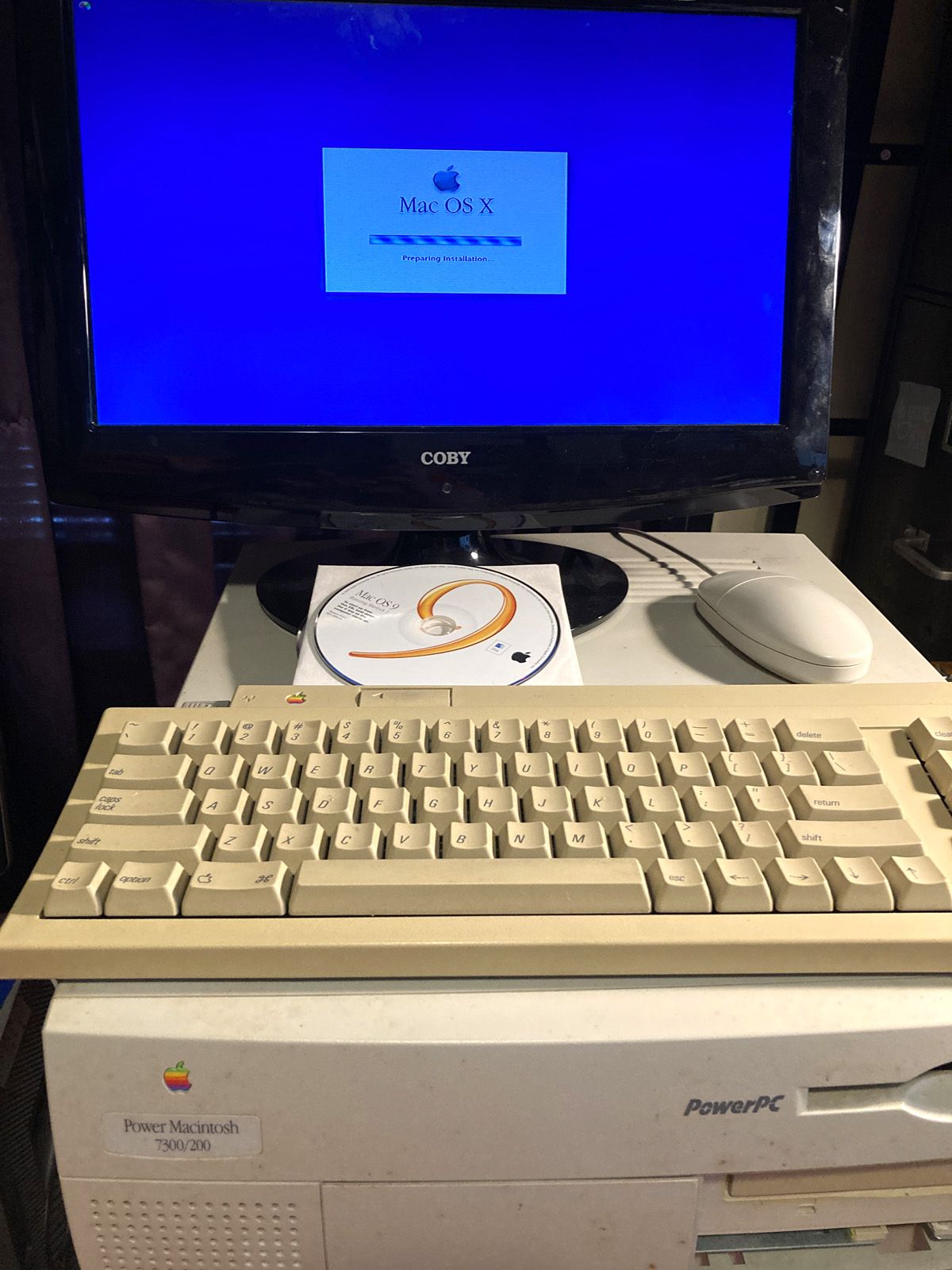

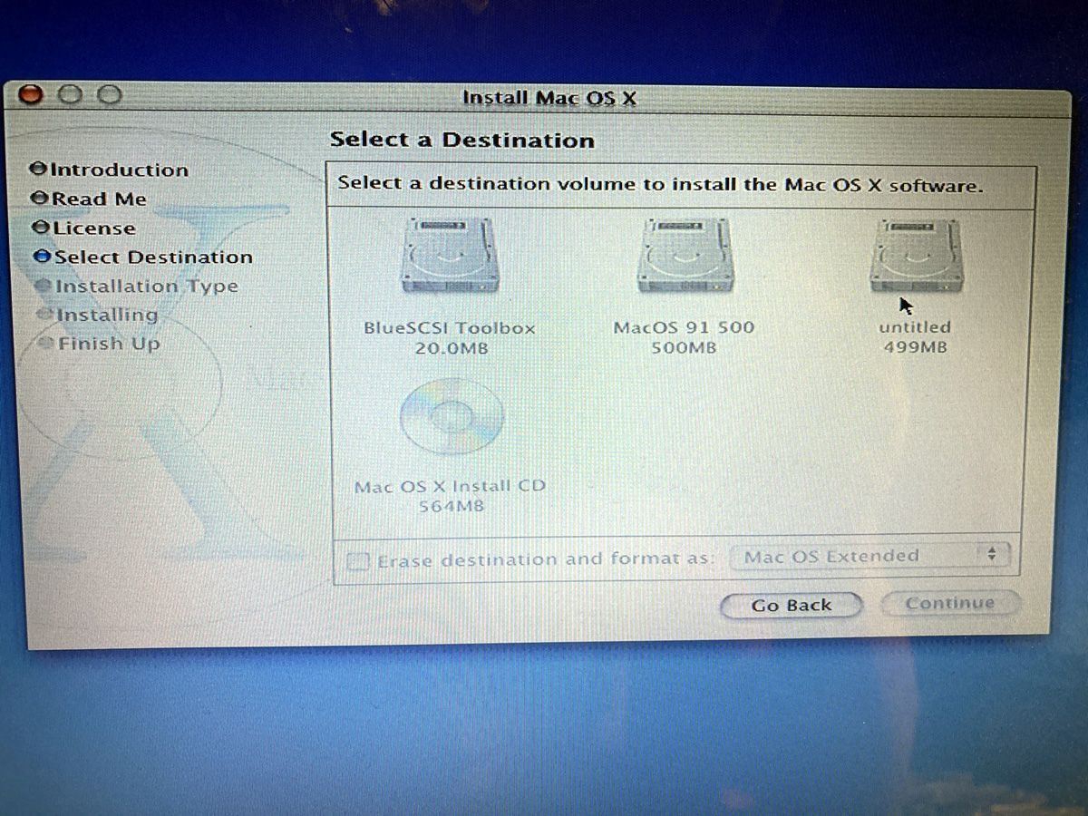

Day 17
I started with a 7300/200 and tried to install OSX 10.0 with XPostFacto, but got stuck on not having an HFS+ formatted volume. I couldn't find the Disk Utilities in the menu on 10.0, so will try another machine with a G3 in it.

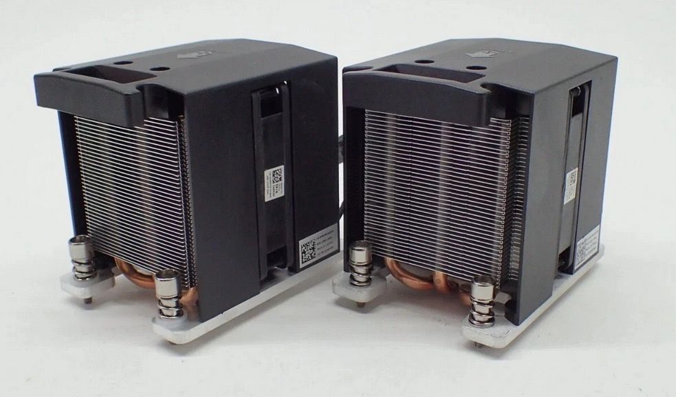

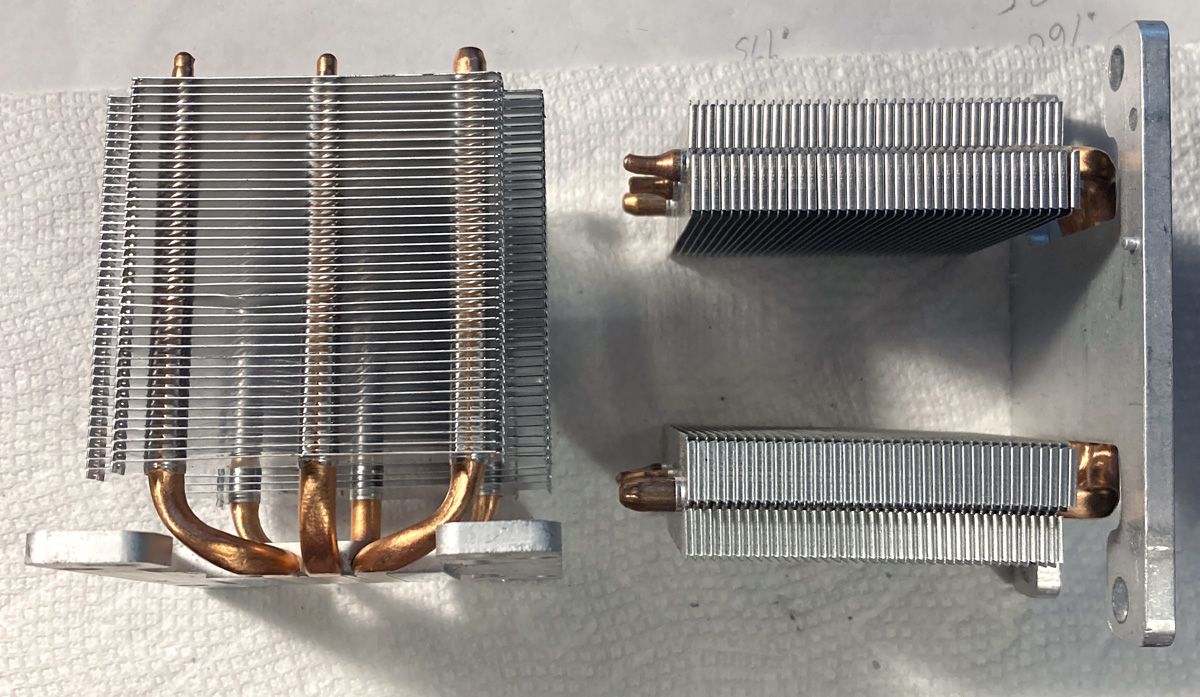

Then I started working on converting my Quad G5 to air cooled. I purchased two Dell T5820 CPU coolers off eBay for total $14 delivered.
They are shorter than standard G5 coolers, and have 3 pipes instead of two. So hopefully they will work out. There is a PDF document about converting to air cooled, and it recommends some 4 pipe coolers ($25-40 each) but I didn't want to shell out that kind of money right now.
So I will mod these and see how it goes.

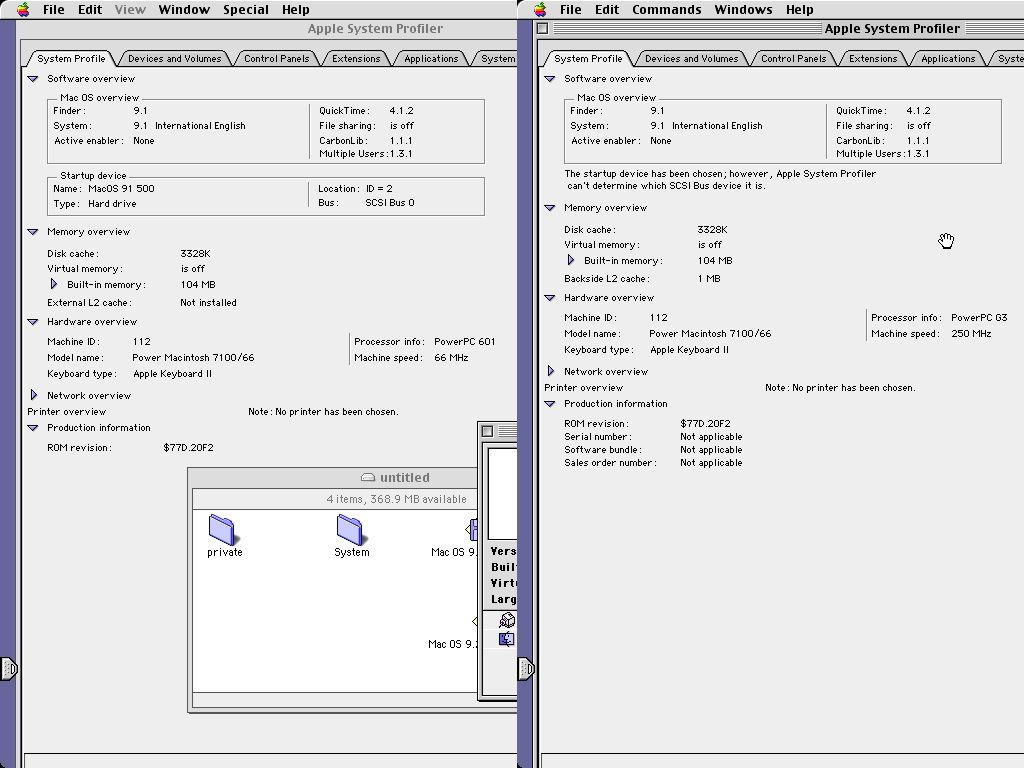

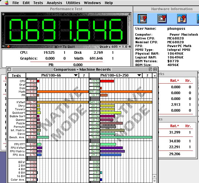

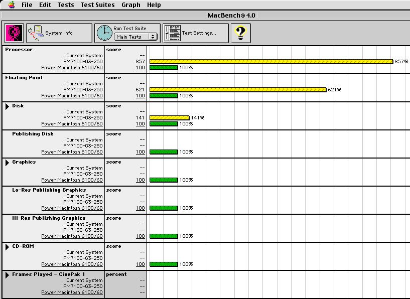

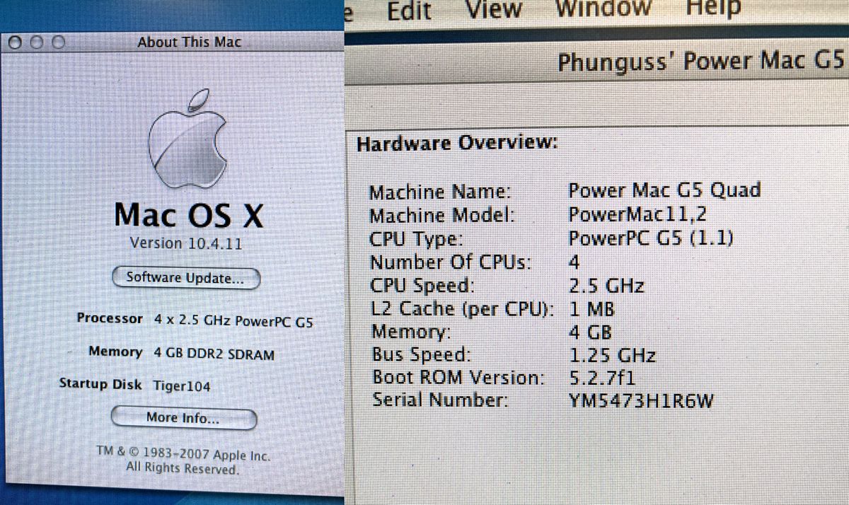

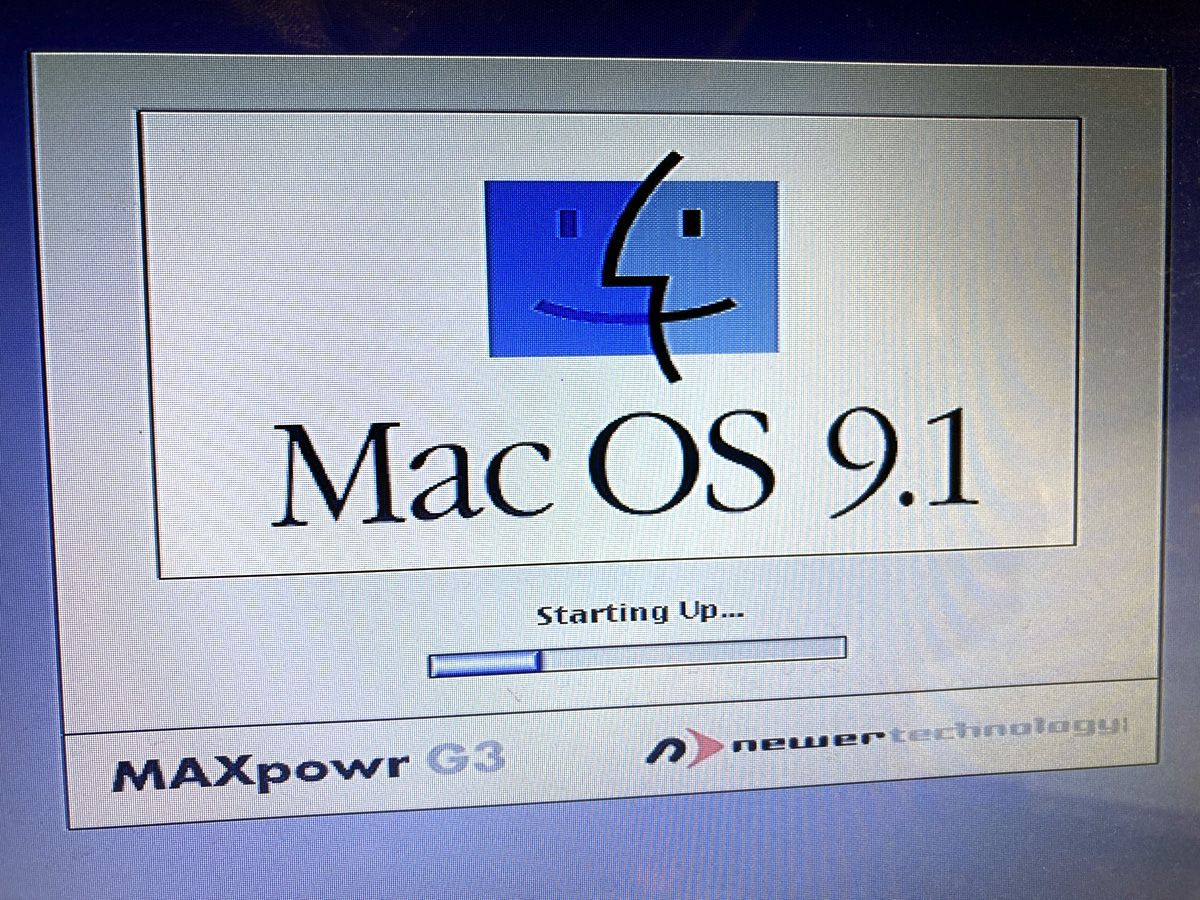

I managed get the NewerTech MaxPower G3 into the 7100/66. I found the correct installer app at the Mac Repo to get the extension enabled.
Before and after System Profiler.
Speedometer 4.02 looks like about 5-6x improvement.
MacBench 4.0, I will have to run further benchmarks, but it sure feels snappier!

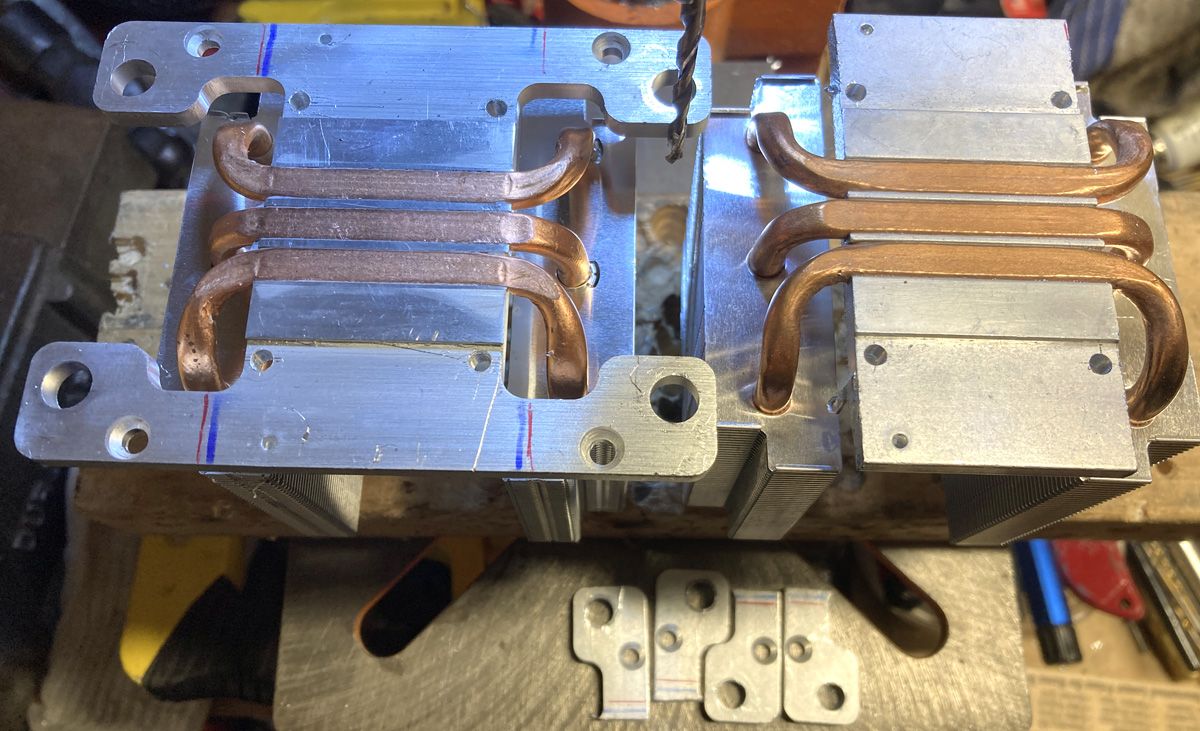

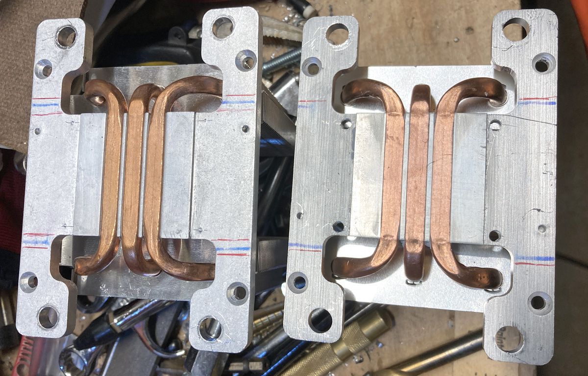

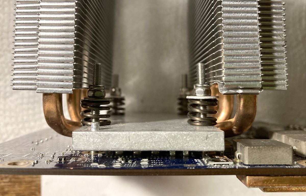

Back to the G5 Quad air cooled mod. I started by stripping off the outer shell and fan, then marking the mount holes on the bottom of the heatsinks. Drilling holes for the M3 screws that will hold the tension springs.
Then I cut off the excess that would be touching components on the CPU cards. Makes them lighter, but less thermal mass to absorb heat.

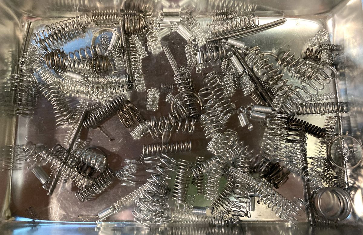

Then I had to choose the springs.

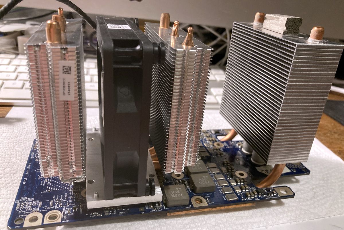

What the CPU cards will look like once the fans are mounted in. I will 3D print an outer shell to direct the airflow.
Finally, the heat sinks mounted and ready to install in the G5 Quad for testing. I will likely run it without the fans and they will be in high speed mode with no fans connected.
I will fire it up tomorrow and see what kinds of problems I have.

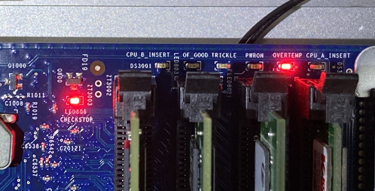

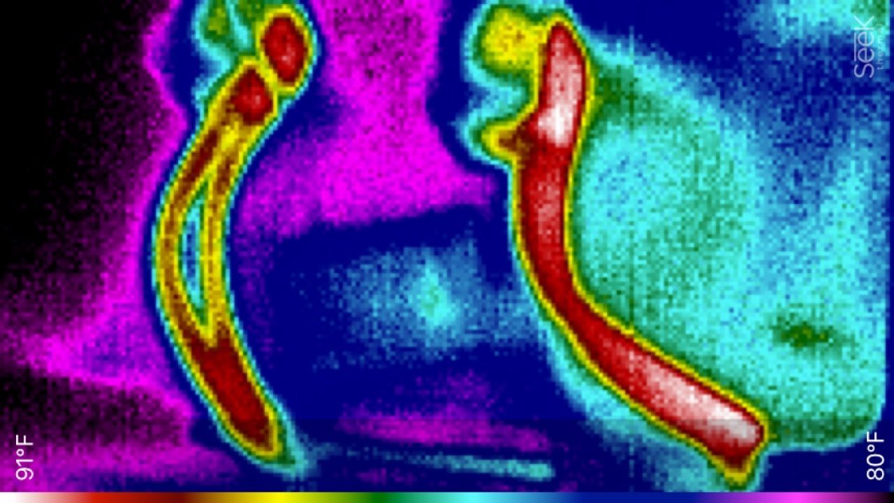

G5 Quad 2.5GHz again. I started out with no boot chime and no video.

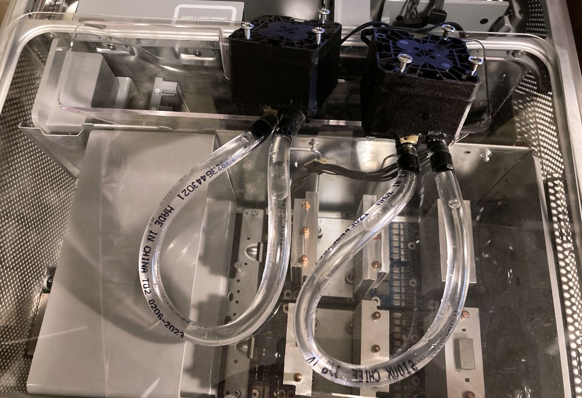

Overtemp? Well I put some water in a short tube and connected the LCS pumps just to have them connected to the logic board. They are not cooling anything.
Powered on, water circulates, but still no love. They appear white because of the air bubbles in there, I was not particularly concerned about bleeding them out.

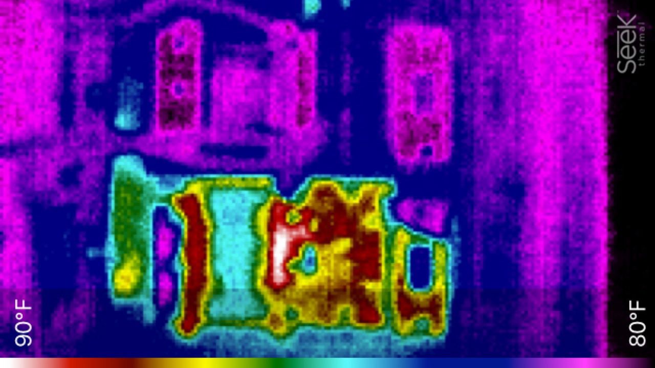

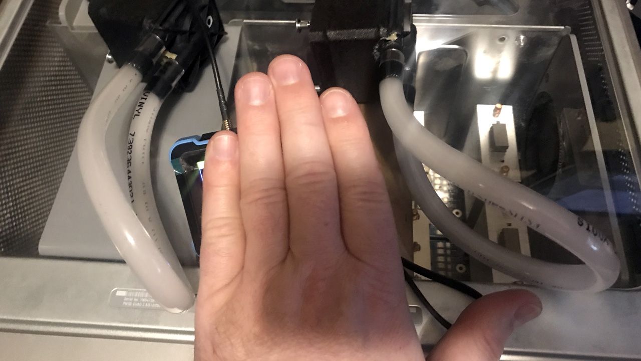

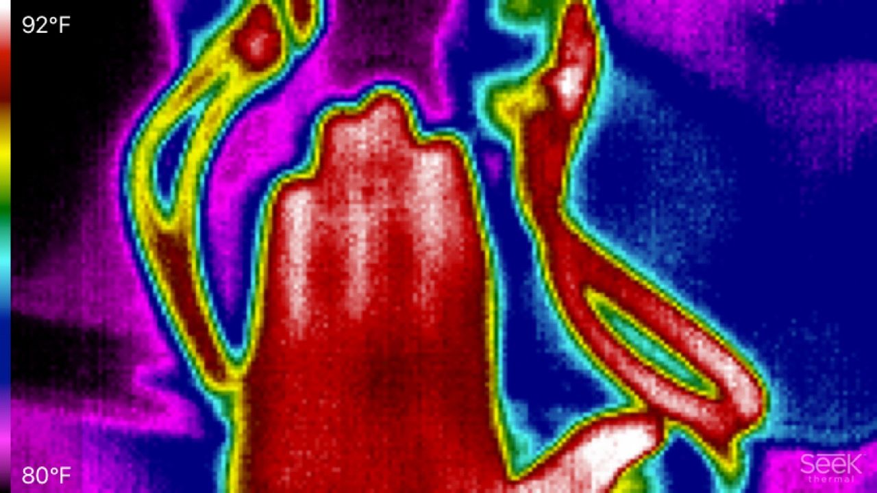

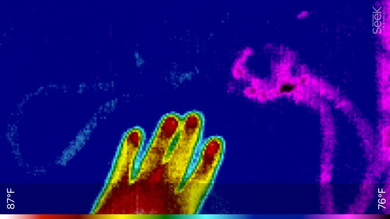

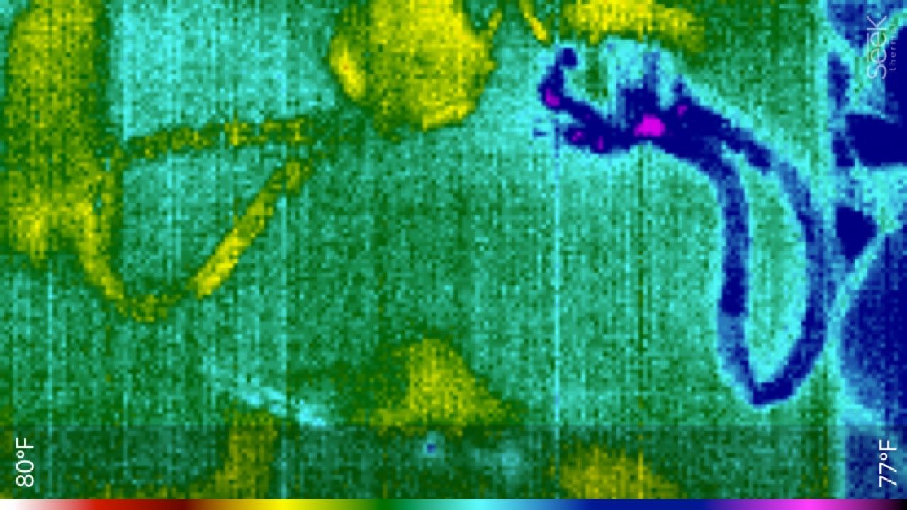

I had to figure out what was going on... I pulled out my Seek thermal cam adapter for my iPhone and tried to take a look.
That's strange... the acrylic panel seems to block IR. Here is my hand over the hoses.
Ok, since the fans are on high speed anyway due to overtemp, lets pull off the acrylic panel.
There we go! One CPU heated up, the other didn't. I have three CPU boards, so I spent some time swapping them around to finally get boot chime!

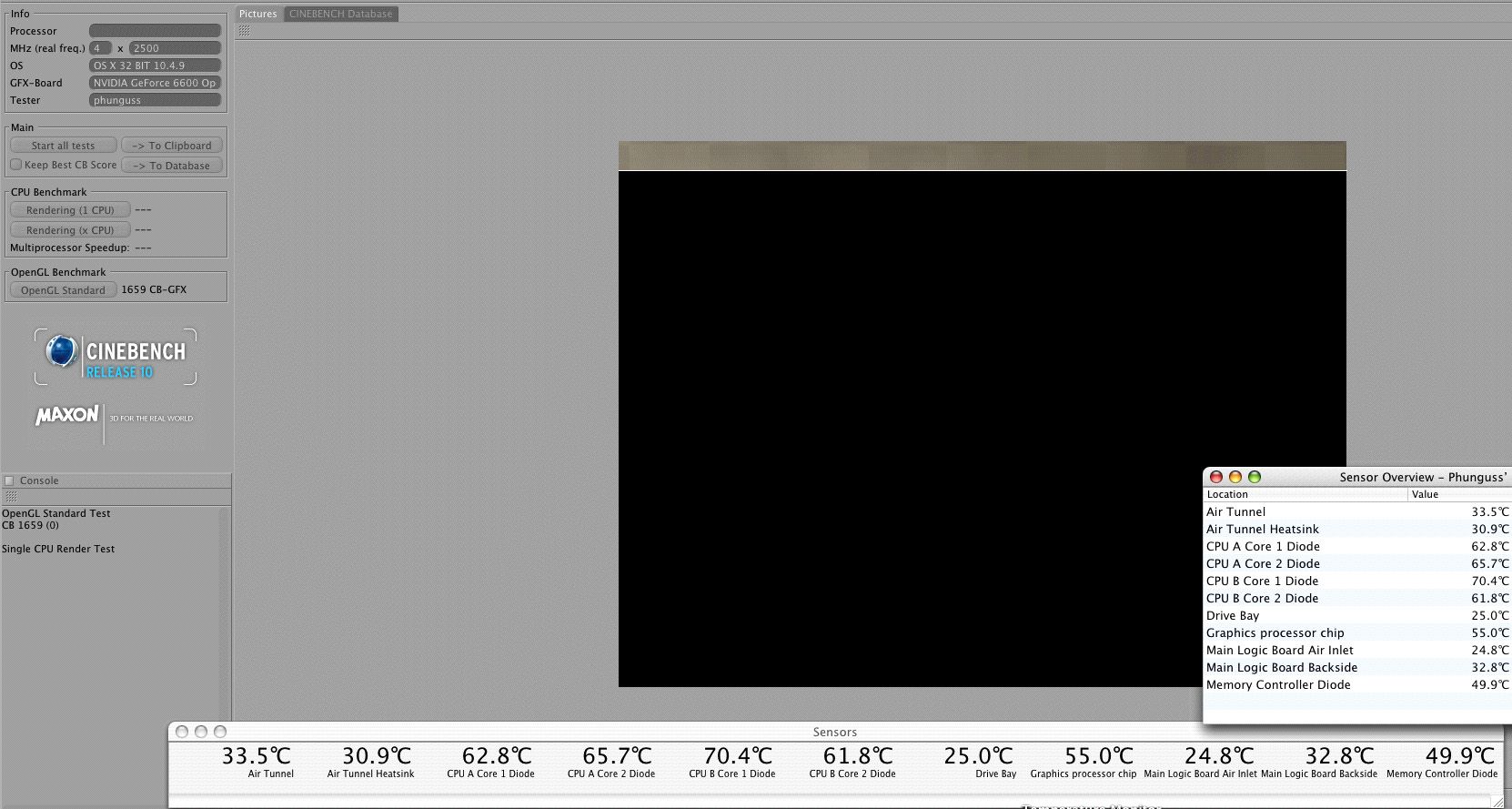

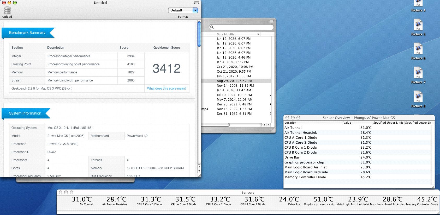

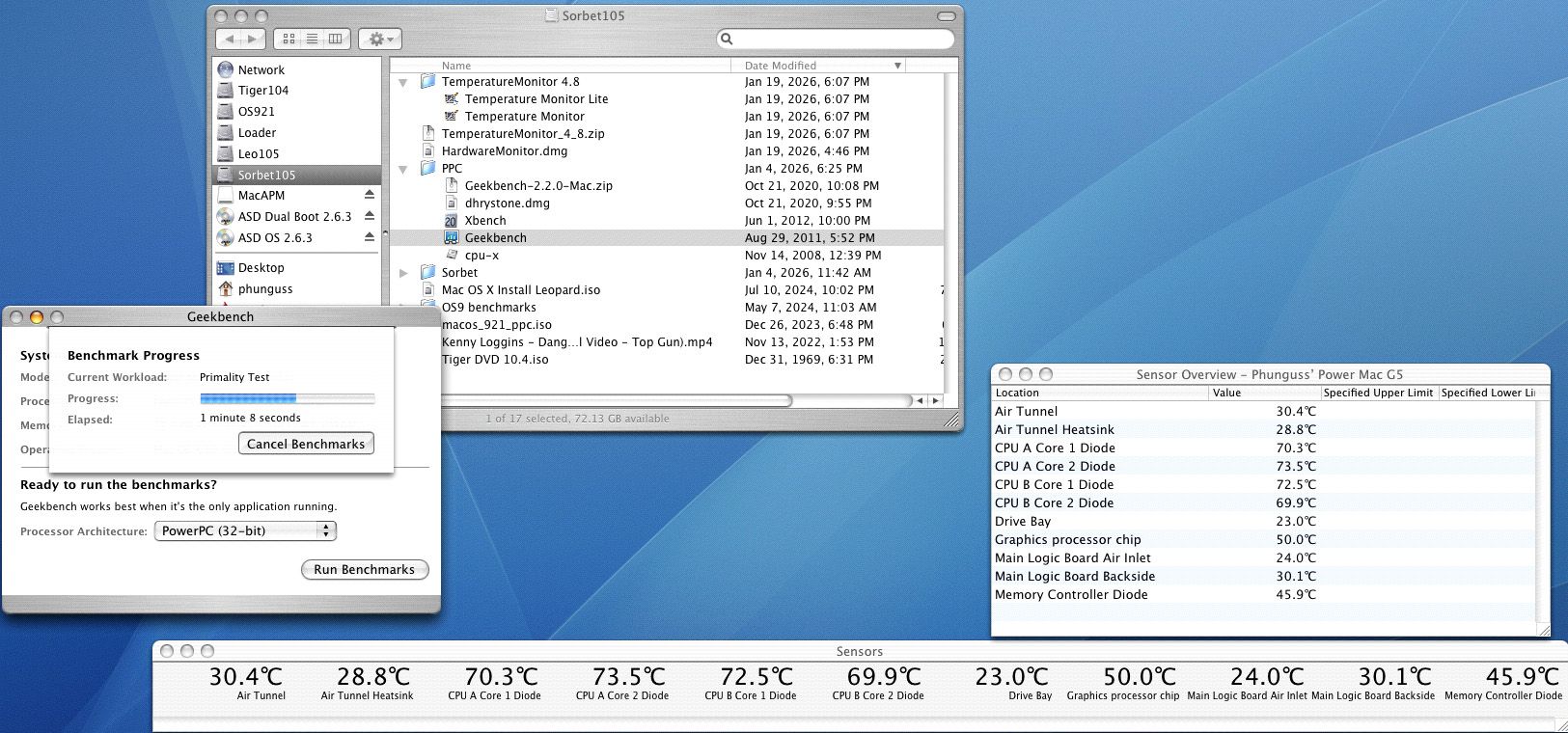

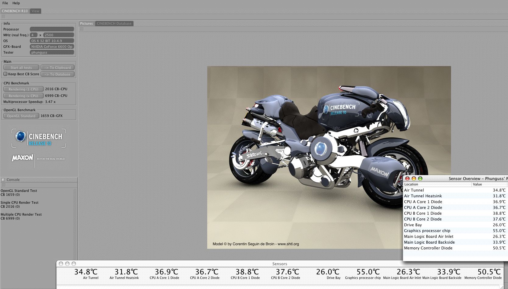

Finally 4 x 2.5GHz! I added the rest of the ram sticks I had and got it up to 14GB. Since the CPU coolers do not yet have fans on them, and they are shorter than stock air coolers, I had to cobble a baffle to increase air flow over the fins.
This is GeekBench 2.20 running under load with max temps in the low 70s C.
And at idle after completion, back down to 30s C.
This is Cinebench R10 under load, again low 70s C.
And idle after completion, back down to mid 30s C.
Overall happy with those results, and I don't think I really need the CPU fans, but they may lower the temps slightly. The real trouble is keeping the intake and exhaust fans at reasonable speeds when I disconnect the LCS pumps. I don't have an oscilloscope, so I can really read the PWM signal to the LCS, so that may be a future project. I guess I could read it with a multimeter and see what voltage range I get when the fans are high, assuming anything over 5V would mean it is 12V PWM (or sinewave as mentioned previously).

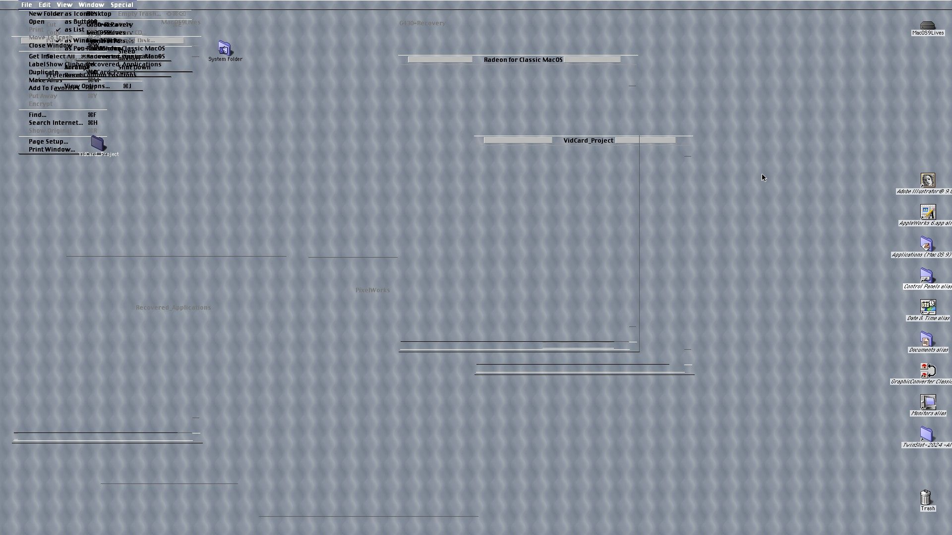

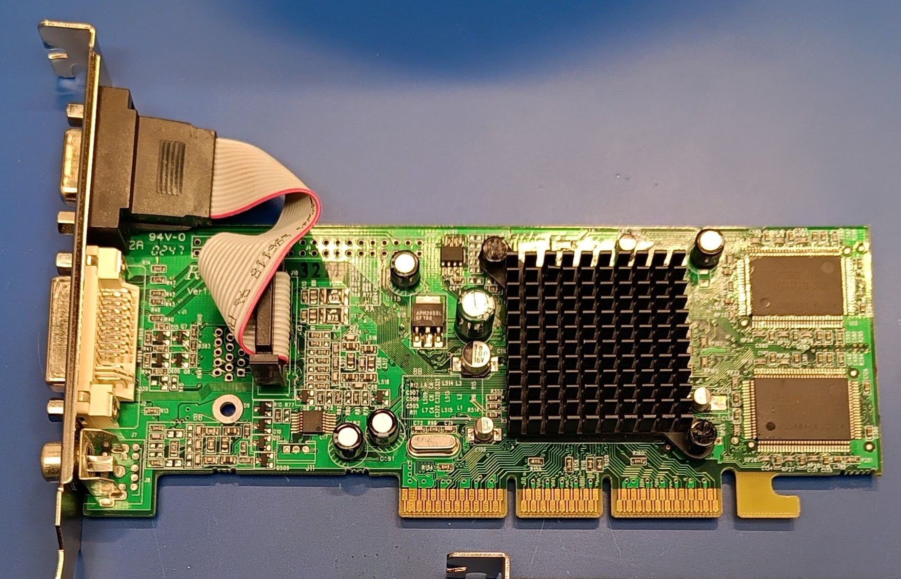

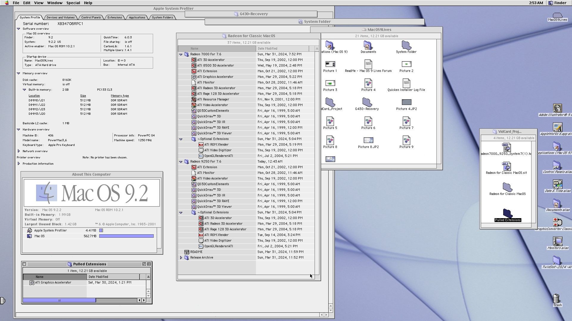

Day 20 - Decided to spin the stictionistic drive up every day until the new one arrives after all.
Tried to install drivers for the new VidCard:
Interesting results:
Forcing boot from the OS9Lives CD got me up and running the iterative which freakin' extension is poleaxing the system swapfest. :rolleyes:
No joy on finding a way to output anything over 1080p from the DVI output of the card. Gotta give VGA a try I think?

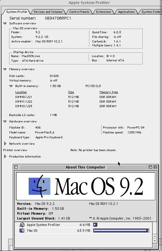

While I was at it, I started to play with RAM sticks to try to pinpoint the error that cropped up on every boot. First thing I tried was pulling the stick from J20 and the error went away! Still reported 1.5MB available as had always done before. Pulled the stick from the next slot over, J23 and replaced it with the first one I'd pulled, same same, not the stick apparently. So I put the J23 stick into J20 just to see . . .
So now About This Computer reports 1.99GB of Built-in Memory? I've never seen such a thing before and never expected to see anything over 1.5GB!!!!
LEM says: RAM: 256 MB standard, expandable to 2 GB (although Mac OS 9 will only recognize 1.5 GB) using PC2700 memory in 4 DIMM slots
WTF? :eek:
1,204
367
Powerbase over at the MLA said he understands this to be standard behavior. Looks to me to be behaving like unclean Macs running without MODE32 addressing memory over 8MB and listing it as system memory allocation.
But 1.99GB? That's just strange. Sure would be nice to have an OS9 extension like MODE32 for that extra half gig. :)

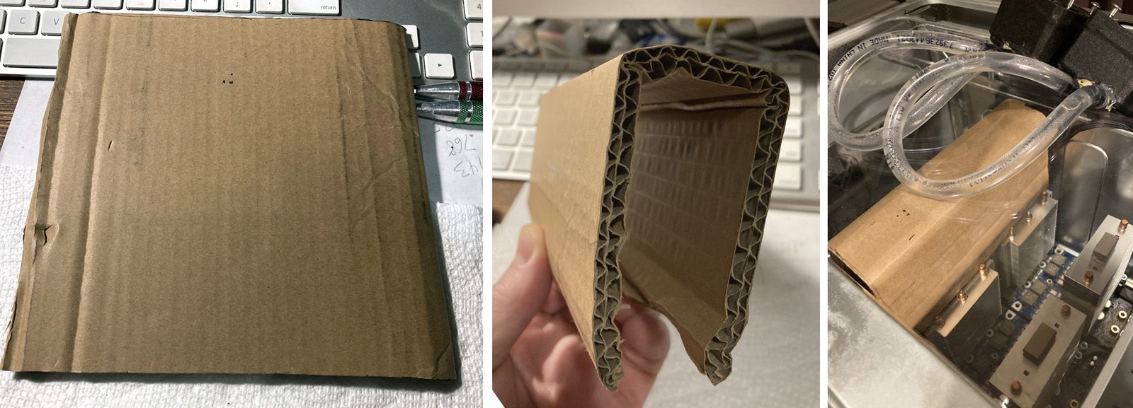

I received my DSO-152 from Temu and have yet to learn it. I set out to try to find the fan speed signaling on the G5Q. I was ramping up the temps by running benchmarks.
I noticed my tubes were getting warm.
They are not connected to the CPUs... but just having the motors run creates enough heat in the short tubes.
Not super hot, but warmer than air.
