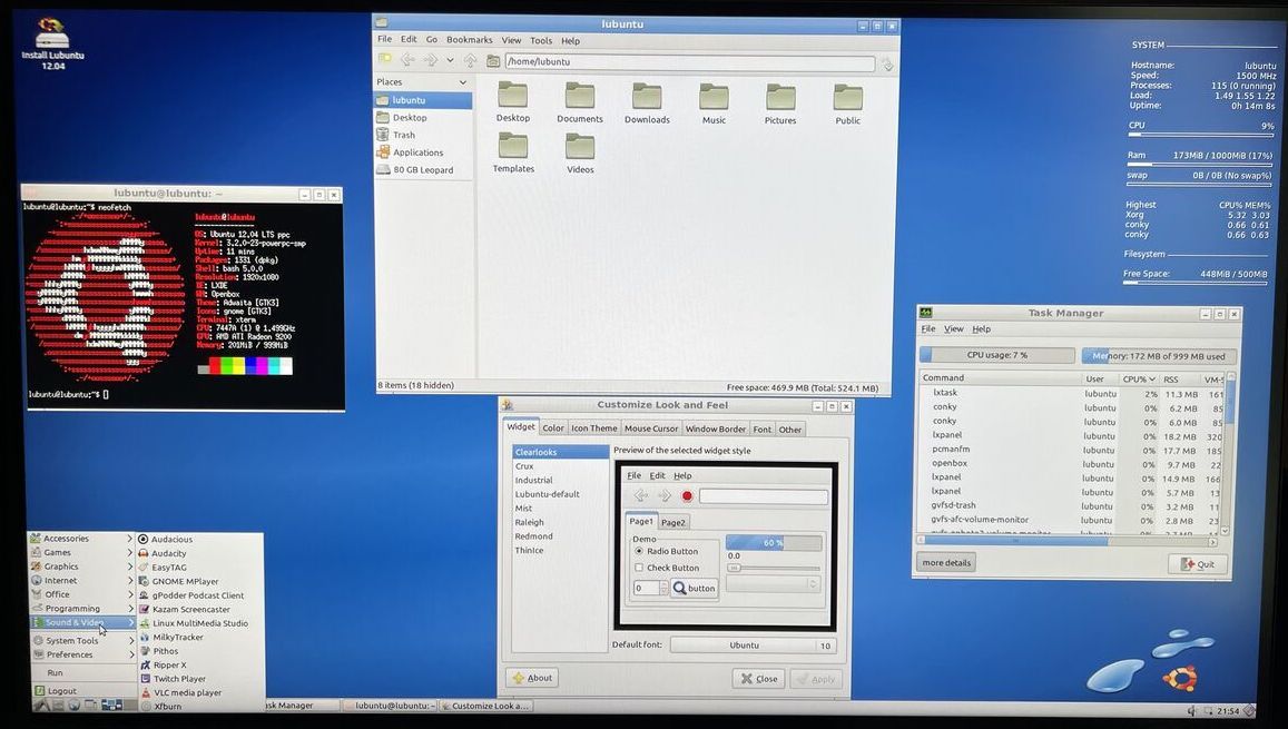

Case in point: the experience with Lubuntu 12.04 Remix in a nutshell:
This is a capture of the stock programs within the live CD environment. I set up a user account and installed the operating system and set out to attempt to install software from an obscure mirror of Lubuntu's now 14-year old version to get additional software not included on the disc, heavily outdated software that we cannot upgrade to newer versions probably because of the old kernel or something that launches the user into escaping Linux dependency hell, but additional software nonetheless. A mirror like old.lubuntu.something or whatever it might have been called. Well? NOT POSSIBLE. Nearly all of the software threw up an error. I have no photograph for this, but let's just say that I tried at least 15 programs I wrote down in an .rtf document that I wished to install but the Lubuntu mirror failed to fetch. I know qmmp was a program that actually DID fetch and install to my Lubuntu 12.04 Remix system, but for whatever reason the audio was glitched and thus audio playback was all but worthless.
First, a list of detriments I noticed that I had written down in a .txt file I made on that day:
1. the Caps Lock key doesn't light up when pressed (I personally used Apple's tenkeyless
2. the Mac Mini is in a constant state of overheating as the fan ramps up constantly
3. over half of the software I attempted to install are, from what I could tell, not available from Lubuntu's repository mirror any longer, which happened sometime between 2021 and 2025, apparently
4. Qmmp's audio playback is reduced to a screeching static sound
5. Lubuntu 12.04 Remix does not "fly" on any Mac Mini if it was as sluggish and stuttered as often as as it did on mine
6. The cross-platform software that is actually able to be installed here is often even OLDER than its counterpart on Mac OS X Leopard
7. I had to turn off my Mac Mini because Archive Manager hung the entire system when failing to extract a tar.gz file
So, in my next post, I'll be giving you all the rundown of when I then next tested Lubuntu 16.04 Remix to see if it warranted the continual use by individuals on MacRumors who still wish to attempt to use it over using the superior Void Linux and then still complain to w1kcn1x when something naturally breaks on their system when using Lubuntu 16.04 Remix.

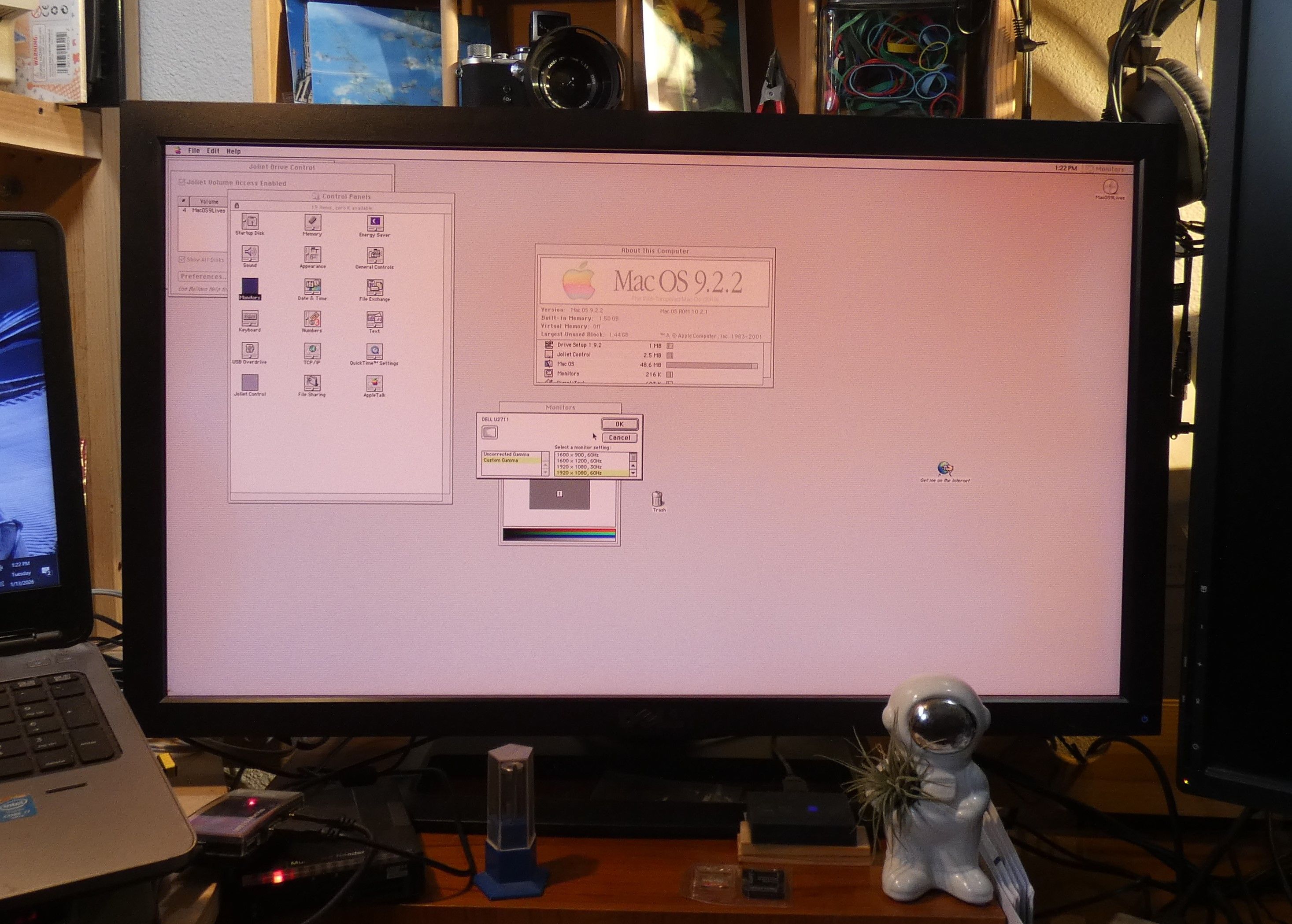

LOL! Yep, it's hilarious, buddy. But I think I've noodled it out. Having VGA hooked up to the the 4:5 panel and DVI running through pestiferous ADC(?) via converter looks to have been the problem. DVI output to HDMI cable was creating a "ghost screen" along with VGA output to the 4:5 panel, whilst defaulting to DVI as the (Blank) startup screen #1. Hence the forever wait on the blank VGA driven 4:5 panel.
Wanted to troubleshoot the system's problems before moving on to the most generous Christmas gift from obsolete over at the MLA.
Swapping in the AGP Radeon 7000/32MB has done the trick!
It'll drive the 1440p (currently at 1080p) or the 1920x1200 vertical (likely @1080p) panel from DVI through the switchbox!

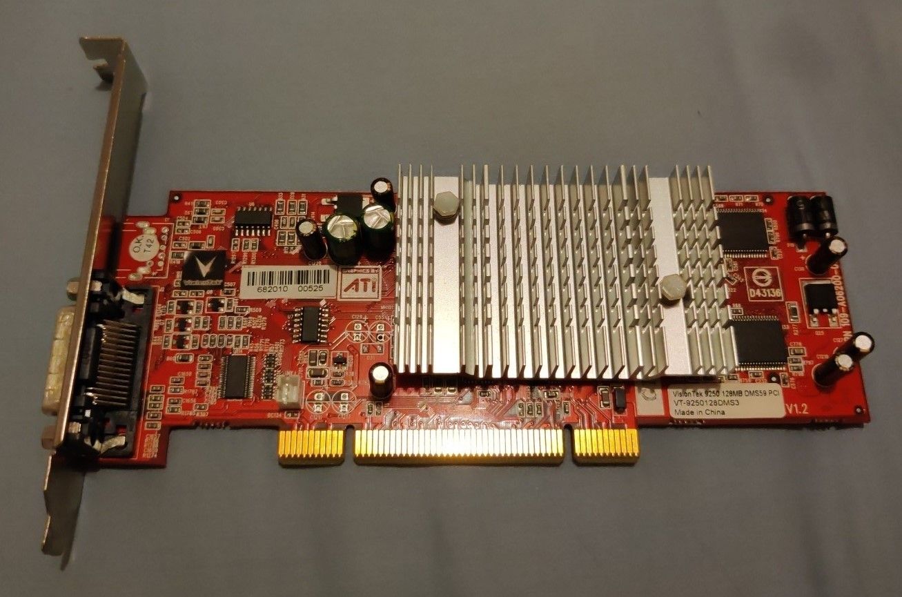

Obsolete is currently working over a VTK-400125 VisionTek ATI Radeon 9250 DMS59 PCI VidCard for me to drive the second display over DVI to HDMI converter cable on the USB3/HDMI KVM Switch.
Hoping the 128MB PCI card will drive the 1440p screen at a higher resolution than the 32MB AGP card. According to the RADEON 7000 MAC EDITION (32MB) user Guide, that one tops out at a 1920x1440 pillared at the screen's native resolution? Right now it's stuck at 1920x1080 before driver installation, but may be a problem when installed:

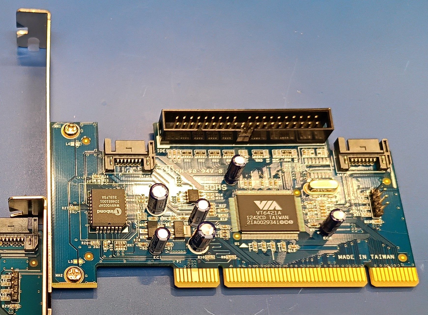

Also installed the flashed Kuroutoshikou SAPARAID-PCI SATA/PATAcard I bought from him, gotta find some cables now!

Neat Pata/Sata card. I've never seen one before. I have a Visiontek 7000 pci in my B&W running Tiger. Ive not played with that ATI config menu before. Sounds like a fun reason for installing & dual booting os9lives 9 dmg in my B&W.

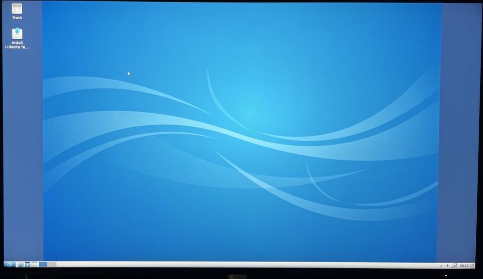

Soon after I had installed and retired Lubuntu 12.04 Remix on my Mac Mini G4, I continued seeing why hubbub continued surrounding it and Lubuntu 16.04 Remix by installing Lubuntu 16.04 Remix for myself for reasons I already listed in my previous post. While Lubuntu either moved or killed off their old repositories for the 12.04, 14.04, and 16.04 releases, one can still connect to a functioning mirror of Void Linux's software repository, meaning the software that you get prepacked with these elder releases of Lubuntu leaves the user dead in the water, whereas with Void Linux, the mirrors are still operational, so you can continue installing "new" (new to you) software just as normal. I really wish Void Linux had continued to be maintained for PowerPC, but seeing that the "16.04" in "Lubuntu 16.04" is in reference to its release date of April of 2016 and Void Linux for PowerPC was maintained from 2021 to 2023, there's therefore no contest as to which is newer, more up-to-date, and secure, if that is a concern to any one, but the fact that we all use 15+ year old versions of Mac OS X online goes to show that security isn't in the forefront of our minds, but an argument can made for the concept of "security through obscurity". An up-to-date version of the SeaLion web browser is also continuing to be made and hosted on GitHub for Void Linux, so web browsing is covered. The same cannot be said for any Lubuntu Remix, as Arctic Fox, for example, will not compile for it. Cobbling together an instance of Debian or Arch for PowerPC is not for the faint of heart, either, and since both distributions use systemd as the default init system, I refuse to even attempt to drag my feet into such a deep trench of sleepless nights compiling in dependency hell. It's the same reason I and many others don't bother with MacPorts for Mac OS X, either.

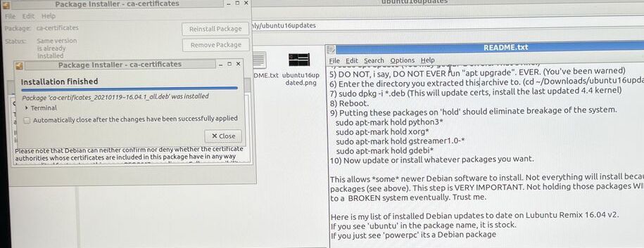

Here is an image of me burning Lubuntu 16.04 Remix to an optical disc and the readme file w1ckn1x included. I can't remember if I followed it or not, but I think the recommendations were temporary/timed, meaning that they were only relevant when it was new and can no longer be replicated.
Moving on, Lubuntu 16.04 Remix presented an initial obstacle to the installation that was not present in Lubuntu 12.04 Remix. As many within the Linux world are aware, this is not because of something w1ckn1x did to it. Rather, as I recall, it is because of something deprecation is graphics drivers in subsequent versions of the Linux kernel that are present in Lubuntu 16.04 onward, I think. In practice, at the yaboot prompt, one must type "radeon.agpmode=-1" (without quotations). If not, then the installation process will freeze every time.
I apologize, but I can't remember the context behind this image of mine. From what I can gleam, I appear to be applying 2021 ca-certificates for Arctic Fox. In any case, I enjoyed using Lubuntu 16.04 Remix more than my short time with Lubuntu 16.04 Remix. To clarify what I meant earlier about the user experience being sluggish on Lubuntu 12.04 Remix, I'm certain it was something to do with the graphical acceleration. Dragging windows left a "trail" of sorts and the CPU bore the grunt of having to redraw windows. That wasn't the case in Lubuntu 16.04 Remix. I don't know if anything was to be done about it on my end.
Attempting to connect to the Debian Sid software repository to install new software, as was claimed possible in the same MacRumors thread about Lubuntu 12.04/16.04 Remix, my entire installation ran into software/dependency incompatibilities and resulted in Lubuntu 16.04 Remix being in an utterly unusable and un-bootable state. How lovely. Granted, w1ckn1x warned that this was a possibility, but don't we welcome challenges? You know, like POWERPC CHALLENGES? I'm bad with humor, sorry. Unaware of what software would result in a broken system, I went ahead and installed icewm, which gave me a rather new version. Satisfied, I continued, but, if I recall correctly, I didn't get far before I was given a broken system. Well, bummer. So, no, unfortunately neither Lubuntu 12.04 Remix nor Lubuntu 16.04 Remix may be used in any sort of serious manner. Until Adelie Linux finally gets out of Beta development, there is essentially NO up-to-date Linux distribution for PowerPC owners.

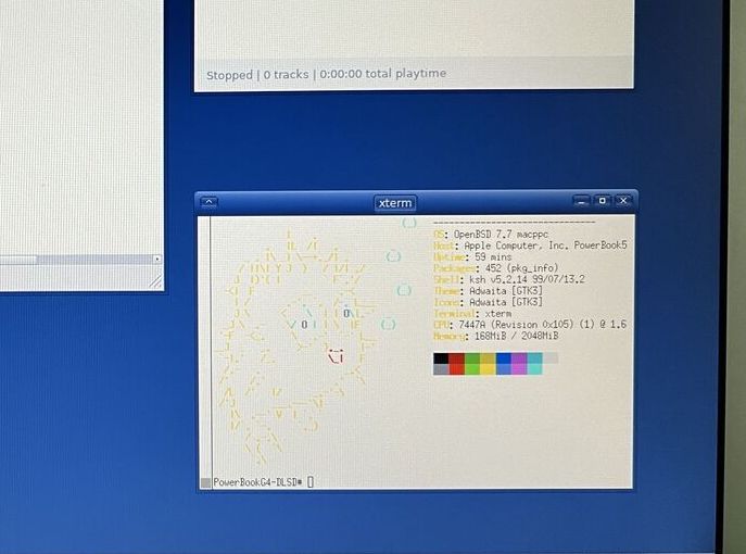

I ended up stepping away from PowerPC Linux and switched focus toward OpenBSD! I'm surprised OpenBSD on PowerPC isn't talked about as frequently as I would think it to be amongst our small PowerPC Mac community, as OpenBSD 7.7 proved to be not only easy to install (the command-line installation sequence is very straightforward and, with a tutorial, is practically foolproof), but it ACTUALLY installed CORRECTLY, period! It's sad that that's actually a proverbial selling point that must be made, but that's the world we live in. Yes, I am unaware whether you, reader, know or not, but you are more likely than not to run into broken operating systems for your Mac than functioning ones.
Not pictured are the finnicky commands you have to feed Open Firmware to make it automatically boot into OpenBSD 7.7 once installed from the CD. I do believe OpenBSD 7.8 has since been released after I installed to my PowerBook last year. I followed the "OpenBSD Wiki" provided by z970 on the MacRumors forums (https://forums.macrumors.com/threads/the-openbsd-wiki.2196940/) and got icewm installed so I can boot into a graphical environment upon logging in to OpenBSD. A few command-line sequences later and presto!
Here is my obligatory neofetch screen.
OpenBSD on PowerPC isn't all sunshine and rainbows, unfortunately. A big issue for many is the complete lack of FireWire support and the paltry selection of software, even less so than PowerPC Linux, if you can believe it. Another, which DroneCatcher noted in that thread I just linked, is the total lack of audio support, which irritates me the most to the point that OpenBSD just isn't an option on PowerPC at all, at least for my use case. I'm sure as a server, OpenBSD excels at that. To avoid myself from making this post any longer, here is my sorrowful end with OpenBSD in the following photograph with an angry note of grievances:
STAY TUNED NEXT TIME TO SEE IF MY SITUATION IS MET WITH A HAPPY ENDING!

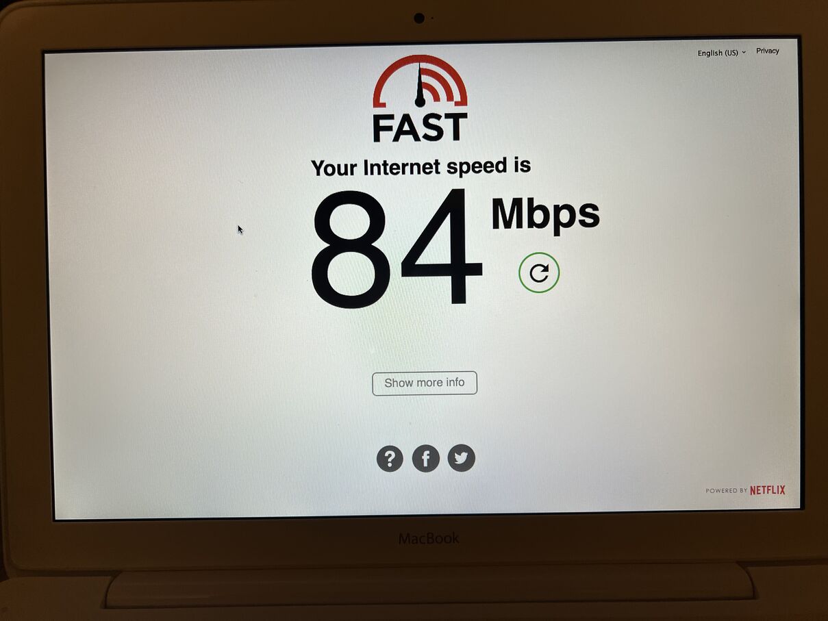

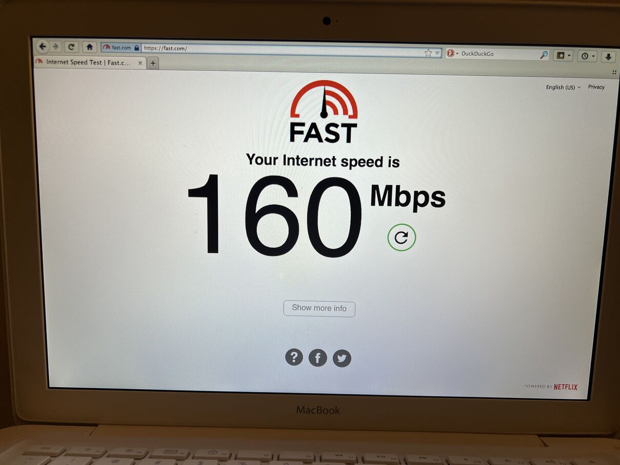

I wanted to test out the capabilities of a set of powerline adapters I once purchased to see what speeds I could get for my PowerPC Macs, considering their wireless networking caps out at 802.11g at 54mbps. I already have a couple of Wi-Fi USB dongles with the newer faster 802.11n standard that also have PowerPC-compatible drivers and software (see the Ra-Link and Realtek drivers on Macintosh Garden)(https://macintoshgarden.org/apps/ralink-usb-wifi)(https://macintoshgarden.org/apps/realtek-rtl8188cu-usb-wireless-mac-drivers), but if I could get comparable or even better performance out of Ethernet-over-powerline then that would be awesome, plus I would free up an extra USB port on these Macs that already have too few USB ports for my needs anyways. If you're NOT using Apple's Mighty Mouse plugged in to the side of Apple's wired keyboard, then you pretty much have only 1 remaining USB port on the iMac G5 and all PowerMac G5s except for the final late-2005 PCIe models. If you're a Mac Mini user, you just lost all of your USB ports and can't plug in anything else. Thankfully, other manufacturers like Macally and Matias have made keyboards with USB ports on their sides, as well, so you're not actually limited to using Apple's wired keyboards, but I digress. Equal or faster internet connection speeds AND freeing up a USB port? Let's dig out these powerline adapters and see what can be done.
I and many others are already well aware of the massive limitations of Ethernet-over-powerline. The reported speeds claimed by manufacturers are borderline false advertising and it all depends upon the wiring of your home, whether or not the room in which your router resides in is on the same circuit as the room your powerline adapter resides in and yadda yadda.
They claim to be Gigabit Ethernet speeds, but obviously in practice you're lucky if you get even a third of that speed. Essentially, in the era of 400+mbps 802.11ac Wi-Fi and even better 802.11ax Wi-Fi (or, "Wi-Fi 6"), powerline adapters are pretty much a rip-off and a straight-up downgrade in every case. But, since all PowerPC Macs came with 54mbps 802.11g Wi-Fi, or older 802.11, or no Wi-Fi at all, Ethernet-over-powerline is a great option if your Mac isn't in the same room as your router and you don't want to string long Ethernet cables around your house.
Let's get to the point. I had my 2010 polycarbonate MacBook running 10.6.3 Snow Leopard help me out in this test to use as a baseline benchmark for comparison. On older versions of Mac OS X (I think pre-Lion or pre-Mountain Lion?), one must open System Preferences, navigate to the "Network" section, then click on "Advanced" in the bottom right corner, then in the TCP/IP section turn off "Configure IPv6", then under the "DNS" section click the + symbol to add a new DNS server and type 8.8.8.8 in the box. Otherwise, your Mac will freeze up and force you to restart the computer.
Manufacturers recommend against plugging in your powerline adapter into an extension cord or powersurge protector instead of directly into the socket in your wall, but since I'm curious, I did it anyway to see what speeds I could get. Below you will see the stock 802.11n Wi-Fi speeds my MacBook gets and the slower speed is the speed the powerline adapter permits when NOT plugged directly into the wall socket:
Still faster than 802.11g Wi-Fi, but slower than 802.11n Wi-Fi by a large margin.
Alright, enough fooling around. What do we get when the powerline adapter is plugged directly into the wall socket and connected to my router, with the other powerline adapter connected to my MacBook?
The 120mbps speed you see was the first test and the 130mbps was the second test I did. So, when plugged directly into the wall as it should be, Ethernet-over-powerline yields a connection speed marginally slower than 802.11n's 160mbps connection speed, at least in my house. Your mileage may vary in your case, and maybe even wildly so. So, is the 30/40 mbps shrinkage worth it for a more stable wired connection and a free USB port not taken up by any of my 802.11n Wi-Fi dongles? I'd say so. Does it justify the ~$80 price tag for a set of powerline adapters just for this, though? You be the judge.

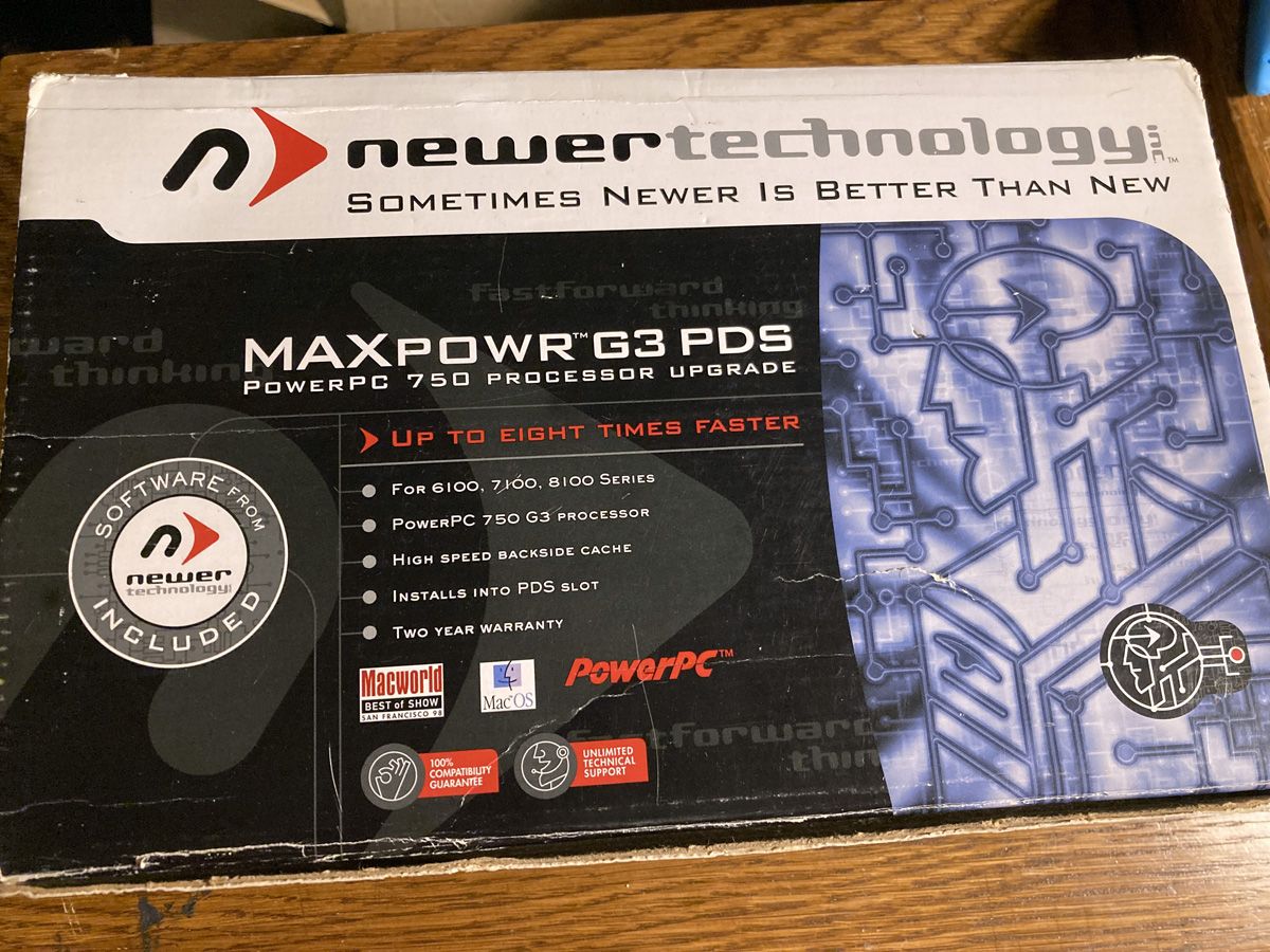

Day 15: Missed a few days
Work has been long this week, so I haven't had the desire to get into anything when I get home in the evening. I pulled a few things out to look at this weekend. I remember back in the day when 10.0 beta came out... I had some PowerMac clone with a 604e and only 8MB of ram... but it did run although slowly. Going to try to recreate that experience on either a 7600/200 or an upgraded 7100/66 with a G3 in it.
The G3 option I purchased from @This Does Not Compute
For the 7100/66.
I am also working on fixing a broken SCSI CD-RW drive. Everything seems to move fine, just the rubber band for the eject/load is dead.
Hopefully this 3-day weekend will be more productive.

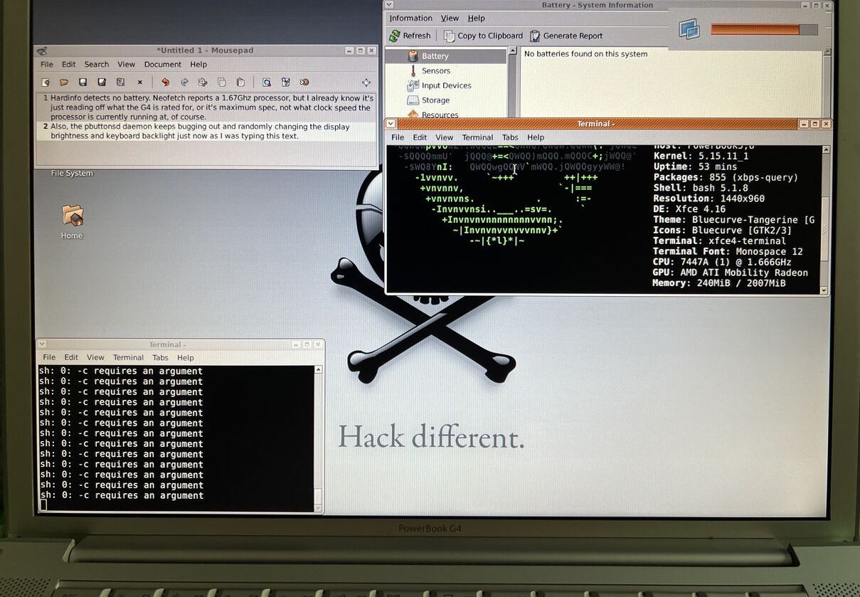

So, OpenBSD was a bust. It got farther than nearly all available Linux distributions in that it actually got past the installation sequence and booted, which is sadly saying a lot, but the anemic collection of software packages, the lack of any audio (and yes I checked to see if there was an audio mixer like pnmixer but there isn't one in the OpenBSD "macppc" repository), and the forgoing of FireWire doesn't make it any more desirable than some other alternative, none of which have even matched the usability and ease of Mac OS X on any PowerPC Mac.
Last August, I installed Void Linux to my PowerBook G4. A plus about Void Linux that, if using a kernel newer than 4.18, then you don't have to type "radeon.agpmode=-1" when using an ATI Radeon GPU every time you boot into the OS. Also, unlike most Linux distributions for PowerPC, full graphical acceleration is enabled out of the box, if you have a supported GPU. Here is a list of supported GPUs: https://web.archive.org/web/2023020...voidlinux-ppc.org/configuration/graphics.html. Since the operating system has since been abandoned and its main repository shut down in 2023, I had to connect to a mirror repository to get software installed. I used this Void Linux repository for the musl variant of Void Linux: https://mirrors.servercentral.com/void-ppc/archive/ppc/musl/. A repository for the glibc variant of Void Linux is NOT preserved, so Arctic Fox, for example, cannot be compiled as it requires the glibc library. In order to add this mirror repository so you can install software from it, you can follow this official guide: https://voidlinux-ppc.org/docs/documentation/project-organization/sources-and-mirrors/. Essentially, what you must do is copy 00-repository-main.conf found in /usr/share/xbps.d directory to the /etc/xbps.d directory. Add the line “https://mirrors.servercentral.com/void-ppc/archive/ppc/musl/“ to 00-repository-main.conf in your /etc/xbps.d directory, then open a terminal and type "sudo xbps-install -Su" (without quotations). What that will do is sync your Void Linux installation with that mirrored repository.
Important to my PowerBook was the installation of pbbuttonsd and mouseemu from the mirror repository so I can use both the function keys and the right-click ability by pressing F11. Unlike in OpenBSD, there is a plethora of software to choose from with PowerPC Void Linux. For whatever reason, only the musl version of Void Linux had its repository preserved by others online, meaning I cannot install this to my Mac Mini G4 if I wanted to, as the Void Linux official GPU guide explains that the Mac Mini's ATi Radeon 9200 GPU produces glitches on the musl variant.
Also, PowerPC Void Linux does not provide a graphical partitioning tool, so the installation sequence is entirely manual and done from the command-line. This is the most difficult portion to installing Void Linux, and I have yet to be able to install a swap partition, so tools like htop report the system as having 0KB of swap space. The reason why I always have no swap space on Void Linux is because the installer keeps giving me errors about the block size while I try to create a partition for swap no matter the amount of space I suggest for it, so I'm left without swap, but 2GB of RAM is plenty for any PowerPC Linux or BSD distribution. At idle, Void Linux with XFCE uses about 200MB of RAM. Very efficient.

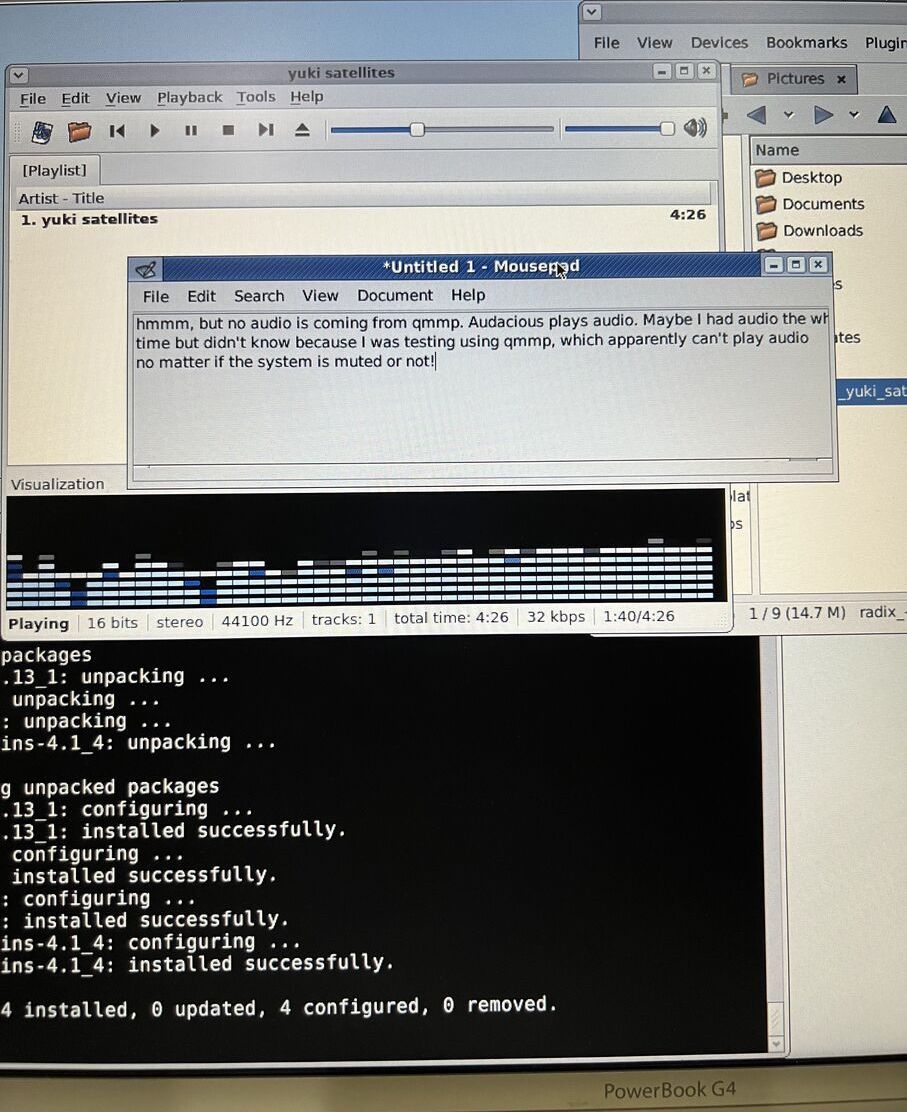

The lack of sound is a known issue in PowerPC Linux, and Void Linux was no different. I installed alsa-utils, qastools, and PNMixer, but none of them enabled audio when I tested audio playback using the qmmp program. It turns out that the mixers weren't the problem at all, but with qmmp itself! Audio got unmuted with pnmixer, but qmmp continued being silent! I found out when trying a different audio program. In my case, I tried Audacious and audio playback was normal!
Void Linux PowerPC also lacks an unzipping tool for .zip, .7z, and other archive file types, so I installed unzip from the command line to remedy that.
I tried a video playback test of a DVD-rip featuring a 200kbps video bitrate. Videos encoded in h.264 (MPEG-4 Part 10) rather than contemporary formats like MPEG-2 or DIVX are taxing on all but the dual PowerMac G5 models, so the results of my testing may or may not surprise you to find that the PowerPC 7447B in this PowerBook G4 DLSD was pegged at nearly 100% playing this 640x480 h.264-encoded ~200kbps DVD-ripped video in the .mkv container format. I tested playback in 4 different video players available to PowerPC Void Linux:
  1. VLC Media Player
  2. SMPlayer
  3. Parole
  4. Gnome-MPlayer
1. VLC Media Player faired the worst. Total CPU usage was at a constant ~100% and you get zero visuals. Audio plays, but you're presented with a black screen during playback. FAILURE
2. SMPlayer at least gave you visuals and audio playback at the same time, but the video stutters quite a bit. Total CPU usage was constant at about 85%. This faired inbetween VLC and Gnome-MPlayer.
3. Parole is the native video player bundled with the XFCE desktop environment. It was hard to decide if this was worse or better than VLC Media Player. Total CPU usage was pegged at a constant ~100%. You can video visuals, but strangely the colors are glitched with a blue overlay. Both the video framerate and audio stuttered considerably and it felt like watching a slideshow. FAILURE
4. To no surprise, the oldest and most lightweight option ended up being the best option. Gnome-MPlayer is a lightweight GTK2 frontend for MPlayer, arguably the least resource-hungry video player. It's invoked from the command-line and Gnome-MPlayer just gives it a GTK2-based GUI skin. Total CPU usage hovered around 75% and the user experiences minimal stuttering. Every 2 seconds or so, a frame is dropped and the video and/or audio skips a beat.
Also, I noticed that certain programs like HardInfo and htop reported this PowerBook's speed as being 833MHz instead of 1.67GHz. You can configure htop to show the current CPU frequency after pressing F2 and, sure enough, after configuring htop, it also reports that my G4 is running at 833MHz - half of the maximum clock speed. I couldn't surmise if it was because of the lack of a functioning battery or not, but I was sure that the CPU throttling to half-speed only affected the Titanium PowerBooks and the Early Intel MacBooks.
View attachment 26129View attachment 26128
