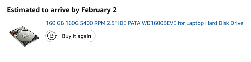

Good to hear I'm not the only one pushing the deadline out by 25% around here. :)
If I can't make that extended deadline looks like I've got a project lined up for MarchIntosh!
edit: Checked USPS site, doesn't say it left Memphis, but "in transit to next facility." WHATEVER . . .
