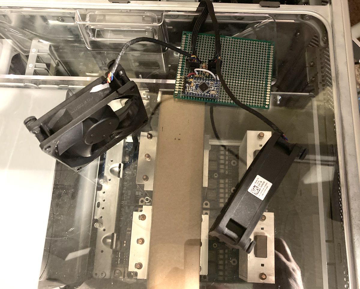

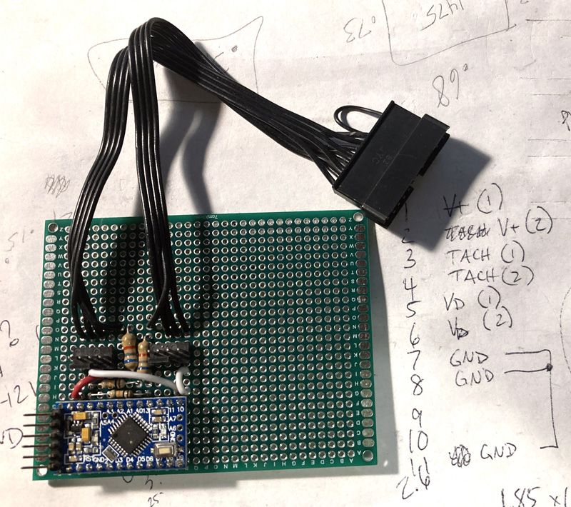

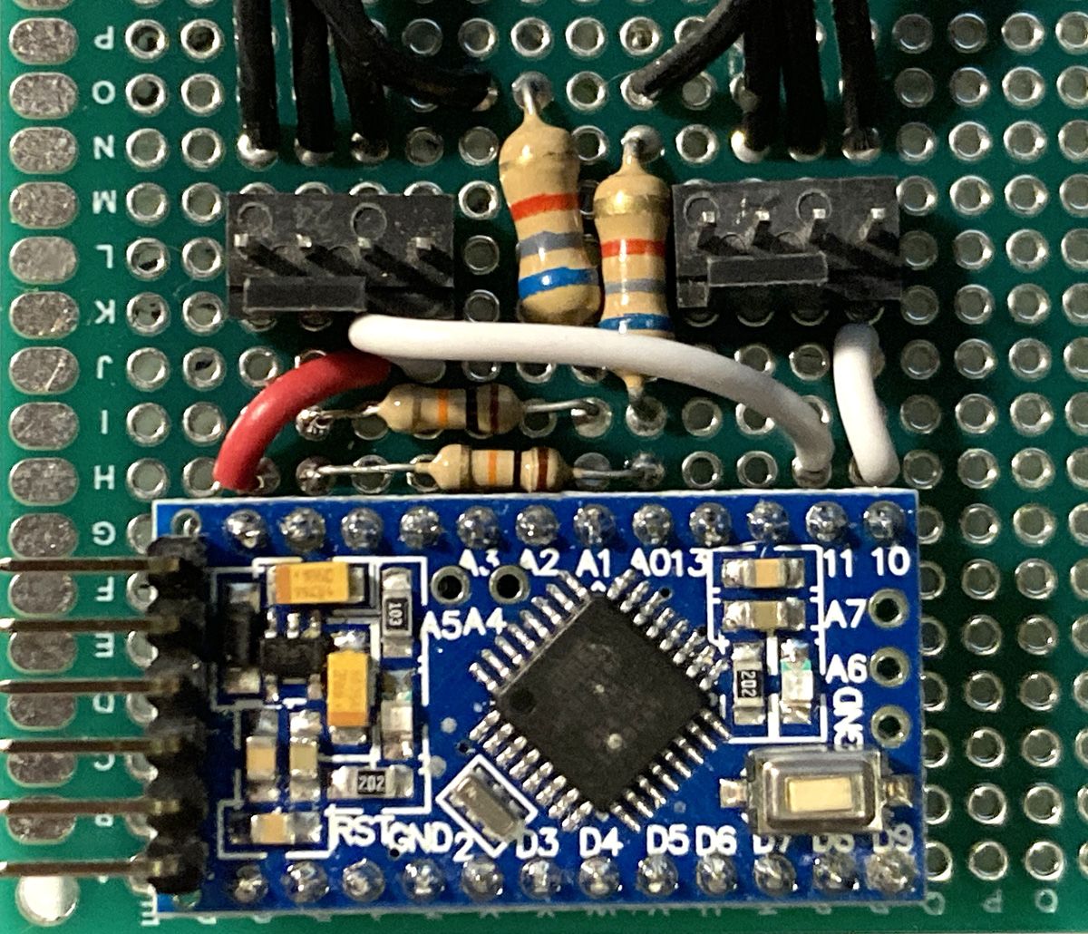

I picked up some perf-board from Micro Center. I pulled a couple PWM fan headers from a donor broken PC motherboard.
I did manage to solder up my LCS pump to PWM converter.

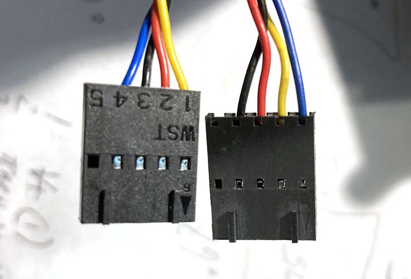

I had to rewire my fans as they are the DELL standard and not the "everbody not DELL" version. Dell on the left, "normal" on the right.
When I plugged it in to test it, only one of the fans came on. I rechecked my soldering and discovered I misplaced one wire, so I fixed that and reconnected everything. Still only 1 fan. So I wondered, did I somehow fry something in my probing and testing?
I searched a little more and found out that the PWM signal in a computer is typically the 25KHz range. The Arduino Pro Mini has pins that produce 490Hz and 980Hz. Depression set in, I didn't want to have to re-engineer the whole thing with some extravagant code. It can of course use counters to actually create the 25KHz, but other searches showed that the fans don't care, as long as the PWM percentage is correct for what your intended speed is. Days go by.

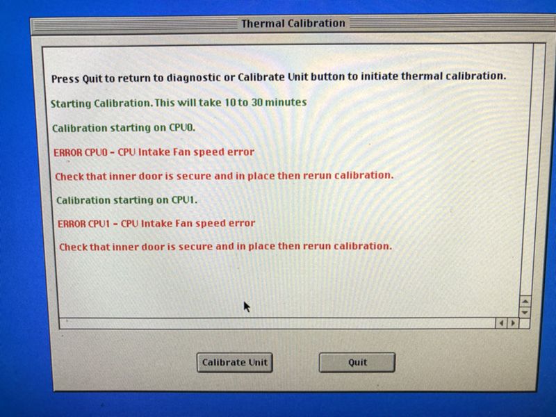

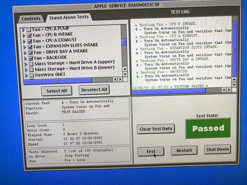

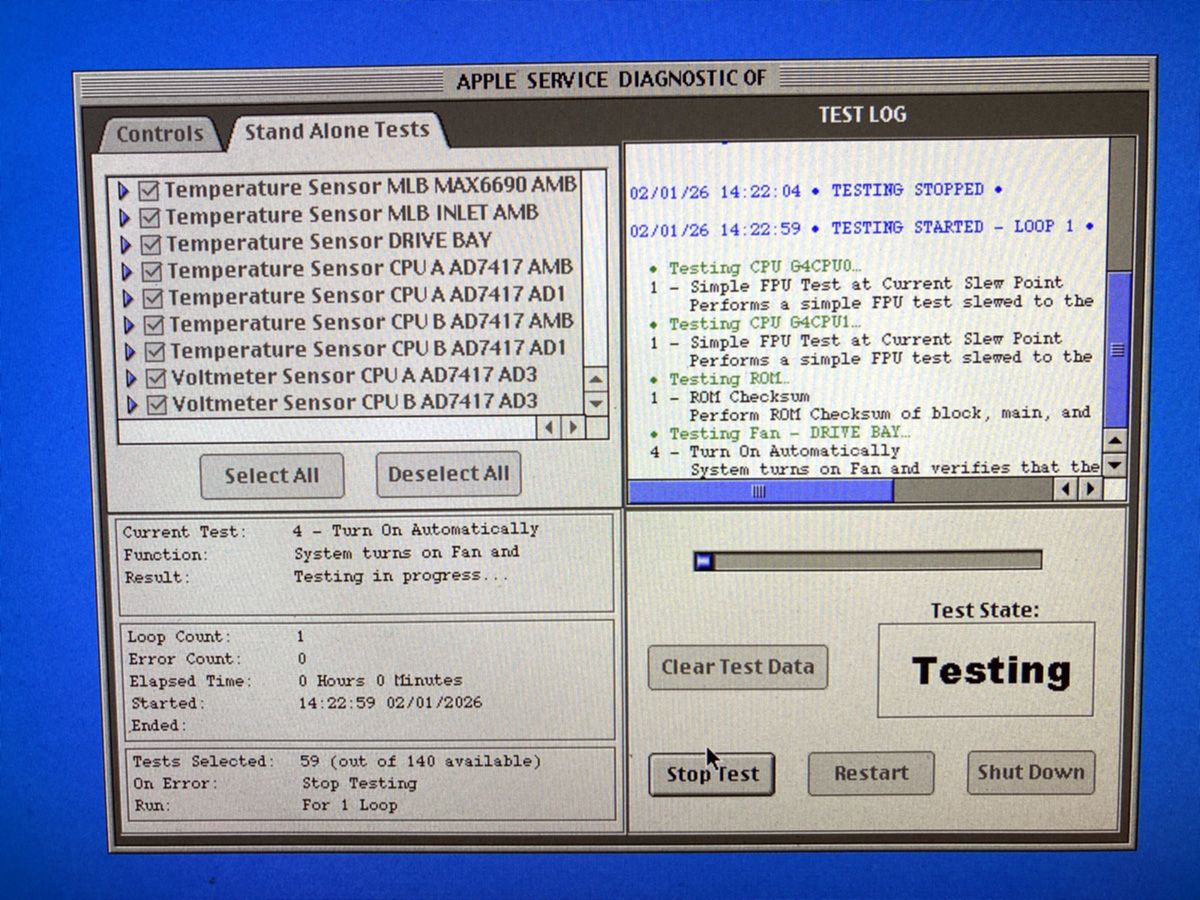

Here we are on Day 30, and I get back into it. I go back to retest the wiring harness and pin 2 is no longer registering any voltage. Again I think that I fried something. So I restart with the ASD CD and run the hardware tests. Intake fans not working properly. What? I look and sure enough, neither is running. FEAR: oh I fried something so bad! So dug deeper. I recall that I tried to remove the original wiiring harness from the motherboard, but then realized it also powered the intake fans. So I removed it again and saw that I had it 1 pin off. The pins/socket are keyed, but I must have pushed a pin through the plug. I aligned it correctly and seated it in. Now the intake fans were working.
Back to ASD CD and run the CPU and fans tests. All fans and CPUs pass, the PUMP fails (fans too fast). I have one of my PWM running full board and the other slowly so I will go back and do benchmarks to see if either changes speeds.
Nope... something is wrong. recheck my wiring and layout. Oh, I have my voltage divider resistors backwards. Must have been brain fog when I was not feeling well.

I got the resistors sorted correctly, but I am still getting a full 11.8V on the driver circuits, so I think the controller is getting the wrong Fan Speed readings from my PWM fans, or at least not what it expected. I then though I would try to turn down the max speed to 50-60% to see if that would be acceptable to the G5Q, but the Arduino Pro Mini 5V stopped communicating and I could not update it. Project for later or next year. I still have to 3D print a fan cowl to cover the air coolers. It is fully working under load, so I am going to leave it as is.

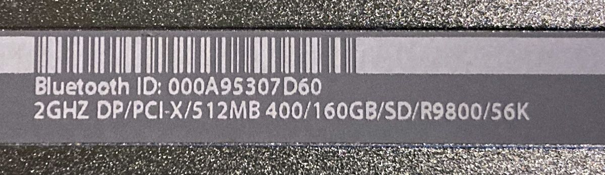

The final countdown! New to me, a G5 Dual 2.0GHz from Free Geek Minneapolis, sold as-is for $10. This will be Unit F.

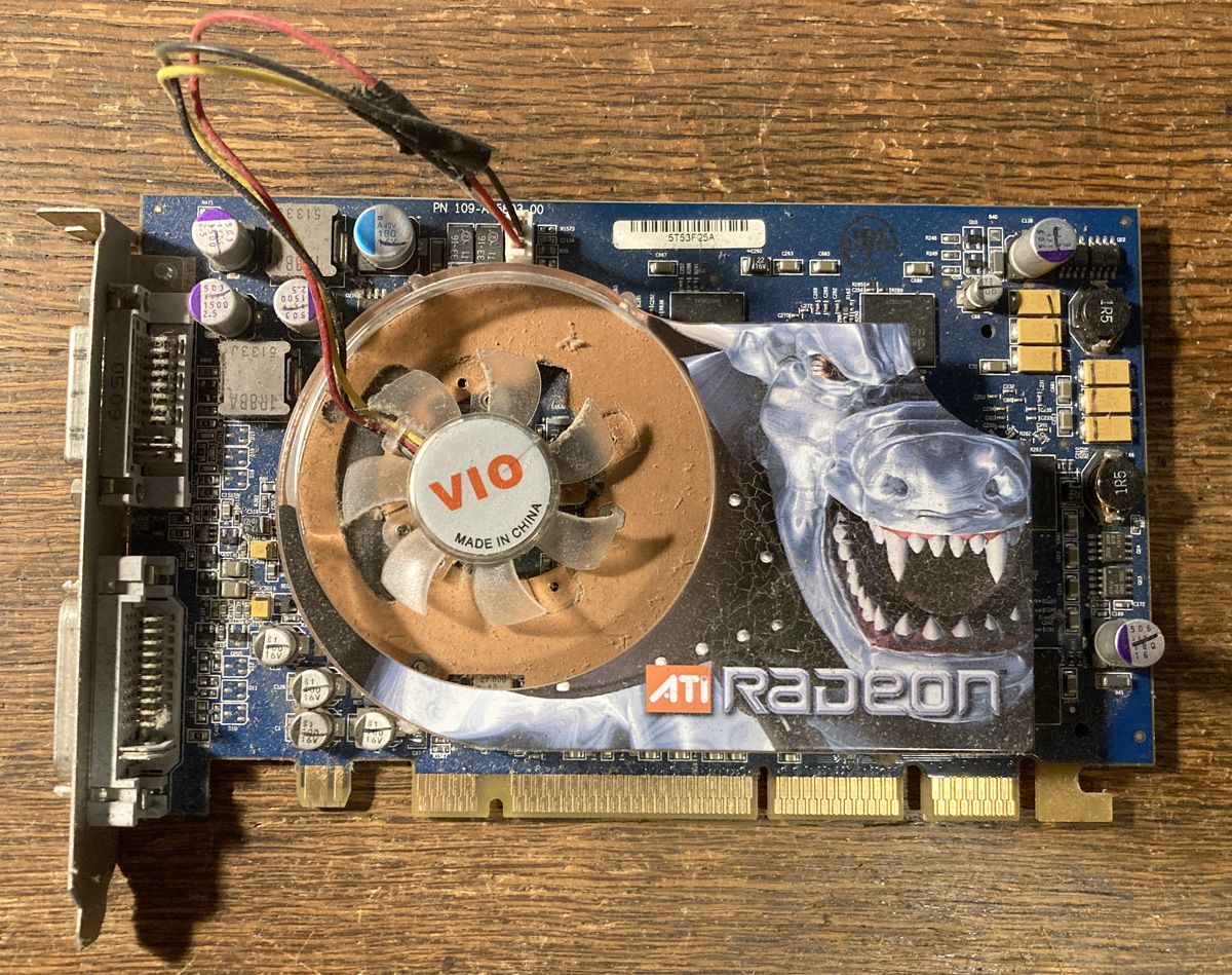

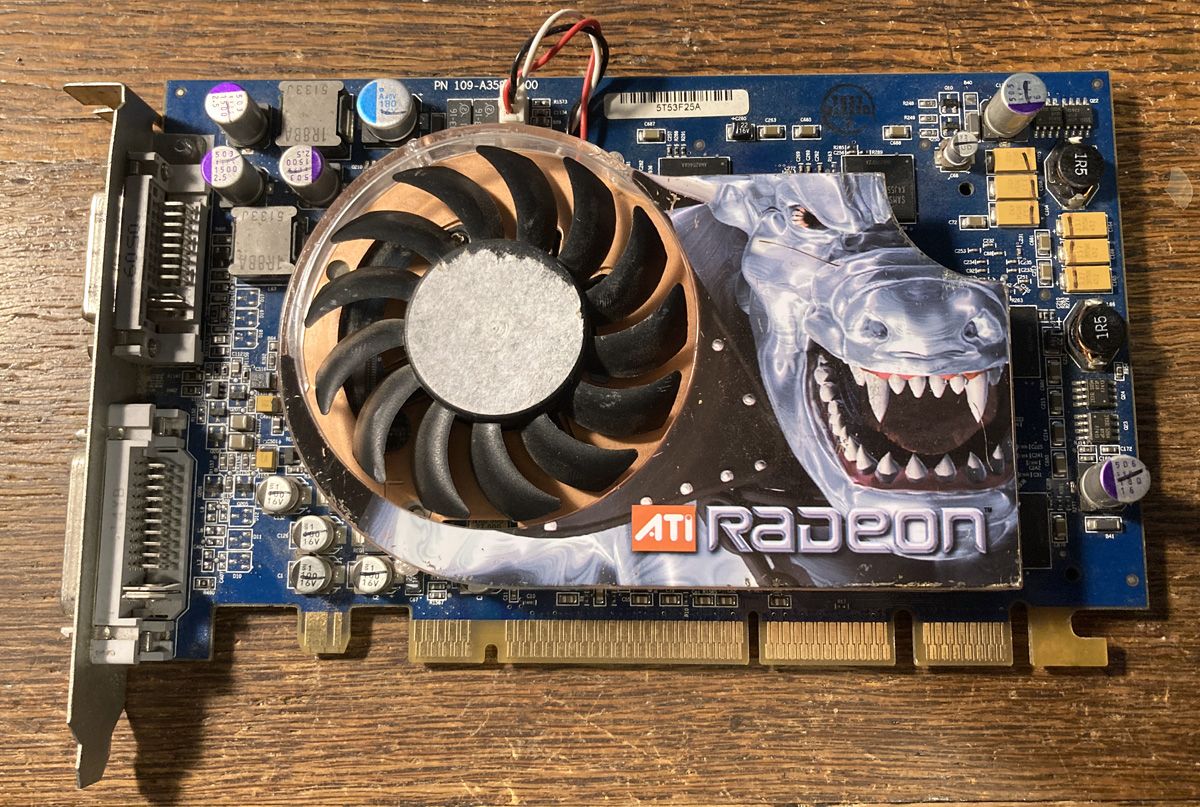

It did have a graphics card, so I popped it open to install a HD, and it was rather dusty. It is listed as a Radeon 9800, but it was actually an X800 XT 256MB. I decided to power it on anyway. I did get a chime, and eventually video, but the desktop never fully loaded. I got a blue screen with a spinning beachball cursor. The PSU was making some crackling/hissing sounds.

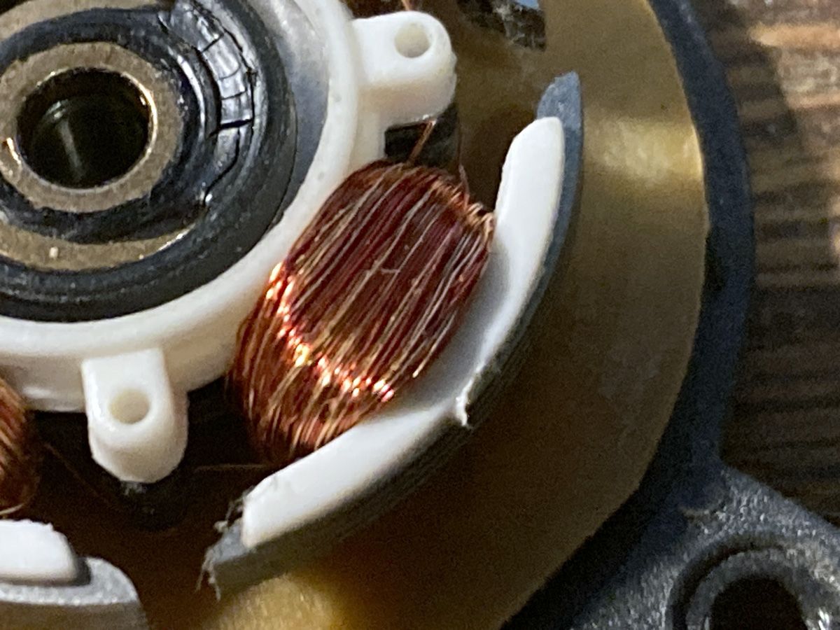

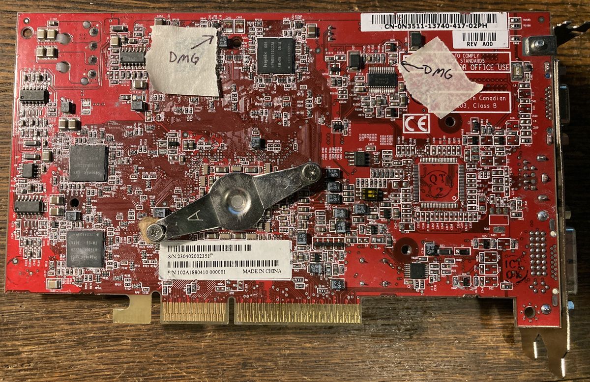

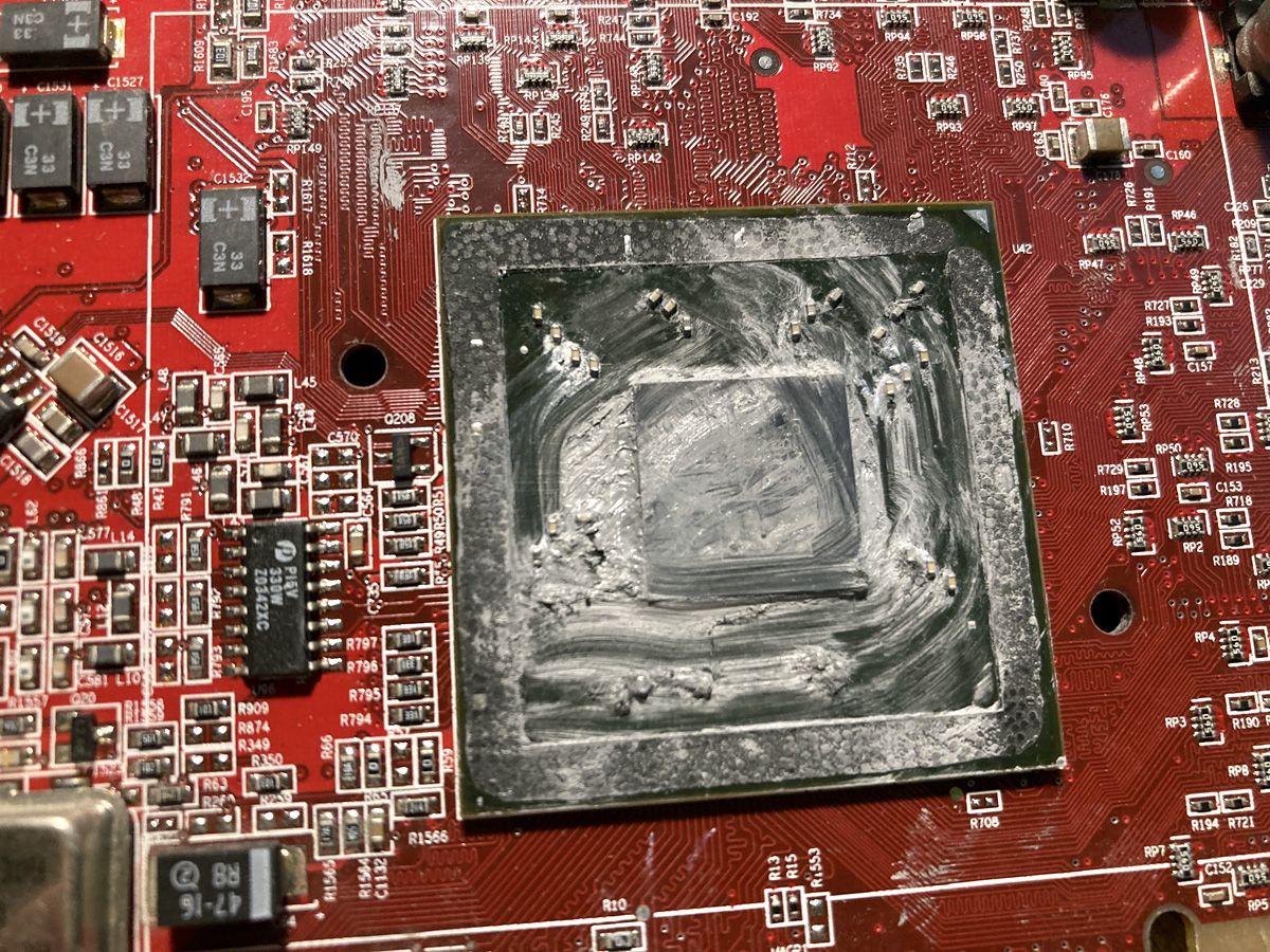

I saw the janky wire on the GPU so I pulled it. Oof, that is a substandard repair. This fan did not spin at all. Luckily I have a pile of old damaged cards for donors. The matching fan/cooler I had also had a gritty fan. So I disassembled the fan and found this tiny resistor floating around on the magnet.
Which, in it's journey, had marred up the plastic separator on the windings.
I cleaned up the dings, and reassembled, and next time I powered on, the fan was working great.

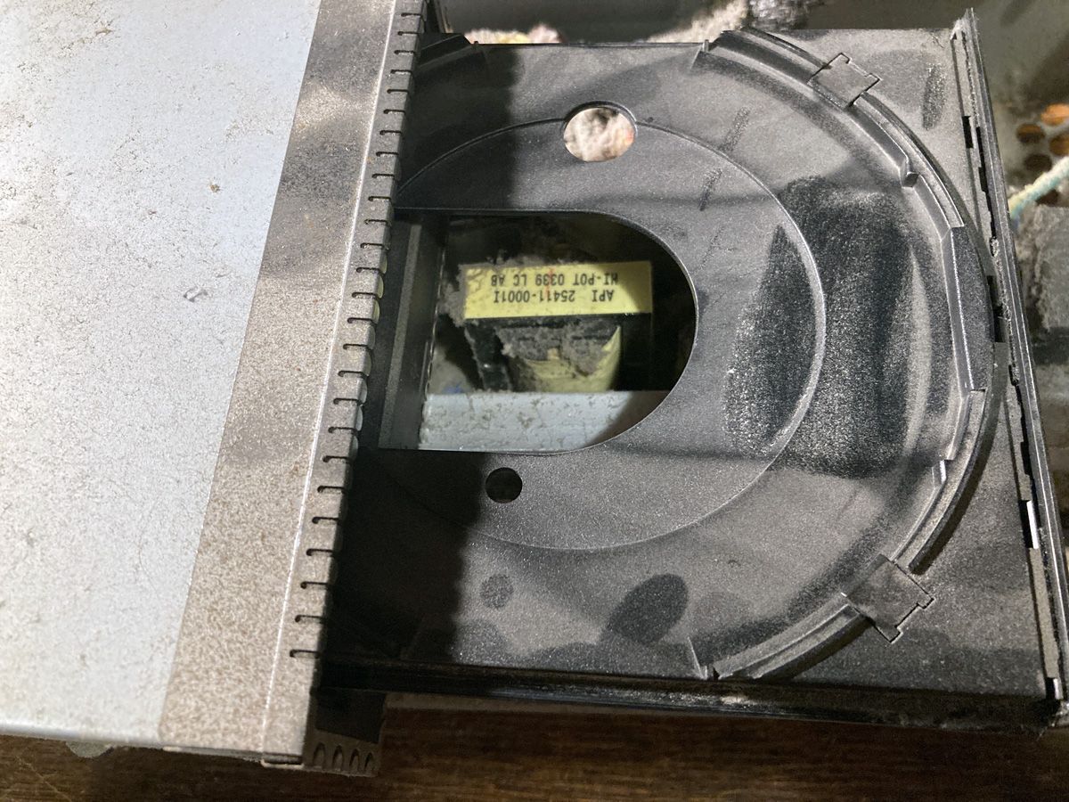

I tried to eject the optical drive to run the ASD but it would not eject. I tried to find the eject with a paper clip, but no luck. I removed the drive. The eject button actually missing. Manual ejection showed the drive full of dust as well.

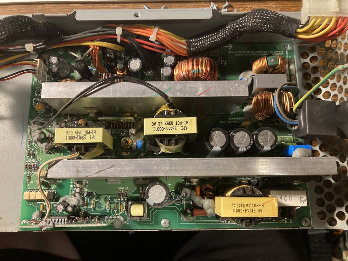

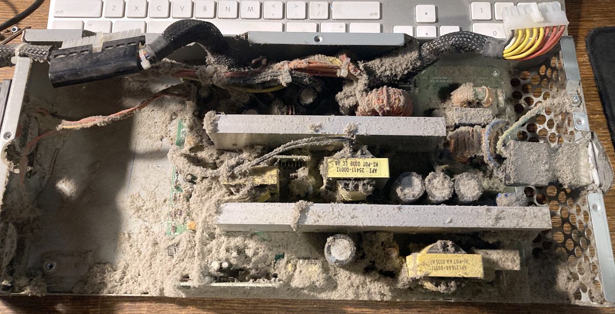

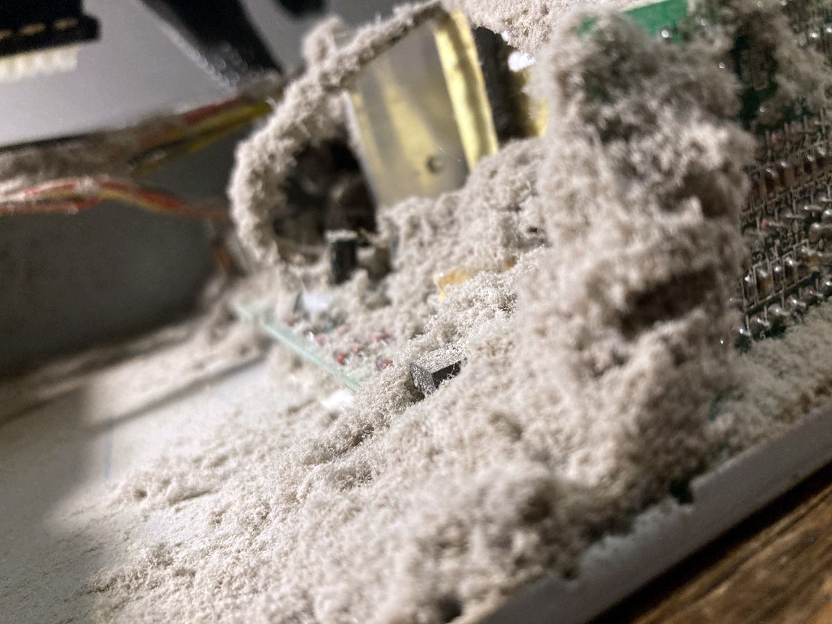

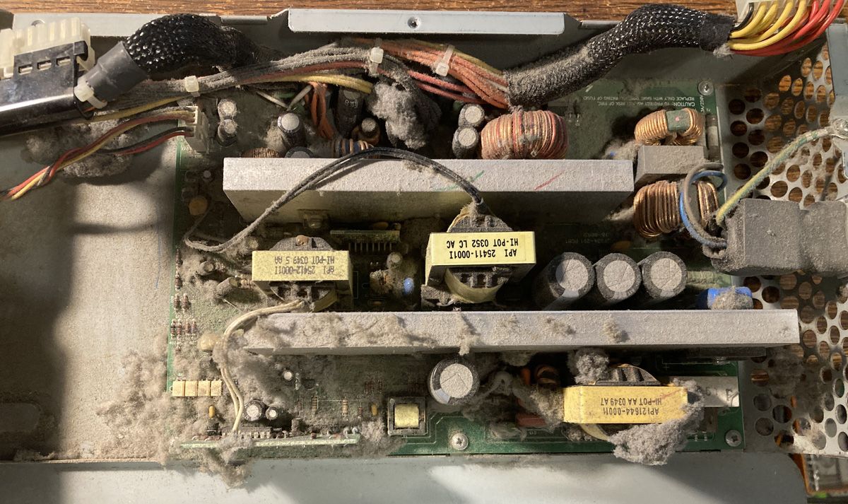

Since my Unit B is listed as "flaky", I think I will possibly try a PSU swap and see if that is the issue. I pulled the PSU from this Unit F, and it was a bit dusty.
You can barely see any green board! This machine has obviously been running a long time, and in a dirty environment. Time to get the air compressor and some baby wipes and clean this up. Then I will check caps, and do the PSU swap if needed.

@phunguss any idea where the resistor came from?
Likely from the damaged donor card. It had been poorly handled, and had lots of missing components on the back side. This was just a visual inspection without a microscope.
The previous owner obviously thought there was something wrong with the thermal compound, and they replaced it extra thick.

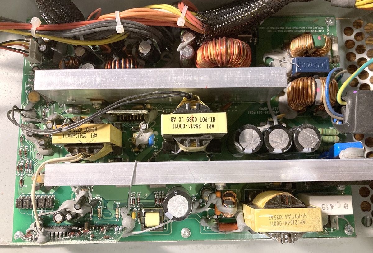

Day 31 finalizing
Unit F PSU after a blowout. Still ticking and hissing.

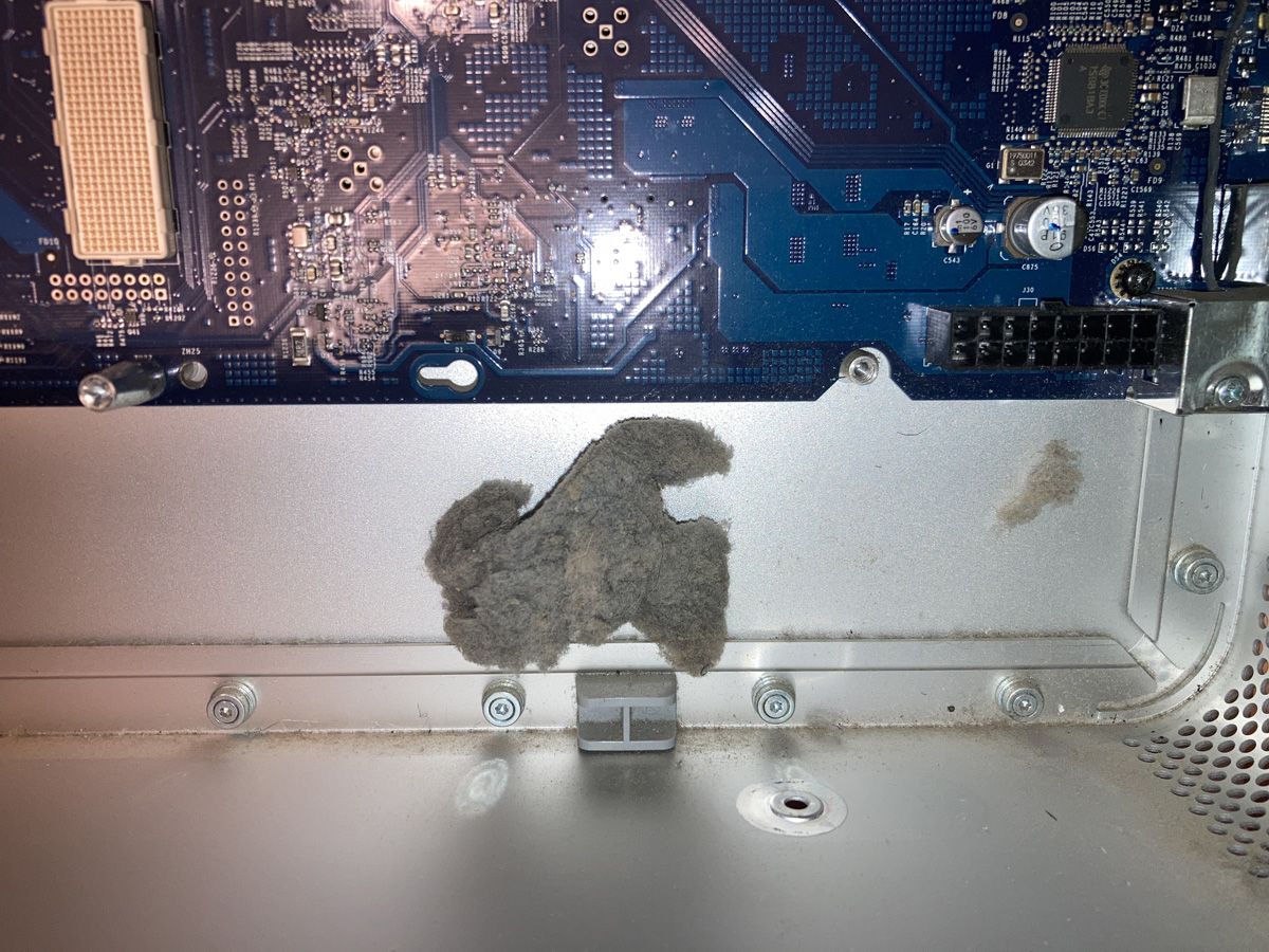

Pulled the PSU from Unit B, dust bunnies in the bottom of the case.
So maybe that's why Unit B is flaky.
Cleaned it up, installed in Unit F. I can get 10.4 and 10.5 to load under safe mode, but the ASD will not run. Maybe I will try an older version.

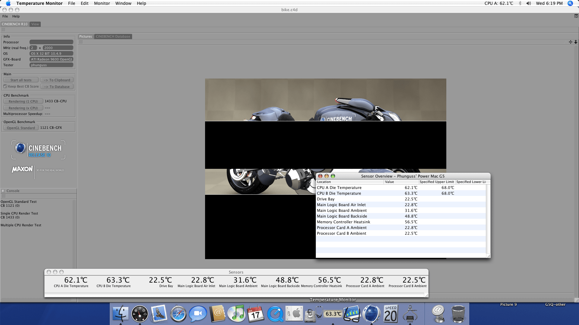

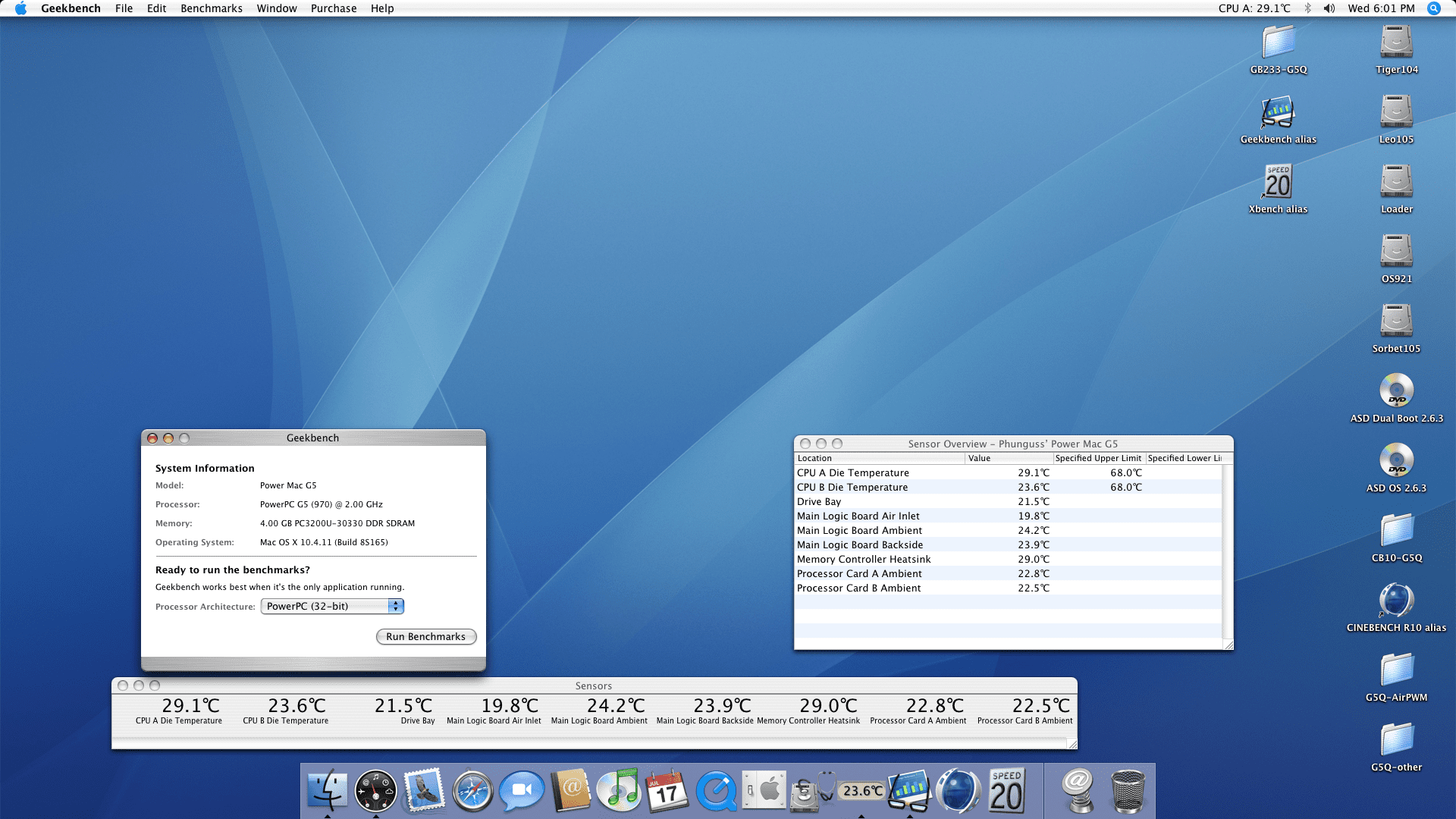

Day 32: Wrapup

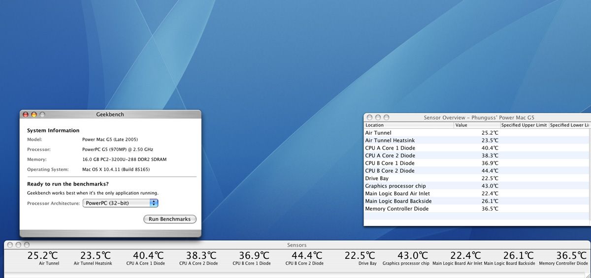

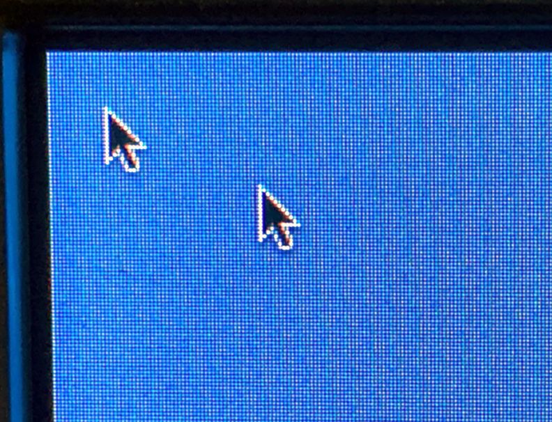

My latest acquisition of the G5 Dual 2.0GHz kept giving me issues. I replaced thermal compound on CPUs, replaced power supply... but I still could not get anything but a safe boot (or this goofy glitch).

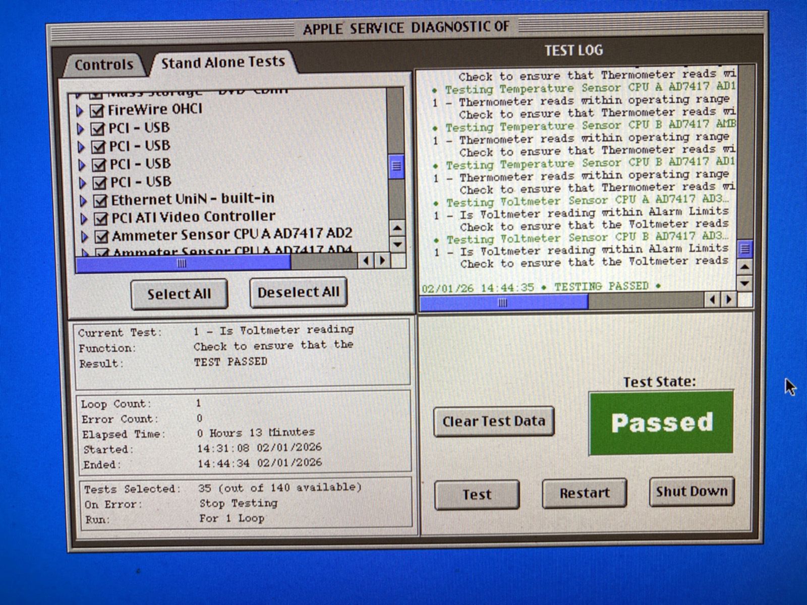

I figured maybe the repaired X800 XT was actually faulty. I swapped out a known working 9560 and it booted fine. I mistakenly had the ASD 2.6.3 disk in, so I swapped that for the 2.5.8 and ran the tests.
Everything came back fine.

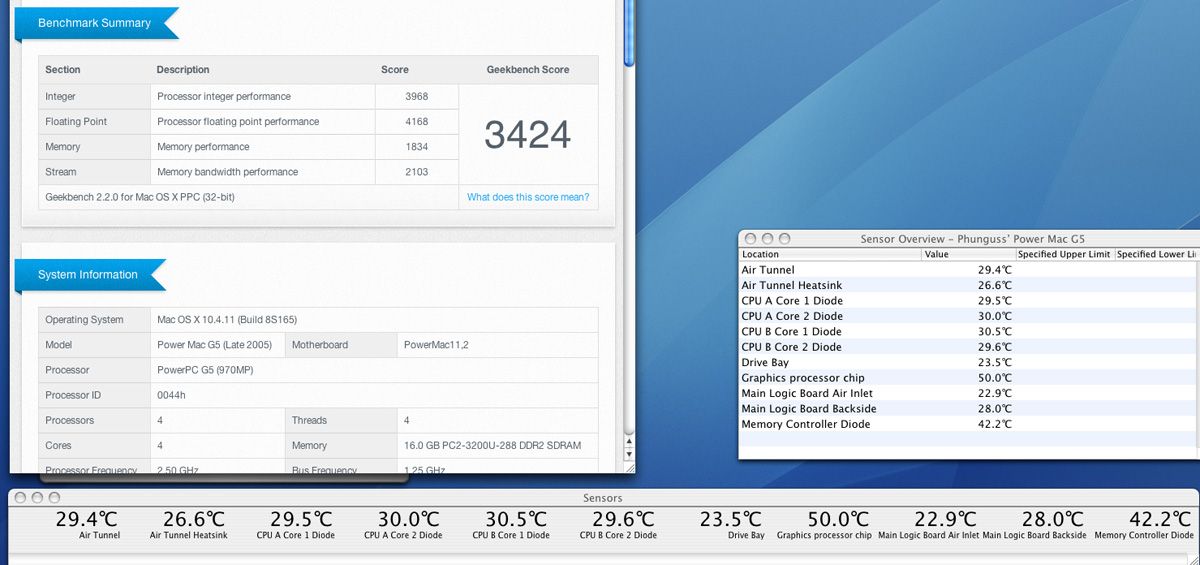

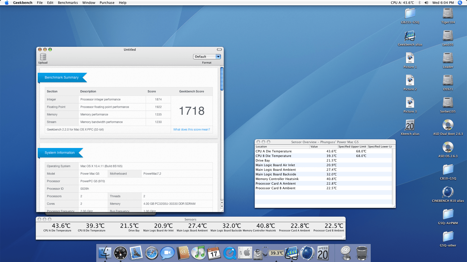

Benchmarks show starting low 20-30s
Not too bad of temps for air cooled.
Cinebench R10 gave the highest temps of mid 60s
So, all said and done, 3/5 on dual processor PowerMac G5s, and 1/1 on a Quad (4 out of 6 working great).
