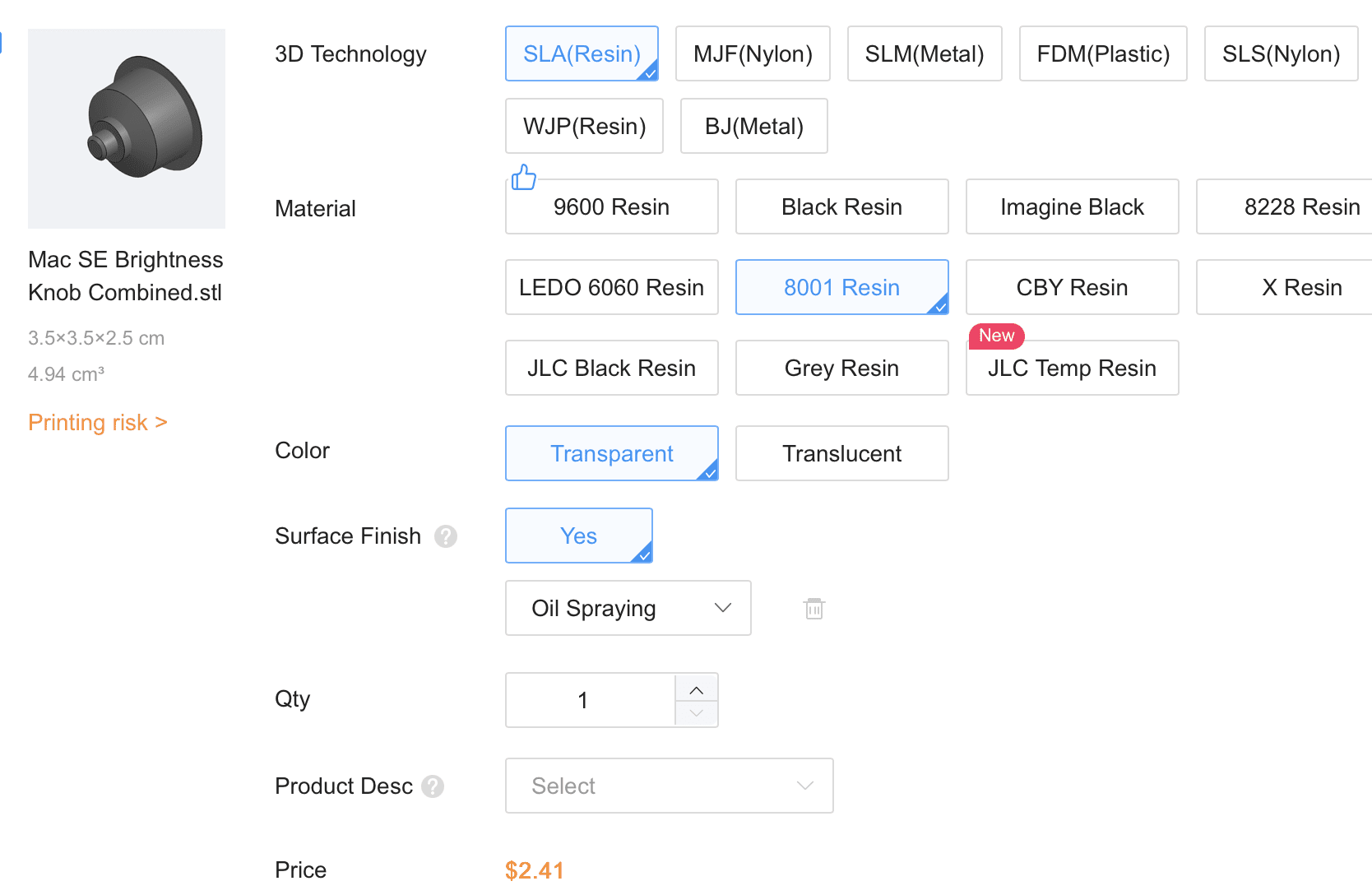

Will JLC print the knob in resin?
Yes. Here is your "Mac_SE_Brightness_Knob_Combined.stl"...

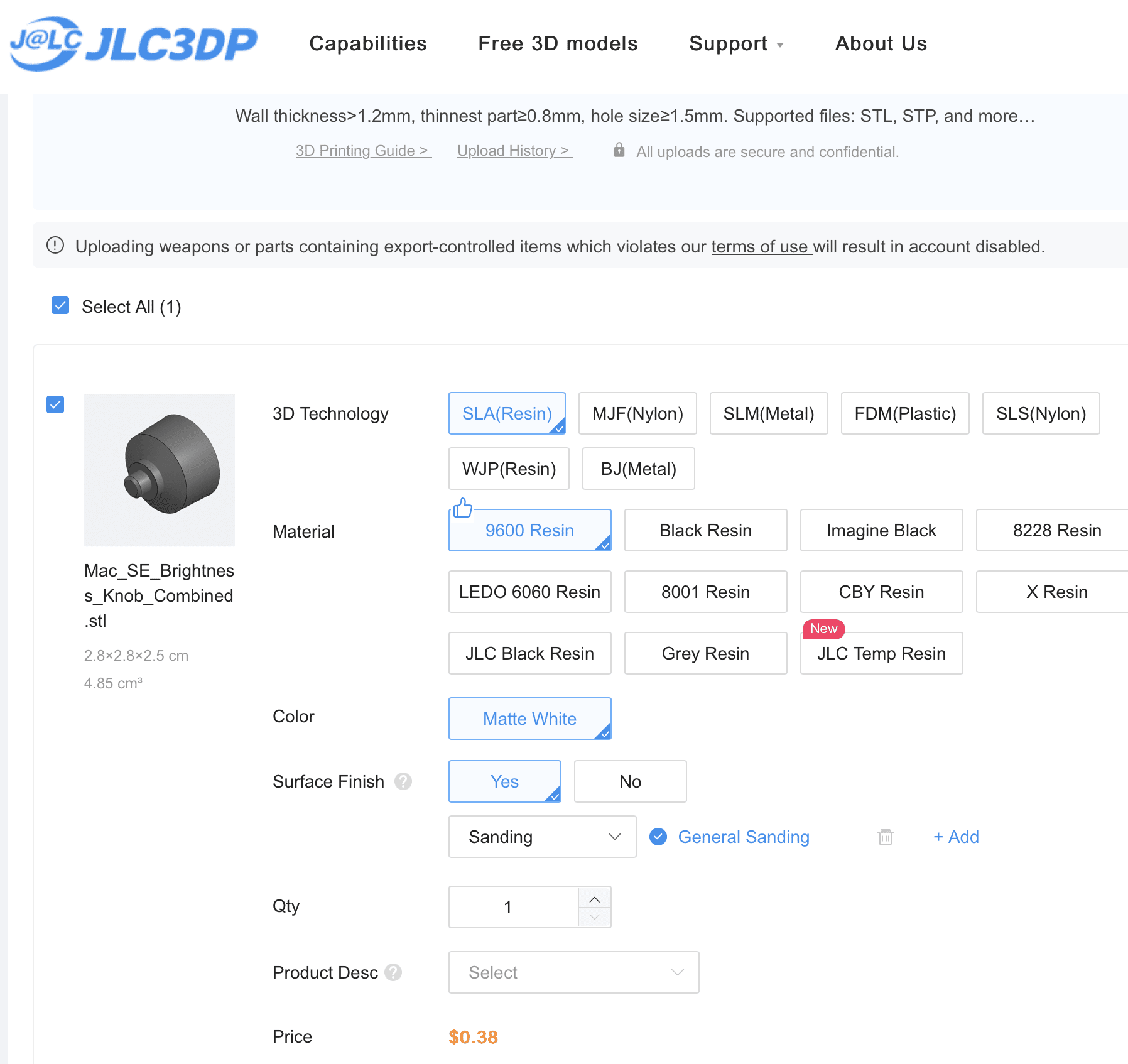

Until now, I've only had things printed in JLC Black Resin. Lots of Resin choices, but none are as durable as PLA, I don't think. So for example, if that inner piece (with split down the middle) is supposed to flex a bit, I'm not sure how Resin would react to that. Nylon would be a non-issue.

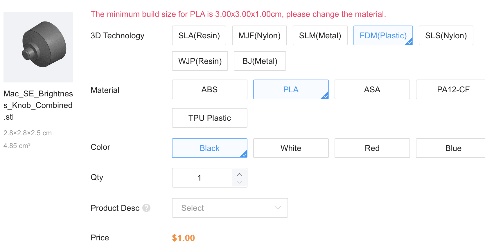

And when you choose "FDM" you get that infuriating "minimum build size" warning that prevents you from proceeding...
To try that yourself, just go here (I had to login first though)...

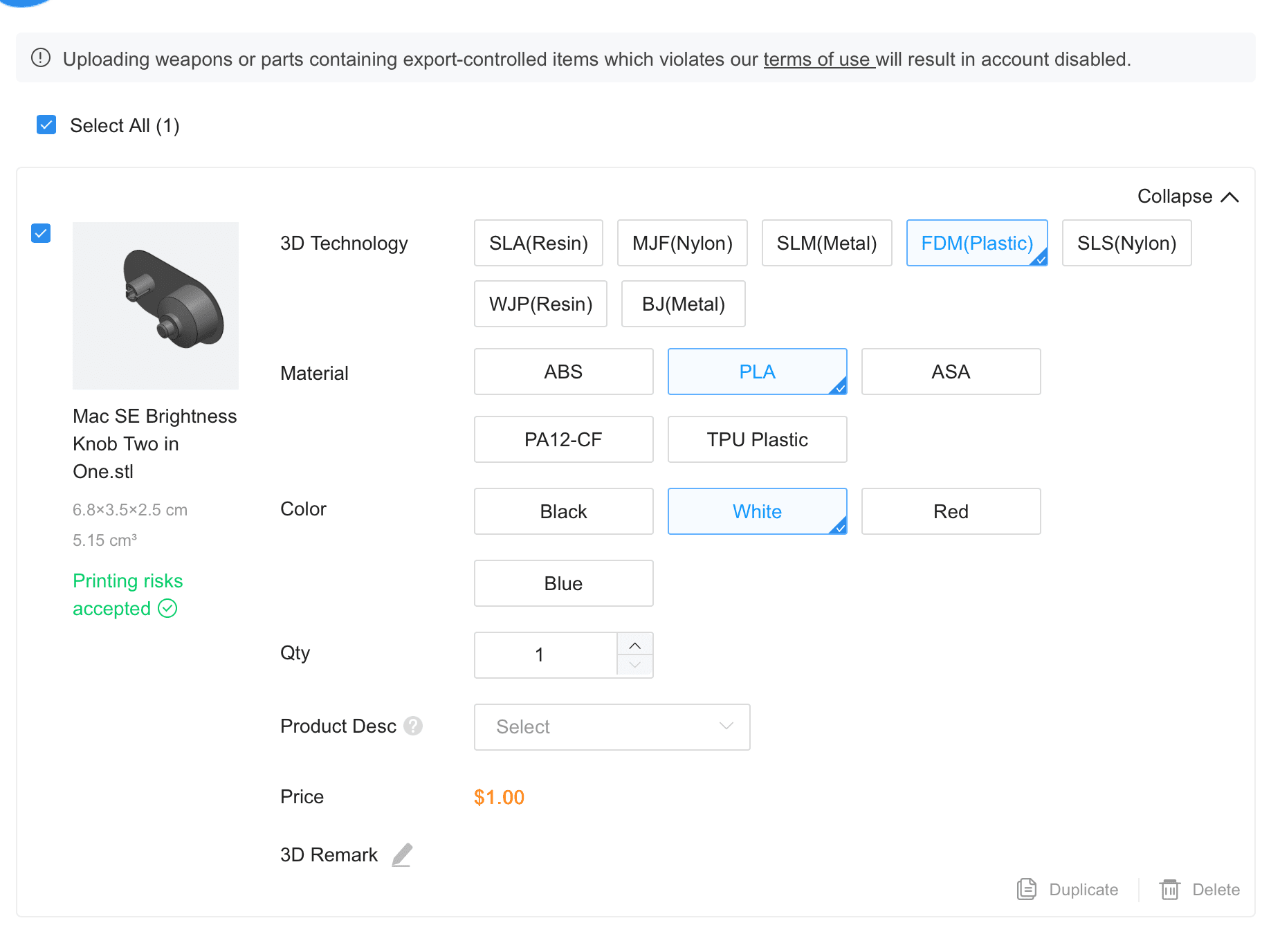

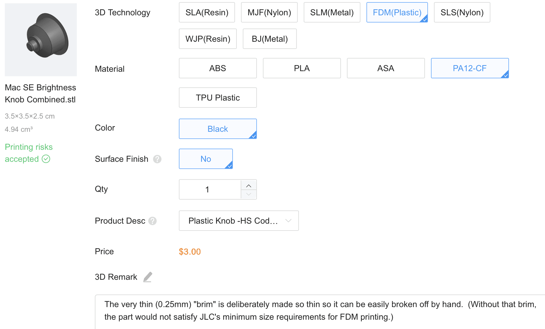

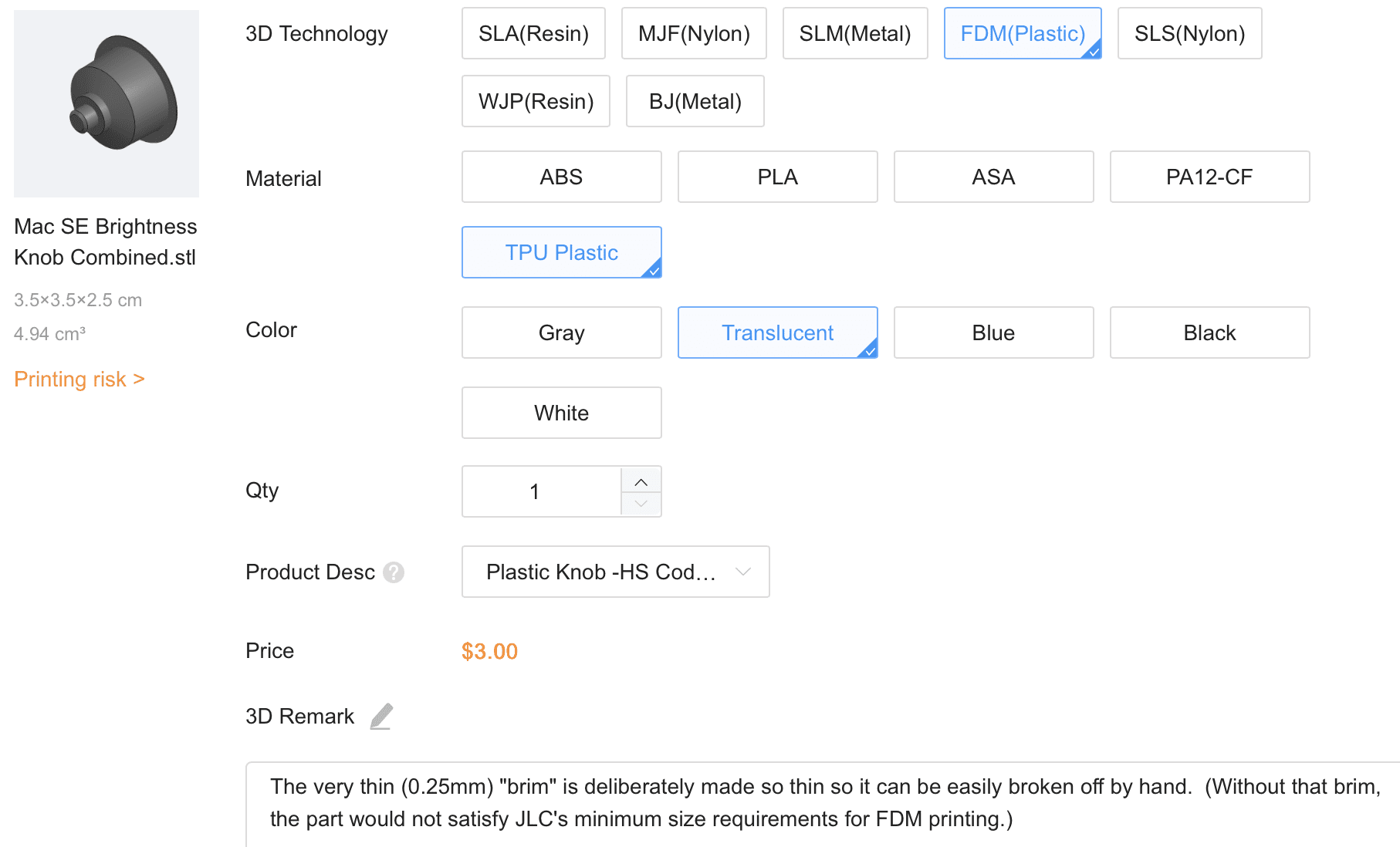

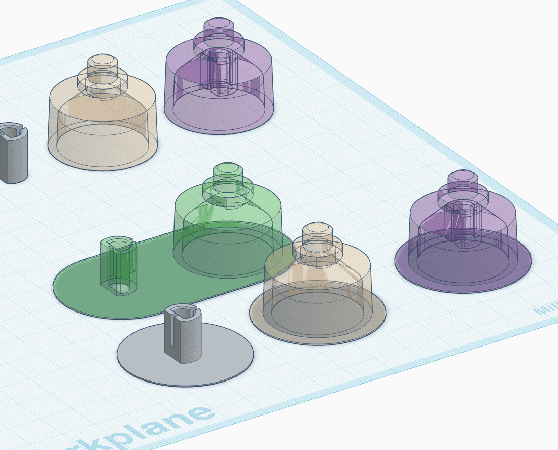

I wonder, what would happen if you had a built-in brim? I could easily add a thin “disc” to the part that you would just bend right off the edge once you receive it. That would make it bigger than 3x3 which might let you work past the warning.
For the split post, you could either try the combined version and let them figure out supports for it, or we could do another built in brim for it at 3.5x3.5 diameter. You cut that off and a little sanding on the tip helps guide it into the hole inside the knob anyway.
Just a thought. You could also put all of the parts on a thin raft to get the combined print bigger than the minimum pretty easily. Ironically, that’s returning to the idea of multiple parts in one file, but since there is material joining them, I don’t see how they can suggest it’s an issue. You just have a quarter mm plane at the base of your “object”!
Attached a zip with all the options

I used your link and uploaded the brim version of the post only. I could select FDM, PLA without any size limit warnings. It did suggest that I had “thin walls” which is obviously referring to the .25mm brim, but you can check a box to accept the risk of deformation. I even opened a chat with them. I dunno how much of my conversation was AI, but tried to explain that my part was small, that I included a support raft at only a quarter mm which is less than their “small column design” spec (2-4mm base). and was that OK? Their answer was that if I am willing to accept the risk(s) they generally try to print my item. Hey, it’s worth a shot!

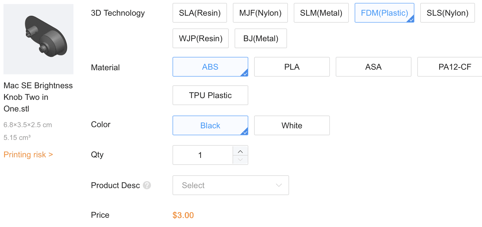

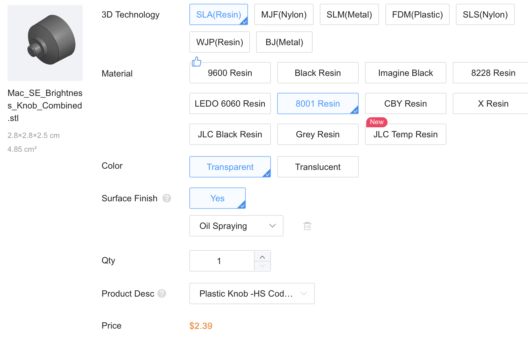

Give this a try using the two-in-one file in my zip:
928
667
Will JLC print the knob in resin? The only reason my model for the knob is two parts is to eliminate overhang issues for FDM, although a careful placement of supports might be fine. A resin knob would be ideal, but you’d want to use a combined knob-post version of the model. I just added that to my thingiverse item.
Given the option is there to use an external pot, I would ABSOLUTELY want to do that! Mounting may be tricky though. Once you have the pot in hand, you can probably fabricate something out of a strip of aluminum bent into position from a nearby chassis screw to get the knob into the front case hole. A 3D printed ”pot holder” would be nice for that!
I have a clear resin version on the way. I combined your two parts because they seem to be able to produce complex parts that normally would require tons of support on FDM printers. It should be here this weekend or early next week and I'll post the results.

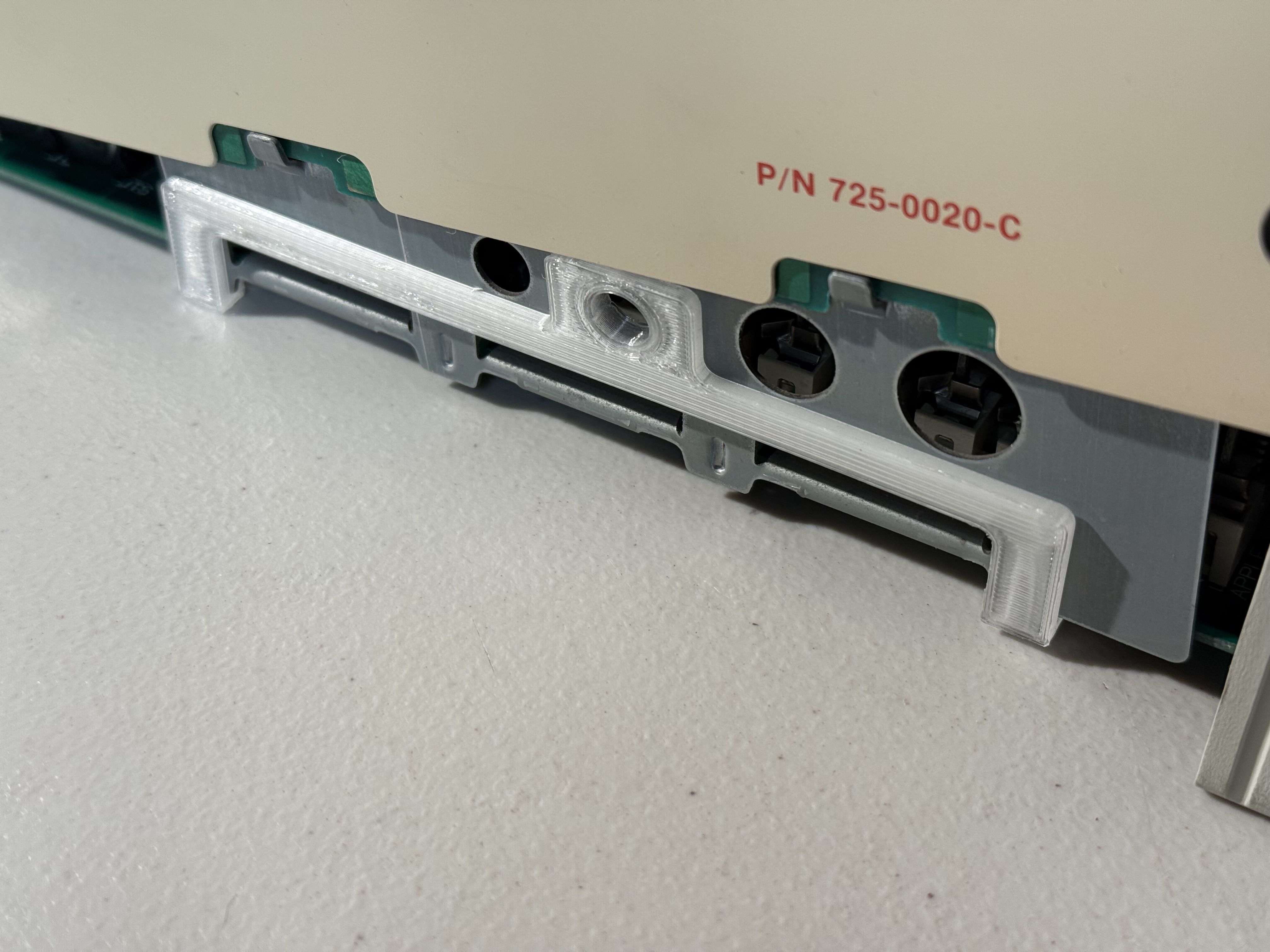

I just printed and attached my desk scratch proof feet. Wow were they hard to attach. The fit is good, but angling a circle through a sharp metal hole was probably hanging up on burrs from my brim. I think I will modify my version to be just a tapered tube since it fits so tightly. I won’t reprint since I got them:
The actual foot overhange converted to 45-degrees works fine.
Tolerance with the existing SE/30 back shell are tight though. I had to set the RF shield aside and even then it was very tight. I dunno if it was side-to-side or bottom. Maybe my chassis is not perfectly straight. I may have bent it out a bit during logic board repair for all the times I had to slide it in and out.

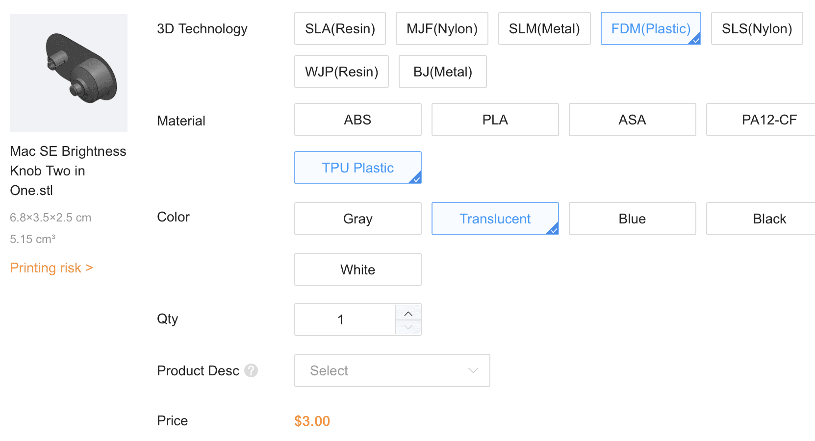

But this brings us back to the topic of the tiny center piece with a split in the middle, which grabs onto the shaft of the Potentiometer. Will any of the JLC Resin offerings work without cracking? The answer will depend on how much that little center piece (with split in middle) FLEXES when the POT shaft is inserted into it. I know Nylon wouldn't break, but Nylon may actually be too flexible to make a good of the POT shaft!
It's very kind of @caver01 to have made the "Two in One" STL to get around JLC's frustrating minimum size requirement... FANTASTIC, in fact! But below are my observations about that.
OBSERVATION #1
The only transparent choice you have for FDM printing is TPU Translucent, but TPU is very rubbery and flexible, as far as I know (I've never tried it), and therefore I don't see how it would be suitable for a brightness knob (or would it?)...
OBSERVATION #2
It would seem to me that ABS would be stronger and more durable over time than PLA of the other FDM plastic options, and if that "guess" on my part is true, then you only have BLACK or WHITE as color options...
So I would love to hear discussion about what I said above, and then I can decide what to print for myself at JLC3DP.
And in regards to the Desk Saver Feet (to allow you to sit an SE or SE/30 with plastic case back OFF on your desk without worry of scratches, in what way is the new overhange converted to 45° version superior to the original? I printed the original in Nylon and had no issues with it in terms of getting the plastic SE/30 case-back on, but I will admit that I leave the metal shield off...

For me, the concern about the feet was that FDM printng is often better and easier with parts designed for that process. Supports are not always an issue, but for me, printing in Taulman T-Glase filament I thought it best to avoid overhangs. The part that goes over the actual bottom edge—the feet themselves—had full overhangs in the original design. Overhangs and dealing with them on a sensitive FDM fliament like clear T-Glase was something I wanted to avoid. Since it was easy enough to remix the design and transform the offending areas into 45-degree slopes without changing the functionality, that’s what I did. I hope others appreciate that.
When you are printing yourself, you perhaps enjoy certain flexibilities, but you also get to make design choices. I don’t print in nylon (don’t have any) and who knows if JLC had to deal with additional cleanup before they sent the successful parts to you. For me though, it was not worth the hassle when I am adept with TinkerCAD. Shortest solution for me I suppose.

This is what I have in my JLC3DP Cart right now...
1) Resin Printing (no brim needed): Resin is more brittle and less forgiving when it comes to plastic flexing, but this print will provide a 100% transparent brightness knob.
2) FDM printing (brim needed to satisfy their min. size requirement): Nylon reinforced with Carbon Fiber (should prove to be very durable and yield a very firm part too):
3) FDM printing (brim needed to satisfy their min. size requirement): TPU can be printed in Translucent. It's rubbery and very flexible, but I really have no idea how well it holds its shape. Will it deform when pressed hard like a piece of rubber? I don't know, hence the need for this print to find out.
By printing in all 3 above, I think I can then find out which is best. Hopefully one of the two transparent prints will suffice because that would help MacEffects Clear Case owners who also want to print at JLC. However, with tariff stupidity harming our hobby, I wonder how many in the USA will even be able to buy from JLC or PCBWay now days. :-( (For me in Japan, and for every country other than the USA, it's a non-issue.)

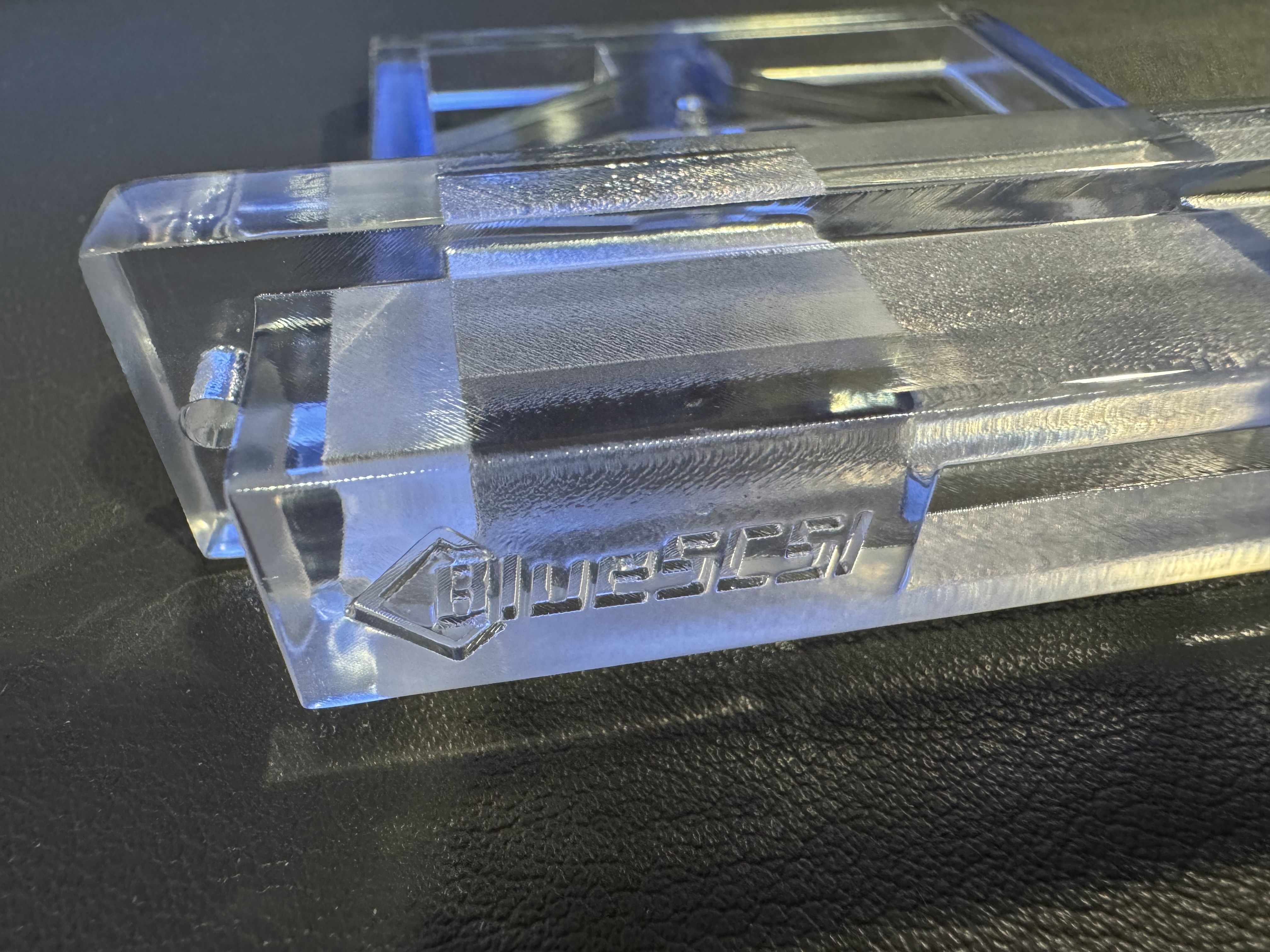

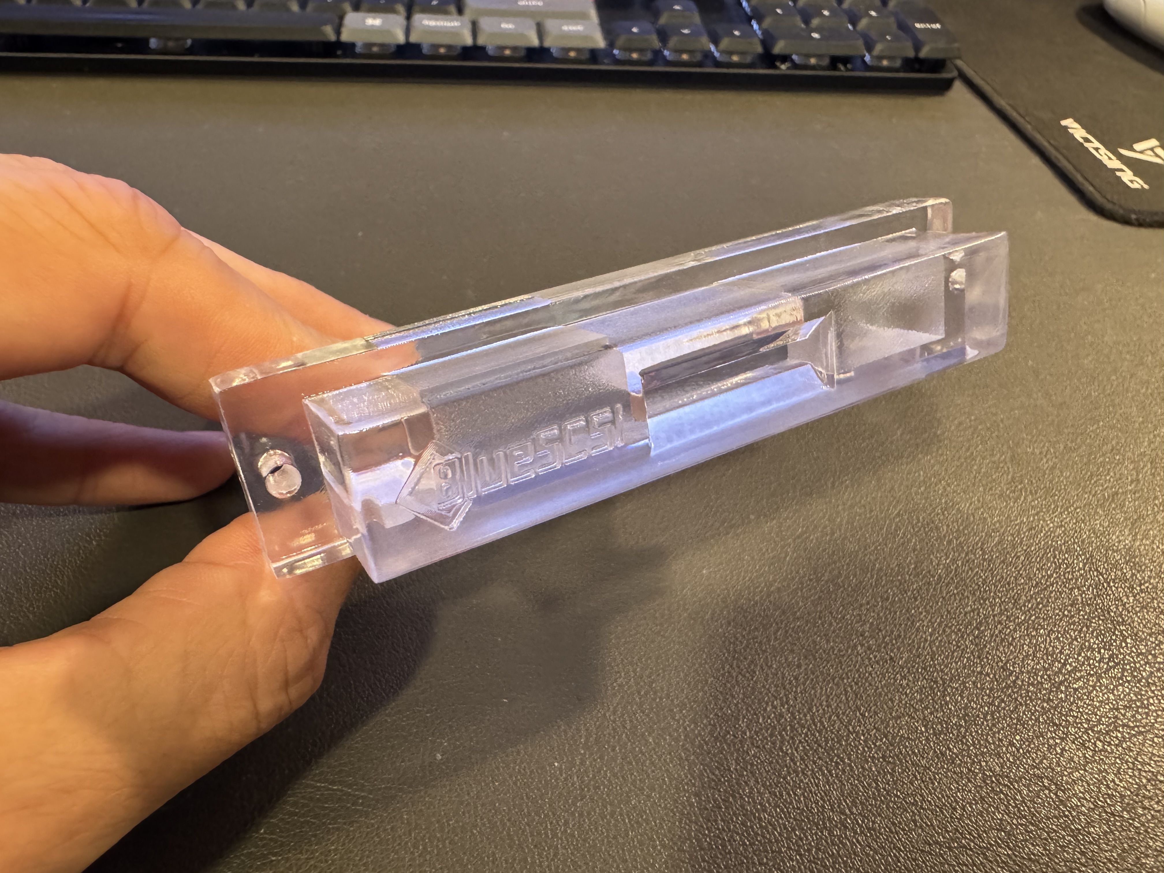

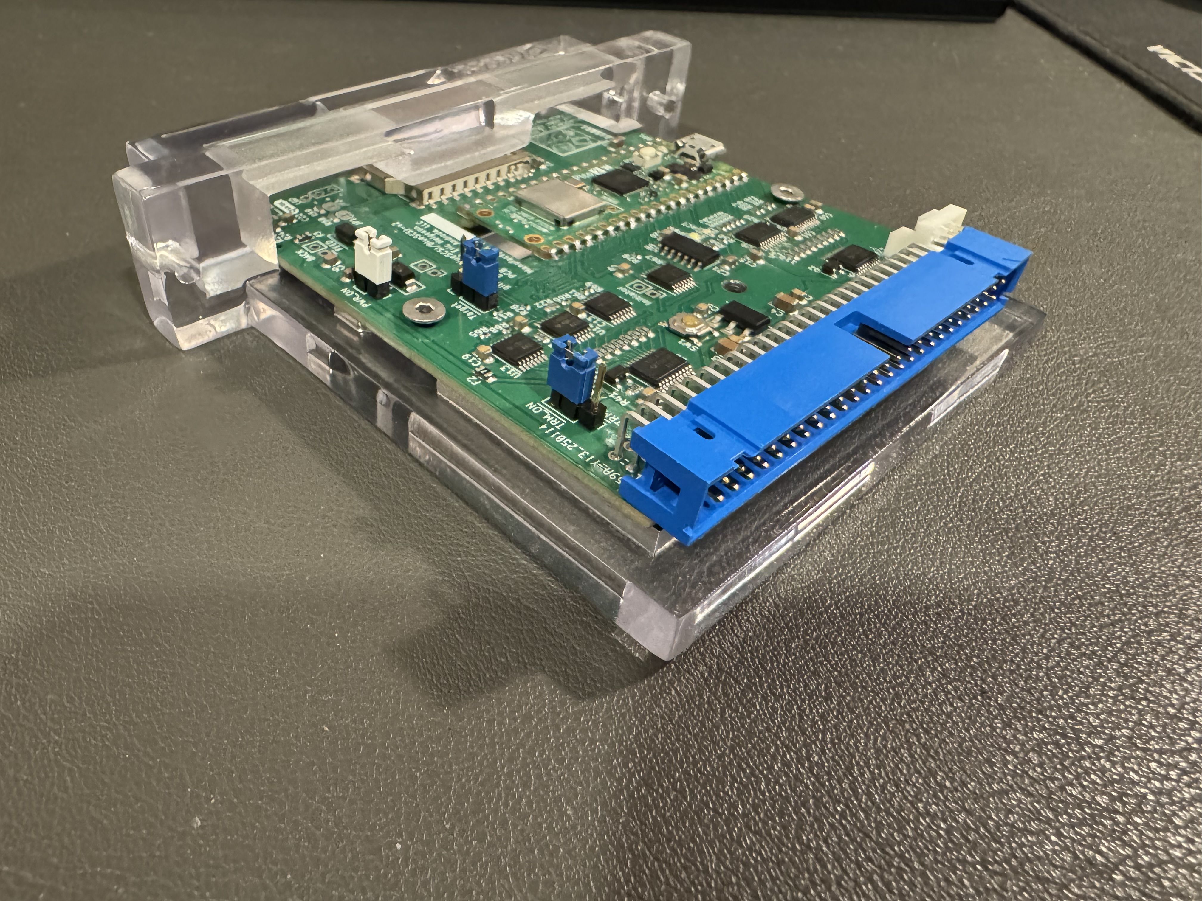

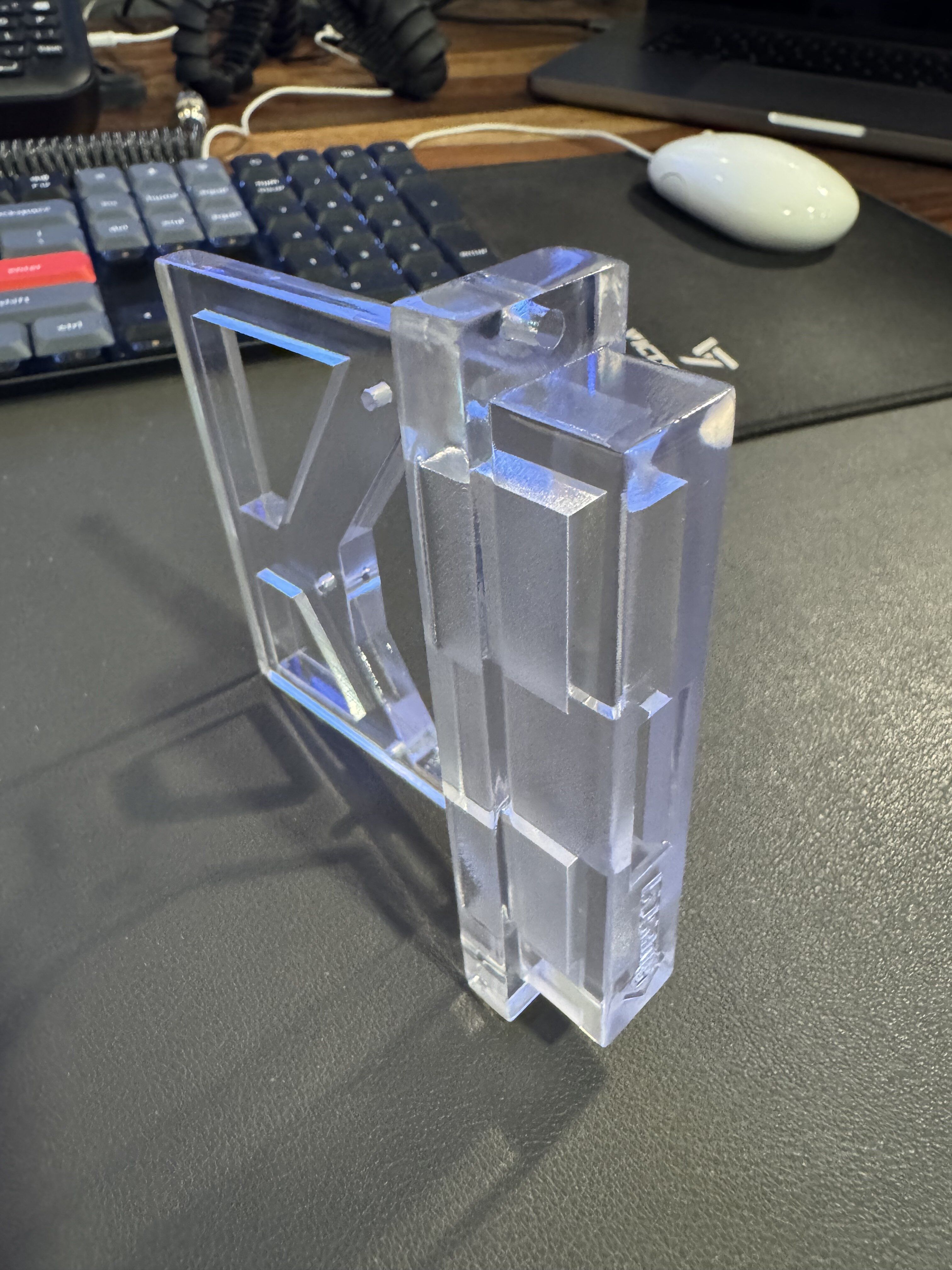

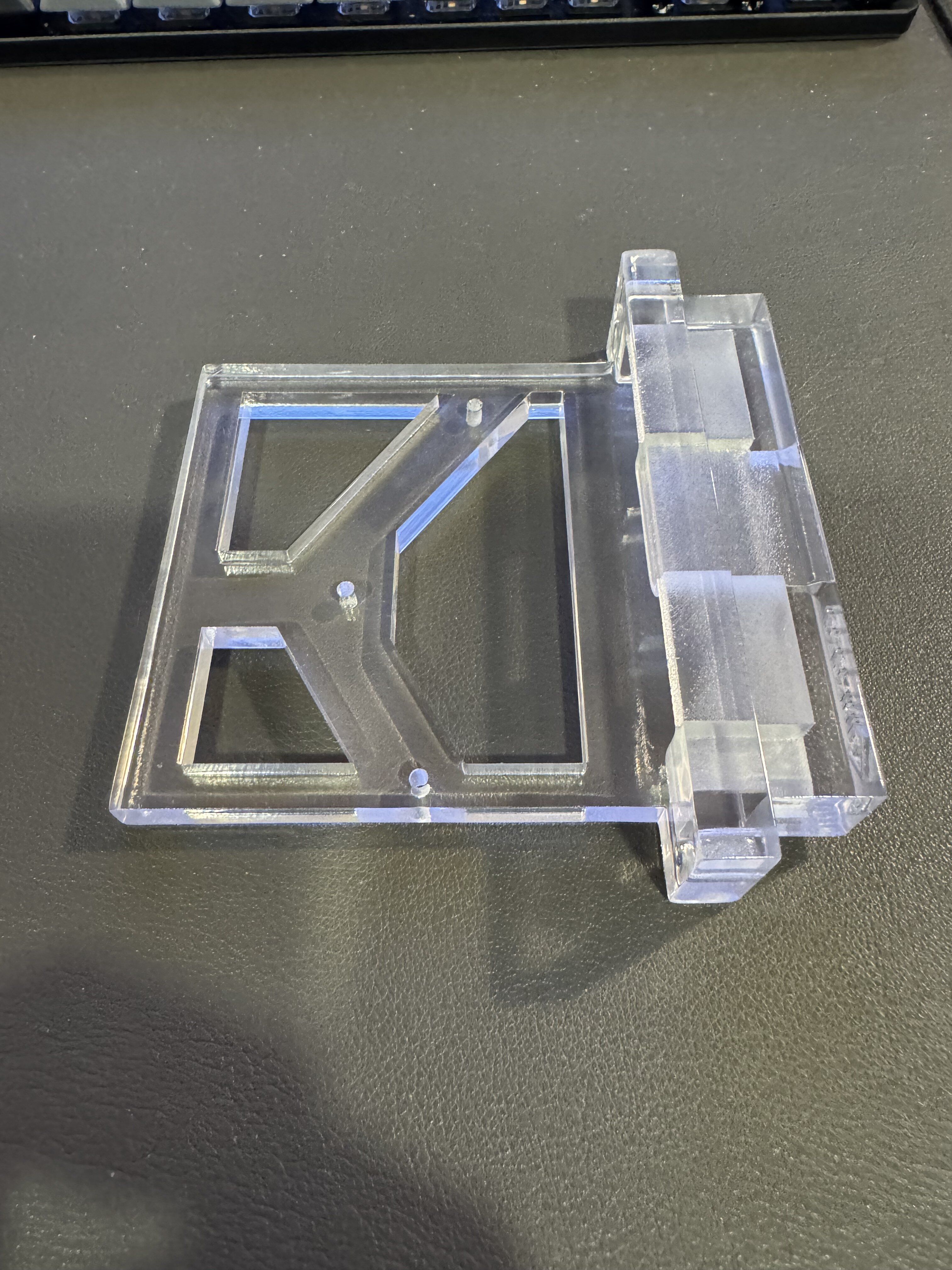

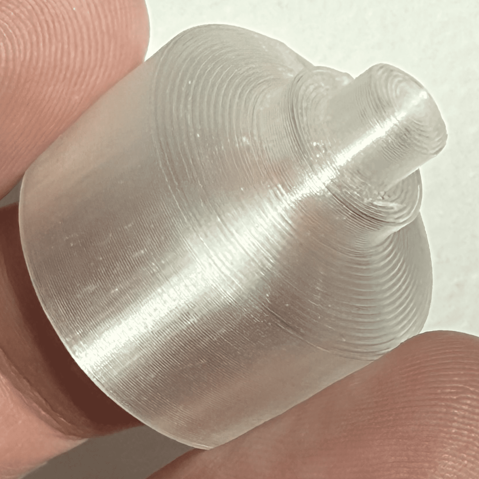

If you want to wait a couple of days to place that order, I can give a report on the resin knob. Mine might be arriving today. For some reason, my knob order got held up a bit longer in shipping.
However, look what did arrive today!

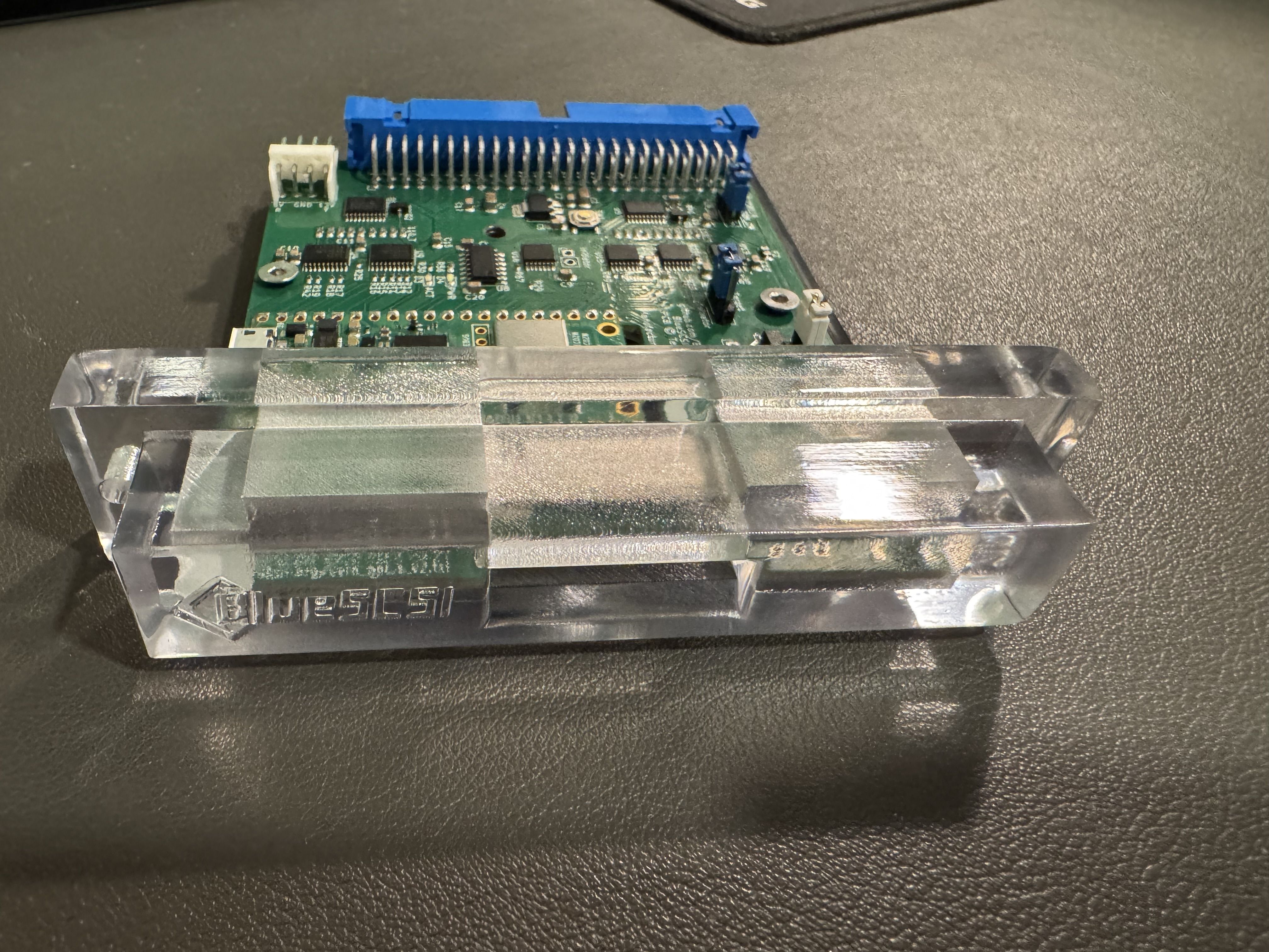

This is definitely my biggest / thickest print in transparent resin, but I think it turned out pretty good. I think the oil coating that makes it fully transparent didn't get applied well within the recessed area where the blueSCSI will go, so there's a frosted effect, but I think that will still look OK when fully installed. Looking forward to swapping it out, but will probably wait until the knob comes in to minimize the number of times I'm re-assembling the case to avoid scratches.
And here with another BlueSCSI v2 installed:
