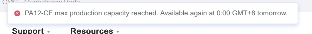

Well, my order is on indefinite hold due to this craziness...
That's 1:00am Japan time. And no, staying up that late didn't work. It's making me wait another day. I emailed them. They said that even if I am able to pay, it will take 5 days to process my order rather than the standard 3.
I believe I'll be checking PCBWay's 3D Printing service now.

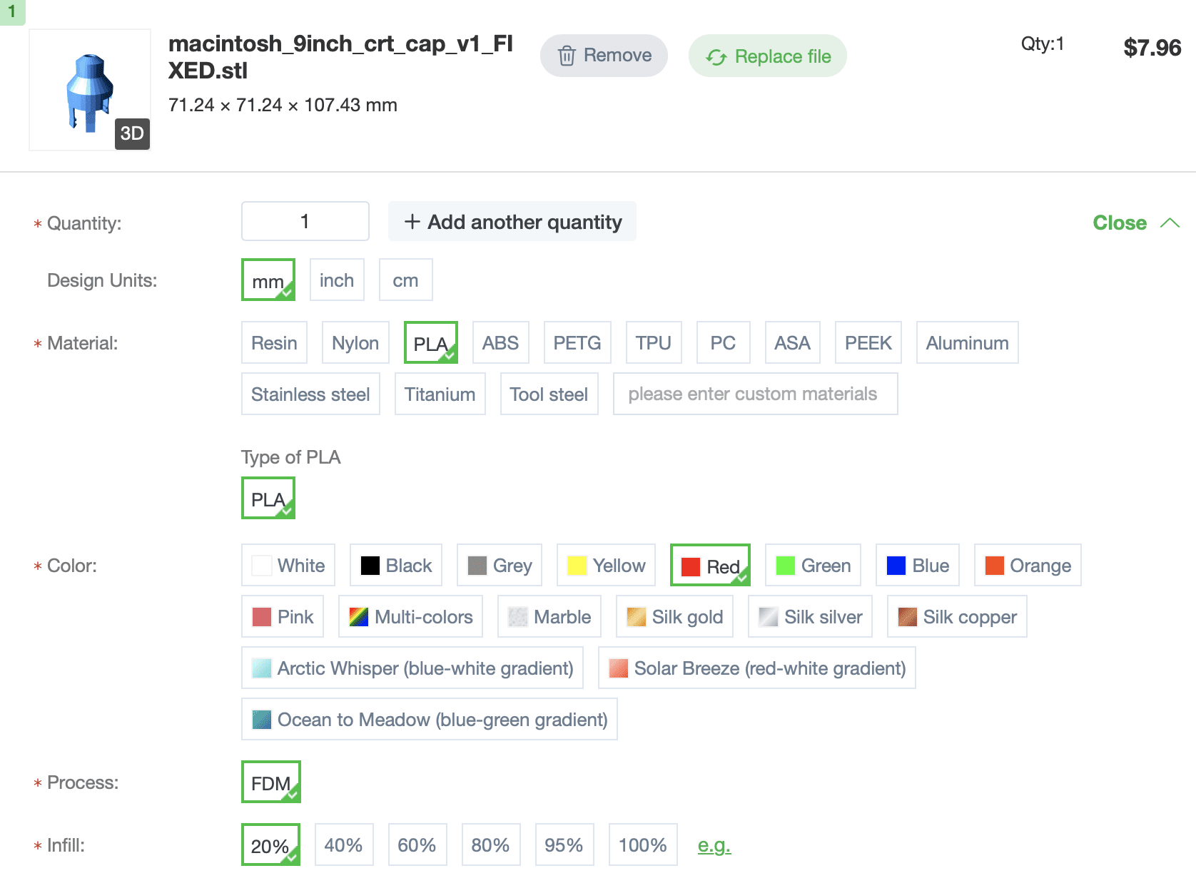

Uploaded one STL at PCBWay and I'm already seeing things I don't like...
JLC3DP priced the same part under $6 for FDM, making PCBWay just over $2 more expensive for that one part alone. I guess that's for all the YouTube video Advertising they *ahem* we the customer pay for. 🤨
On the upside, PCBWay offers PETG, which JLC does not. And Nick Gillard (creator of that CRT Yoke Protector STL I am showing above), told me that PLA+ is what he prefers to print it in, but PETG should be a fallback rather than standard PLA. So there's merit to having PETG.
However...

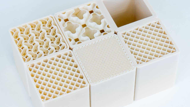

Asking me to choose an "Infill" is bad news. I'm not a 3D modeling or 3D printing guy. I am somebody who can download a model in hopes of getting it cheaply printed. Yep. It's really that simple. Sure, I've read about what Infill is, but how in THE world do I know what Infill to choose when it's not specified by the STL designer? Guess? JLC never asks that and I always get great parts because they make good decisions about what infill to choose. 😔

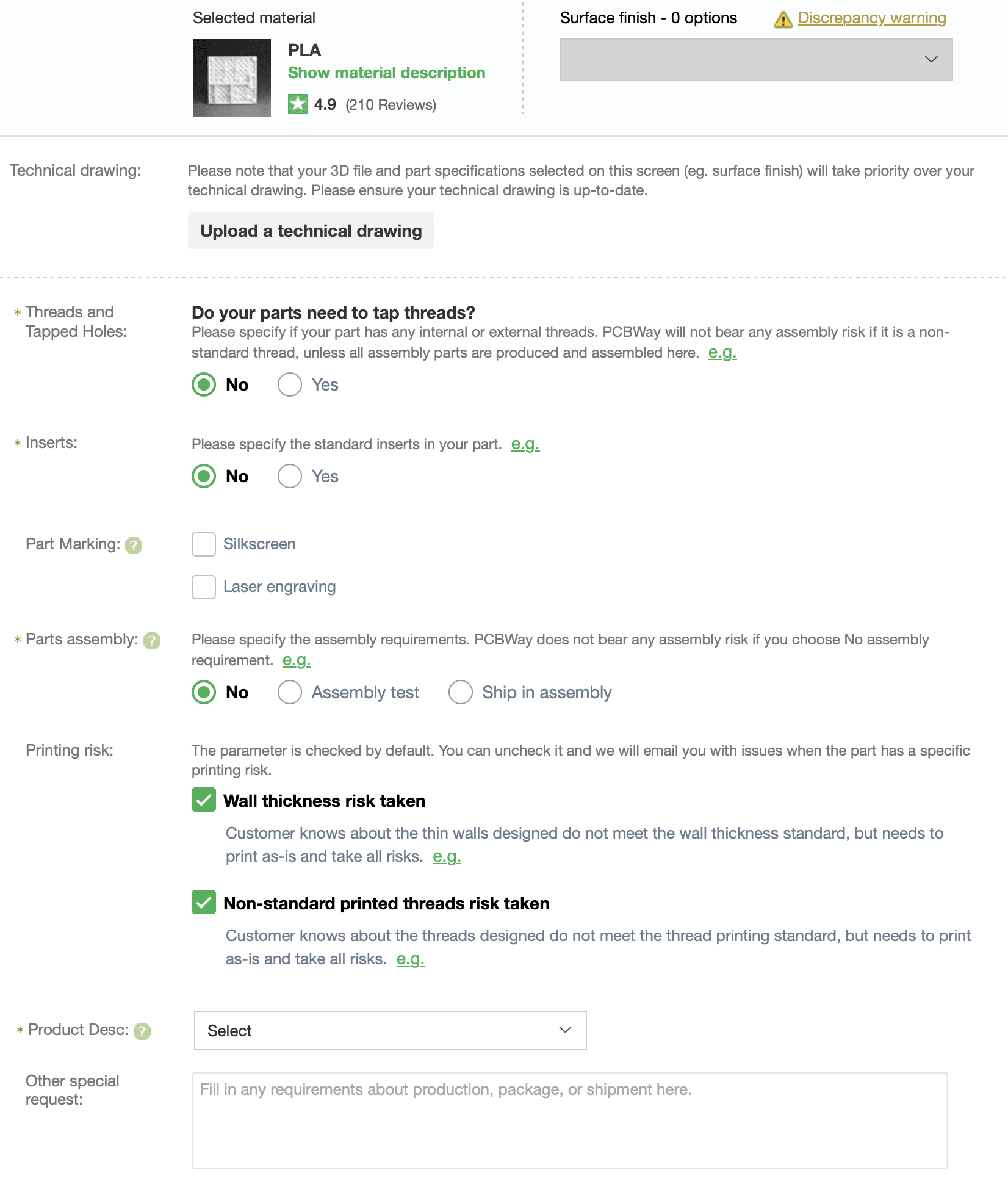

We then have more settings at PCBWay before even one STL file can be added to the Cart...
So let's see...
Not sure what the "Technical Drawing" is for because JLC doesn't ask for one, but it does seem optional, so I will just ignore it.
"Tap threads"? Have no idea what that is. JLC doesn't ask it, and my orders with them are always just fine.
"Inserts"? Again... No idea.

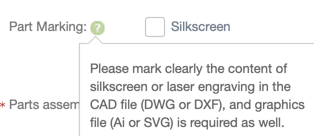

At least "Part Marking" has a little "?" icon that I can click on to get an explanation — something I don't need and can ignore, I see.

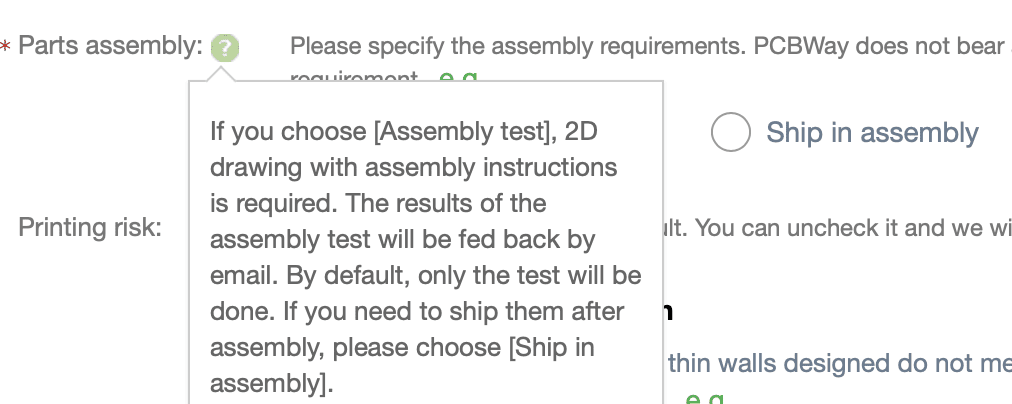

We then have "Parts assembly" which has an explanation that I still don't fully understand...
I guess that is for designs that have multiple pieces to them and you want PCBWay to put all the pieces together? (Again, JLC doesn't ask that.)

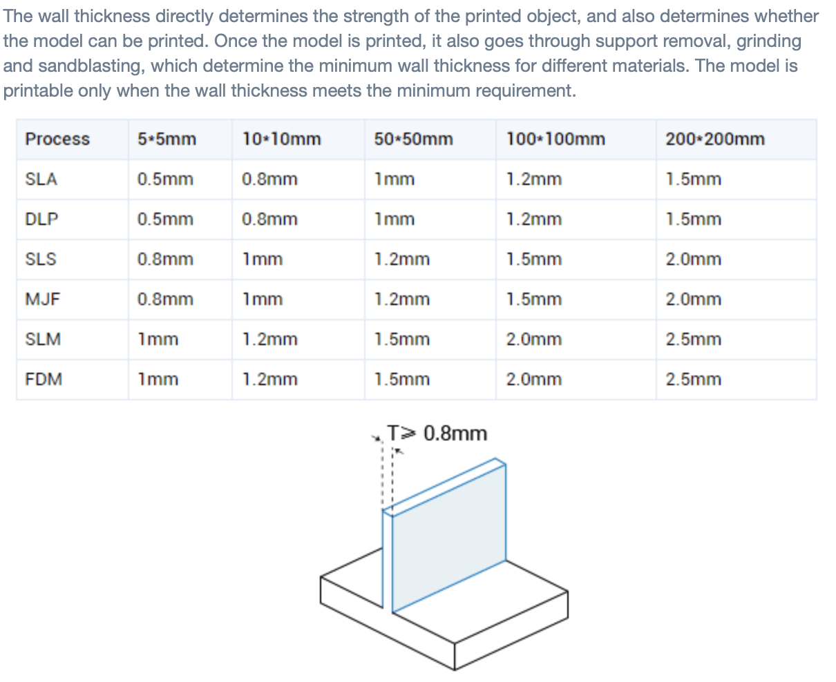

Their Wall thickness requirements...
Glad to see you can take all risks and get prints made anyway because almost every single STL I've found out there seems to have at least one teensy tiny section that is thinner than 0.8mm.

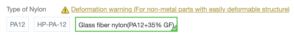

Then if I switch filaments, I see they do not offer PA12-CF (Carbon Fiber reinforced) like JLC does:

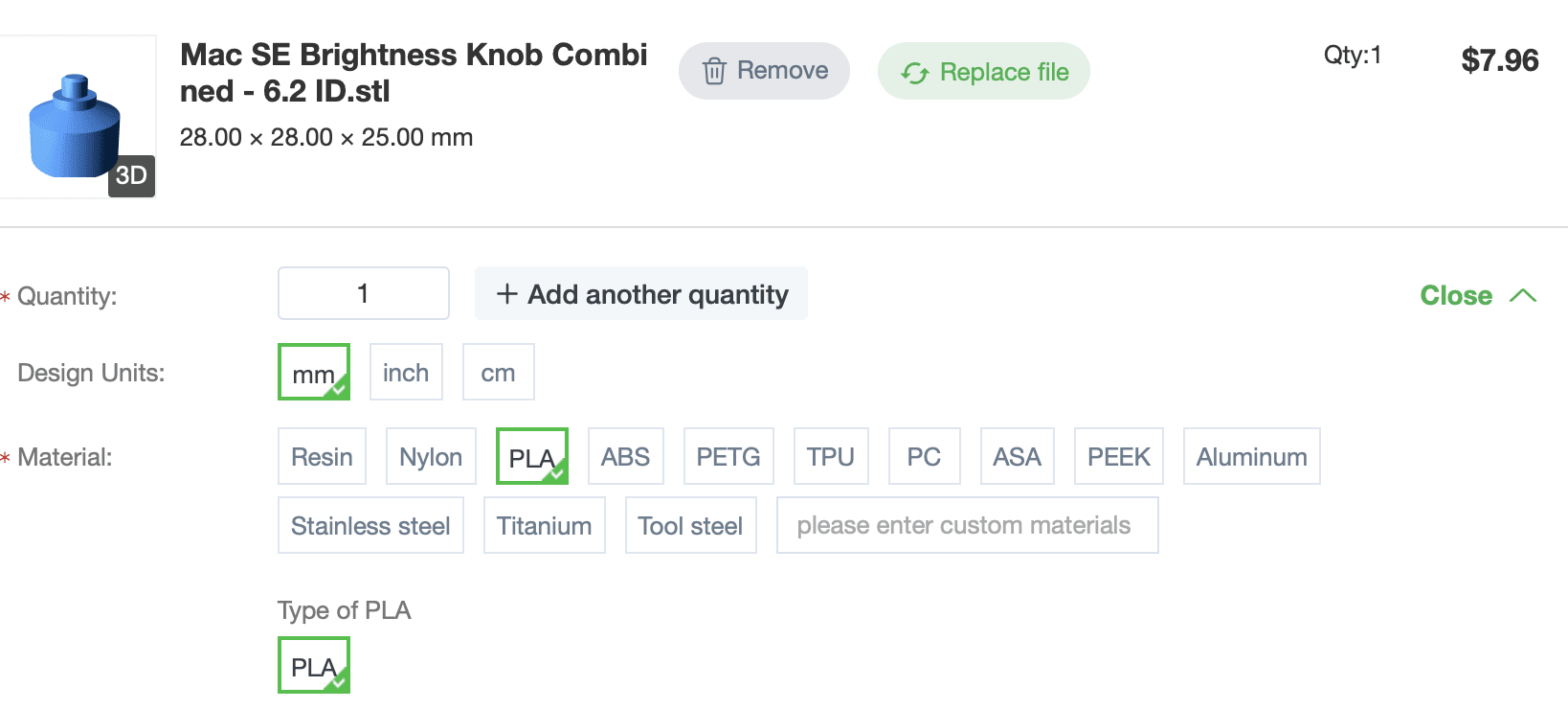

And lastly, checking the BRIGHTNESS KNOB STL without Brim, I am pleased to see that PCBWay does't have the same nutty "min. size" restrictions that JLC has, but man, that price for otherwise cheap PLA is crazy...
The Brim version of that Knob printed in PA12-CF (Carbon Fiber reinforced) on JLC costs $3.00, making PCBWay more than double the price for just PLA! The price differential is so huge you have to second guess yourself and ask, "Did I do something wrong here?" Wow.

Interesting. I appreciate the simplified perspective you have enjoyed using JLC, but honestly, these options are much better to be able to control, even if they require you to invest in understanding them. Something like infill for example . . . JLC is making that decision for you, as well as wall thickness (which is for solid areas, not areas of models that happen to have thin spots). This is important because the part’s performance in a given circumstance will depend on that circumstance in combination with wall thickness and infill. I am surprised they don’t let you specify the type of infill (grid, honeycomb, gyroid).
Now, you can live in ignorance of some of these details and there’s nothing wrong with that at all. But when a part fails it might be due to an arbitrary decision made on your behalf that might have been better if you had direct control over it. YES, it assumes you know what choice to make, and for that, a part designer should be specifying the details. When something like infill or wall thickness really matters for a given part, the modeler/uploader often DOES specify those details—at least I do. When they don’t, it’s usually because it does not affect performance, and it’s up to you (or the printer) how much filament they want to waste on infill and perimeters, or how much time they want to spend printing the part. Defaults are usually fine for these choices. I see they have 20% infill as a lowest default. I often just print 15%.
Tap threads probably means they will spin a thread tapper into holes you specify in your technical drawing—if you choose to. Inserts are brass threads that they can heat up and push into holes—again, probably based on your technical drawing.
It seems PCBWay has a LOT more capabilities which is good to know if you ever come across a part you need printed that requires some specific details like this. For everything else, I suppose not knowing is not really hurting. What’s that saying? Ignorance is bliss? It can be!
Thanks for sharing some of these details. As someone who prints stuff, I would not otherwise have known the options that exist. It is good info for all of us.

is it safe to assume that 100% infill makes it a solid part?
If what you mean by solid is that there are no air gaps in the interior space then yes. However, somewhat counterintuitively, a rigid part is not necessarily a solid one. Sometimes 100% infill results in a part that bends easily whereas a part with Just two or three perimeter or wall thicknesses and minimal infill to hold everything in place is far more structurally sound.

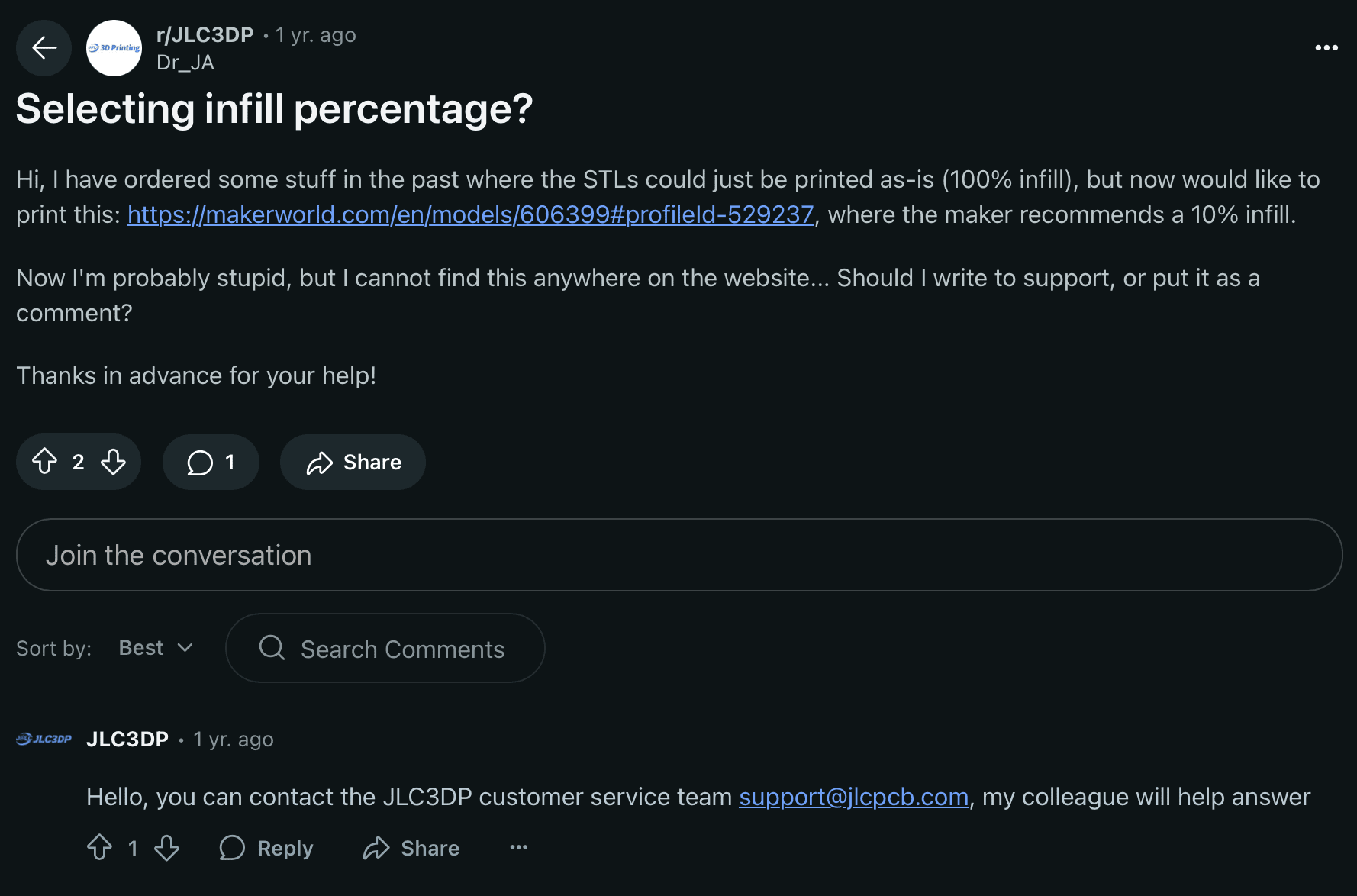

JLC has an entire article on infill density and type here:
Very odd that same page makes no mention of how you specifically request the kind of infill you want, but I Googled up the following Reddit which suggest you must email them to get it:
