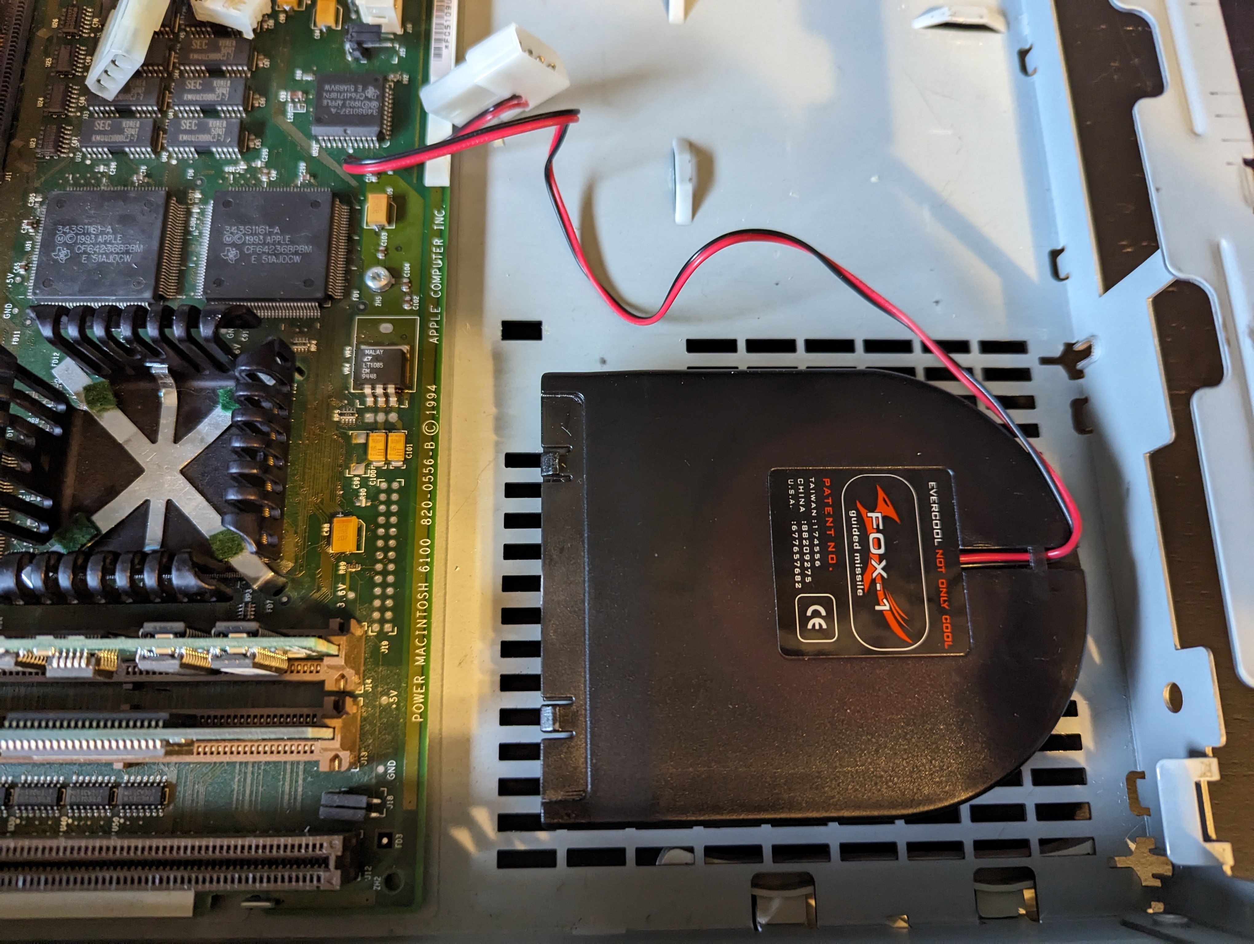

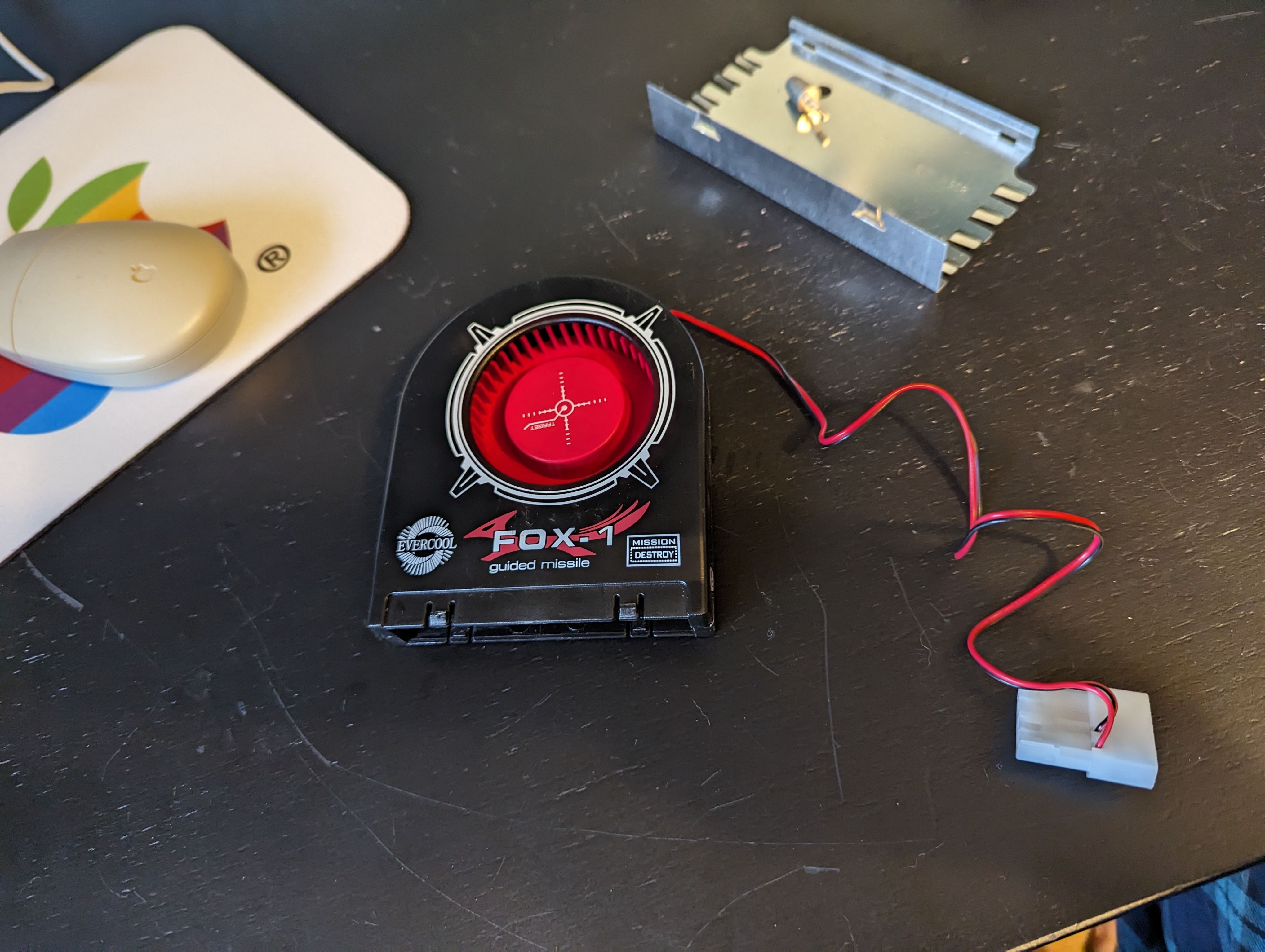

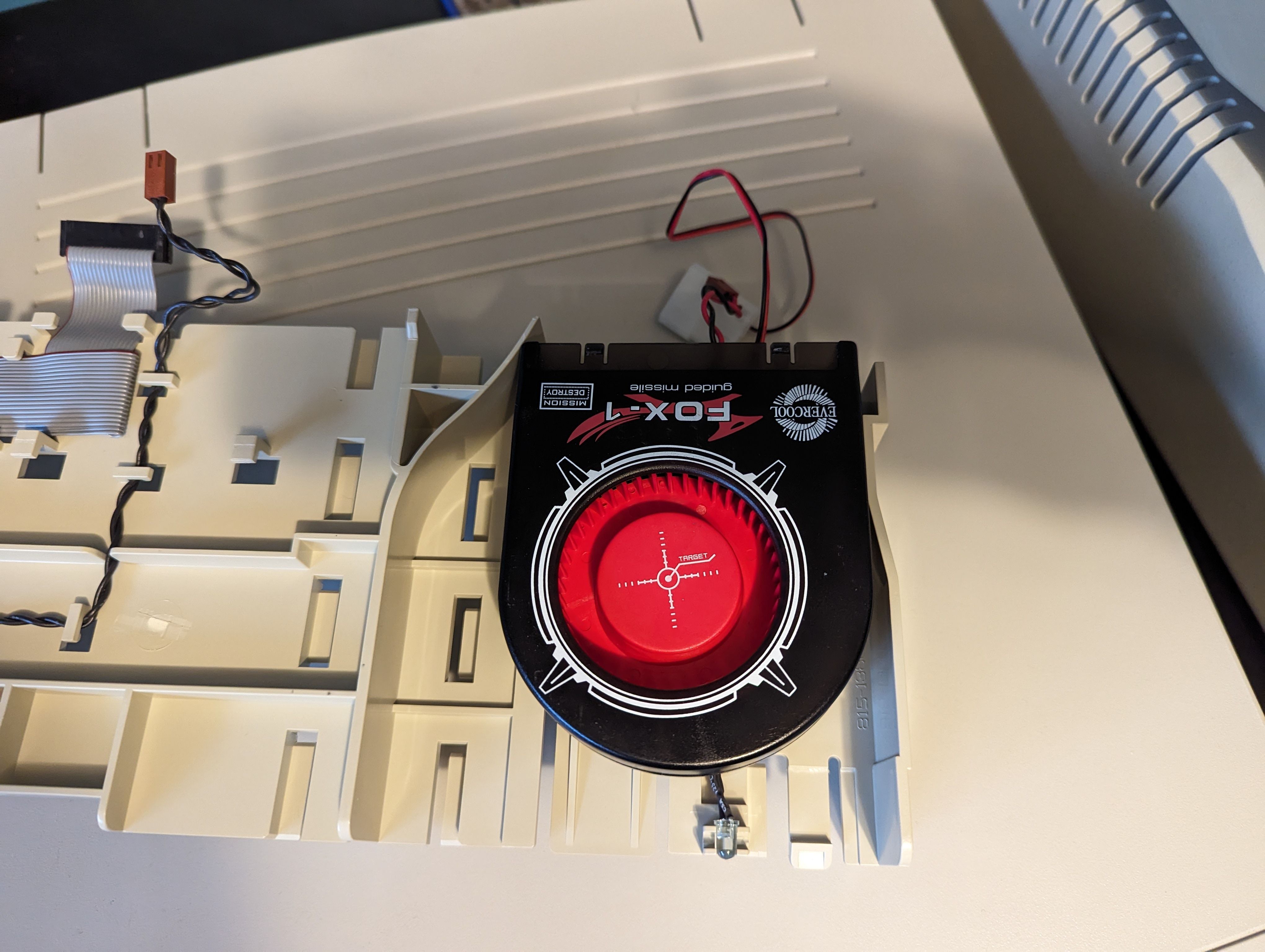

Upgraded my 6100 with a GUIDED MISSILE :ROFLMAO:. Grabbed this (hilariously marketed) slot blower fan for $2 at VCFMW to see if it fit under the 6100's HD bay. After removing the slot bracket, it's snug, but it fits perfectly:
PXL_20231031_131616343.jpg PXL_20231031_135129340.jpg PXL_20231031_135438089.jpg PXL_20231031_150625427.jpg PXL_20231031_150636836.jpg
It's quiet and blowing a steady stream of cool air from outside the case directly at both the PPC and 486 heatsinks.

Might have to pick up this type of cooler for mine. The heat was pretty crazy when I ran mine briefly to set up Windows on it. Thanks for the inspiration!
