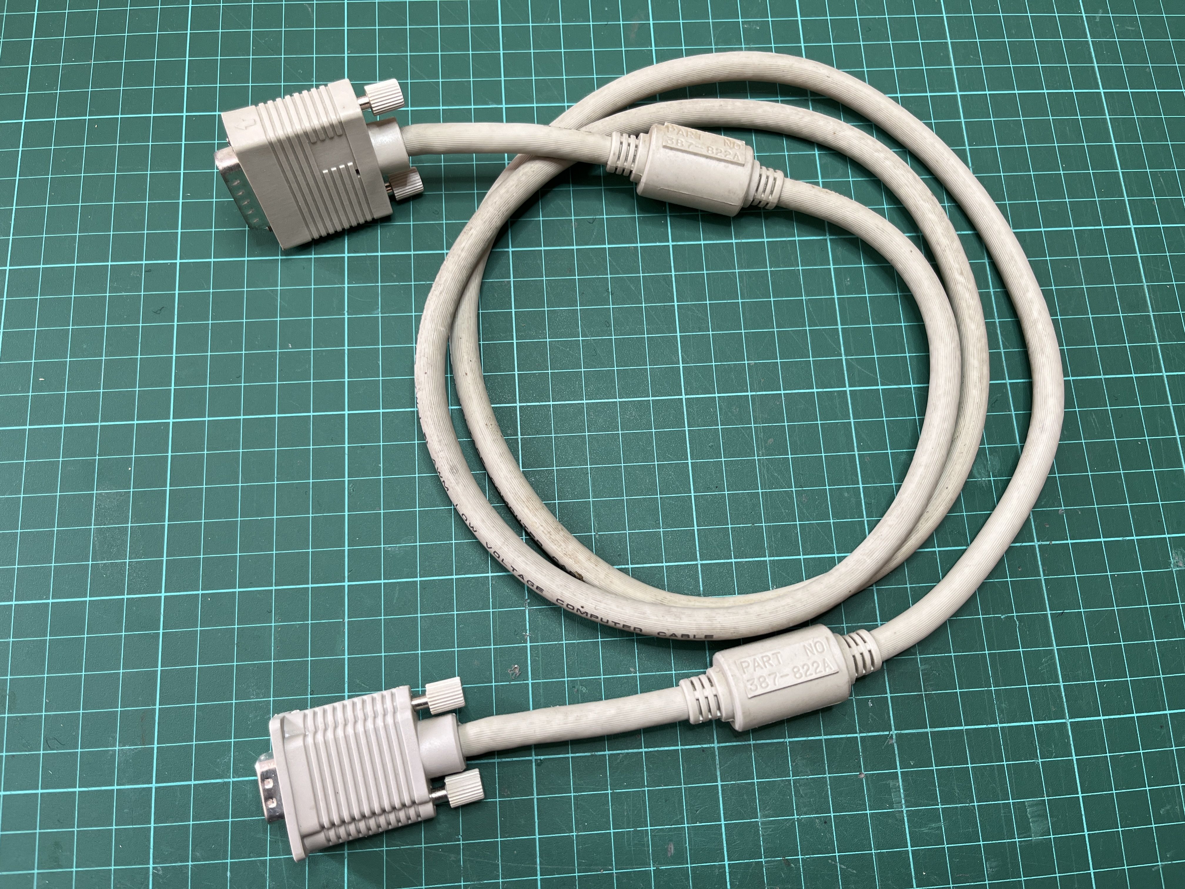

This is the cable that I have:

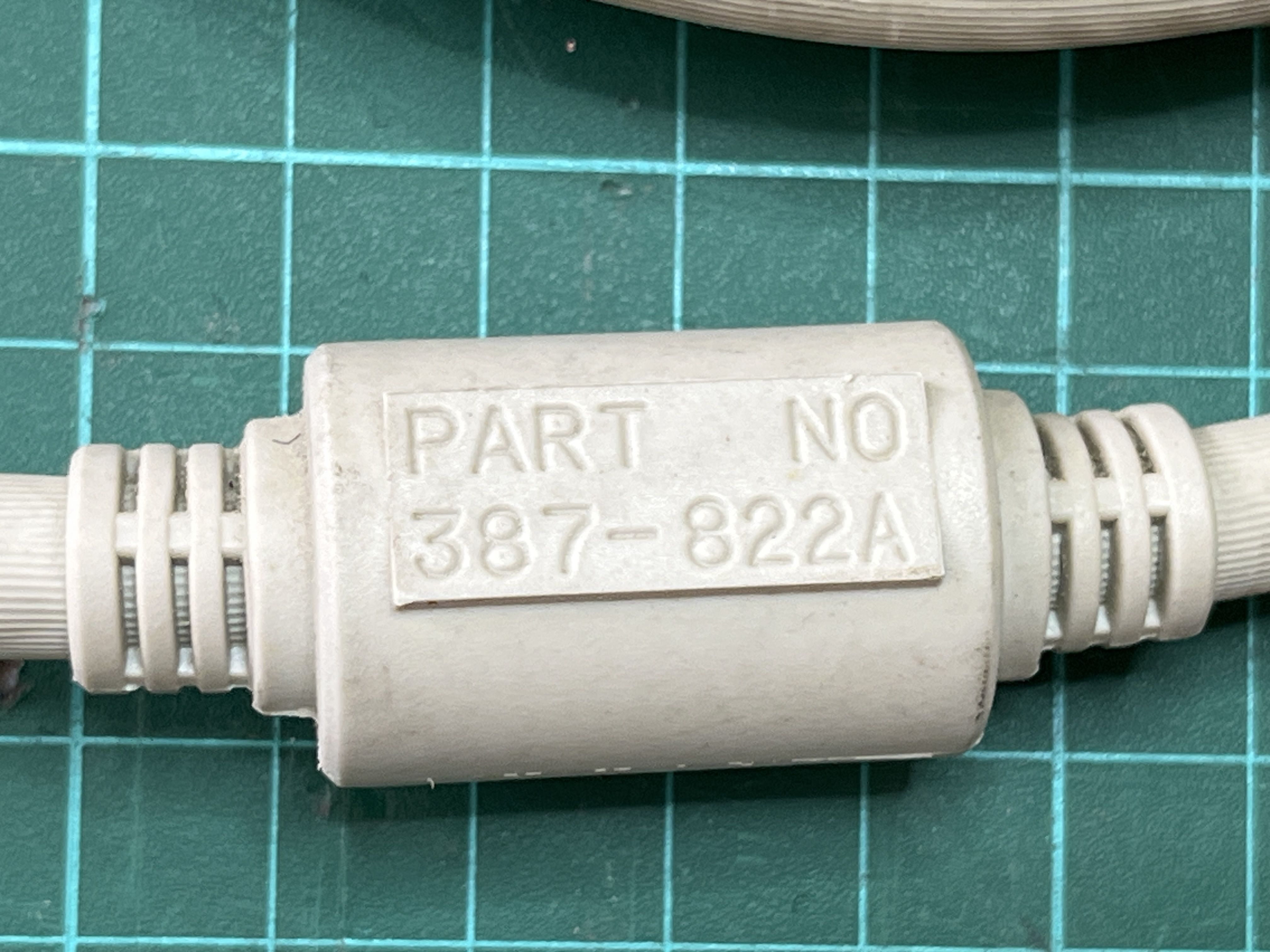

I don’t see any brand name or logo on it, but there’s a part number (387-822A):

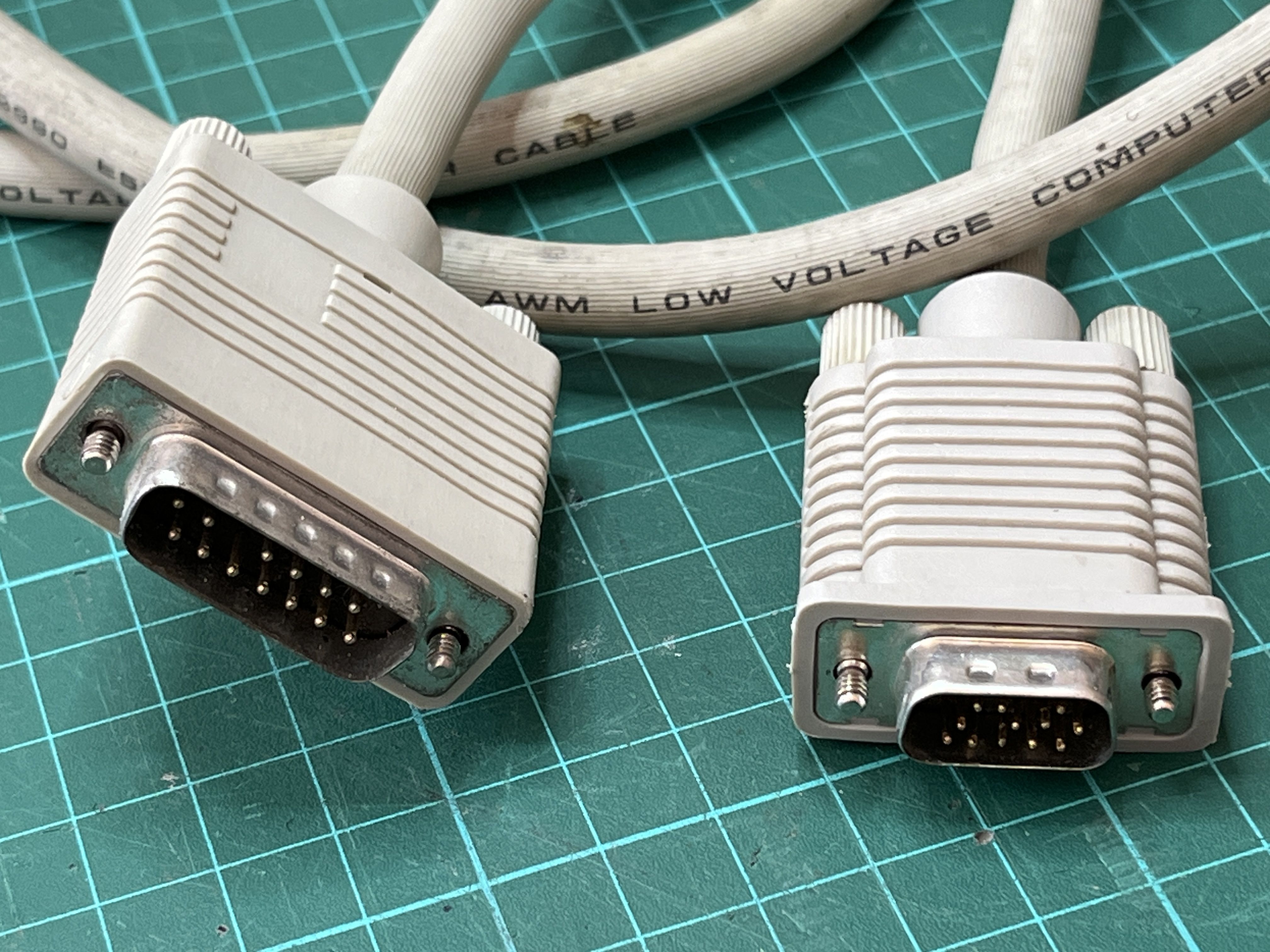

A closer look at the plugs:
Thank you! and thank you for offering the additional info. Unfortunately, I have no DB15 cables on hand to splice together. I did, however, find this nugget on ebay. I'm going to buy it regarless, but wanted to get your input -- do you think this is the same type of cable as yours? It says Radius, which worries me a little that it is a proprietary cable for a specific radius card, but unsure :
