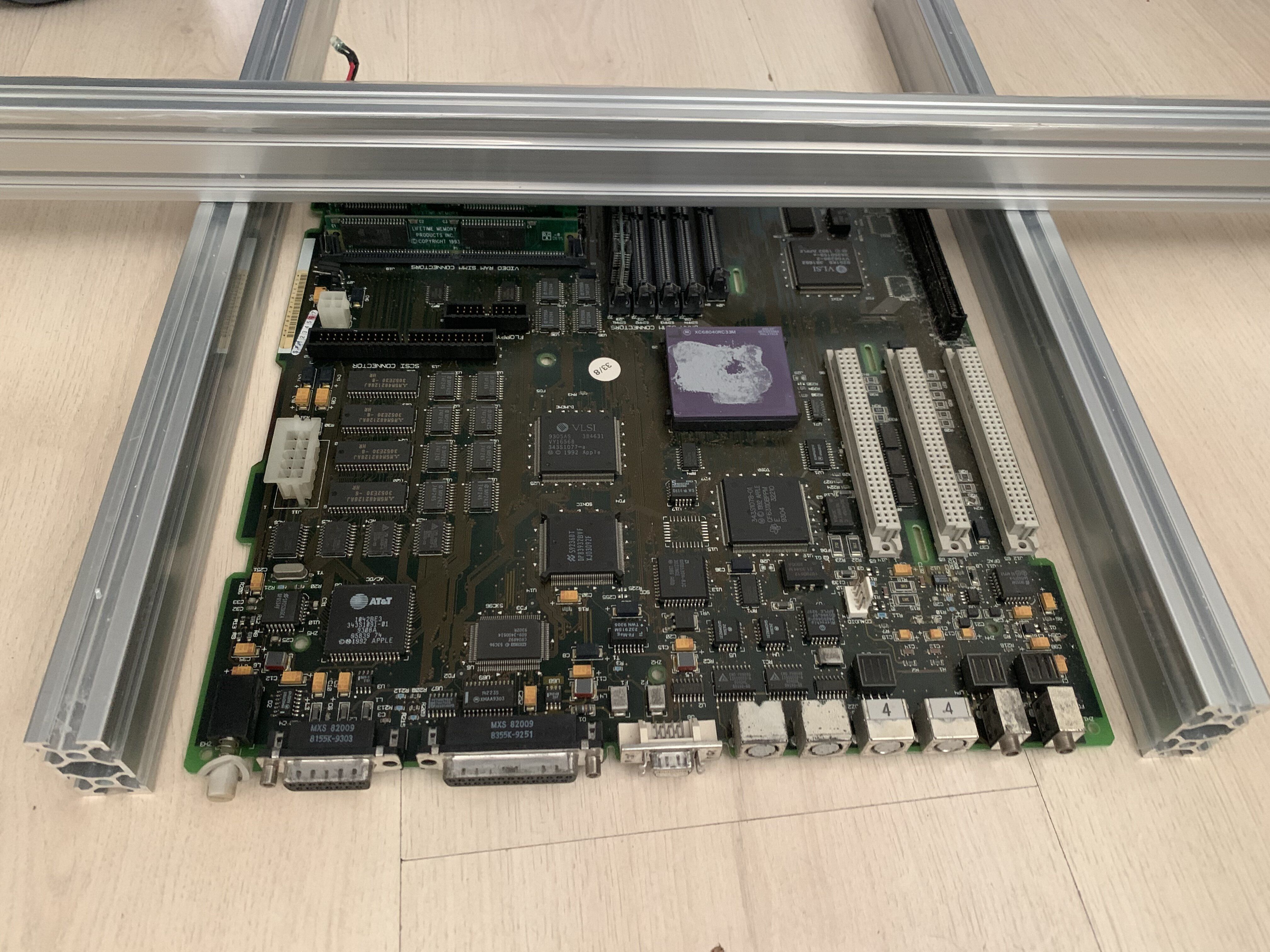

While we have rain this sunday morning, I figured to have a go with the Quadra enclosure.
Dont shoot me, as this is a personal-practical approach to this design. I can create this without too much of a hassle.
A piece off Apple, a piece of me😇so to say.
But no plastic tabs to break……
For the basics its an 20x80 or 20x100mm extrusion with faceplates, and the stainless bottom chassis and cover that go over it. These are held in place with four screws.
They also hold the handle and standing support.
A horizontal version is also possible,
what I have a look at next.
-edit- had a look-🛠-something like this?-
Edit-can even be stacked as a kind off system….
like @retr01 suggested…👍
Thats the idea for now.
Remarks & suggestions welcome!

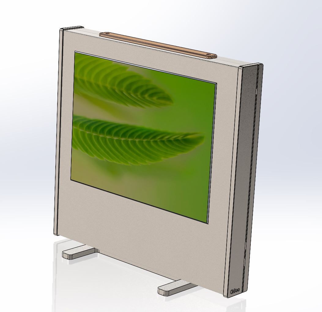

Update:
Further Explorings ….skipping CD and Floppy brings this enclosure to a minimal 40mm thickness….
Adding a suitable display could make it into a kind of modern Macintosh ….
What you guys think?

Well, actually this concept applies to any suitable enclosure.
Just add an handle and display of choice…..
As example,
my CAD-workstion converted in 2013 for mobile use.
@wottle creations ive not seen yet.
Link?
Indeed, any logicboard can be used here too.
I like the idea that its now become modular and stackable system. (like @retr01 suggested in the first place)
Ticker and thinner and contour can vary a bit to fit the largest board.
The version with a display is actually kind of logic.
So, should I actually make one?
(Edit: @wottle -as for a carrying handle,…
Its optional, yet to be determined….can be added to the top /bottom/ backside in various ways.)
