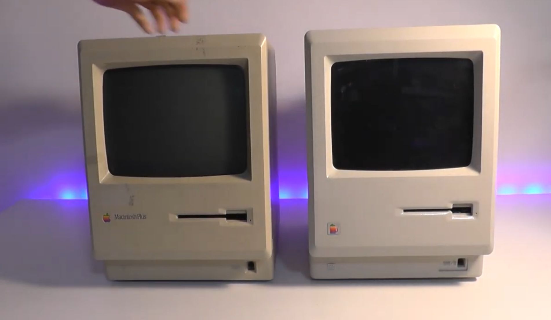

@Kai Robinson , dont know if it would fit a Plus chassis. But I suspect not intirely as its printed with a fairly thick wall.
It does fit with the parts he chose very well.
The eye for detail and his quality finish is superb ❤️
1,538
497
I just watched that Macintosh Plus video in one sitting. Amazing, truly amazing. First thought is to mod the front bezel model to Twiggy/DVD spec. The rear of the case would be modified with an opening for removable panel for customization in lieu of printing one in the bucket. Fitting a custom I/O plate or ATX cover plate and mobo to the chassis would be ideal. A setback Riser would allow for expansion card as well.
1,538
497
Got no money for that, on a retirement budget, though still working full time. 3D CAD and PCB Design Tools are at the top of the list when i have more time. Is that model available under license? Chopping parts out by hand would be one thing, but doing it with modifications to the print reworked model would be the best approach.
Edit: forgot to ask, how goes this project. Love your wiring diagram for the 630 PSU. I need to find same for the 6x00 harness. ISTR the 6360 PSI/harness connection being a bodge job? Has anyone seen an ATX version for the PCI drawer/harness.
