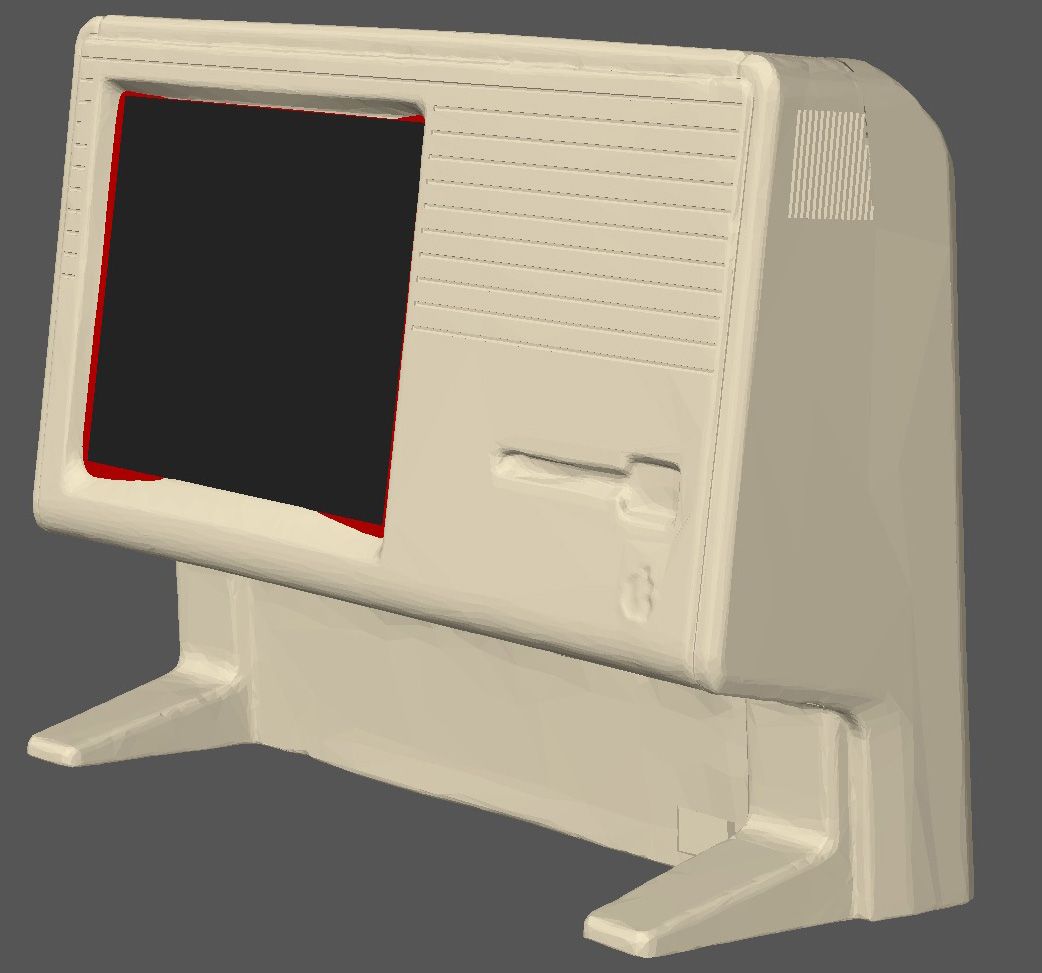

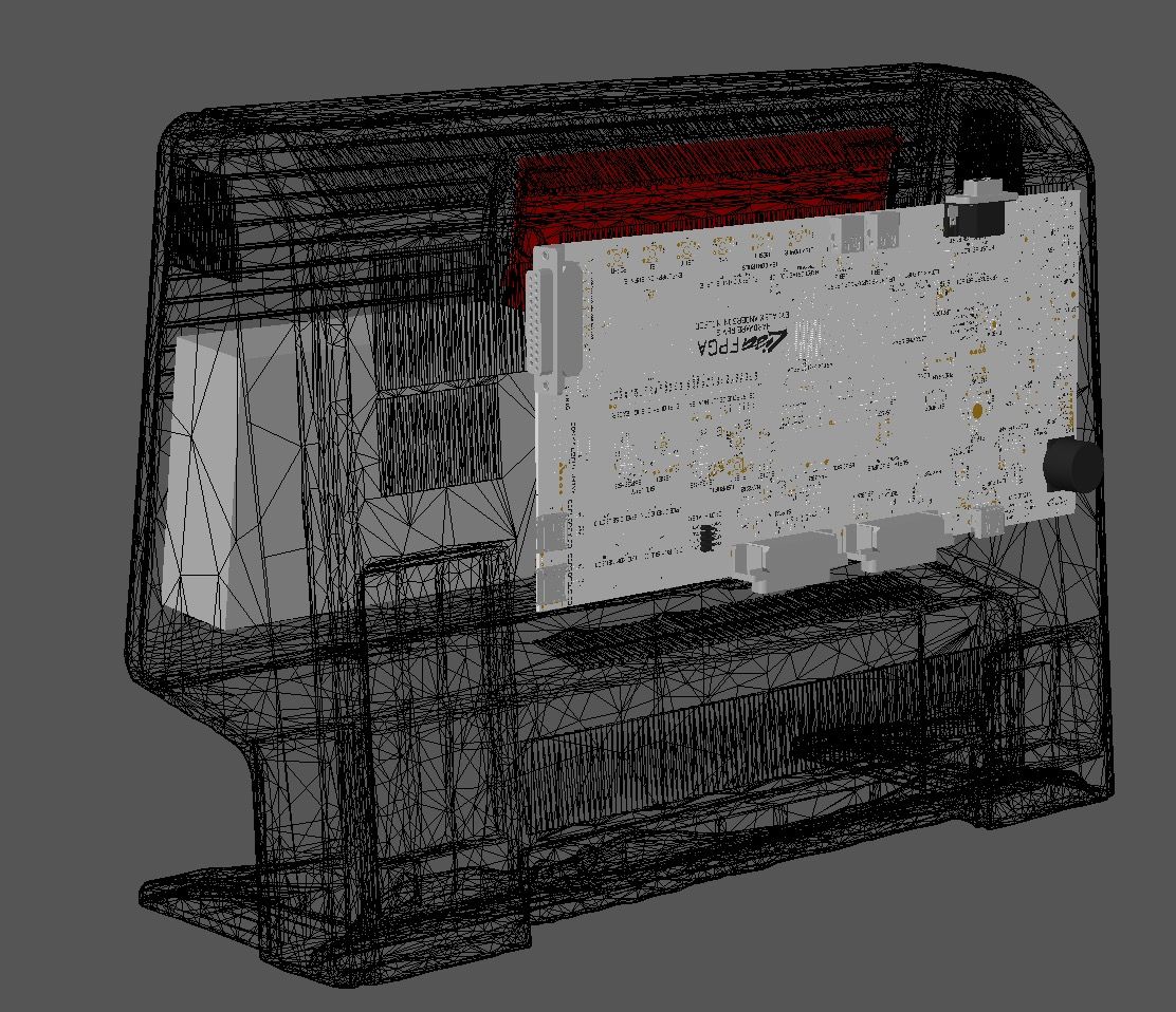

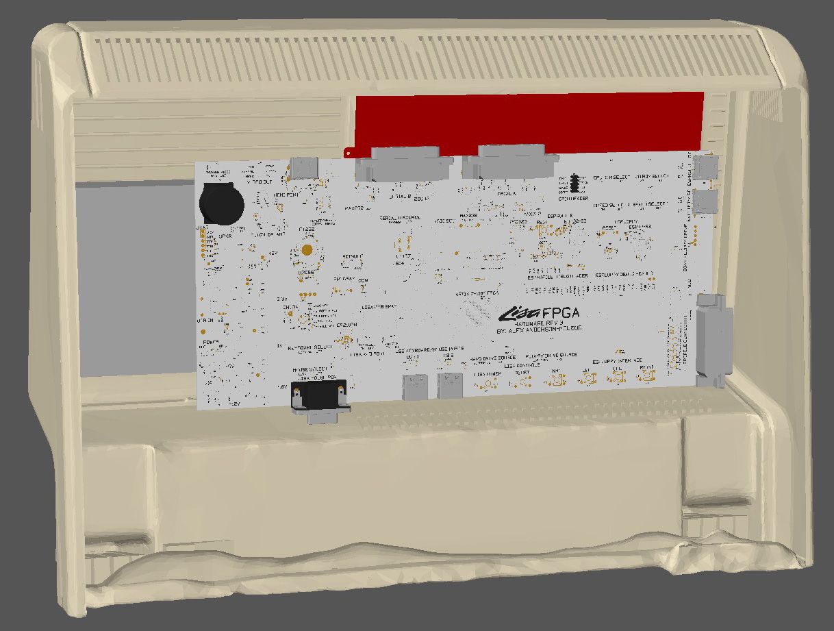

OK, With the addition of the the LisaNet module I added (connected to the LisaFPGA's GPIO pins), I noticed with my case and my software enhancements, the chip was getting hotter than it should. So I've optimized the software a bit (and removed a feature I wasn't using - 1024 x 768 support) and have it running within a few degrees celsius of the stock firmware. I think with my case, the vertical orientation, and the software, it is higher than I feel comfortable with.
So I've added a spot for a 40x40x10mm fan above the FPGA chip. I also have reworked the rear case so that it can be printed without supports. That required removing the skirt from the main body and allowing it to be printed separately. One advantage of that is that you can print the skirt you like (with the cutout for the keyboard cord, or without).
I'm printing it now, and I finally got my ESFloppy screen in. Note to others: if you do relocate the ESFloppy screen, triple check your wiring to make sure you don't get any wires mixed up! But it now is fully working, and I can test with my on screen menu system to confirm it doesn't cause problems. However, with LisaNet in place, I can do basically anything I would do on the onscreen menu without touching the machine. Those settings are all available (plus some settings not in the settings menu) in the LisaNet web interface. I'll be updating the 3d model files in the repo, cleaning up the instructions a bit, and sharing a video of it all in action.
Trying to make it modular so if anyone does create it, they can pick their level of customization. Moving the LED power button and ESFloppy to the front was a lot of extra work. I think it was worth it, because it really does make the experience much better. But there are risks and challenges with soldering to the LisaFPGA board (as evidenced by my fried ESFloppy LCD I had to replace).

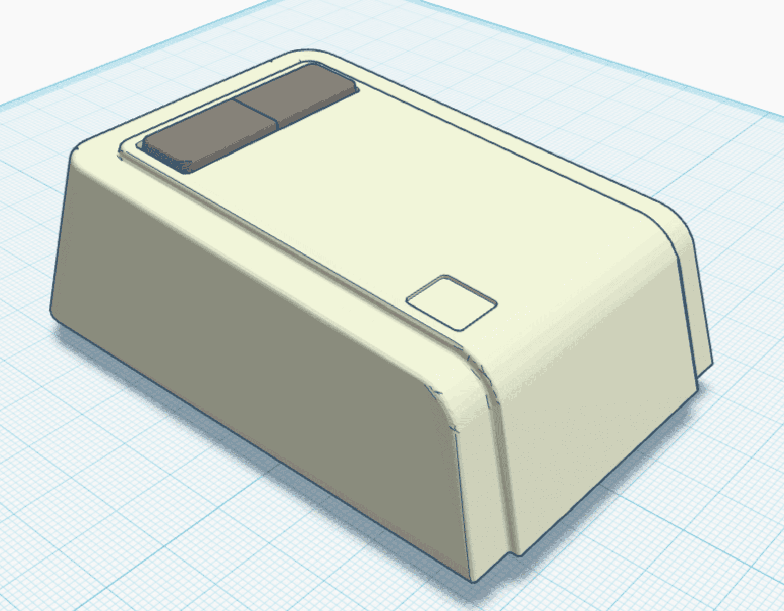

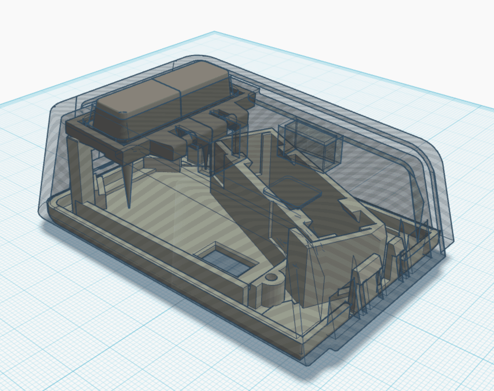

So, with the main Lisa Mini project mostly behind me, I moved on to tweaking my Lisa mouse shell, with a wireless Logitech mouse innards. The version I’ve been using in my demo videos has been passable, but the buttons felt a bit sloppy. So I’ve been trying to optimize the buttons. It has been a journey!
Different print orientations, different stem lengths, my board not sitting flush in some of my assemblies, the buttons catching on the front of the case… it took a lot of test prints to finally get two buttons I was happy with. It’s still not quite as solid feeling as I’d like, but both buttons sit flush and provide a decent click feel.
I may actually split the buttons into two parts. One for the button itself and a second for the leg that rests against the button. That would allow the keg length to be adjusted for variations in the Logitech PCB button heights. I only have the one mouse, so I don’t know if this will need adjusting, but as you can see from my ~20 buttons, getting the right height is challenging.
I’m just doing some final validations of the prints and will publish the results soon. I will say I love using it wirelessly with the Lisa Mini (no left mouse click support in Lisa Office System, obviously), but the movement is smooth and clicks are handled reliably.
I could see myself using it on modern computers, but I do miss the scroll wheel. I may look into adding support for the scroll wheel in the middle of the buttons.
Reactions: Garrett and JDW
